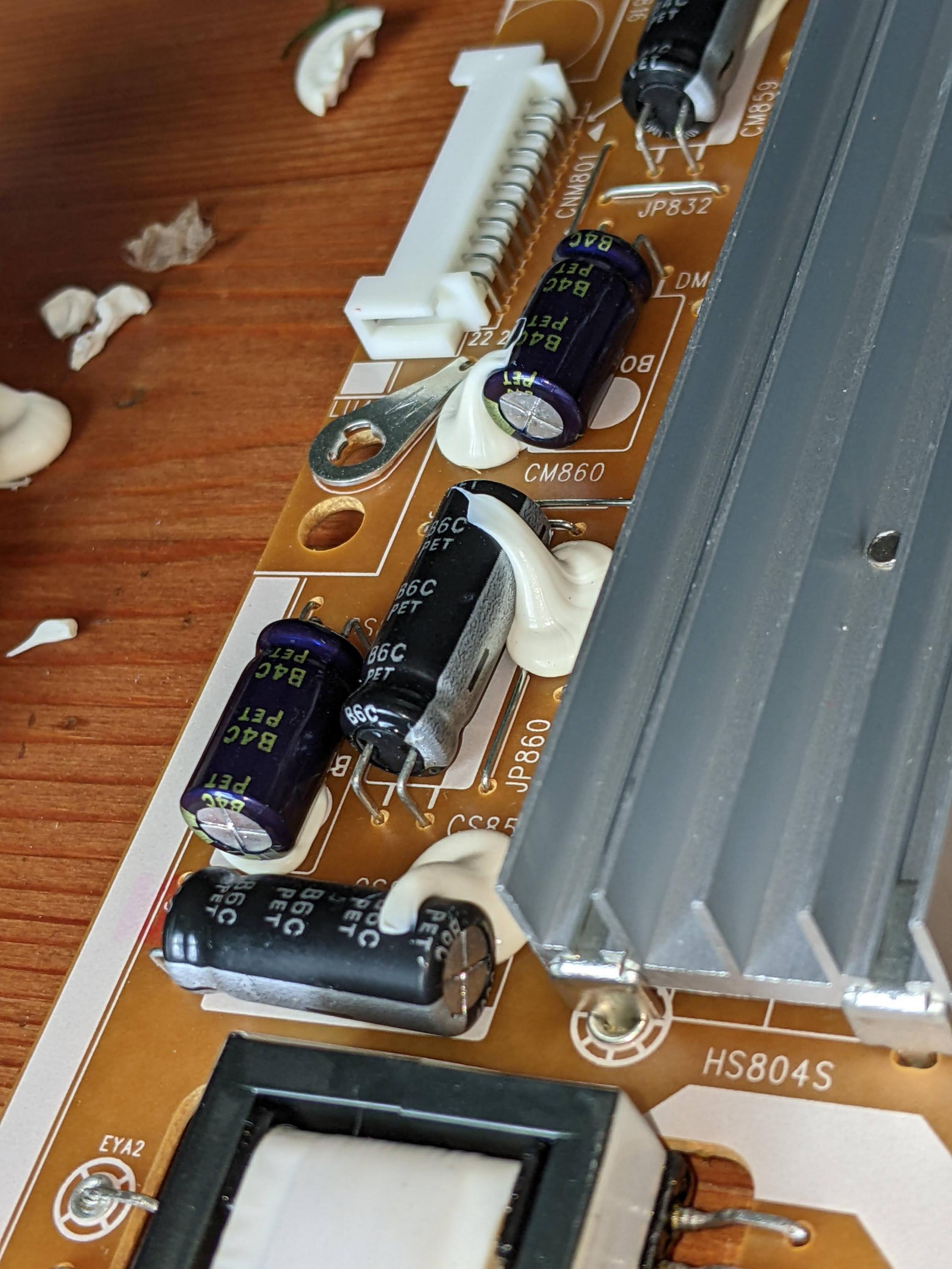

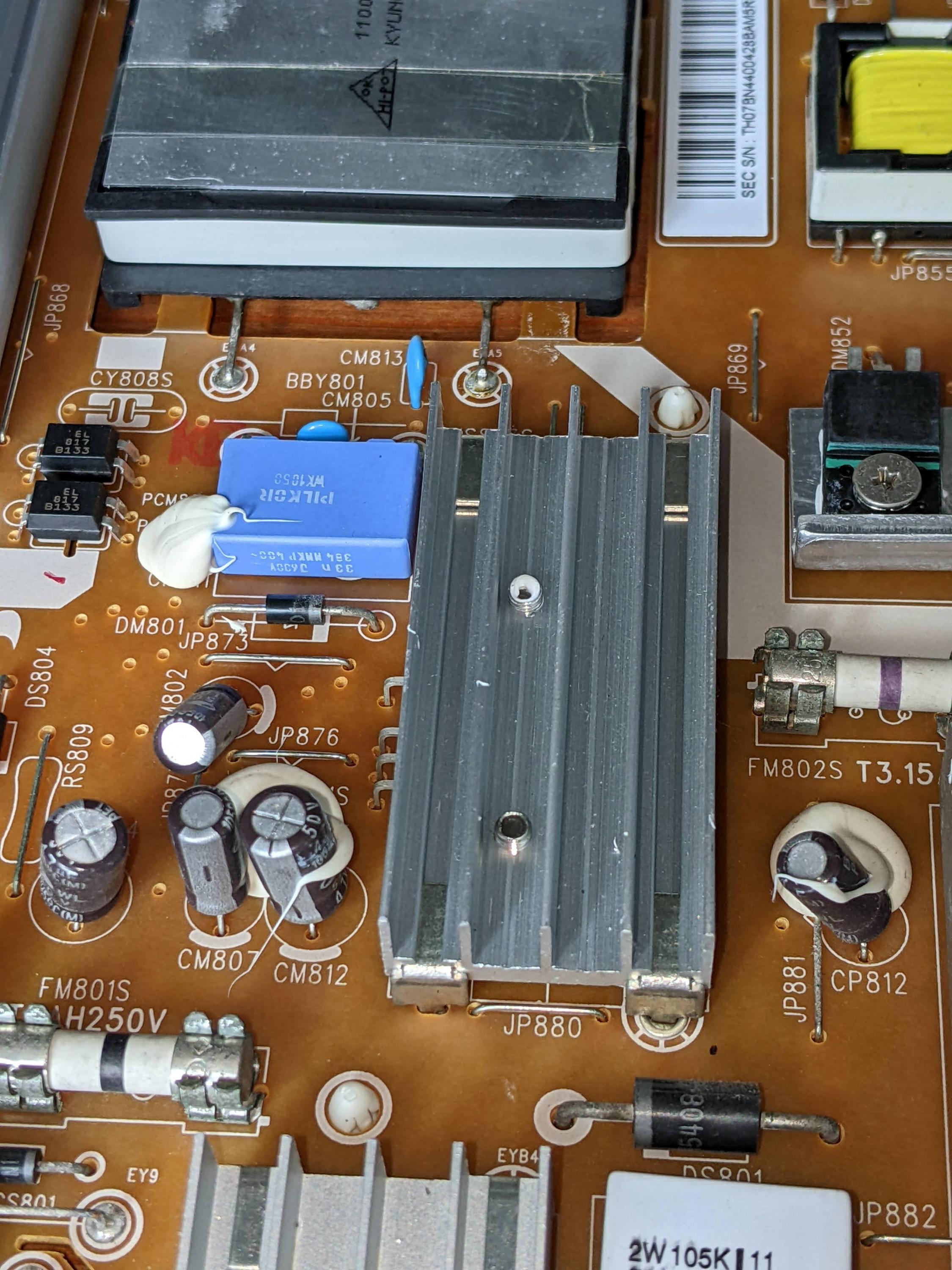

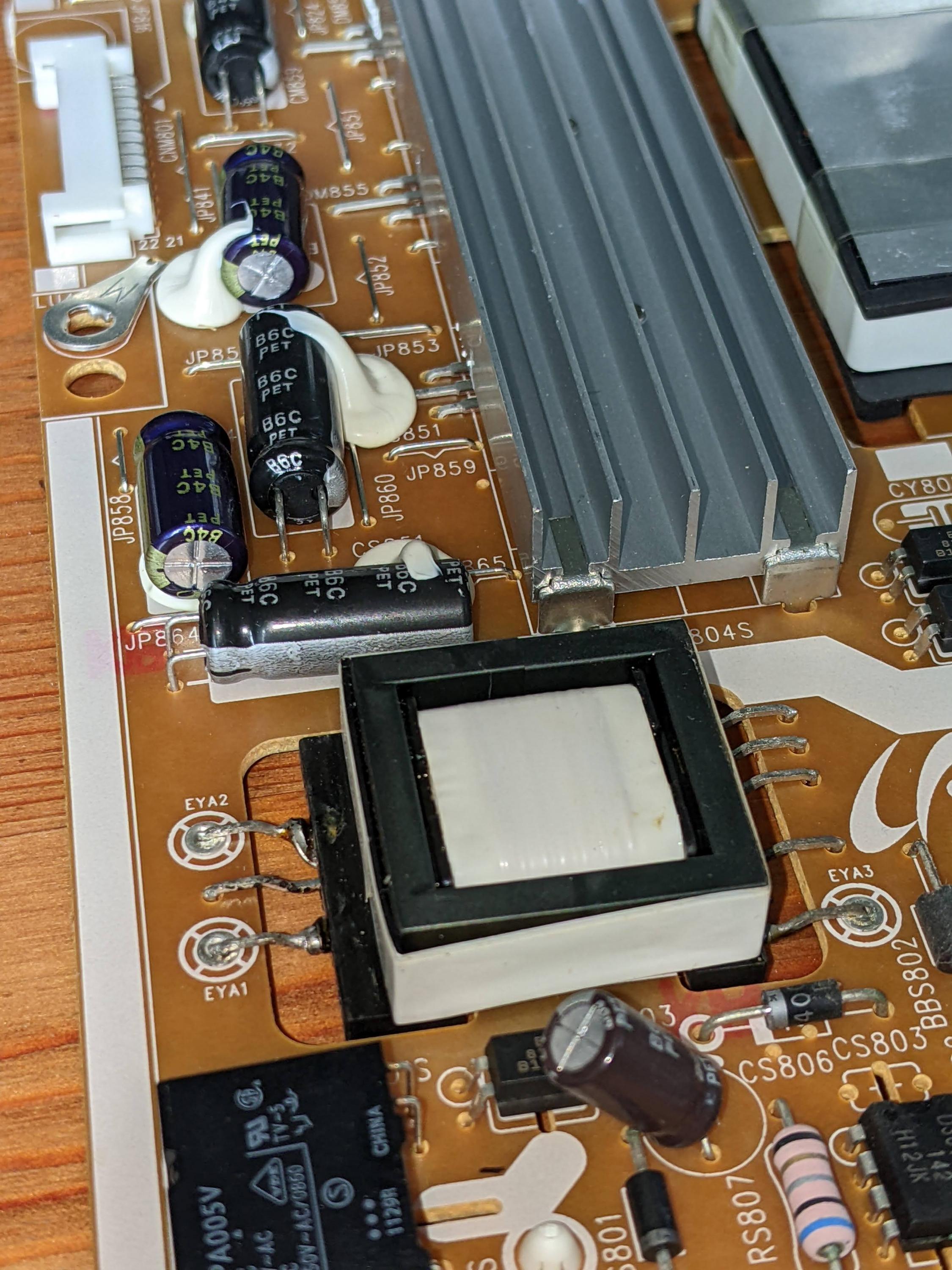

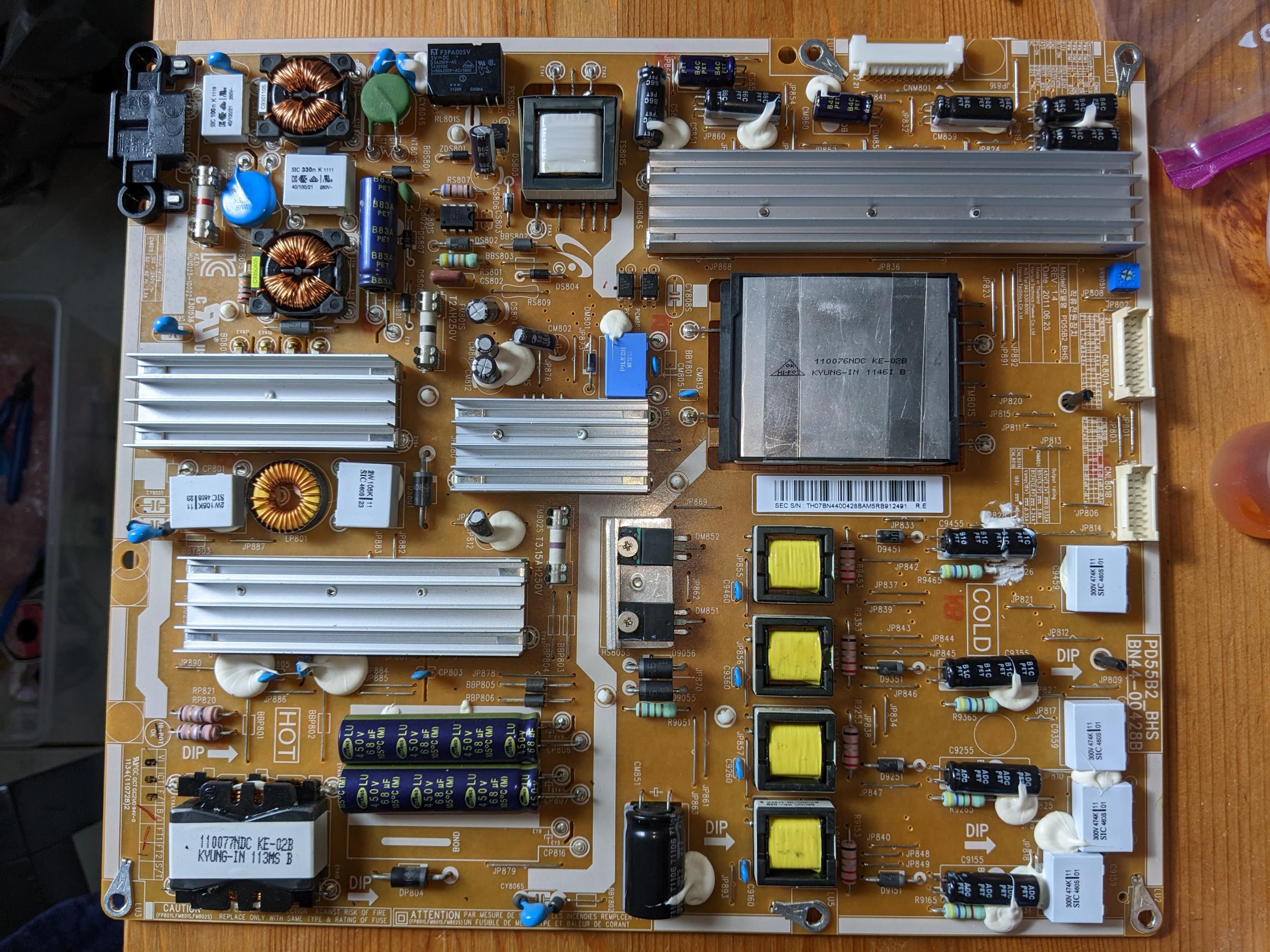

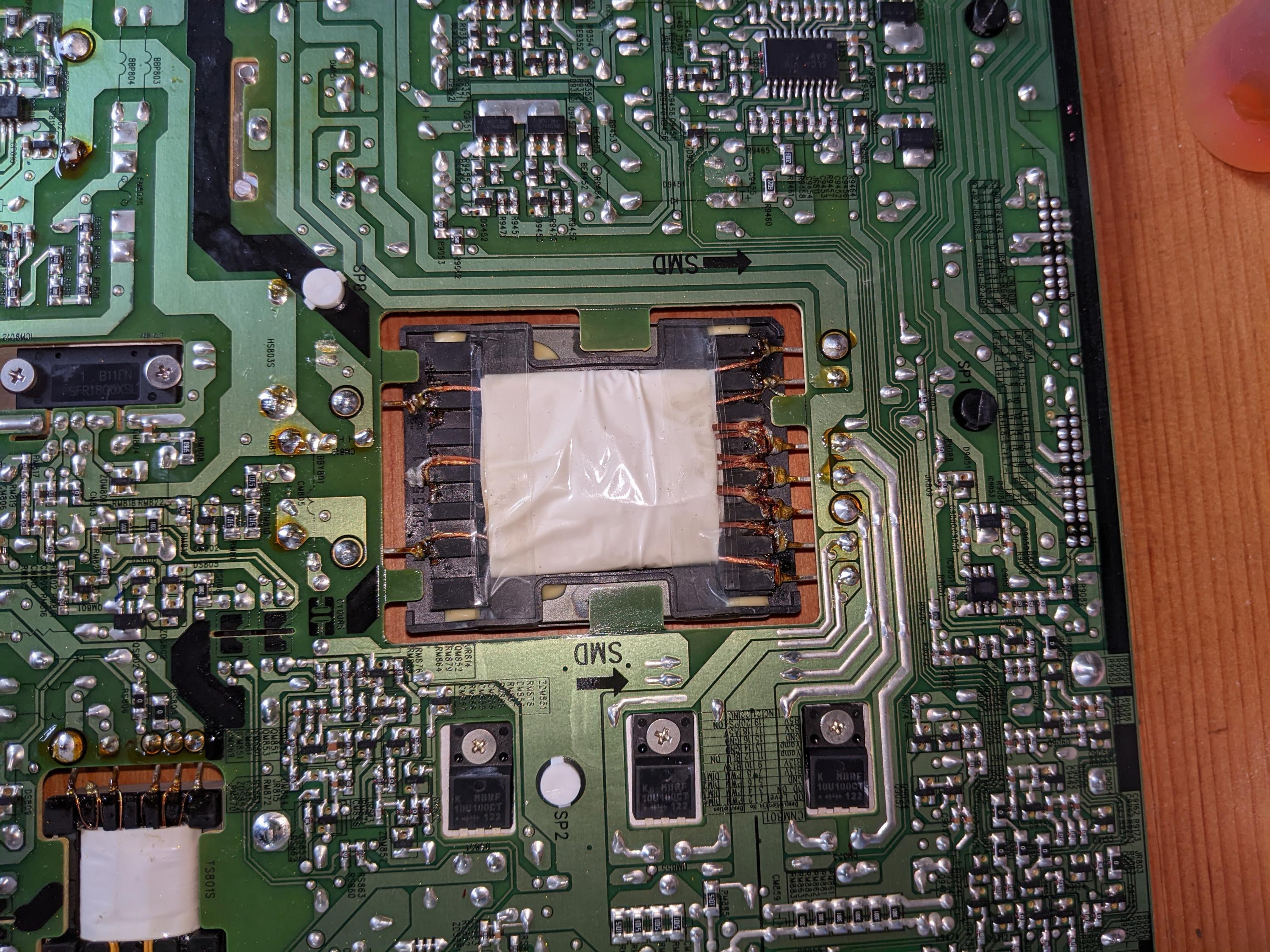

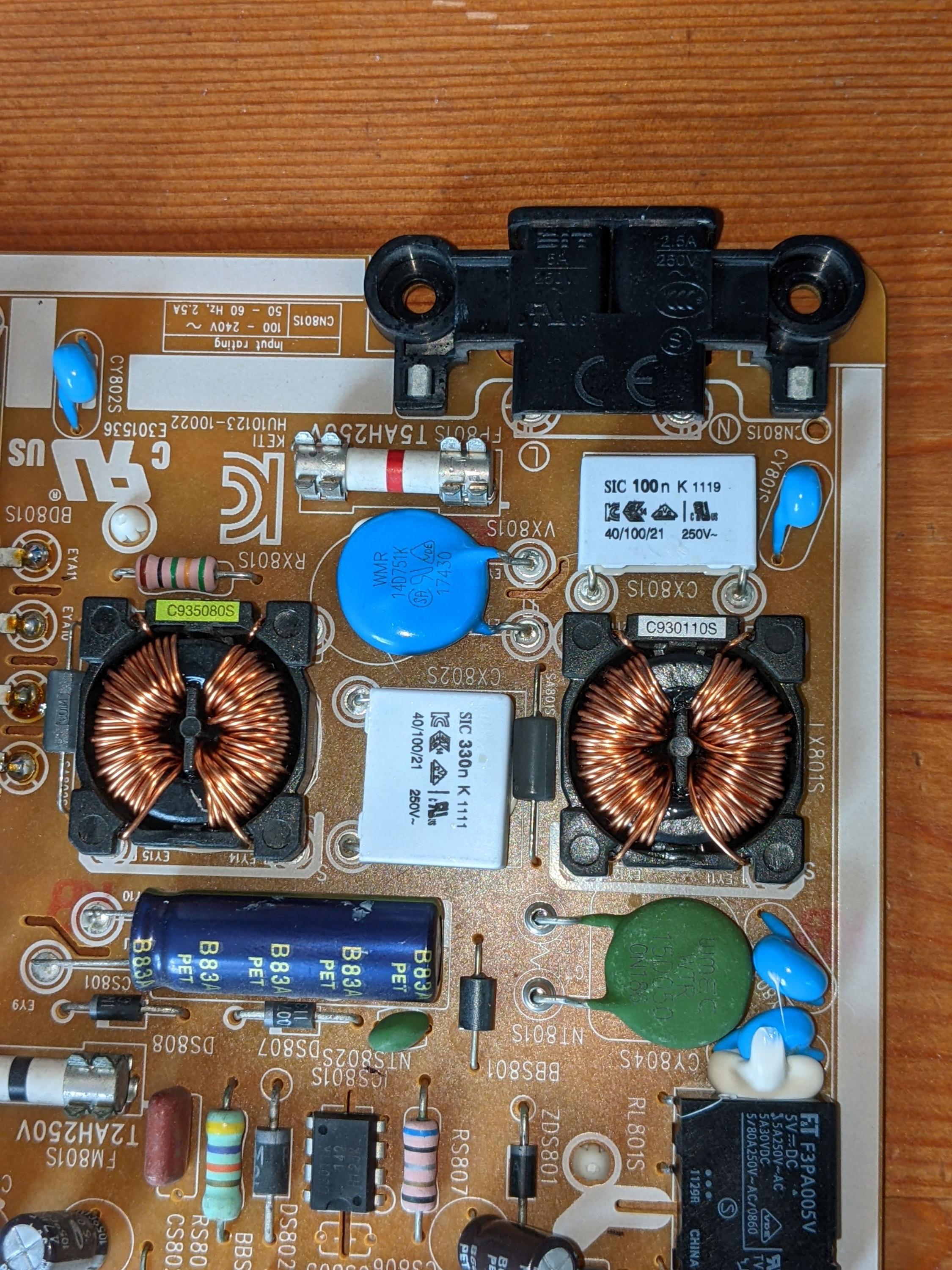

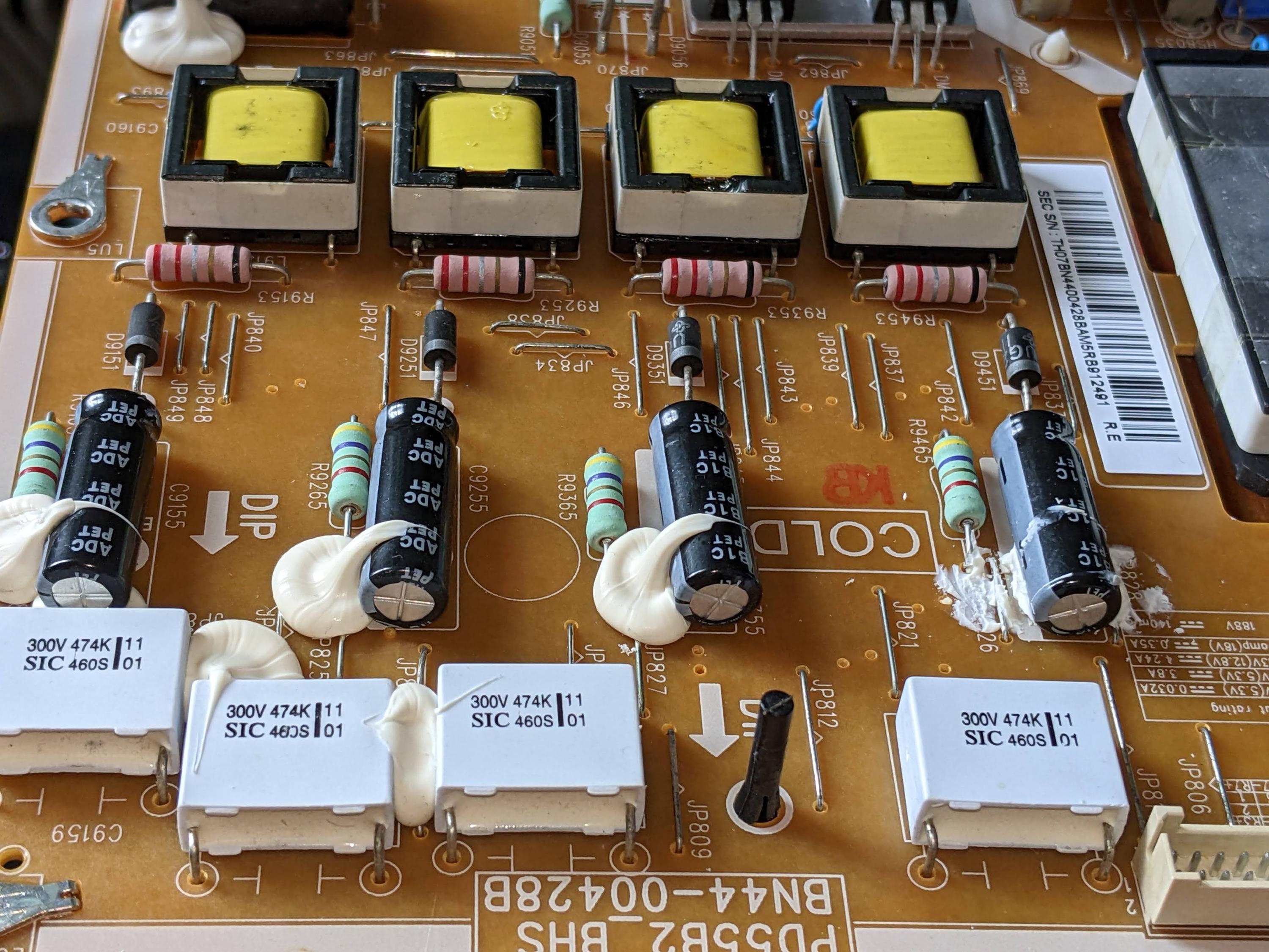

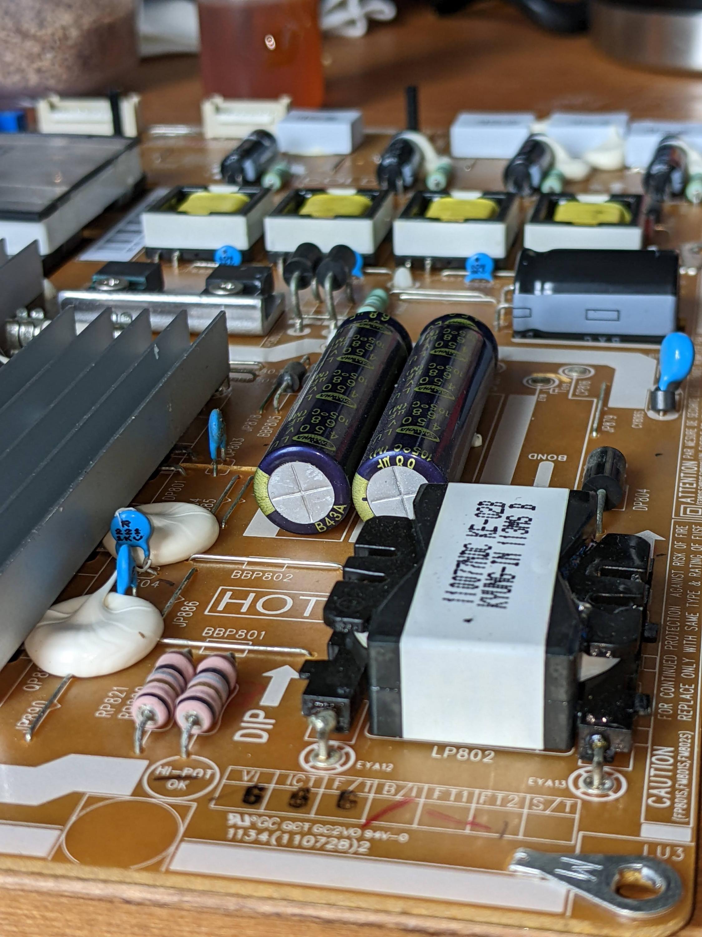

        Re: Samsung / Hansol BN44-00428b
        This thread is epic. Not sure whether I should create a new thread or update this one, but let me know if I am breaking board etiquette by replying here and I'll create a new thread.
        I am troubleshooting a TV (a Samsung UN55D6420UF) that has one of these Hansol BN44-00428b boards right now. The symptoms don't look exactly like anything I could find in this forum and now I'm super curious to figure it out. I am obviously not an EE or anything but I am really intrigued by circuits.
        Here is the behavior:
        1. When perfectly cold and with all capacitors discharged, the TV starts right up, and will do so a few times in a row.
        2. After it's been powered on for a while, if you turn the TV off and on again, it will relay-click a bunch of times before it starts up. It seems like the longer the TV has been running, the more times it'll click before it eventually comes on.
        3. If it's been running for an hour or more, if you turn it off and on again, it will bootloop...you can see the logo come on for a moment and then it immediately reboots. I've let it do this for several minutes and it never fully boots, so I just unplug it at that point and let it cool down.
        4. Occasionally (after 20-30 minutes or more), while watching the TV, the screen will go dark, the relays will click, and then it'll come back on. This sometimes results in an endless logo-flashing boot loop, especially if the TV has been on too long.
        I put a meter on various power rails on the cold side as well as all of the pins on the main board connector. The standby voltage is around 5.5 VDC whether the TV is off or on. When the TV is successfully running, the voltage is 5.4 VDC on the 5V rail, 12.8-13.0 VDC on the 13V rail, and 17.9-18.1 VDC on the 18V rail.
        However, when the relay is clicking on and off and the TV isn't booting yet, the voltage on each non-standby rail (5V, 13V, 18V) will spike up to about 25-75% of proper voltage right after each on-click, then go back down to zero immediately, and after that, the relay will click off and try again. This occurs until the "successful" on-click where the voltage gets up to where it's supposed to be.
        Unplugging the main board from the power supply, there is a delay of between 5 and 20 seconds before the backlights will come on. Once they're on, they stay on, with no flickering. During the delay before the backlights come on, there is a faint crackling noise coming from the area near where the AC cable is plugged in, somewhere around the two inductor coils there. Sometimes, during the crackling noises and before the LEDs fully come up, the LEDs will flicker on each crackle. Because of this possibly abnormal behavior even with the mainboard unplugged, I'm suspecting either the power board or the LEDs (or the connections between).
        I ran these tests in the dark and I see no arcing on either side of the board either during the relay-clicking power on or during TV operation.
        All caps look visibly fine to me (although I know this doesn't mean they're good). I saw some questionable-looking solder pads around the large transformer, so I fluxed and resoldered every larger pad on the hot side of the board as well as every pad on the transformers, but this didn't change the behavior. I tested each diode on the board with a multimeter's diode mode and I believe they all tested good, although I may have missed one or messed this up.
        I turned down the brightness and looked for bad LEDs with the TV on, but didn't find any.
        I measure 440 VDC across the two 450V caps (on the right side of the board) while it's running. While it's relay-clicking at start and there's unstable power to the low voltage rails, these caps measure 440 VDC after the on-click, and then slowly discharge after the on-click.
        Also measured 184 VDC on the caps that drive the LEDs on the upper right of the board while the TV is working and the LEDs are on.
        The next thing I can think to do is to try and measure each IC with the board on, and compare the measurements to what the datasheet says. It's tricky to perform this kind of test because the TV mostly works... if it were bootlooping or something constantly it'd be a lot easier to measure voltages! As it is right now, I'm plugging it in and unplugging it for each test. Now I really want to buy some of those multimeter leads with alligator clips on the end...
        I am attaching photos of the board in case they provide any clues. I left the flux around the solder pads so you can see which ones I resoldered. If you're as intrigued as I am by this situation and want to help, let me know if you need any other photos and/or measurements.
