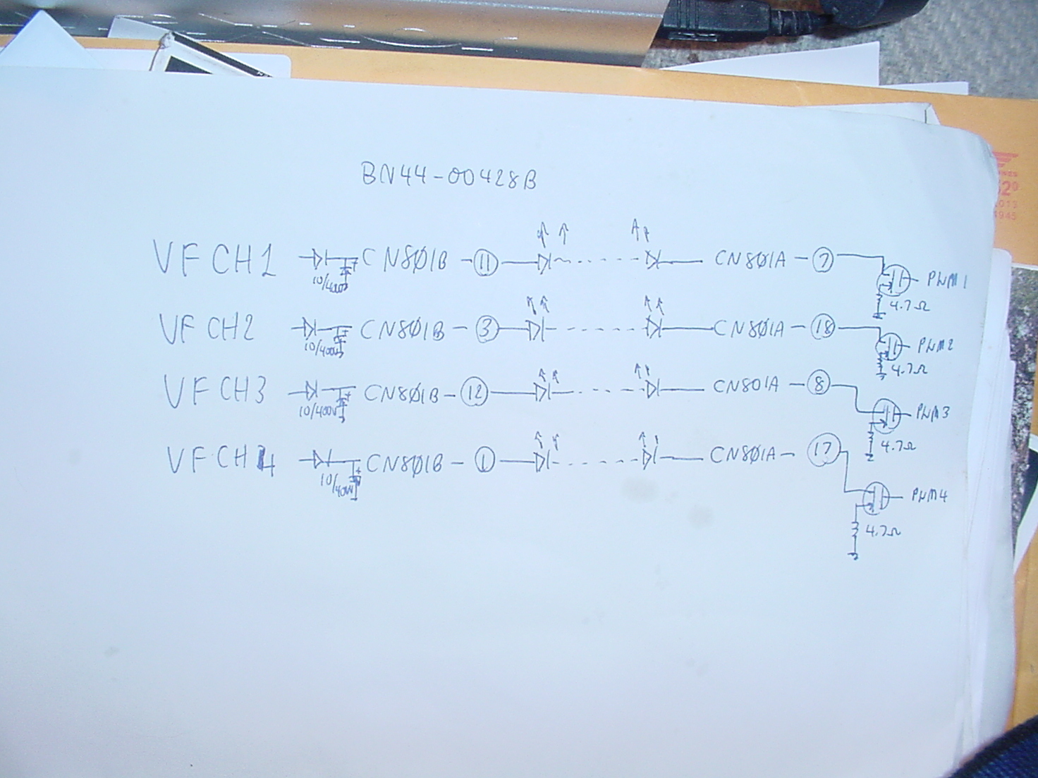

    It is edge lit LED backlights setup, 4 LED strings total per diagram (from looking at the A and the B version, the component designators are not the same but using the same setup).
    I still do not understand by the LED does not even flash on once before going into shutdown, it will have to detect that one or more of the LED strings are not working by trying to fire up the LED, if it detect shorts or open, then it will go into shutdown.
    You may have to remove the LED strings and check each LED, you should also check to see if any one of the wires leading to the LED strings are shorted to the chassis.

      " (from looking at the A and the B version, the component designators are not the same but using the same setup) "
      That was my assessment as well, which is why I was able to use this solely as a template and simply substitute the designators to match (I little extra work, but sometimes you just have to do).
      " I still do not understand by the LED does not even flash on once before going into shutdown, it will have to detect that one or more of the LED strings are not working by trying to fire up the LED, if it detect shorts or open, then it will go into shutdown. "
      And this has been confusing me all along (and still does).
      Is it really flashing and I just didn't see it ??? - I don't know.
      Now that the panel is dis-assembled and I can clearly see the Leds, I may try it again.
      My only other thought would be in the IF1 & IF2 (of the 22 pin conn.) that I have yet been able to decifer. Do they play into the shutdown (protection mode) ?? - If so, how ??
      " You may have to remove the LED strings and check each LED, you should also check to see if any one of the wires leading to the LED strings are shorted to the chassis. "
      Can positively say that all the wires are good. I have verified this not only visually, but ohm and induced amp testing (power probe).
      I already ordered a replacement Led Bar - but would still like to know the how and why.
      I have never actually tested an led before (and don't even know how).
      But if you would be willing to teach me, I'd be more than happy to learn - and appreciative.

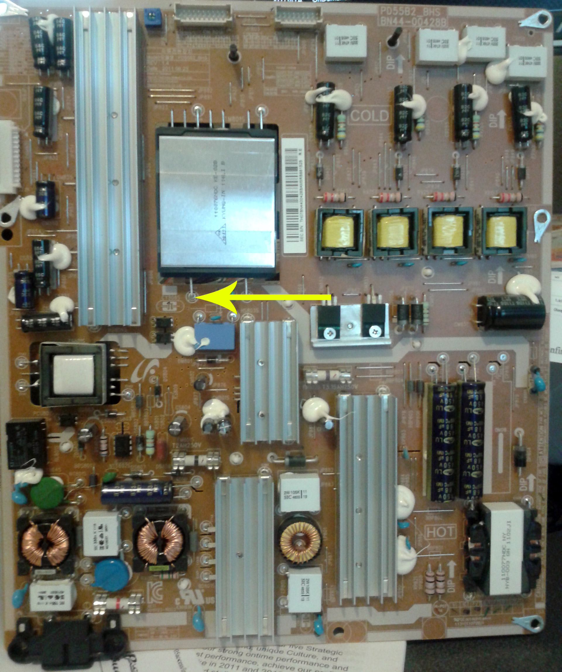

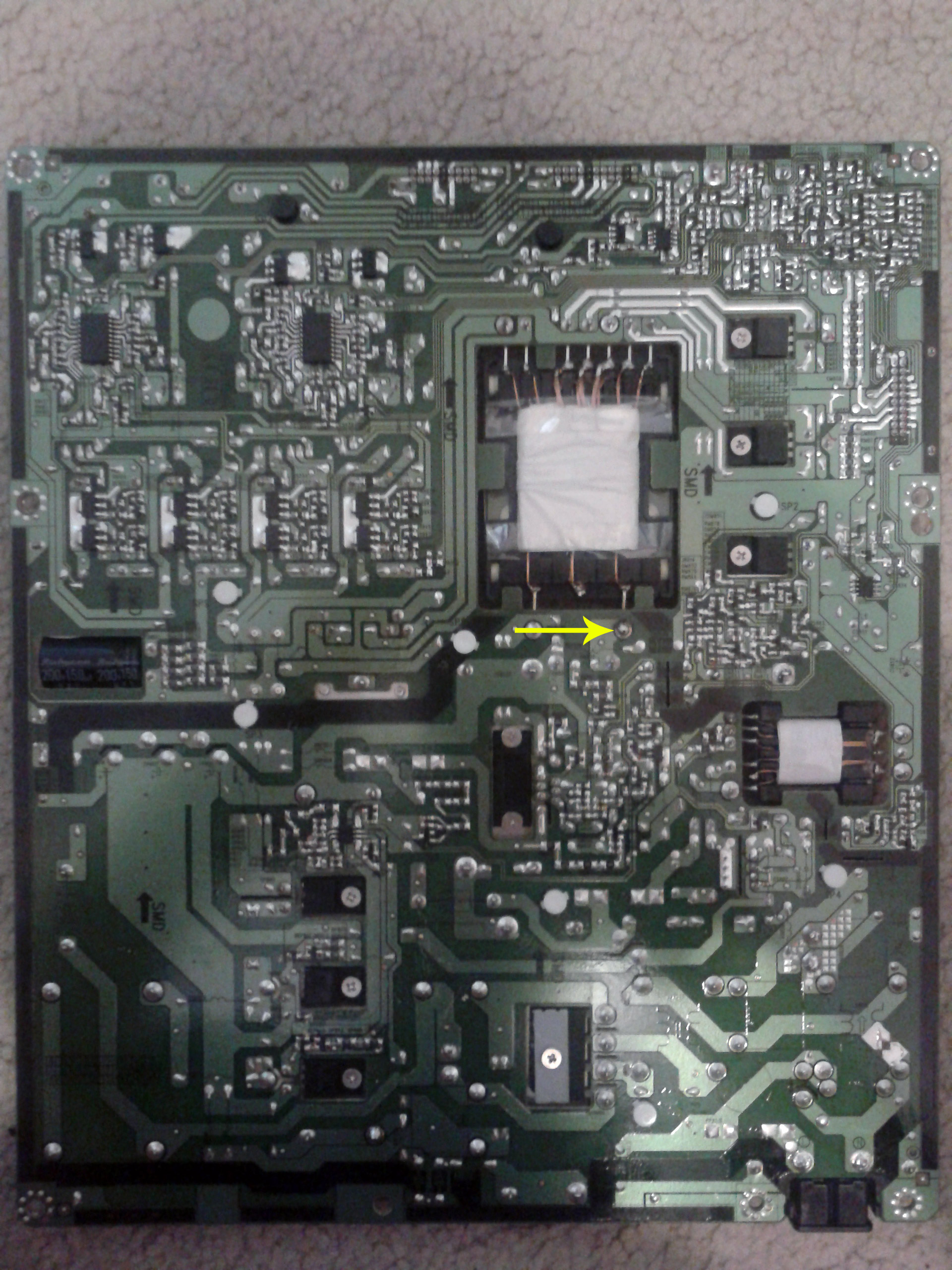

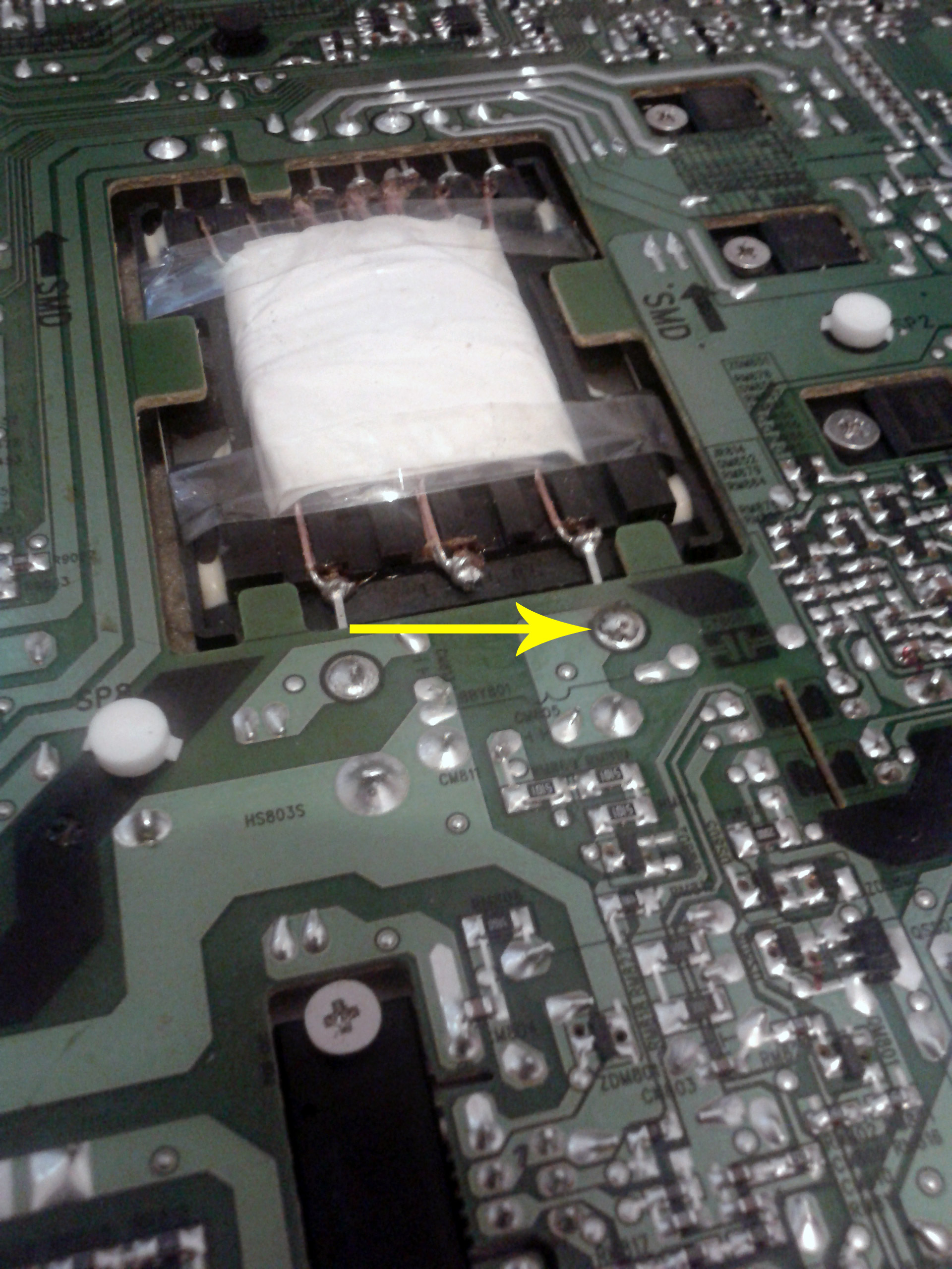

                                    *****Fixed******
                                    I had the same exact problem as the OP and this is what fixed my problem.
                                    I found that the main transformer TM801S had a cold solder if you look at the 3 pictures I posted. The first shows the front of the board with a yellow arrow pointing at the joint that was bad. The 2nd and 3rd show the back of the board with a yellow arrow pointing at the bad joint. I hit it with my soldering iron and problem fixed.
                                    BTW I found this problem because I just happened to see that joint arcing every time the power relay would click.

                                      Re: Samsung / Hansol BN44-00428b
                                      some of the other joints are visibly cracked too.
                                      that's why some of us tell people to re-solder transformers sometimes.
