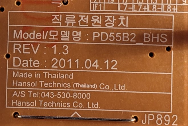

 I also have a Samsung UN55D6400UFXZA. I have the blink problem. My power supply is PD55B2_BHS, BN44-00428B. I found this repair kit on ebay for $12.95 and free shipping:

 Samsung BN44-00428b -revision 3 power supply?
 Folks...
 Update on my kit and power supply. See my post above this one.
 Most of the stuff in the kit do not have a place on my power supply. Could it be that the revision number of my power supply is not matching up with the kit I bought?
 I have no capacitor called CM811. I have no ICM801S. Nothing even close. The kit had two ICs called QP801,802. I have nothing like that. However I have two ICs at location JP862 called DM851 and DM852.
 The only correct things in the kit are two ICs (ICS801S and ICP801S) and the three fuses.
 I have enclosed three photos of my board. I bought the correct kit for the Samsung TV part number and the correct power supply part number. But maybe the kit is old. I have revision 3 of the power supply. Maybe that is the issue?
 Could that be it? Should I check for cold solder joints, install the two ICs and 3 fuses and see what happens?

 Re: Samsung / Hansol BN44-00428b
 CM811 is next to the diode DM801, designator of CM811 is covered by the white glue.
 ICM801S designator is also covered up by the white glue.
 QPxx are also covered up by the white glue.
 The question is what is the problem with the power supply board? What Voltages do you have and not have on the power supply connector that goes to the main board? I would not install the kit until you find what section of the power not working otherwise you can create new problem due to improper repair works..
