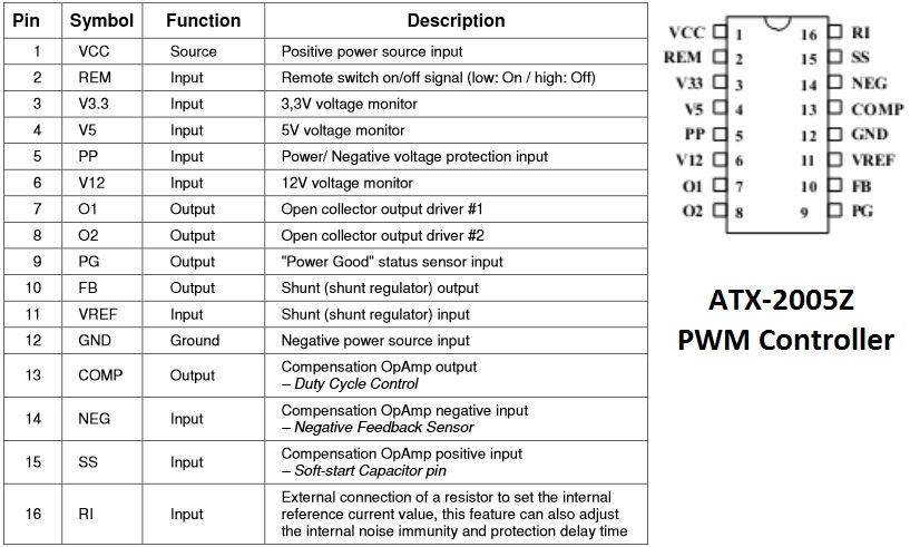

    Since I got my Amateur Radio Operator license a few months ago I've been in the process of putting together my station. One of the aspects of this project is to build a reliable power source to run my various radios and amplifiers. I've successfully converted a couple of old(ish) ATX PSUs to output 13.8v to 14v, with some working better than others. Each are rated at ~20 amps on the 12v rail.
    I plan on documenting the various components with pictures in this thread so we can see what components should be upgraded in order to supply more current/power. I have a fried PSU that can source 60a on the 12v rail so I may pull components from it to increase the power capacity of this supply.
    I converted these by removing the 5v regulation and using a voltage divider on the 12v rail to regulate the PSU (the PWM controller sees 5v through the voltage divider). If I increase the voltage above 14v the PSU won't power on. Voltage is what I consider fairly stable -- 14v at idle and the lowest I've seen is 13.8v under a roughly 200w peak load (~15a).
    I also added a gang of supercapacitors on the output. Total capacitance from this should be roughly 1F. Unfortunately I'm afraid the total ESR of the 7 capacitors in series is too high to do much good (each capacitor is rated at 80 mohms esr).
    The problem I've come across is the transient nature of the power consumption of the SSB transmission mode is randomly powering down my PSU.
    I don't believe the PSU is going into overpower or overcurrent protection; it will shut down at random whether I'm using the amplifier (15a max) or running barefoot (less than 1/4 the power of the amplifier). I can sometimes talk for upwards of 20 minutes without a shutdown and other times I can't finish a sentence. Once the PSU starts to power down it will do so regardless of the power settings.
    I don't believe temperature is a factor; the room temp has been anywhere from 40°F to 85°F and if anything the PSU will shut down more often when it's cold but I have no way to quantify that. I have never felt any heat coming out of the back of the supply (high speed fan runs directly off the 14v rail).
    It seems to be able to run more stably in AM mode which has a more constant power draw with more average power used but less peak power. However, when talking on AM in medium or high power mode the PSU makes a slight squeal corresponding with my voice. This noise doesn't occur in SSB mode.
    I have replaced a few bulged output capacitors with higher value components - both in voltage and in capacitance - though they came out of another PSU so admittedly I don't know their ESR (just that they aren't bulged and my Fluke meter measured the correct capacitance).
    Strangely even with a modest ~250 watt load I’ve noticed that the lights slightly dim in my shack when I’m talking in SSB mode (following my voice). Might larger input capacitors alleviate this problem? It should be noted that my 2kw electric heater and ¼HP grinder don’t cause the lights to dim appreciably. Could this possibly be what is causing the PSU to shut down?

      Yes, I did precisely what is shown in that link. Too bad; I thought I had produced an original DIY idea. :P
      Unfortunately I can't edit my original post so I'll add some more information here; the stated power capability in my original post was incorrect.
      The PSU is an Austin Power Supply, Model DR-B300ATX.
      3.3v 28a
      5v 30a
      12v 15a
      It seems this power supply is running on the ragged edge of inadequacy.
      So I guess the next question is, which components should I look at first with regards to increasing the power capability? Would it be possible to remove the more stout 5v components and use them to replace the 12v components?

        Could just be the OVP shutting it down. Well that explains everything! It's a Deer Depending on what the PSU uses, it may be a bad idea to swap the 5V and 12V rectifiers. Most likely the 5V uses a TO-247 30A schottky and the 12V uses a 12 or 16A ultra fast recovery diode. If so, then swapping them would probably throw all the voltages out of whack. If there's a schottky on the 3.3V, swap that one with the 12V. It probably has 13007 switchers, which are good for usually 250W but depending on the size of the main transformer it may not even be worth it to replace the switchers.
        It wouldn't hurt to up the value of the input caps. They're probably 330uF, and the switchers + transformer would thank you if you got them to at least 470uF.

            I haven't had trouble increasing the voltage on this supply; it is stable at 14v using a single variable resistor, though admittedly it won't go much higher. The supply uses an ATX-2005Z PWM Controller which has the ability to monitor the 3.3v, 5v, and 12v rails.
            Ripple voltage on the output is well within acceptable limits, <20mv at idle and <75mv under a steady load. Problems only arise when the load is extremely transient and knocking on 15 amps, as in the case of transmitting in SSB mode.

                    I modified the regulator feedback to maintain steady voltage based on the 12v rail instead of the 5v rail. Loading of the lower voltage rails is unnecessary when this is done; loading them would do nothing more than dump more heat into the main transformer.
                    I replaced the bulged originals with higher capacitance and higher voltage rated capacitors, though the PSU could probably benefit from low ESR equivalents.
                    Originally posted by sententia
                    When using this mod do all other voltage rails get altered in their outputs?
                    If so should one check the capacitors of the other rails as they can be damaged?
                    Yes, the voltages on the other rails increase along with the 12v rail. They will increase even further when high current is drawn from the 12v rail (and therefore the PWM increases the duty cycle through the main transformer which increases all of the output voltages). Tricking the PWM controller into believing the 3.3v and 5v rails are closer to 3.3v and 5v may increase the PSU's usable voltage range. In fact, come to think of it, this could be why the PSU is shutting down; a heavy load on the 12v rail will increase the voltage on the 3.3 and 5 volt rails which could be triggering the PSU's over-voltage protection. I'll have to look into that.
                    I replaced the 5v filter capacitors with 10v capacitors and the 3.3v capacitors were replaced with 6v capacitors. I would much rather simply disable and remove the lower voltage rails, however, to free up room on the board and simplify the layout of the entire power supply.

                                      I did a little more checking on Friday and this is what I came up with.
                                      The 3.3v rail is separately regulated and is still at exactly 3.33 volts.
                                      The 5v rail has gone up to 6.3 volts (6.6v under load) but since I removed the feedback from the 5v rail it shouldn't be tripping the OVP. Capacitors are all 10v rated.
                                      The 12v rail has 16v capacitors and is right at 14v. This is where it gets strange, however. Pin 6 of the PWM chip monitors the 12v rail for OVP. Instead of 12v on this pin, it has 0.778v which increases to roughly 0.85v under load which is about the point that the PSU shuts down.
                                      I've attached the PDF that contains the datasheet for the ATX-2005Z PWM controller.
                                      Main Input Capacitors: 85°C Koshin 330uF/200v
                                      Main Switchers: D13007K 606II (x2), CET 6588Z CEF062N6A
                                      Secondary: LT6220 SBK2045CT, PEC614 SB1660CT, LT6206 SBL3045PT
                                      Transformer: ERL-35-2005
                                      Images to come.

                                        I suggest you replace the 330uF input capacitors with 680uF ones. Sometimes deer uses 2A diodes for the mains rectification - those aren't good enough for 250 watts! Replace them with 3A diodes, or install a bridge rectifier. How hot do the heatsinks get? How hot does the transformer get? What brand are the secondary side capacitors? Have you tried replacing ALL electrolytic capacitors?
