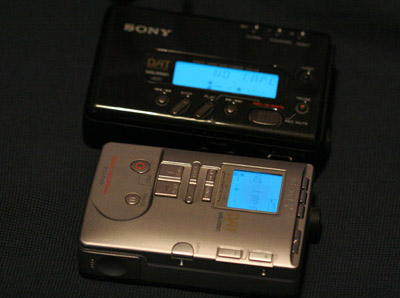

                        If there is a front panel it should be digital with adjustable backlight brightness (preferably blue) and be able to have software input via usb so that not only the PSU readings are displayed but also the user is able to show other stuff like winamp or motherboard readings on it. so then there is a double bonus, the user not only buys a psu but gets a front panel as well.
                        Sony DAT blue yaaay
