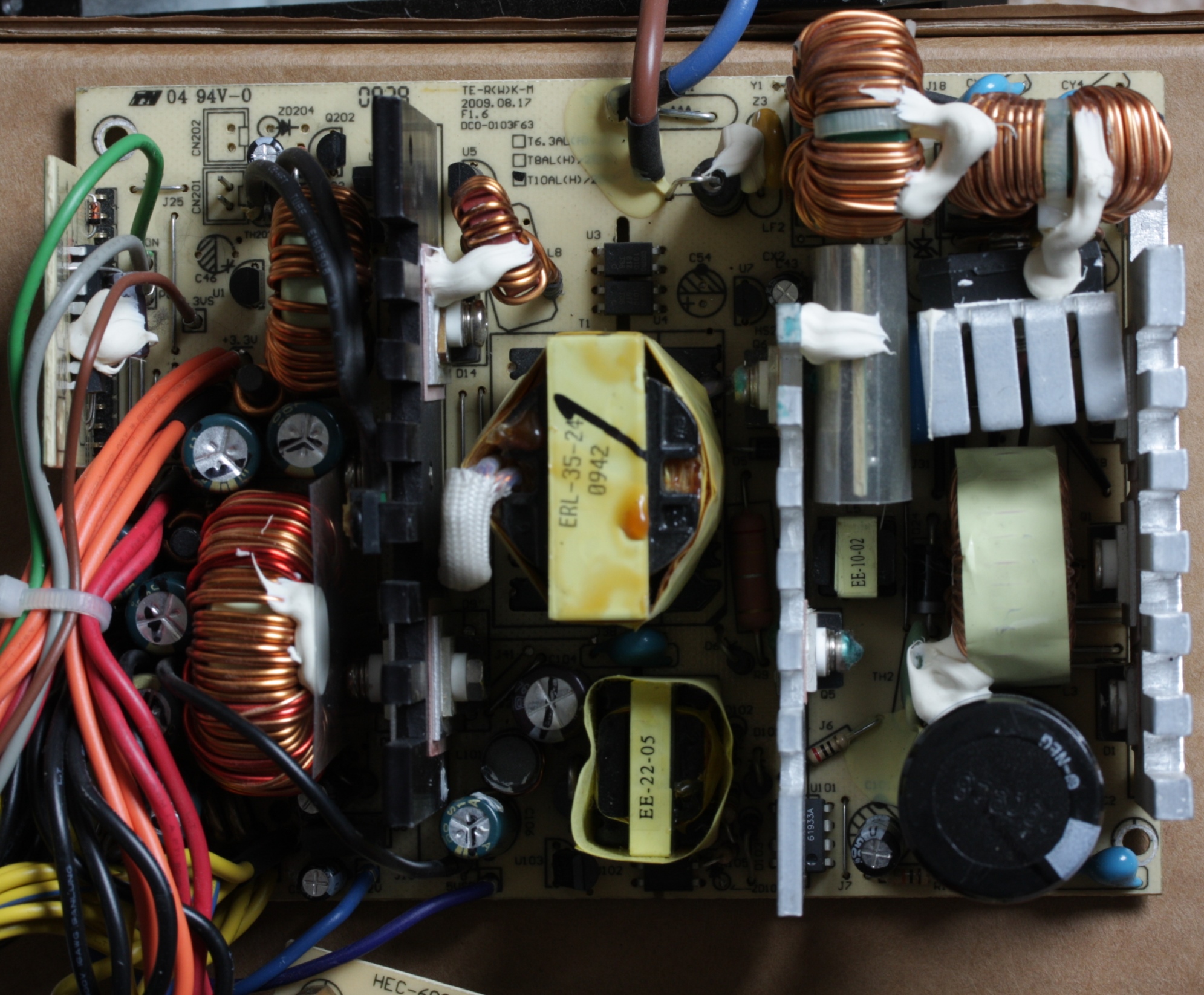

    Problem: PSU does not allow pc to start
    Testing: Fuse checked fine, primary startup cap fine, ~330v on the primary cap, psu tester does not register anything at all. Apart from the primary voltage I am getting 5.05v at the PS-ON (green lead) and the same at the 5VSB (dark blue lead). None of the other 3.3v or 12v rails have any voltage.
    Question: I can't see anything that appears burnt, cracked or smells bad, the caps (teapo) which I know are poor are not bulged and test good on esr meter. Can you suggest where I can test next? ...also can anyone identify the manufacturer of this unit so I can check for a schematic.

    since it has 5VSB and 5.05V PS_ON, you have much more chance to repair it. the culprits maybe on the secondary side of the psu. try to look carefully that has any burned or stinky smell..

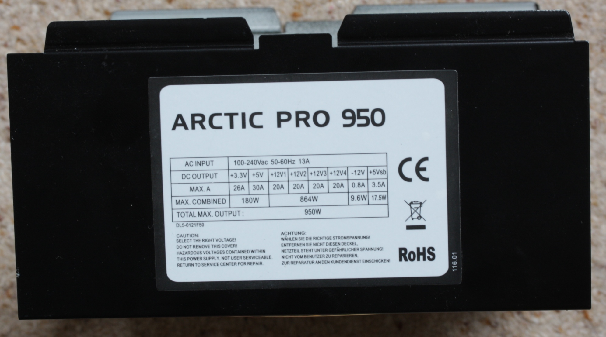

      I hope you do not think you can get 950W out of this supply, you would be lucky if it could do half of that continuously.
      You will be hard pressed to find a schematic for this power supply or any ATX power supply, but you can repair these without one with some effort.
      When you attempt to turn on this supply, do you get any voltage out of the 3.3, 5 or 12 volt rails for even a fraction of a second? If you do then your problem is most likely on the secondary side due to a bad input to the supervisor IC. If not then then the primary side is not getting the signal to turn on or the primary side is damaged.

        if you don't even get anything for a fraction of a second, then check primary switchers, resistors and diodes around them

            belongs in the hall of shame.
            950w my ass!

                  This. I'd check rectifiers as the first thing - if somebody believed that sticker and pushed it too far, rectifiers would probably be the first to blow.

                    So I asked the guy how much he had connected and it was a lot.... 5 hard drives, x2 USB hubs, lots of case fans a decent processor, x2 DVD drives and a meaty graphics card. I believe he definitely maxed it out and was sold on the 950w rating,

                      This looks like HEC, or a HEC knock-off. May be the rectifiers like behemot suggested. When you try to power it on do the fans twitch for a second?

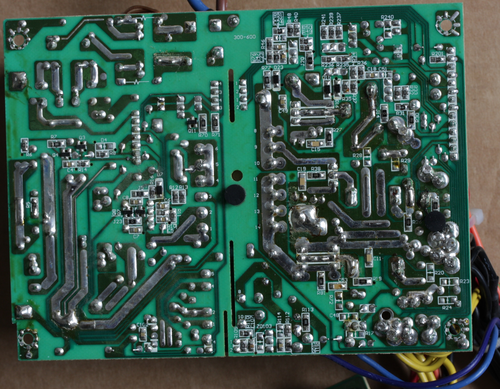

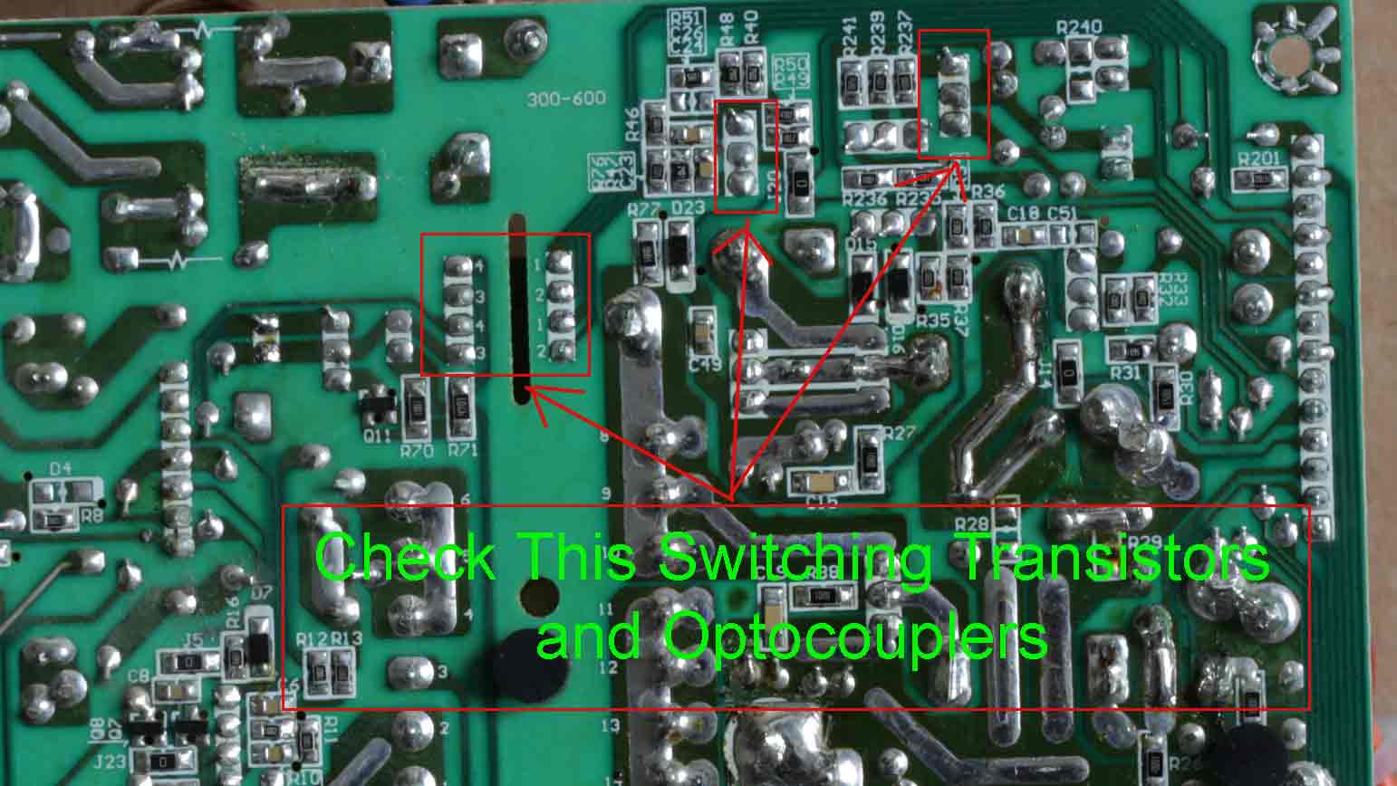

                              I think you have switching problem . check those switching transistors and Opt-couplers shown in the image . If the switching transistors and optocouplers are OK, then give a voltage check . Measure the voltage of Optocoupler Pin 1 & 2 at normal state (I mean without connecting "Green + Black" condition) . Now connect "Green + Black" and measure the voltage of optocouplers pin 1 & 2 again . This time optocoupler's pin voltage will go higher than the voltage was at normal state . If it happens like that, then your controller section is working properly otherwise not .
                              If the secondary side is OK, then you have the problem in the Primary section and you have to search in the primary side .
                              I hope it will help you find out the problem side ...........

                                Escort Eagle - I have checked the switching transistors on the peak DCA55, and they came out ok. Can you advise me on how many volts dc I should be seeing on pins 1&2 of the optocouplers, as when I tested it was only 0.02v dc.

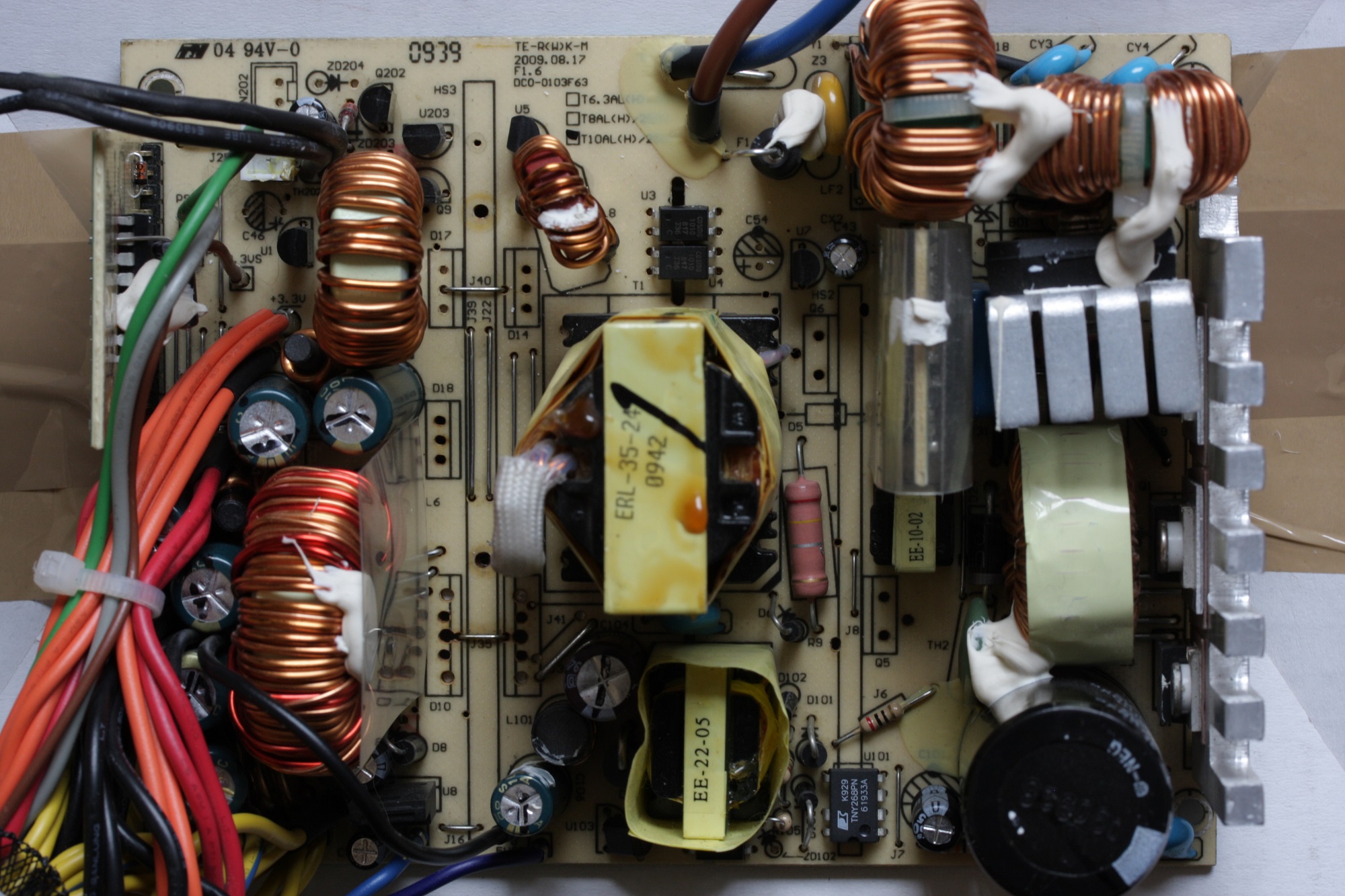

                                  quattro, did you test passive components as I mentioned in answer #4? switchers?
                                  They can be tested onboard, typical failures will result in opens or shorts.
                                  I had identical issue with another p/s - the resistors were cooked to fuck. they changed their rating from 1ohm to something like 1Mohm There wasn't any clearly visible damage to them though. I am not familiar with octocouplers, never had problem with them, but I have swapped them with known good ones as a precaution As it didn't help, i've put the original one back
                                    Is it 0.02V DC in both Off_State and On_state ? At On_State it should go upto 1.5V . That means your controller IC is not working properly .

                                      I've just tested the diodes and found D5 (UF1007) to be shorted ( I get a reading in both directions). Should I replace with the same or go up a notch?
                                      Also can you confirm what you mean by switchers please?
                                      I managed to get around 330v at Q6 but not Q5 does this help at all?

                                        have a look if there is some small-value resistor nearby, sometimes there is and it makes the reading seem the diode is bad.
