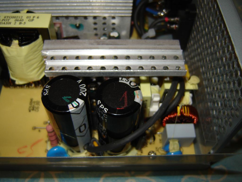

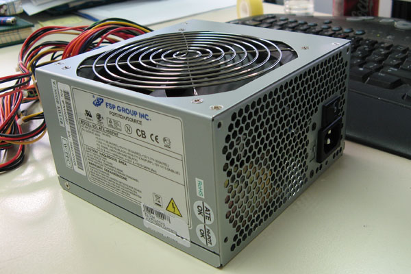

    I am using these for replacements in the office.
    dual rail 12v which is not exactly what i need though
    Passive pfc

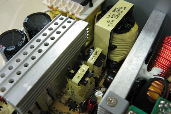

      jamicon, teapo, capxon
      last one. 20+4 atx

        I see this PS has plenty of Teapo caps and Jamicon 3300u 10V. I would be rather sus of the latter caps. The old trick of using low grade caps uprated from 6.3V to 10V.

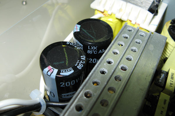

                          Would you tell me the value capacitance and diameter of large can input caps(Teapo)?
                          My SAMXON Capacitors Database HERE!!
                          X-CON is a new brand for SAMXON's Polymer Capacitors.
                          • willawake
                            Super Modulator
                            • Nov 2003
                            • 8457
                            • Greece
                            Re: Fortron FSP-ATX-400PNF
                            they are Teapo LXK 820uf 200v.
                            looking at the spec sheet they would be either 25x30 or 35x30. I will pull the psu to check, when i can.

                                I have seen testing by others that indicate high ripple with this psu. The primary cap of 820uf 200V is kinda small for a 400w.

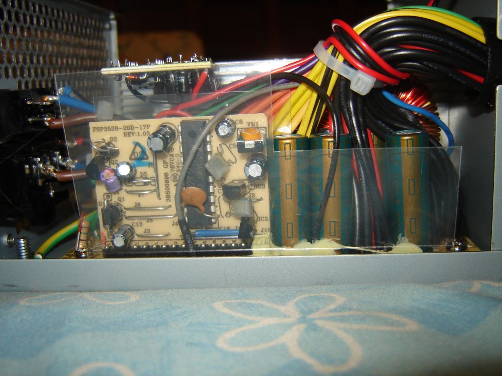

                                I open this HEC 350 watt which have a pair of 1000uf 200V by capxon. This PSU is from 2001. THe secondary caps are domed (fujuyyu caps). I don't know why in this psu use 470uf 35V on and 400uf 25V on the secondary side. I don't think psu need 25 and 35V on the secondary. I will update with picture in the build thread.

                                      I have 2 of these PSU laying around with bad caps. One of the 2 CAPs in the middle (Teapo 1000uF 10V) are dead on both.
                                      I wonder if it originates from the capacitor quality or maybe the motherboard what it worked with killed it.. (I found these)
                                      I would change them, but I have only 1 such capacitor in my inventory but that has greated diameter, or I have some (a lot) nichicon 1000uF 6.3V caps.. oh and a Jee 1000uF 16V.
                                      Jee is low quality as I read, but maybe it is oversized enough not to die?
                                      Also would it be enough to change 1 cap on both, or both caps since they are identical, and I guess the other can fail as well?
