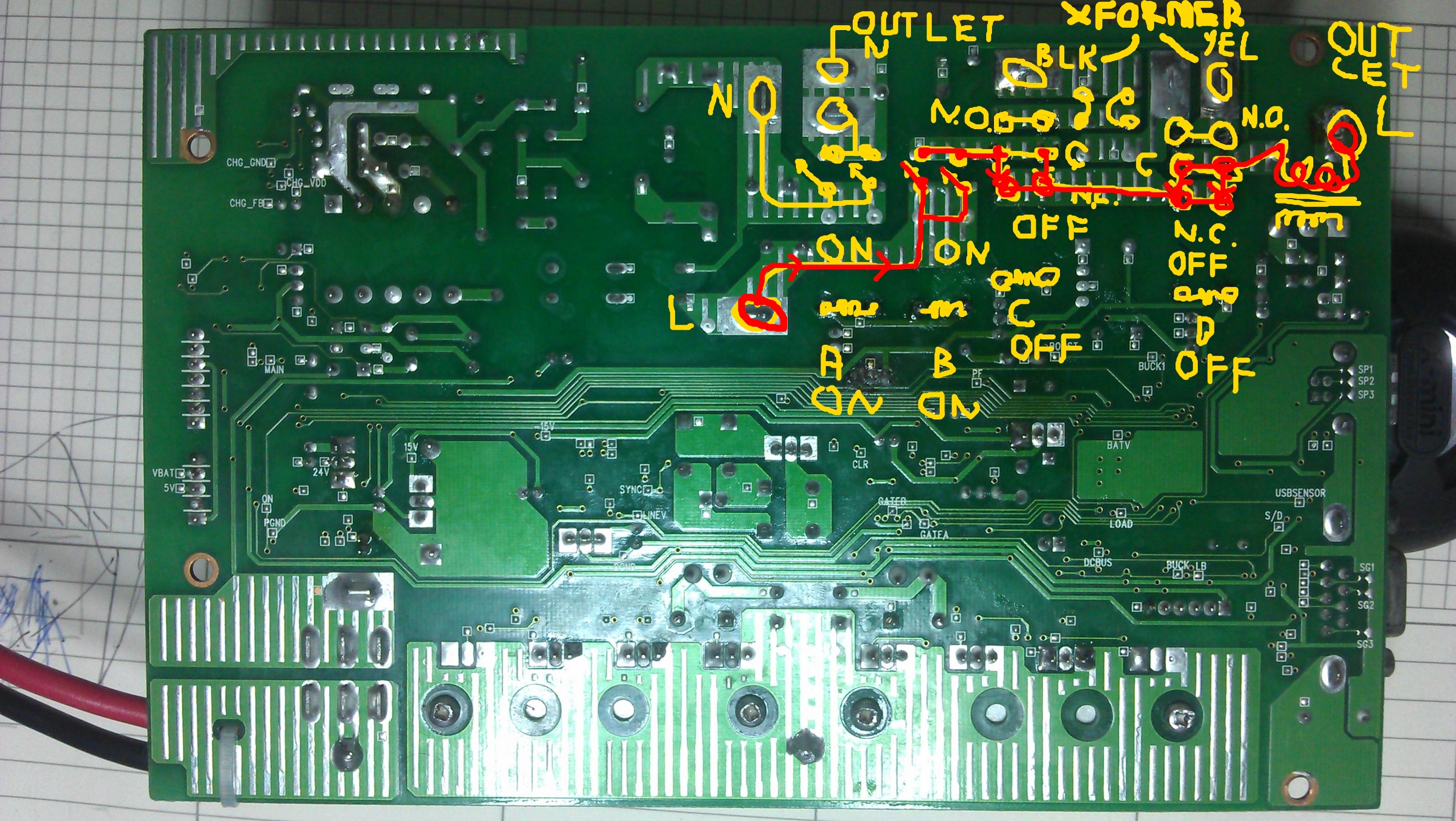

    I have CyberPower Value 2200E-B UPS which is not bypassing AC input to load.
    When connected and turned on to AC 230V it does not show any error, it passes self test and on display it's shown input & output voltage, batt capacity and load - everything as it should be. Problem is that there is no output voltage (0V!) on any socket (only when connected to AC 220V!) However, when switched to battery power (eg power failure) UPS works normally, it switches to battery and output voltage is stable 220V.
    I've tested all relays and they are OK, (voltage on their coils are 0V when UPS is on AC power). Charging of the battery works.
    Any ideas or schematic would be appreciated.

        Re: Cyber Power 2200E not switching to AC power (0V output)
        Have to trace the wires from the outlets back to board to see which relays are used for bypassing the UPS when not in batteries mode, the complicate part will be that I believe that this UPS also has AVR (Automatic Voltage regulator using transformer tap switching) to maintain the AC output and will kick into UPS mode when it is out of regulation range or when it detects the lost of the incoming AC.
        Is this the one you have?

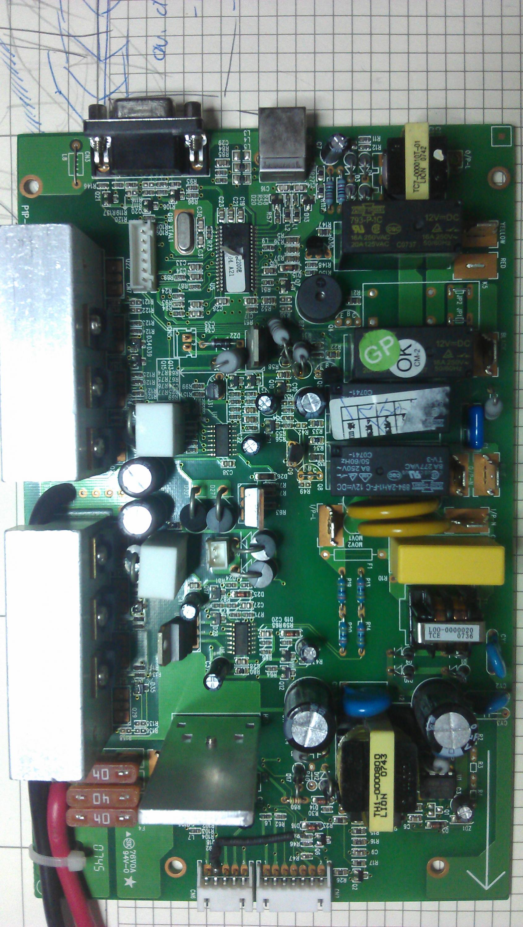

          Is it just me or does there appear to be some scorch marks around the components between transistor Q5 and the buzzer? (BZ1)
          I'd guess that transistor is used to switch the relay next to it - might be somewhere to start?
            I cannot tell from the pictures.
              Thank you for helping me guys.
              @budm
              yes that's the correct UPS and it has AVR function. Relays you were looking are lower two (NOT the two around the buzzer).
              @Elysarian
              There is no scorch, but some solder flux traces -that part was repaired i can see it how two resistors and diode nearby are soldered together (note that ups was repaired earlier, before i got it. Don't have any info why and was it working after)
              I think that relays are driven by transistors MPSA42 (to-90) which are near relays

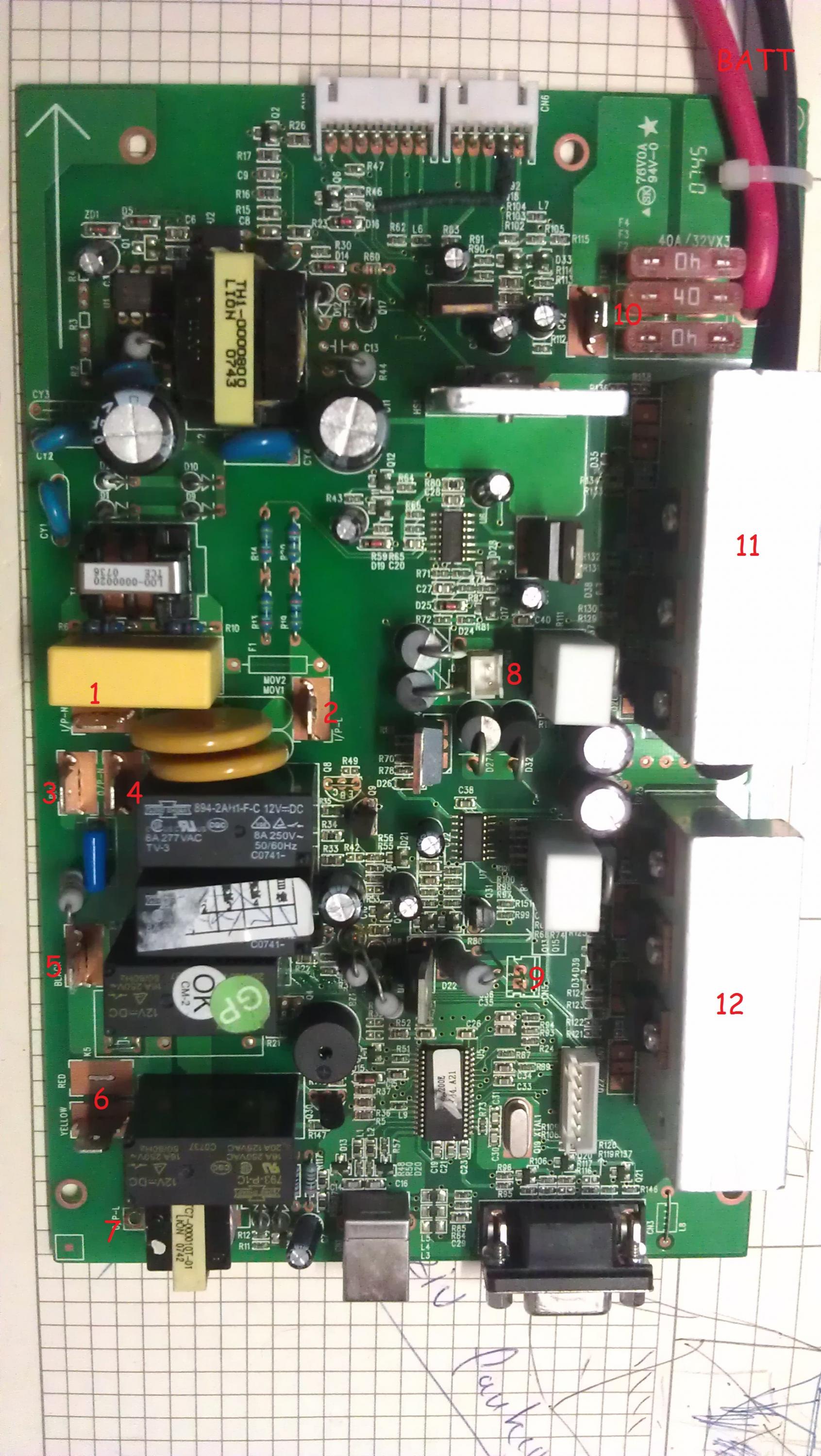

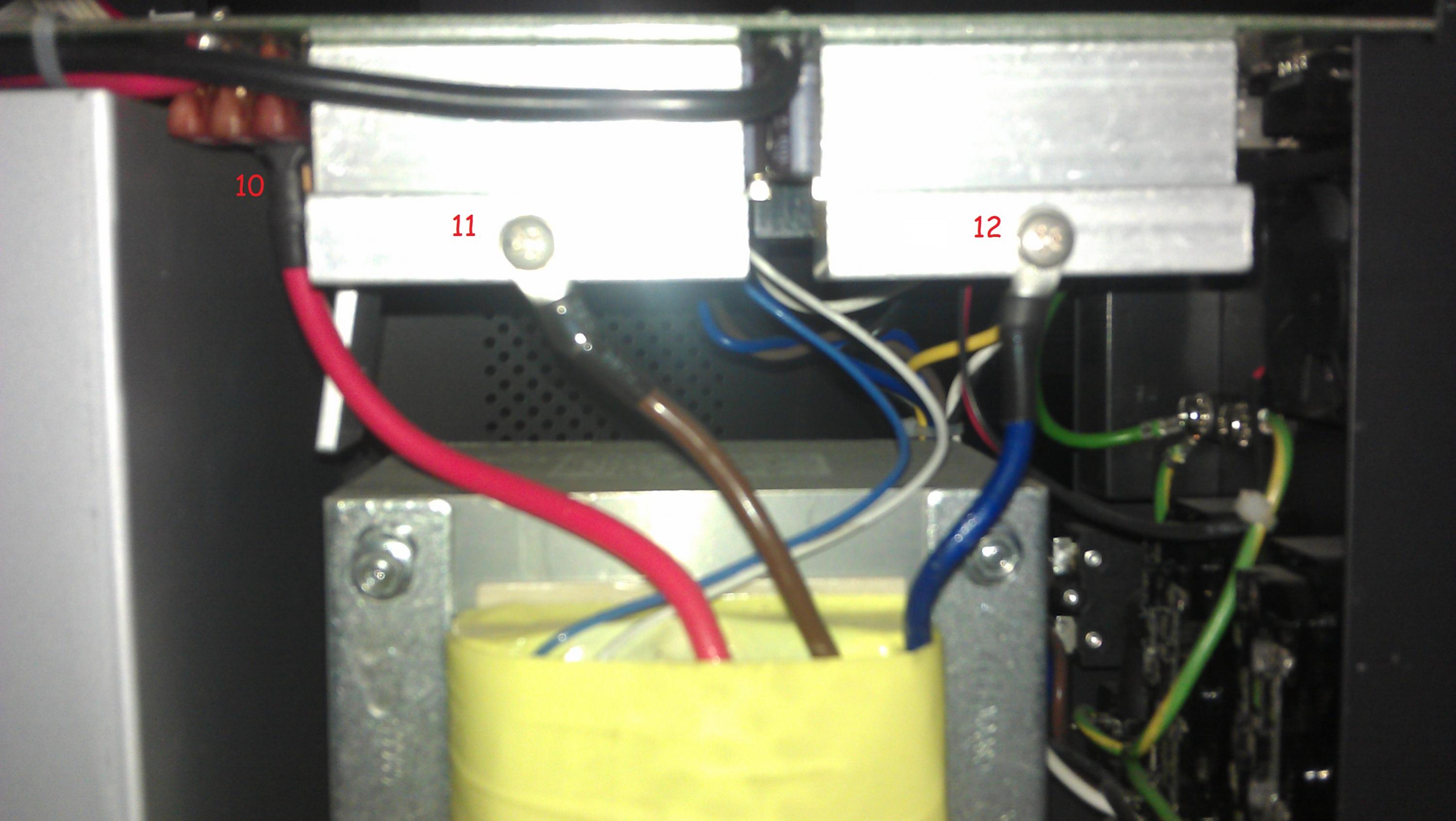

                    So here are pics of transformer and wiring:
                    Wiring goes like this;
                    1 - blue, from the AC input
                    2 - brown, from AC input
                    3 - blue, (thin) from transformer primary
                    4 - white, to output sockets
                    5 - black, from transformer primary
                    6 - yellow, from transformer primary
                    7 - black, to output sockets (for soldering on the board)
                    8 - blue/white wires (on conn) from transformer secondary
                    9 - fan
                    10 - red, (thick) from transformer secondary
                    11 - brown (thick), from transformer secondary
                    12 - blue (thick), from transformer secondary
                    13 - those two thick wires from board goes to the battery
                    Does anyone have a better clue now what could be wrong here and where to start?

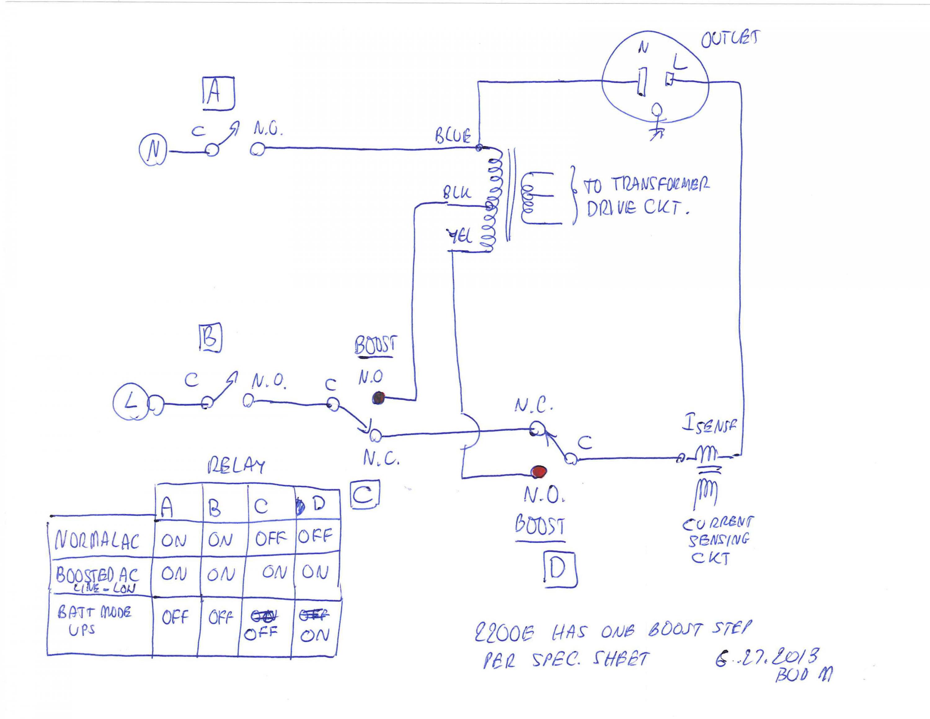

                      OK, this is what I come up with:
                      When you apply the AC to the unit, the relay A and B should turn on, relay B and C can be off if the AVR does not kick in, the out will either get the power directly from the L through normally closed contacts of relay C and D or it may select the output form the transformer Black wire if C is ON, or from Yellow wire of the transformer if D is ON. I do not know which one of the transformer wires are for Buck and Boost winding. But as you can see how the L (HOT) get connected to he outlet L.
                        Here is the relay's switching diagram.
