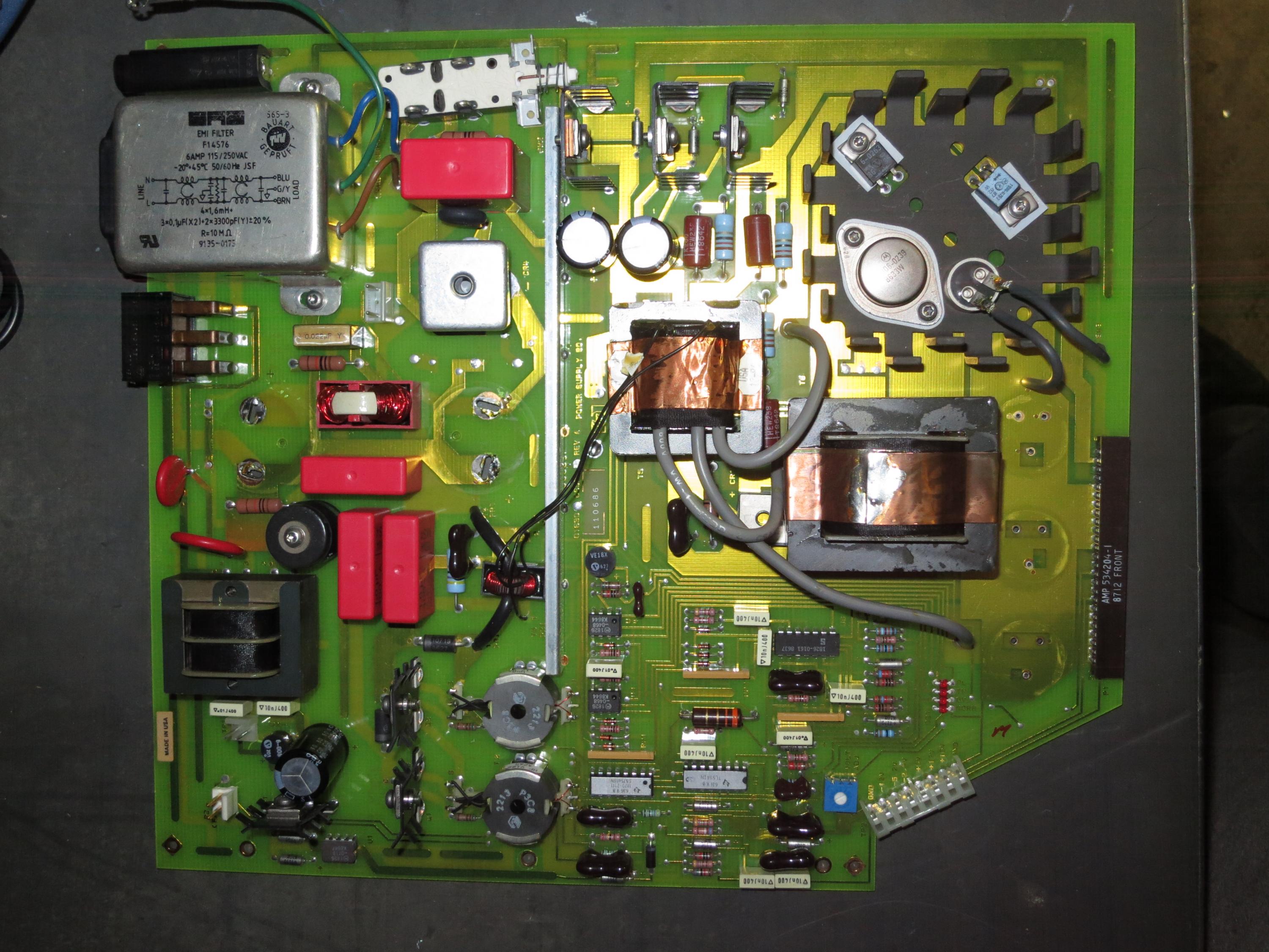

          So - I went and had a chat with the 'scope - it's a HP 54200A (a detail I'd managed to forget previously), and snapped a couple photos of the power supply board. I'm not sure how high a resolution that badcaps will let me post, but, for reference the PWM looks to be a TL594IN.

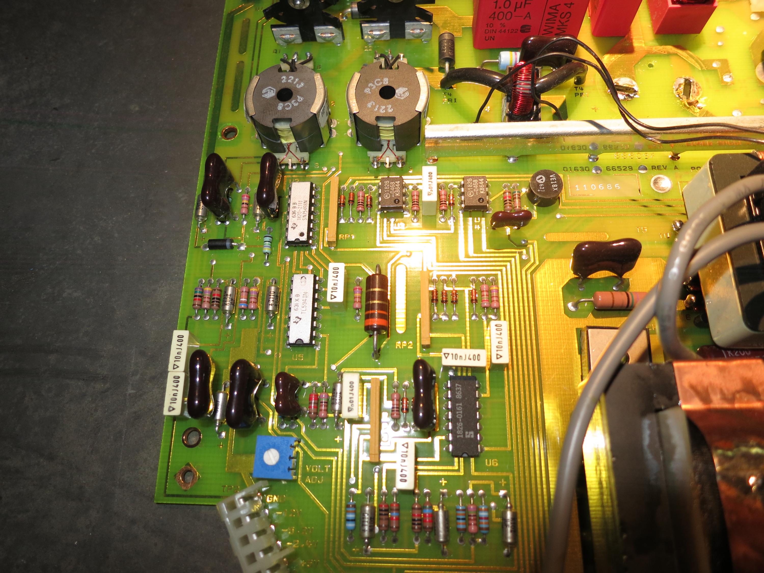

          I don't quite grasp how they're using the overvoltage sensors (Motorola 1826-0468s that appear to cross-reference to MC3423P1 ) as over-current sensors for the switching xformer. There's no proper voltage divider, and there's a 10K resistor in series with the 1826-0468 input - seems quite a lot of opportunity for drift to muck up whatever calibration was intended there, though that's probably just my naiveté showing...
          Let's see if I can make a couple pictures stick -- the whole board, and the PWM and control corner...

            Holy cow! That thing's from the mid-80s! That OV crowbar chip was made by Signetics. I noticed a small round bridge rectifier made by Varo. Those pot cores are Ferroxcube 3C8 ferrite. Varo is long gone, and Signetics and Ferroxcube were bought by Phillips back in the late 80s or early 90s; Ferroxcube now looks to be a division of Yageo. Maybe the crowbar chip is tripping, triggering the OC protection which is a different part.

              Ain't she a beauty? Who has the real estate to lay out a board like that anymore?

                        Re: Help me get started on a middle-aged HP 'scope power supply?
                        Since T5 is the main transformer (the Primary is driven by Q1. Q2) that produce 5 output voltages, if any one of the 5 is shorted out, it will shutdown the circuit.
                        -2.4 is produce by CR19 Dual Diode with Common Cathode.
                        The Primary current sensing is done by T4 current sensing transformer.
                        Pin3 of U5 is fed by OR GATE Diodes (CR16, CR17, CR9, and CR8) setup, if pin 3 goes HI it U5 will go into shutdown.
                        CR16 is for -2.4V Isense
                        CR17 is for +5V Isense
                        CR9 is for Primary Isense
                        CR8 is for Thermal sense.
                        If any one of the Anode of those Diode goes HI, that will trip the shutdown.
                        There are two more internal 2 or Diode in the U5 that also feed pin3.
                        So you need to monitor which one of the OR Gate Diode on the Anode side has gone HI to trip the shutdown.
                        I see alot of 1uF caps around that circuits which usually lost its value when it get old. I would check them out closely since they are used for filter around the inputs of U5.
                        U5 shutdowns by stopping the drive to the Q1, Q2.
                        The output of the MC3423 just goes HI when overcurrent is sensed, the output is not used for driving the SCR which will latch on until the DC voltage is removed, but the scope is not using that SCR Crowbar setup.

                                Actually, I just noticed on your picture of the board, there are no high voltage filter capacitors for the power supply input! I see spaces where they would go too. There are missing ones on the output side too. That could be the problem...
                                      No, no, those are out because I had them out for testing. They're all quite happy and back where they belong now.
                                      Will
                                        If it false triggering, that can be due to poor filtering of noise or spike in the sensing circuits.
