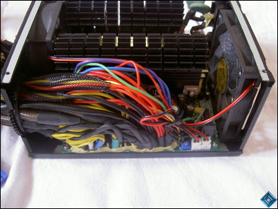

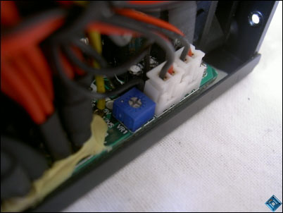

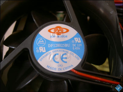

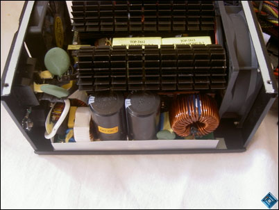

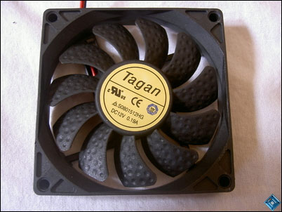

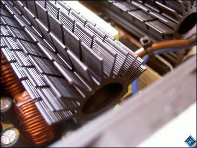

      some pics

        Yeah these units look and perform alot better then some of Top Powers other offerings, I am considering buying one.

          I see sometimes old "TOP MOTOR" fans - clear plastic ones on Socket 7 CPUs - many of them are still working fine.

            Dynaeon is pretty huge. Used to be ODM for AMD retail box CPU's. That's why you saw so many of them way back when.

              Actually these new Tagans have independant regulation much like the OCZ models, I wish you could get your hands on one and do some testing for us. The review that CAD4466HK took those pics from tested that 1100w unit and all the rails seemed extreamly stable but I am sure you could test it much more indepth.
