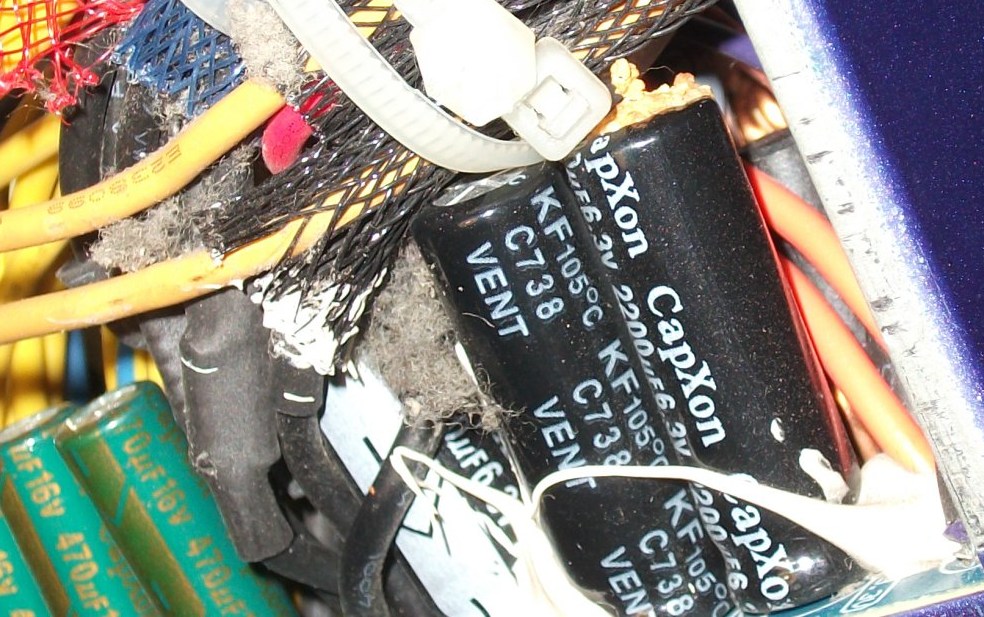

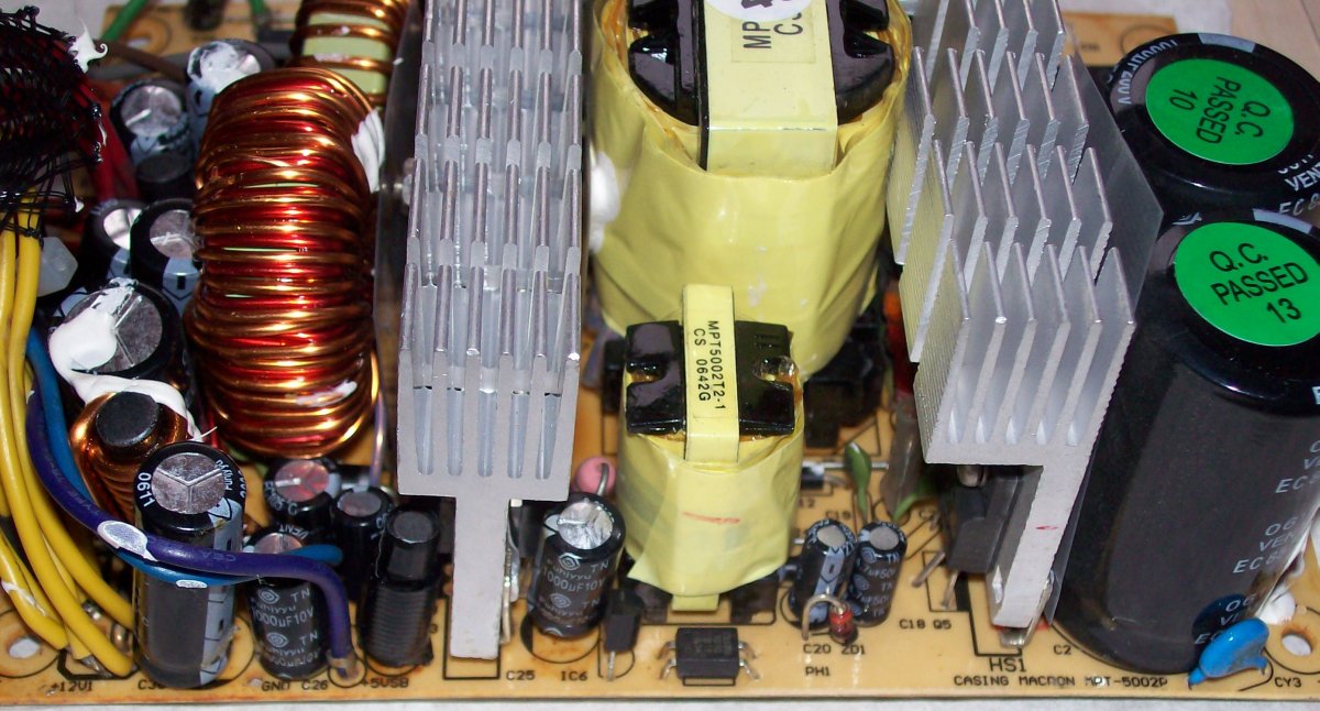

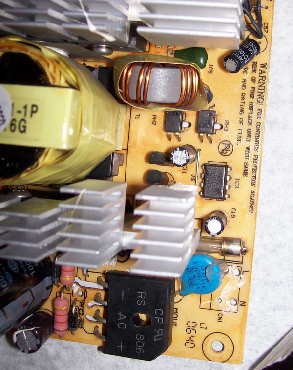

    I opened all the units up for visual inspection. All except the Chieftec has buldging caps. I'm affraid some of the fortons may even have bad primary caps.

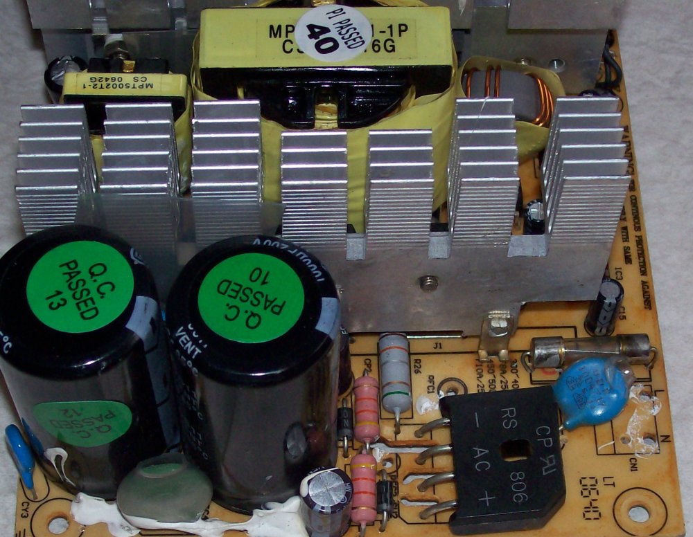

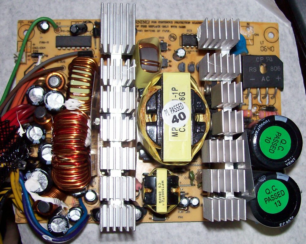

    I decided to start with the Macron, I haven't meet the insides of this psu so far.
    Standby voltage is 3.4V closing pson ground: unit doesnt start.
    Passive pfc
    8A Greetz

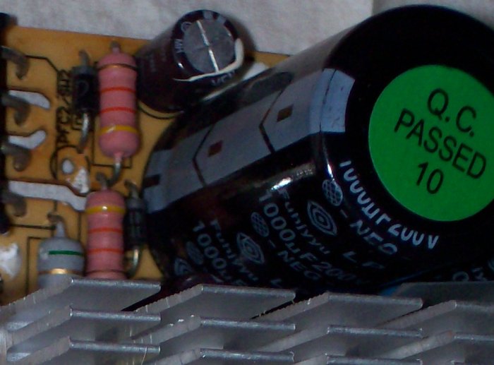

    2x1000uF 200V primary capacitors
    2 x 2sc2765 fets, 3843pwm
    5N60G standby fet, driven by a some sot-23 pwm
    ...Fuhjyyu caps everywhere.
    WT7525 supervisor
    smd 339

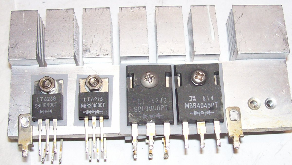

    1040CT for standby
    2 x 20100 for 12V; 2 x 3040 for 5V; 4045 for 3.3V schottkies

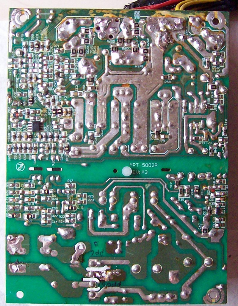

    Fuse, transistors and diodes test good. I replaced all capacitors except the primaries, measured 950- 960uF on them...
    Still no go. The fan doesn't even twitch, only standby voltage is present. I'm going to look for shorts and measure supervisor and other ic tomorrow.

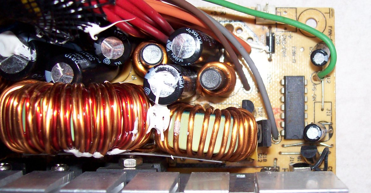

        First clue: 5Vsb is nowhere near 5V - start your investigations there.
        Prime suspect: those two small cap in the 5Vsb circuit, between those two (nearly) upright diodes. Replace those with some brand-name trustable ones, and see if it works right after that.

          There's also that stupid voltage boosting circuit on the primary (the 2 small electrolytic caps next to the primary caps, along with the 2 diodes next to them). Not that that's the cause of the problem, but if you do end up fixing the Macron, you should remove/disable that circuit - it generates a lot of heat and really servers no practical purpose.

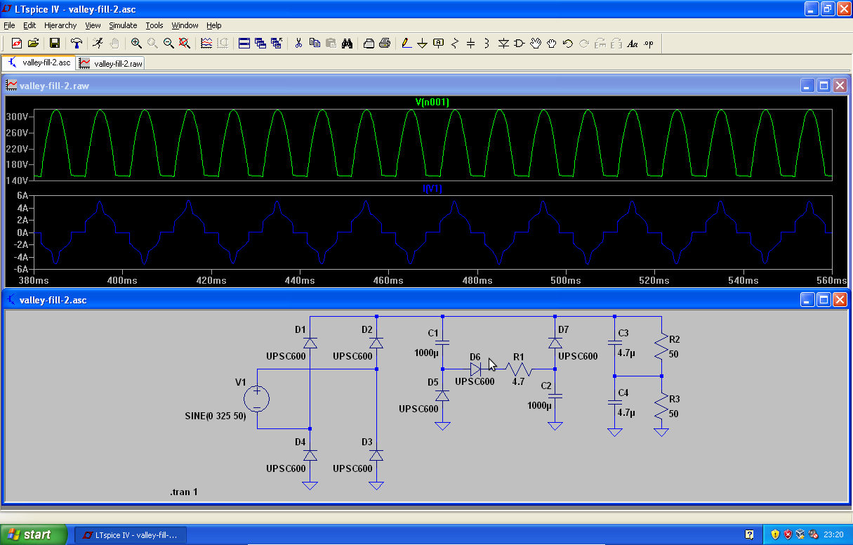

              Re: Half dozen psu repair challenge
              That circuit reduces efficiency... it increases power factor. It's a valley-fill circuit. Disadvantage is ripple is about 50% of line voltage (stretches transformer design) but PF is about 0.8~0.9 ideally.

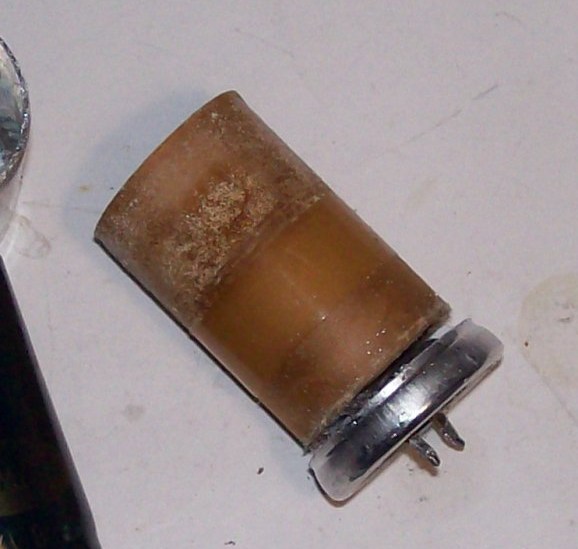

                Ah, yes I have replaced all the small lytic caps too. Standby got back to normal right after I replaced the caps.
                The pfc voltage doubler circuit is gone. I removed it before I reassambled the psu. Interestingly the pcb wasn't fried there at all.
                Only standby voltage is present, it won't start.

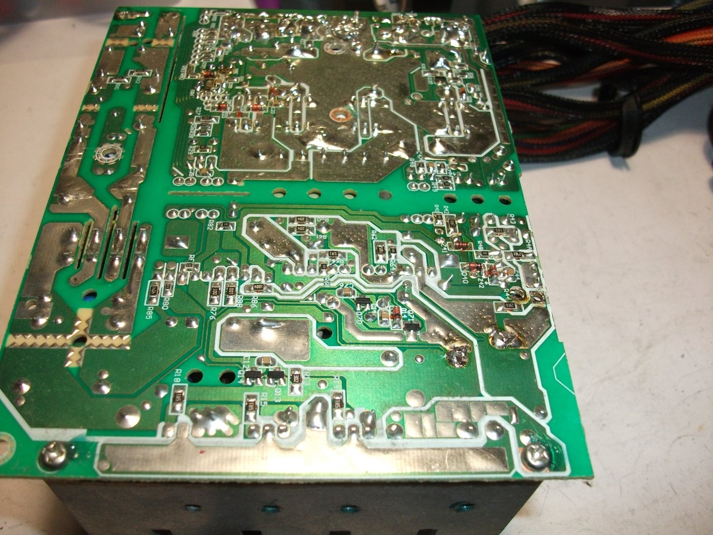

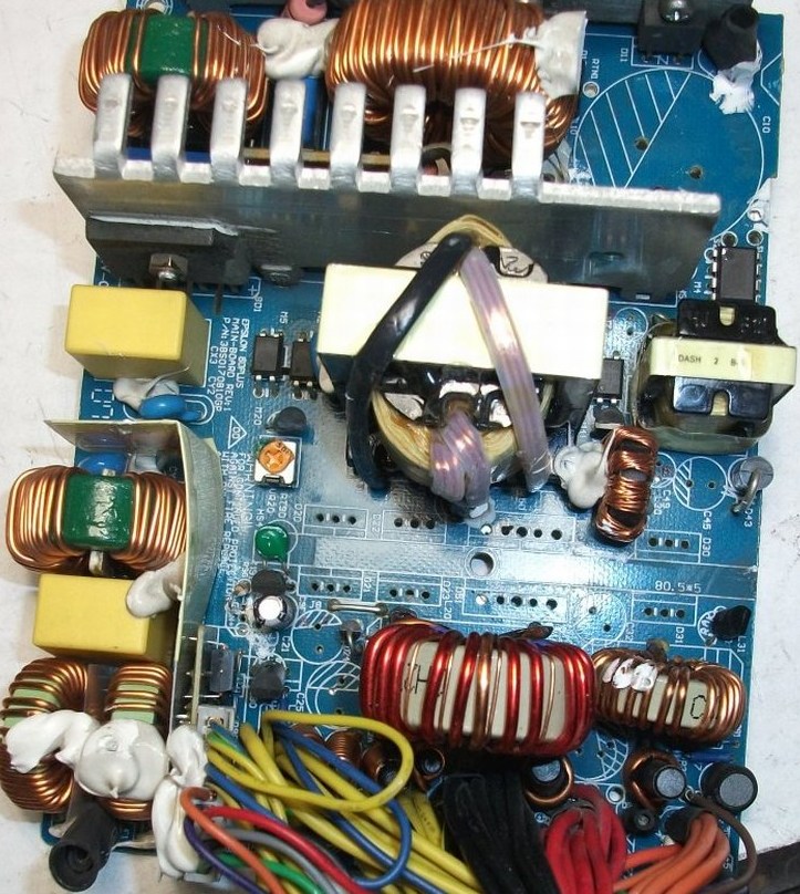

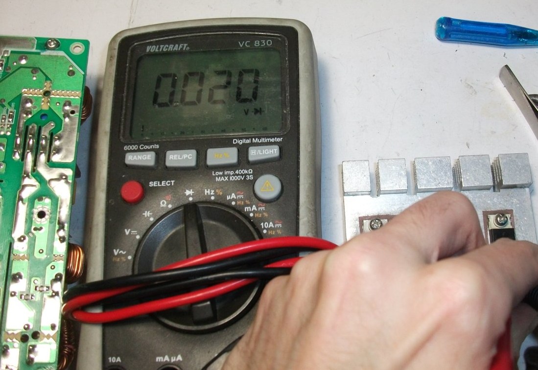

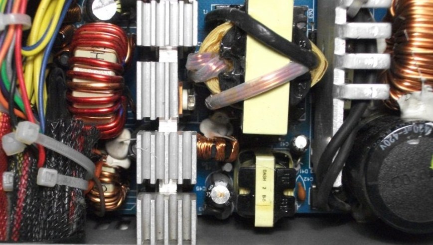

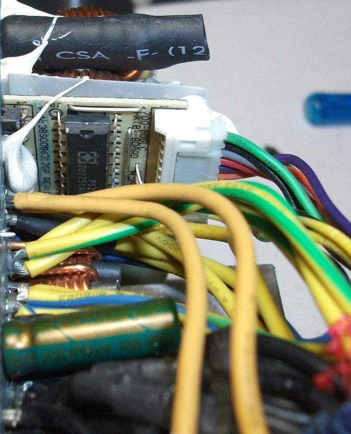

                Also here are some shots of the 600W Forton. Turning on the unit it's buzzing and gives 1,5-3V standby. I took it apart and I keep finding bad components. Glimm lamp isn't lit when AC is applied, it has popped at some point. Capxon everywhere. The Capxon LP primary cap has 252uF (real parameters: 420uF 420V ) capacity and it looks corroded
                One of the 12V diode is shorted. Just great...
                I hope the other fsp units aren't like this.
                      Originally posted by Wester547
                      Wouldn't 50% of the line voltage be a good thing, if you mean 50/60Hz ripple as opposed to 100Hz/120Hz ripple (unless you mean something else, like 25/30Hz ripple with half wave rectification and 50/60Hz ripple with full wave rectification with passive PFC involved)?
                      The main caps get 50% ripple, so around 320-160V (160Vp-p) operating range for the PSU, which means the PSU transformer and controller has to be designed to work over a wide voltage range, which is tricky... The ripple is still at 100Hz. Typical ripple is around 70Vp-p at the point where the control loop begins to struggle and 100Hz becomes dominant on the outputs.
                          It's not half wave rectification. It's full wave rectified.
                          Here's an example of what the valley fill circuit does. Efficiency of this stage is 98.5%, power factor is 0.95 for a 560W load. So it works fairly well, and it's efficient.
                          The resistor is for limiting inrush current, and may be removed and replaced with an inrush NTC on the input; it also helps reduce the THD.
