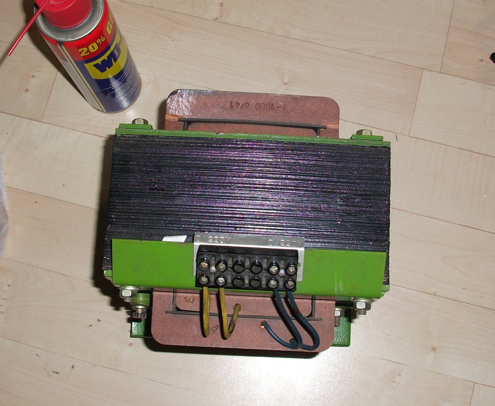

      Sadly I had no time for repairs during weekend since I wasn't at home. Also I took apart my old isolation transformer setup kludged together from two old tv trafos. I want to do the cabling and some sort of housing for this brown-green hulk. I'll continue soon.

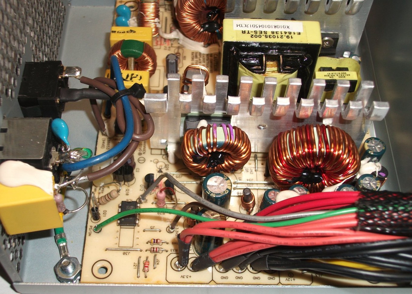

        Re: Half dozen psu repair challenge

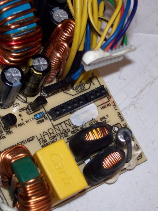

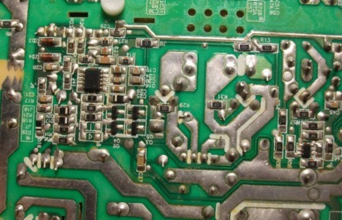

        So I got into it and fixed the two smaller fortons. It wasn't too hard. Most of the Capxon caps on the secondary had to go, supervisors are ok. Voltages are back to normal. Sadly the Epsilon's ps223 seems faulty. Also I modded a forton gln psu to test the supervisor cards a bit faster.

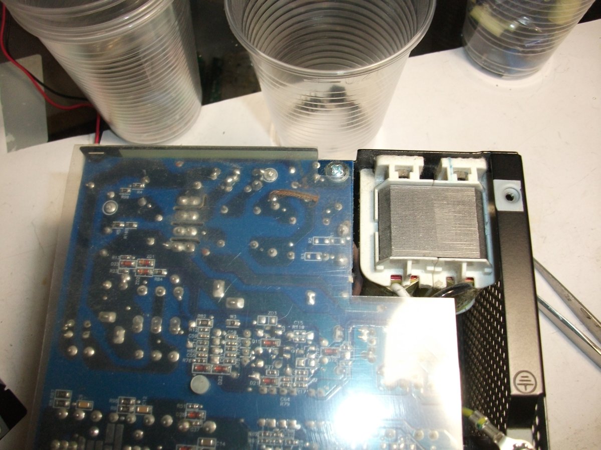

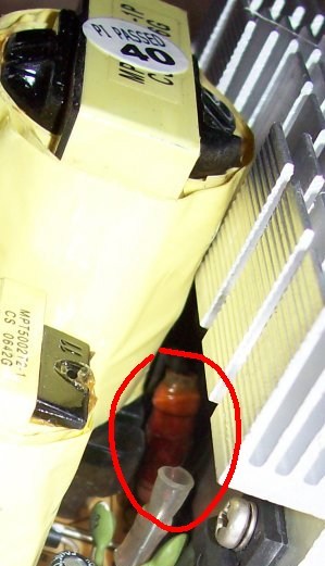

        In the Macron I discovered a resistor wrapped in a toasted crunchy heat shrink. It's between the primary trafos two legs. Color code tells me it's 15 ohm but it measures 17.

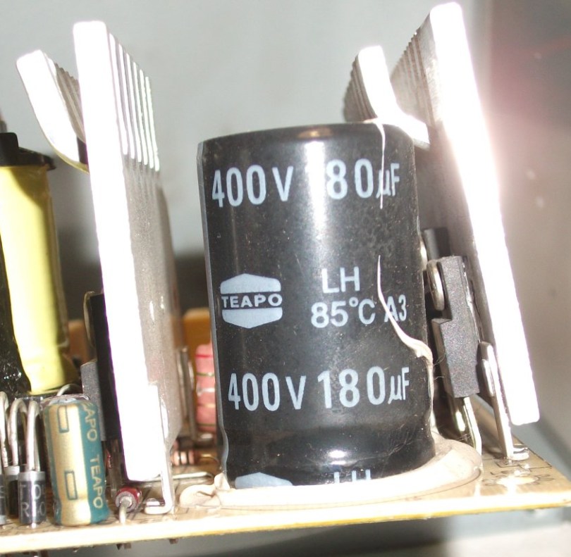

        The chieftec CTG-450 is kind of strange. Isn't the primary 180uF cap a bit small for 450 Watt?
        It had a lot of cold solder joints and the 12V filter caps measured twice the original capacity! It runs now, but the fan spins on max all the time. I checked the thermistor, two transistors, zeners, resistors... tried putting 4.7, 10, 20 Kohm resistor in paralell with the ntc but still no use.
