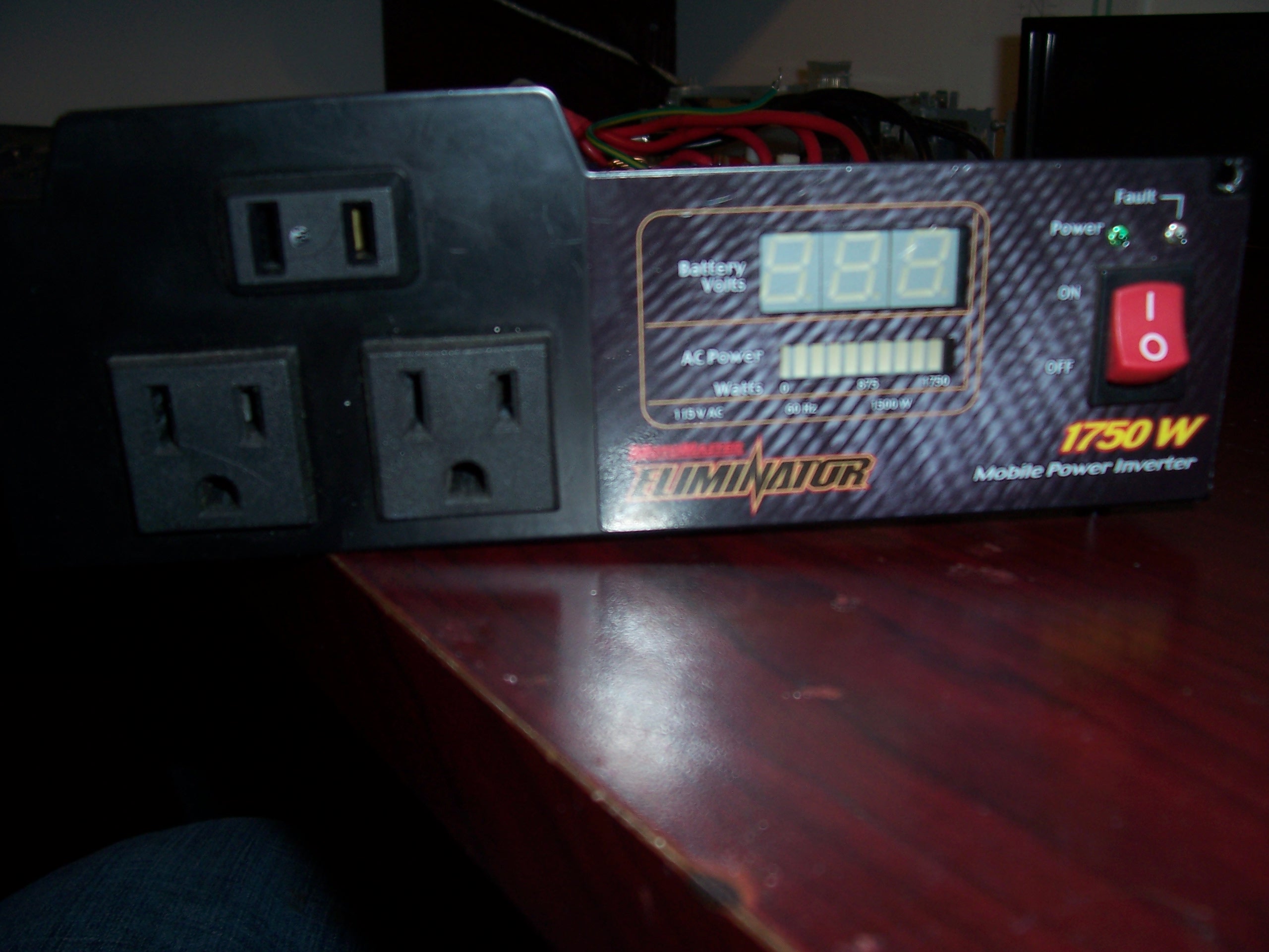

    I found another thread on when googeling my problem, I posted on that website but there hasent been any responses. I have the exact same hardware but a different failure. It looks very similar in design to a car amplifier except just generating a modified square wave all day instead of music driving the outputs.
    About repairing a 1750 watt power inverter
    Mine is the same hardware but I don't seem to have any shorted transistors or diodes bolted to the heat sink. My hardware is identical to all of his pictures I just seem to have a different failure. I have the battery voltage appearing at the display and the red fault light on.

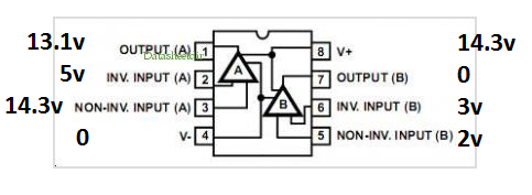

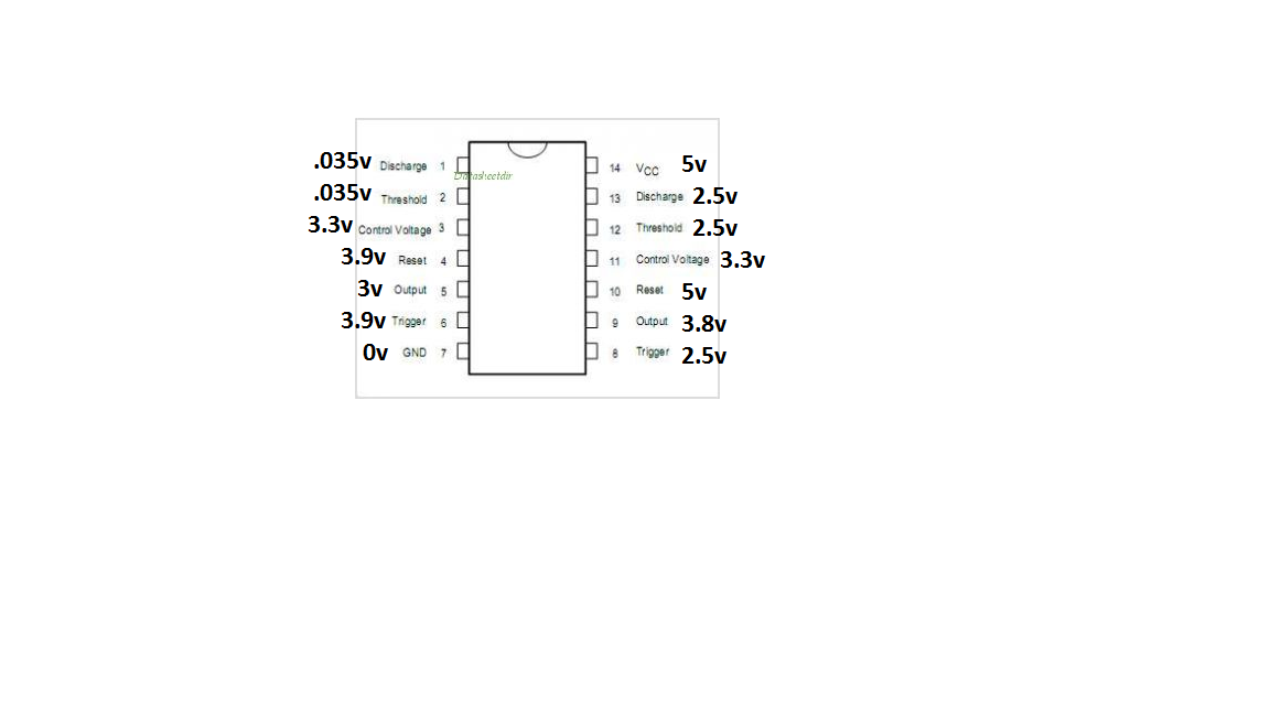

    Symptoms,
    I have no gate voltage to the IRF3205 but I have 15v drain
    I have ground on the source + drain IRF640 and 15v on gate. It seems to be fully on.

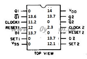

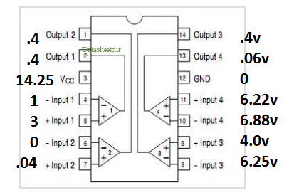

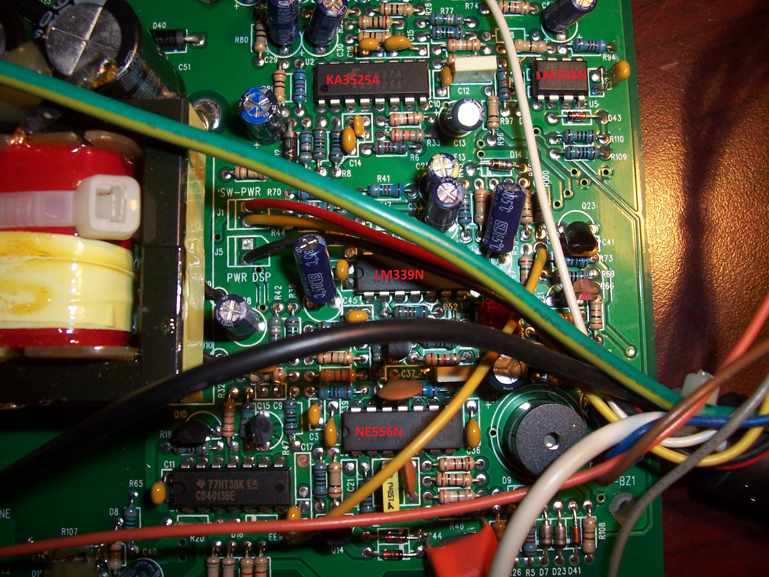

    All the ICs seem to be getting power I posted all of the pin outs from the control part. I am not too sure where to go from here. Any help would really be appreciated. I can post more voltage readings or more pictures if someone is willing to help me through this. I have 3 of these power invereters I keep buying and blowing up they all have the same symptoms with no burnt internal components and just the red fault light on. I would really like to know how to service these things because I need them for work and they are expensive. I am shocked to see how similar they are to car amplifiers. I have all of the outputs and power supply FETs left over from other amp repairs I have done. so most of the parts I have already laying around.
    1.) CDE4013BE SMPS Controller
    2.) KA3525A
    3.) LM339N Comparator
    4.) LM358N
    5.) NE556N Timer

    The KA3525A is the SMPS controller.
    You say the IRF640 is turned on? It's D-S voltage is 200v - I am guessing that it is in the DC-AC inverter section. Is there any ~170v rail anywhere? If you cant find it, try looking for high voltage capacitors (I.E. 200v, electrolytic). If the DC-DC converter is working, then the problem is in the DC-AC converter section.

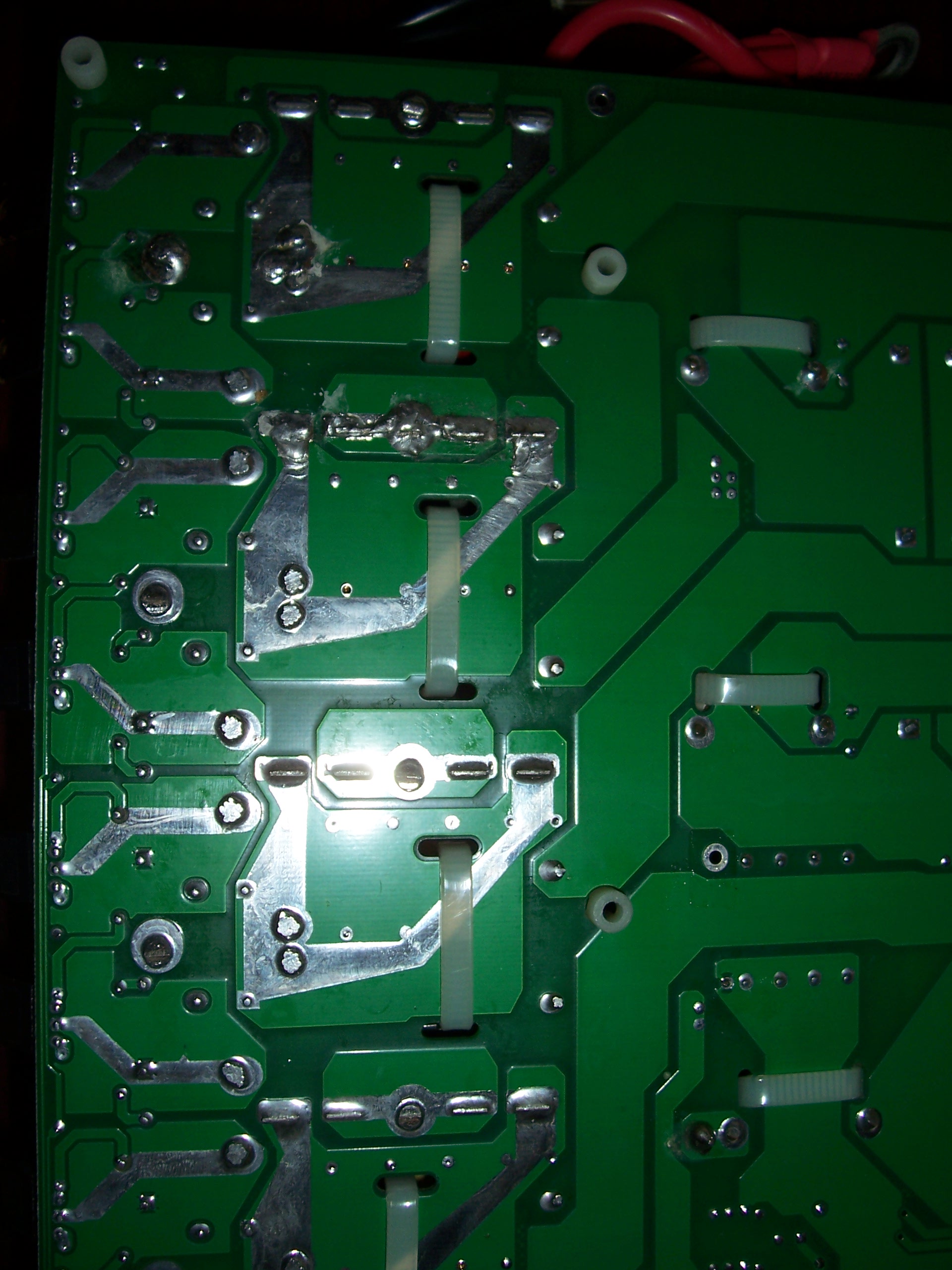

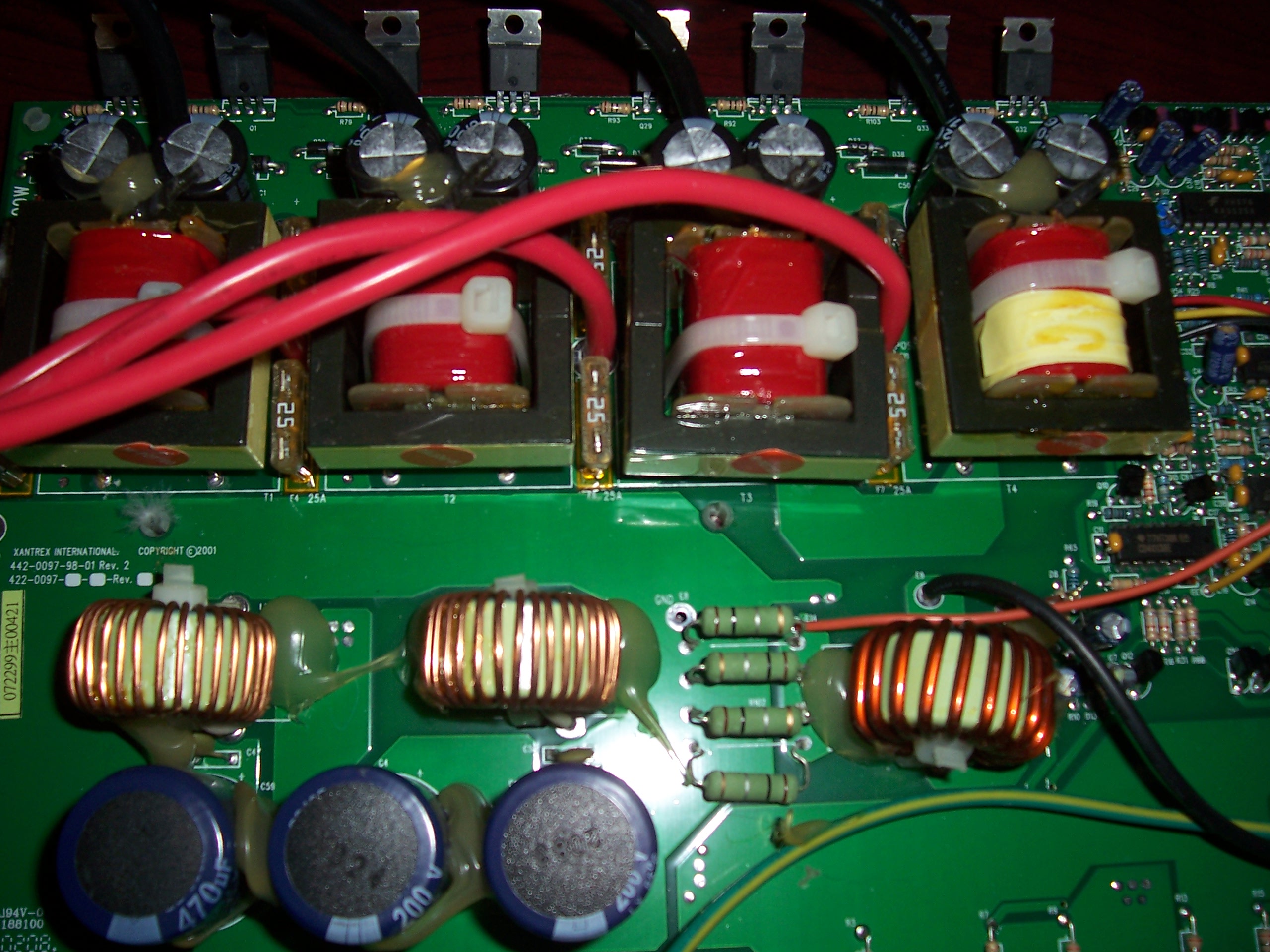

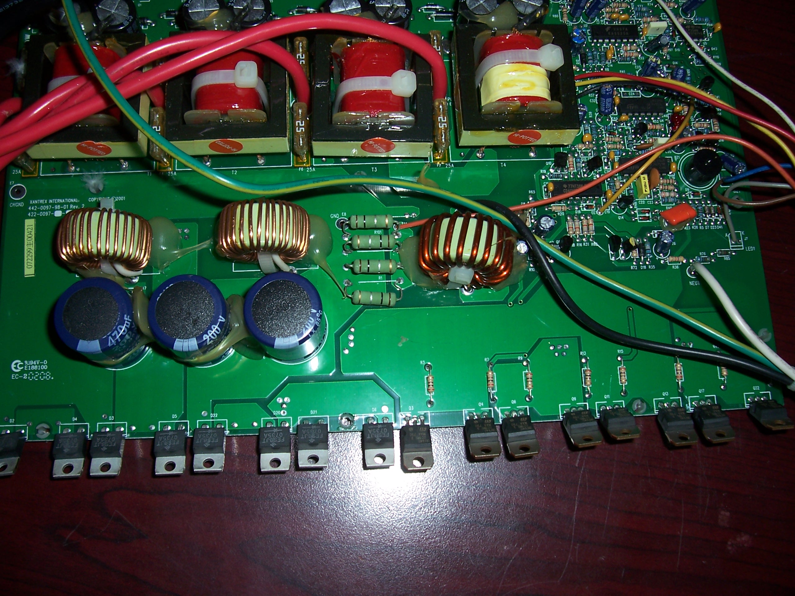

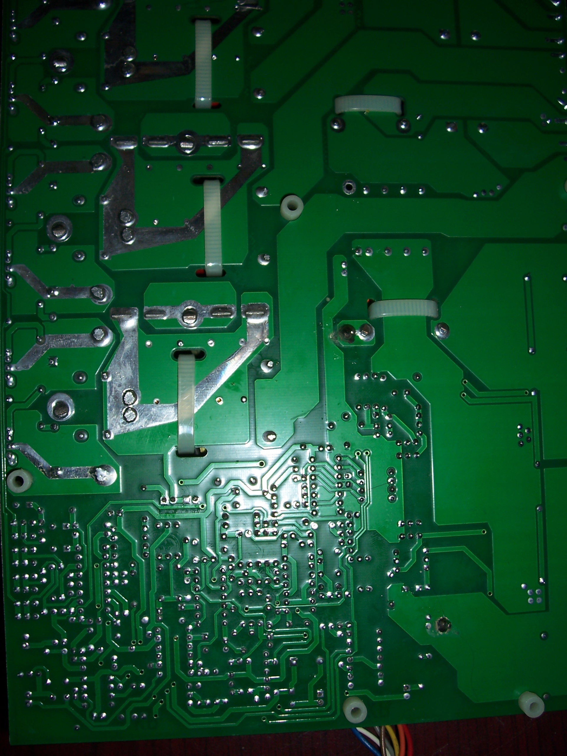

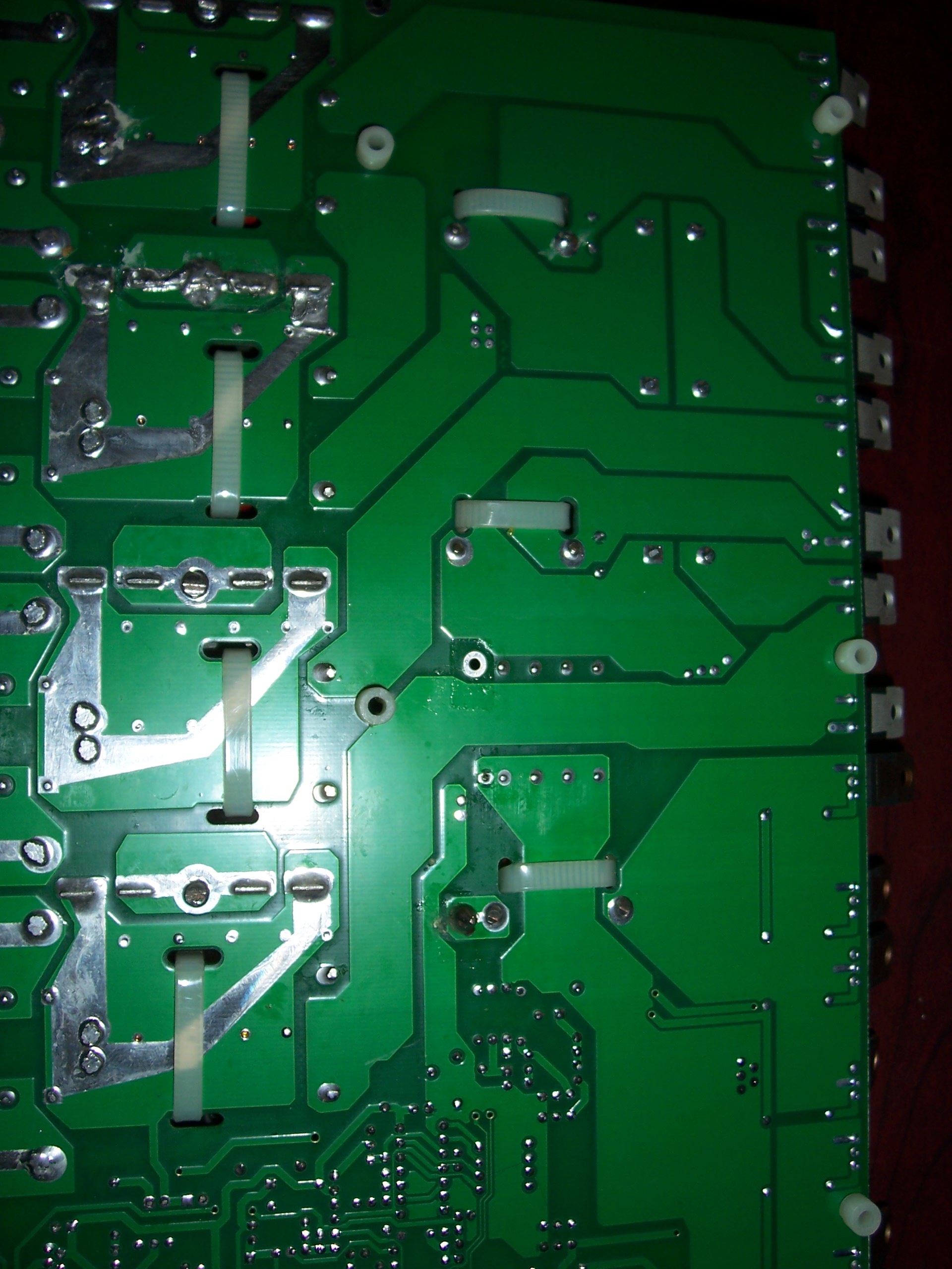

        Could we have some larger shots of the WHOLE board?
        And some shots of the back of the PCB. Thanks!
        Car amps have transformers in them too, they are used to boost the voltage. Those usually are round doughnut types. These are just the regular 'E' types. Both operate on a high frequency, so they are ferrite cores (iron cores don't work well at high frequencies).
        Are any of the FES8JT's shorted or open-circuit? They are high voltage diodes, and they'll rectify the high voltage output from the transformer(s).

                        Re: Power Inverter for a Car (Diagnose + Repair)

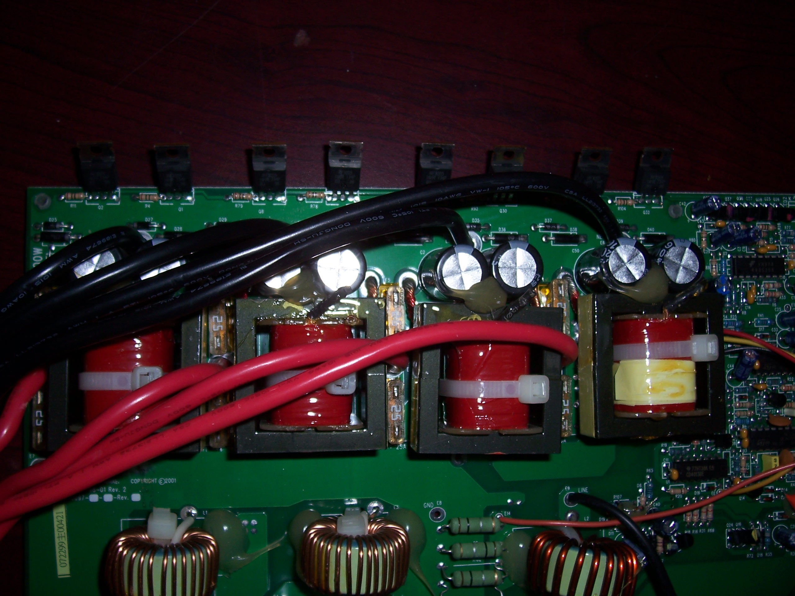

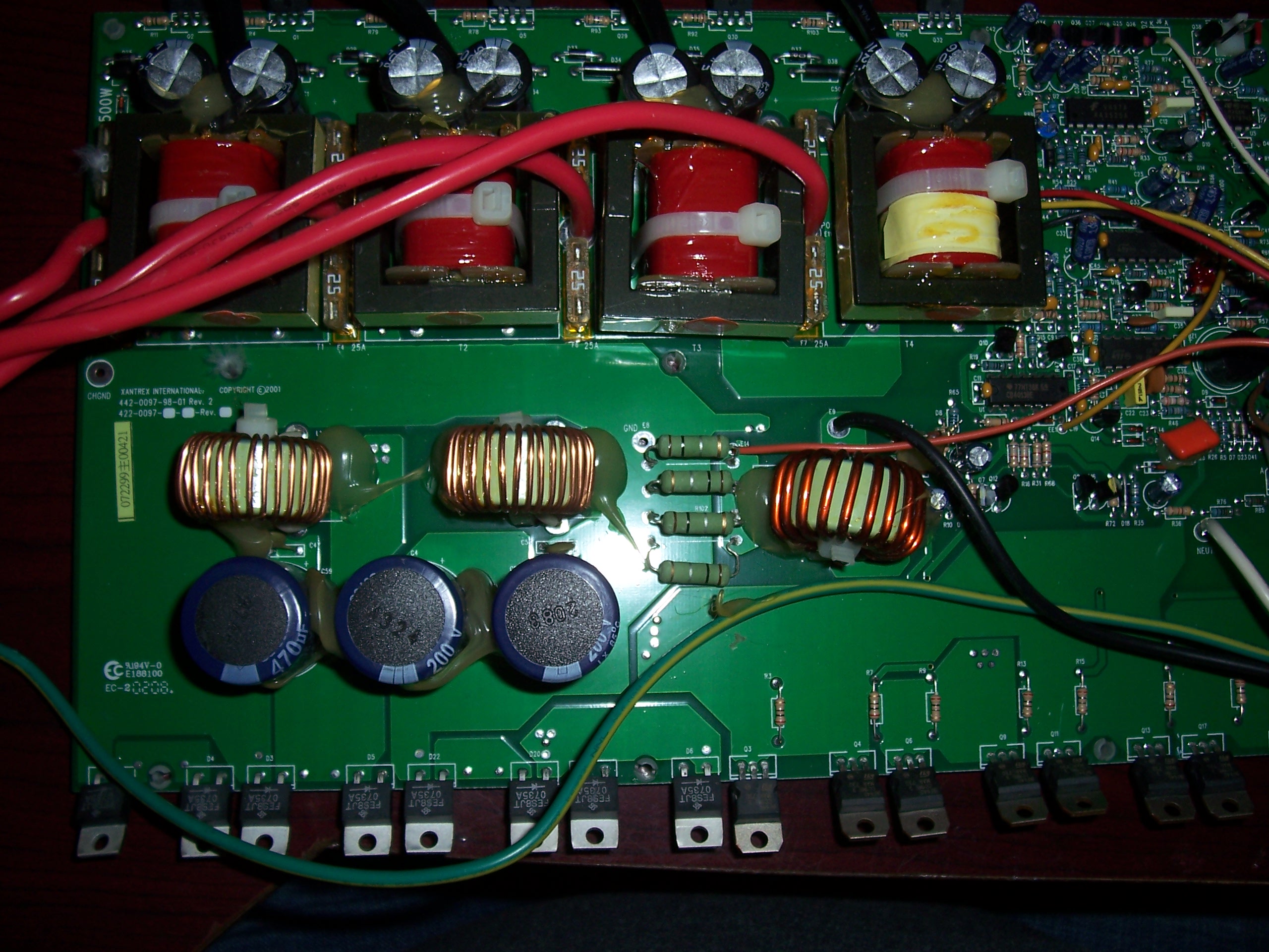

                        I couldn't find a schematic, but you can see they have split it up into 4 smaller push-pull stages, then they combine the output. Hence 8 fuses/ 4 pairs of mosfets/4 pairs of rectifier diodes/4 transformers, so each stage is 1750/4 or 438W.
                        The (rectifier) outputs are then paralleled to create the 170VDC bus voltage on the big blue capacitors. This 170VDC is then commutated by the IRF640's (Q3,4,6,9,11,13,17) to make a pseudo-sine wave. This also looks paralleled, in pairs to make up the H-bridge.
                        Check the Gate-Source resistance on all the mosfets, looking for shorted ones. If none of the eight 25A fuses are blown, then assume the primary side mosfets are ok.
                        That leaves the IRF640's which frequently fail.
                        I see a black arc spot on the underbelly of... L2? so that would definitely damage things.
                        I don't see any bleeder resistors so be careful, those blue caps (470uF 250V) can hold a charge. You should jumper with a power resistor to discharge them.

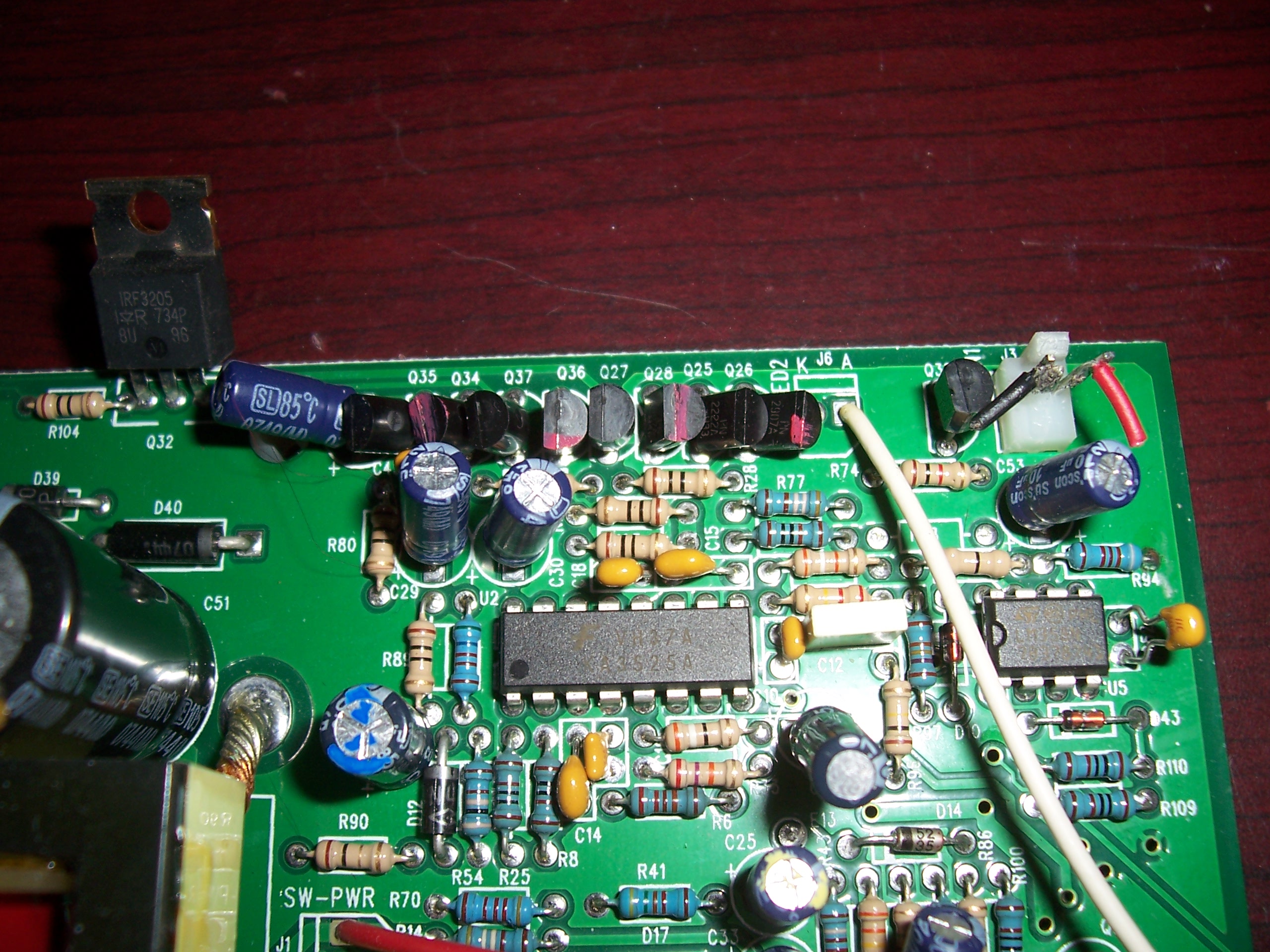

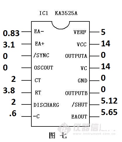

                          The PIN-10 of the KA3525A is the shutdown pin. The pin is at 5v according to your measurments. The threshold voltage for the shutdown pin is about 1.3v - above the voltage, the shutdown is activated.

                            i have no shorts in the IRF640s the lowest number i can get is 60k Ohms resistance.
                            there is no burn mark around L2 it must just be a shadow or bad picture.
                            should i pull the IRF640s anyways and see if it removes the 5v to pin 10?

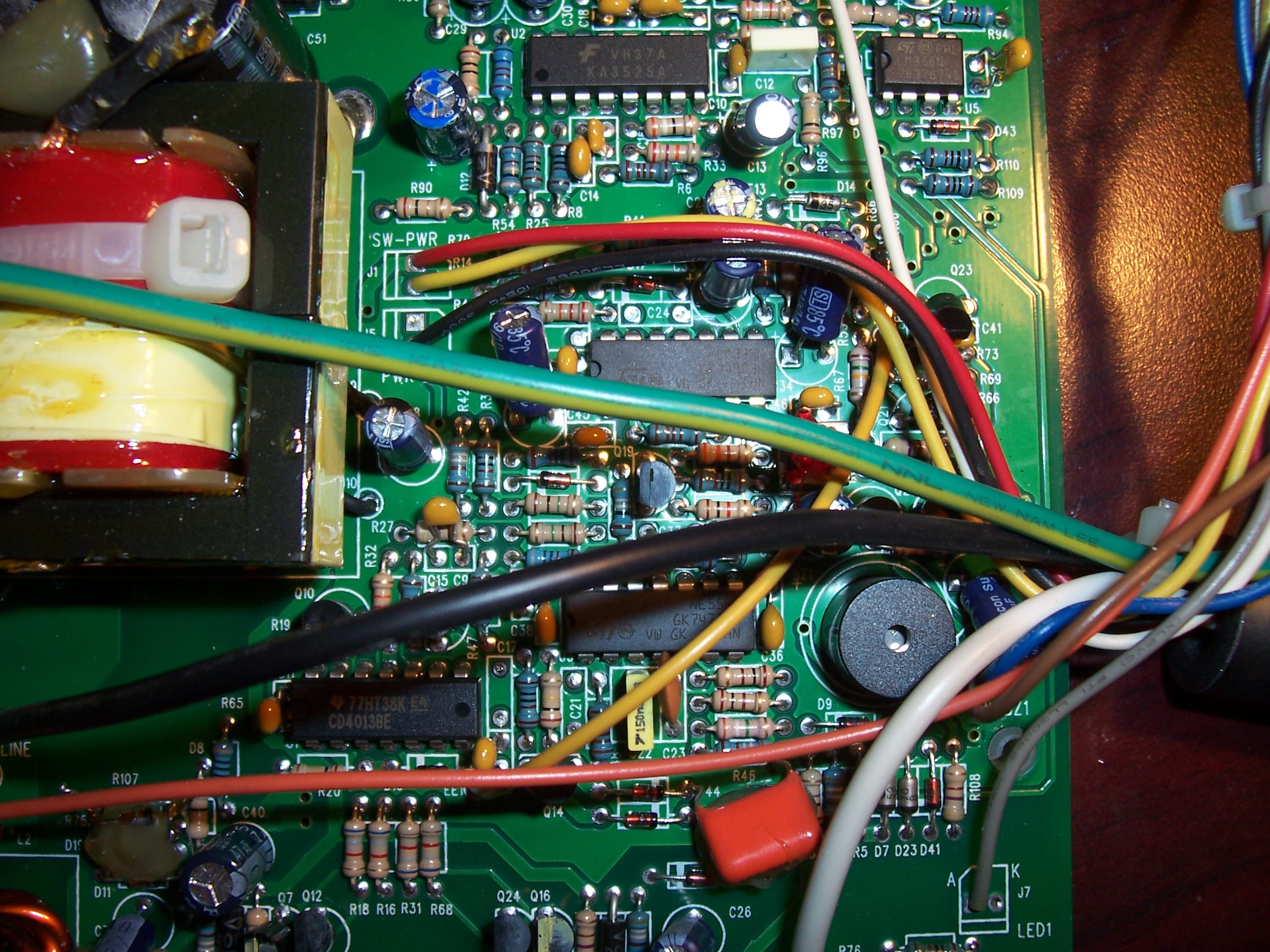

                              Could we get a picture of the row of transistors near the KA3525? What part numbers are they?
                              Muh-soggy-knee
                              • scampo77
                                • Dec 2010
                                • 233
                                sorry for the late response, i am back tho now
                                all the ones with pink marker (Q26, Q28, Q36, Q34) are 1n2907a
                                every other one in between (Q25, Q27, Q37, Q35) is a 1n2222a
                                the oddball off to the side (Q38) is a 1n2222a

                                    they are alll out and no shorts and now on the empty pads i have.....
                                    Gate 7vdc
                                    Drain 150dc
                                    Source is fluctuating from .8v-1.2v
                                    and i still have ~5vdc on pin 10 of the KA3525
