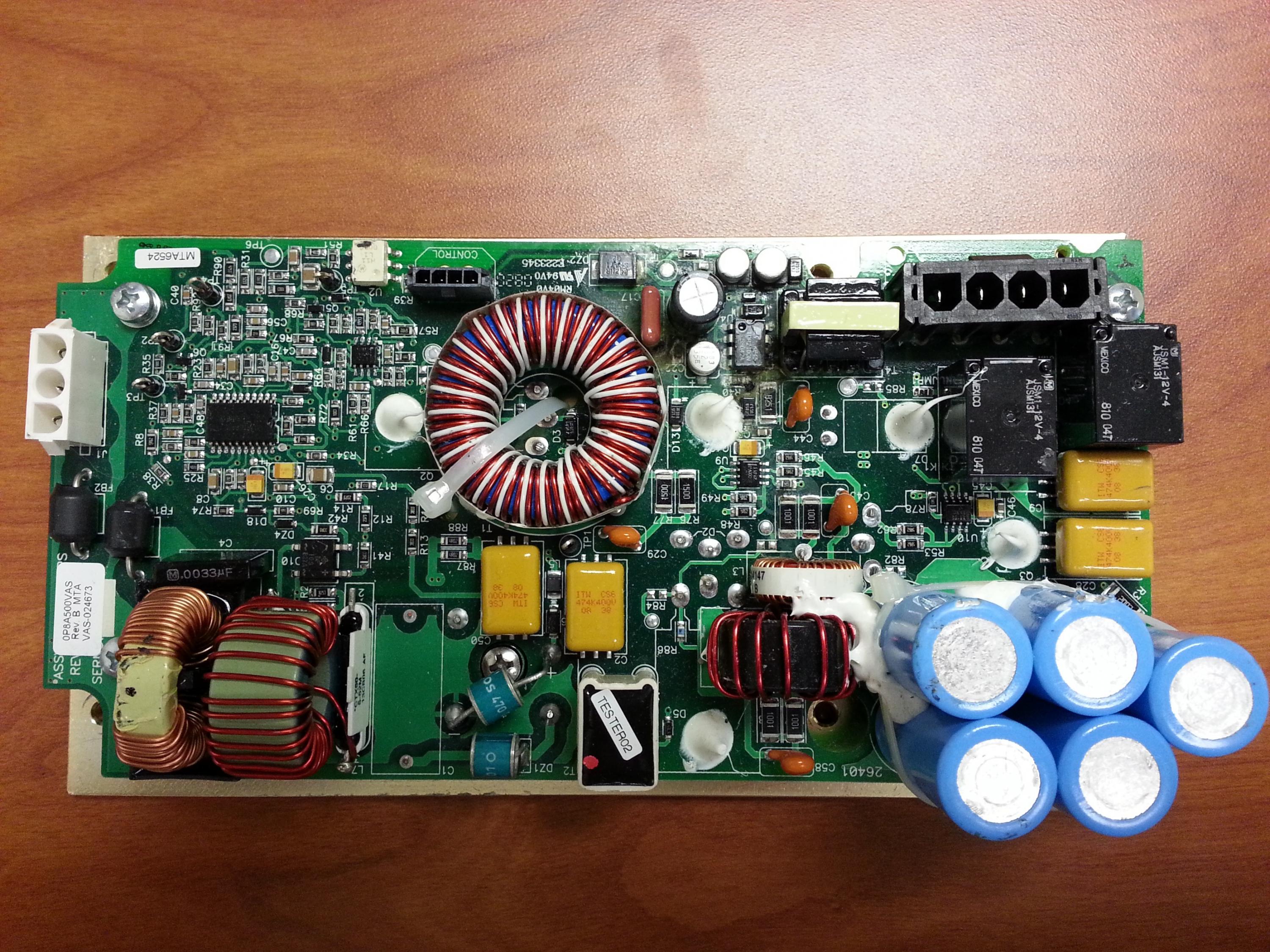

                            Re: Thermo electric pcb power supply
                            Has anyone had an experience with the 500W power supply for the ThermoTek Vascutherm 2? Board has number OP8A500PPS on it. Here is the picture:

                              #34
                              area around the topswitch looks like a spill/cap leak.
                              those surface mount caps may have leaked.
                              edit!
                              zoom in on the area around u4.looks like an arc between pins.

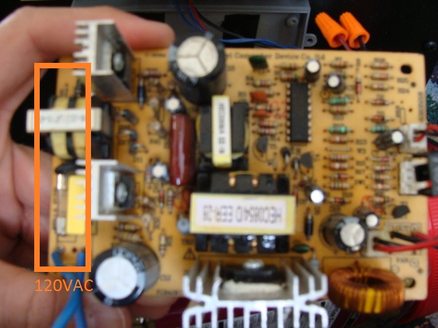

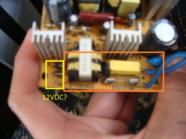

                                Hi, I know this is an old thread but I just joined because I'm trying to convert my thermoelectric fridge to be able to run on 12VDC input and this is the thread I found when searching for info. related to servicing the PSU boards that run these things.
                                I have one of those Chinese boards made by Hanny (part no. S126AM14-5), like the ones found in Haier, Avanti, and Chefmate thermoelectric refrigerators and wine coolers. This particular one was salvaged out of a countertop water dispenser and is being used in a custom 0.7 cf homebuilt top-loading fridge box. If anyone can point me in the right direction, I'm looking for a point to tap in a 12 volt lead. I'm not very well-versed in electronics but I know some of the basics. At what point on this board would I get 12 volts? I'm told it's after the Schottky diode but I see several such diodes. It appears that after the main AC power comes in, it goes to that first transformer which is then followed by two small diodes but my little cheapo meter went on the fritz when I touched it to the leads.

                                  That's not a transformer, just a line filter. Those diodes output rectified line voltage, NOT 12v.
                                    Thanks. That's probably why my meter went kaput! Learning as I go...
                                    I'm guessing the big transformer is where the stepdown takes place, so the diode(s) should be after that, right?
                                      • 31247
                                      #38
                                      i will start by saying your lucky to be n the u.s.
                                      because if you had real mains like Europe / Australia your meter would have done a lot more than gon "kaput".
                                      the mains goes through the filter choke that looks like a transformer.
                                      then it gets rectified into dc.
                                      120v rectified is closer to 190v i think. in Europe it would have been about 370v!!!
                                      that then gets converted into very high frequency pulses and fed into the "real" transformer.
                                      the output voltage is controlled by altering the pulse frequency.
                                      i dont think you should be messing with this if you dont understand the principle of how they operate!
