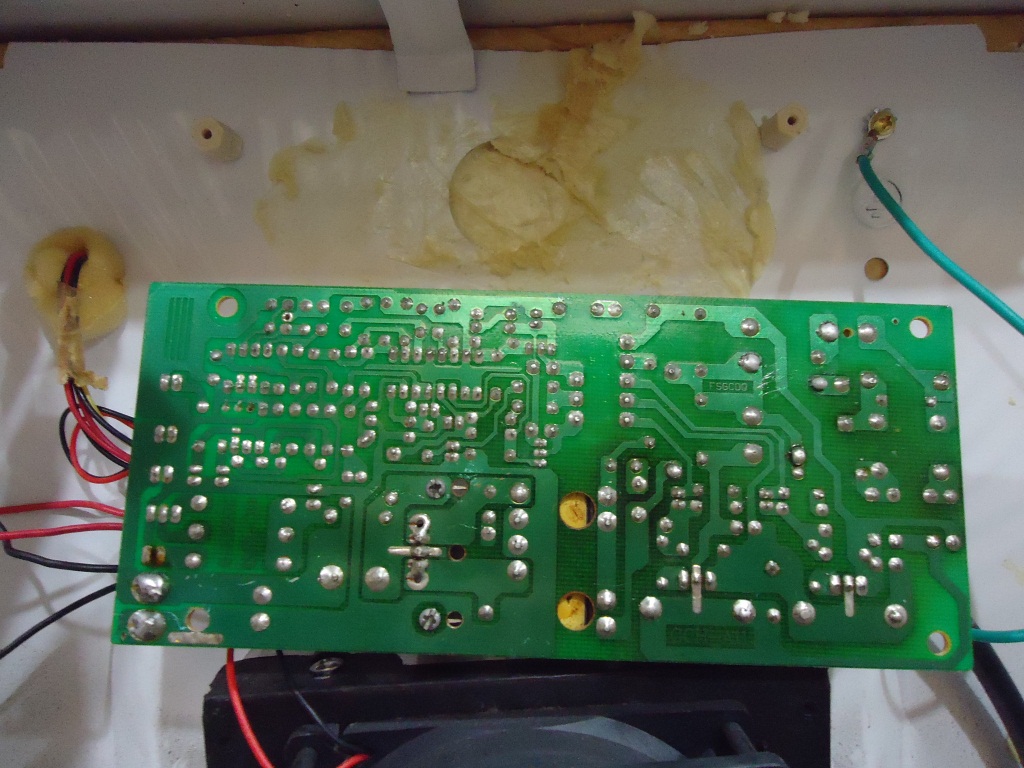

      here are some photos i took last night
      thoughts?

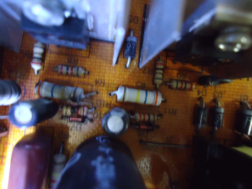

        Thers something strange going on! Can you get image of the third heatsink, there is something like rectifier mounted in there? From the lower side photo it seems that thing got totally unsoldered or what?!

          Seems the board has two hole patterns, maybe for bigger parts. But in the last photo isn´t there a resistor with burnt marks ?
          And in the 3rd photo is there a hole in that transistor ?

              visually i would say that this is where the problems are , the two xistors that have burned out / up and a few odd resitors.
              i sure wish i could find a schematic

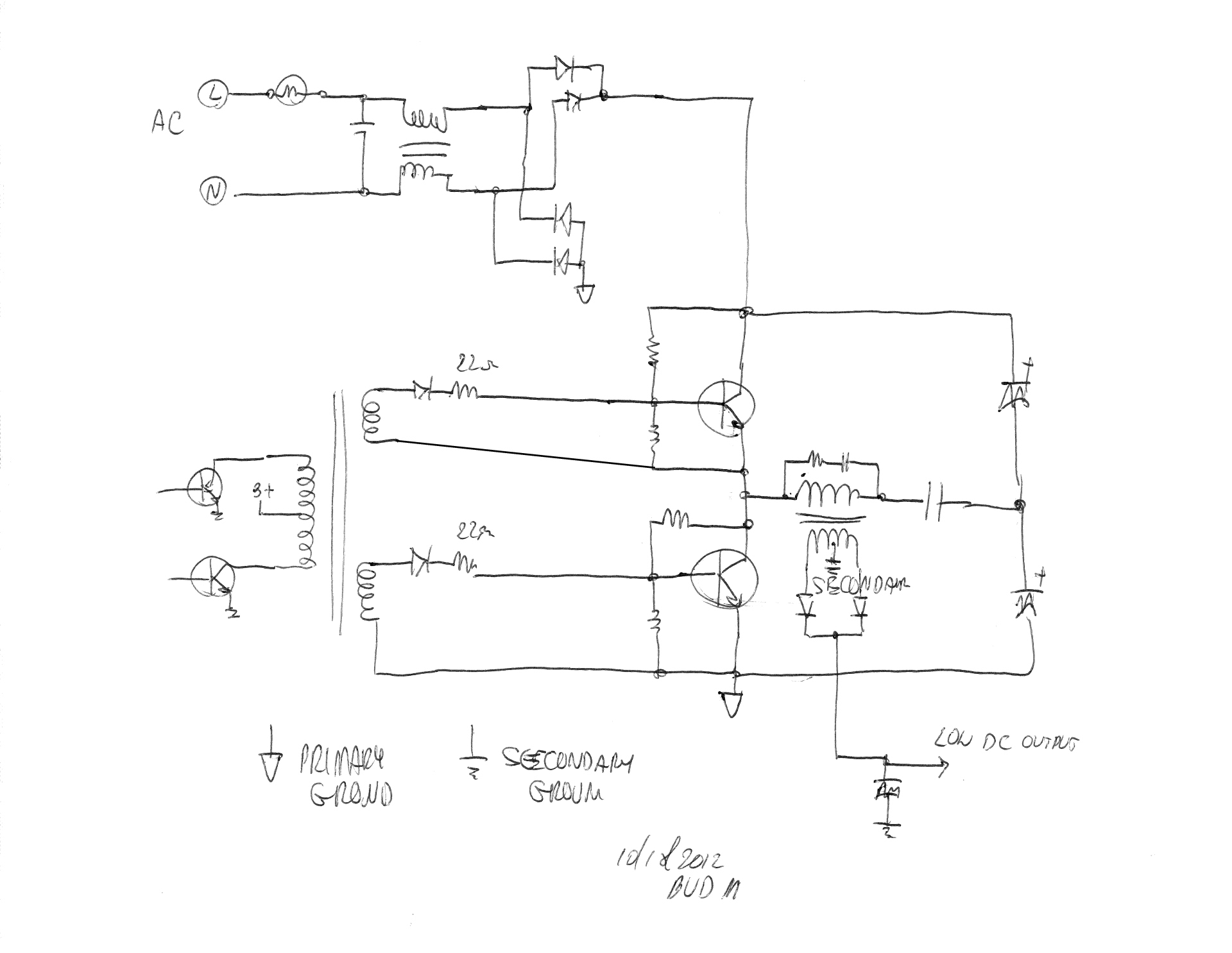

                Re: Thermo electric pcb power supply
                This isn't a schematic of your power supply but it is a representation of how the two transistors are wired up (from one of th3_un1qu3's posts):

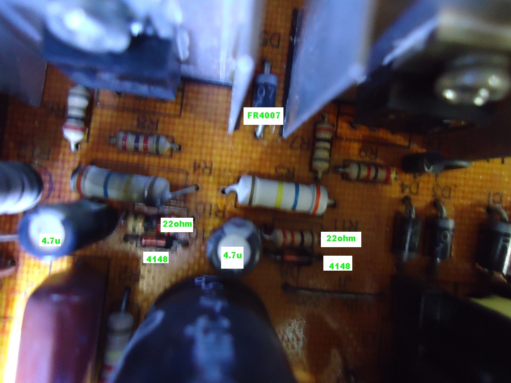

                  I had a feeling that stuff on resistors is just carbonized and broken heatshrink, the pictures are not so good on my 1920x1440 px display As for transistors, just use diode tester on them first and see, it may be just some damage on the plastic package without influence on function.
                  But really, I think there is rectifier on the third heatsink. You see how the solder is practically not in contact with the two legs?
                    The 22 Ohms resistors for the Gate/Base drive is burnt up, yes it is half bridge drive setup. He needs to take out both transistor and check for shorts, also the Gate/Base drive diode that is in series with the 22 Ohm resistor.
                    There are many wires and connectors attached to this board, can I see the whole setup to see where all these wires go to?
                      This may be close to what you have based on what I can see from your pictures.

                          As far as your particular unit, here's what I think.
                          At least one primary switcher has blown, taking out its base resistor. The two small caps go bad and the transistors are no longer biased/driven properly.
                          Your secondary rectifier desoldered itself, or you took it out to test.
                          The screws for the 13005s are discolored, one more than the other. They were running hot, possibly unbalanced as well. The small caps mentioned above contributed to this. If you lost half of the secondary rectifier, that would also be a problem.
                          Replace everything in the base drive ckts, for both transistors. You can sub 13003s for low-load testing- some CFLs use them. They can be scrounged when the CFL dies. It's mostly the bigger ones that use them. "Lights of America" 26W ones do.
                          Check the 2sc945s or 1845s between the '494 and the driver transformer (smaller of the two).
                          I only marked the values of the resistors that I was certain of. The lighting could be better...
