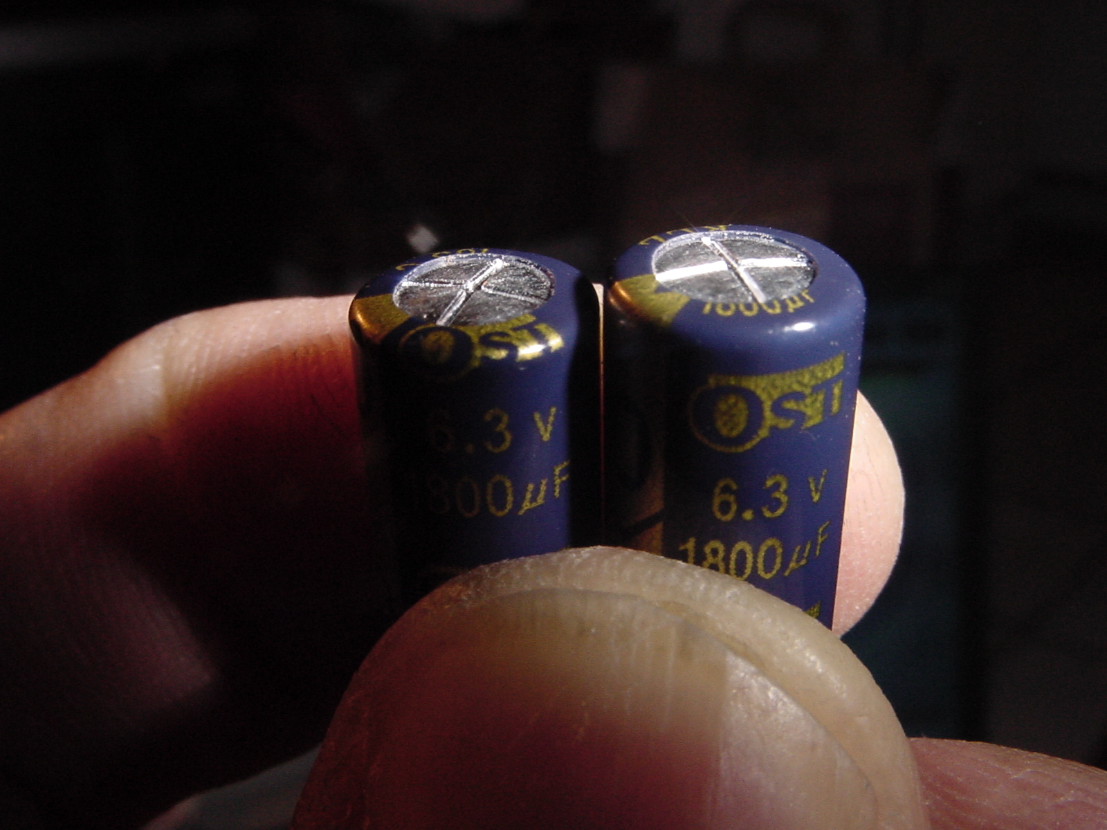

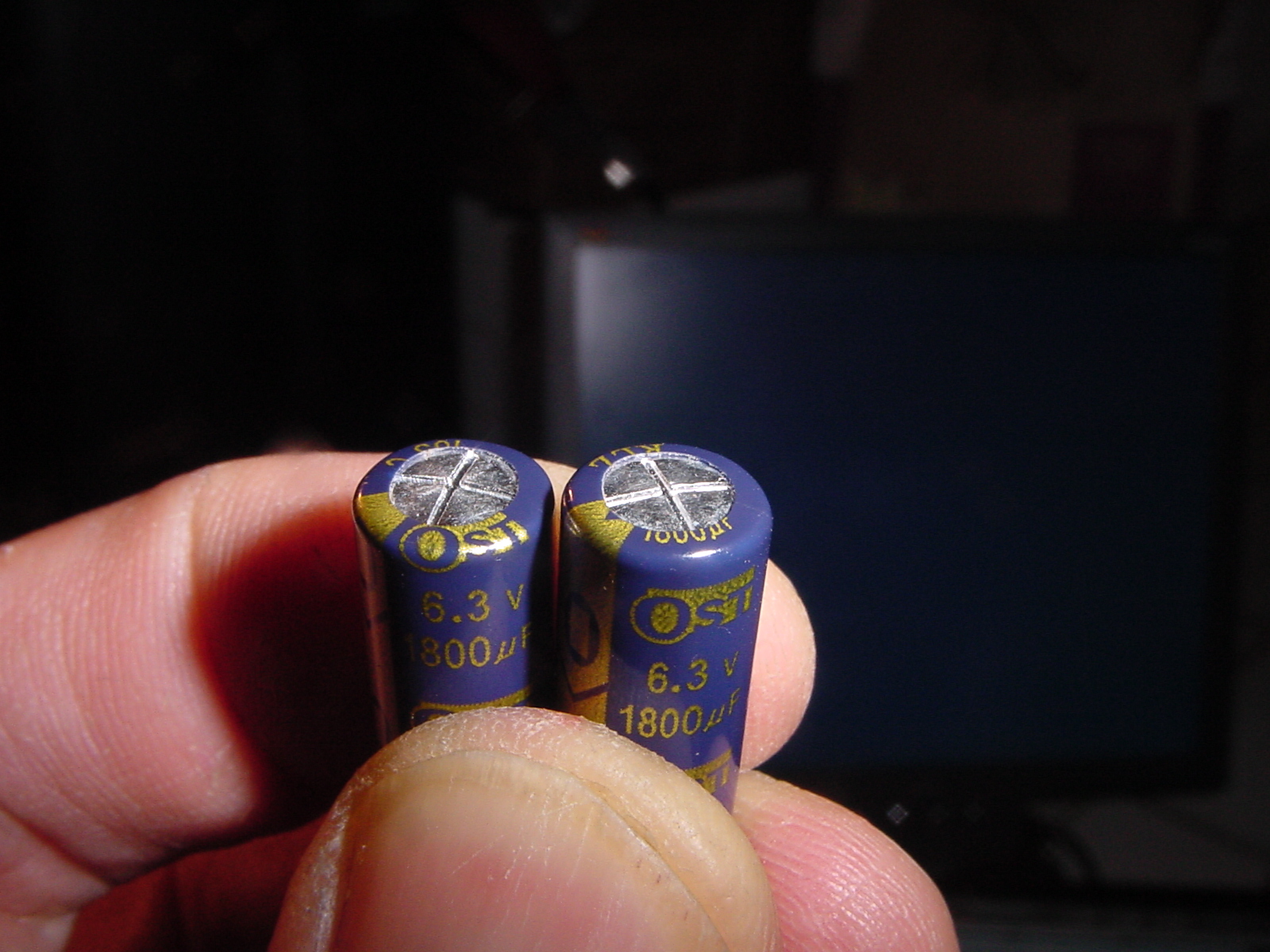

                                  "There are no suspicious-looking capacitors on my mobo or psu" Sometime you can hardly tell until you look real close or actual measurement of the ESR. The caps (6 of them in parallel) in the pictures shown capacitance value to be within 20% but ESR were 5 Ohms.
