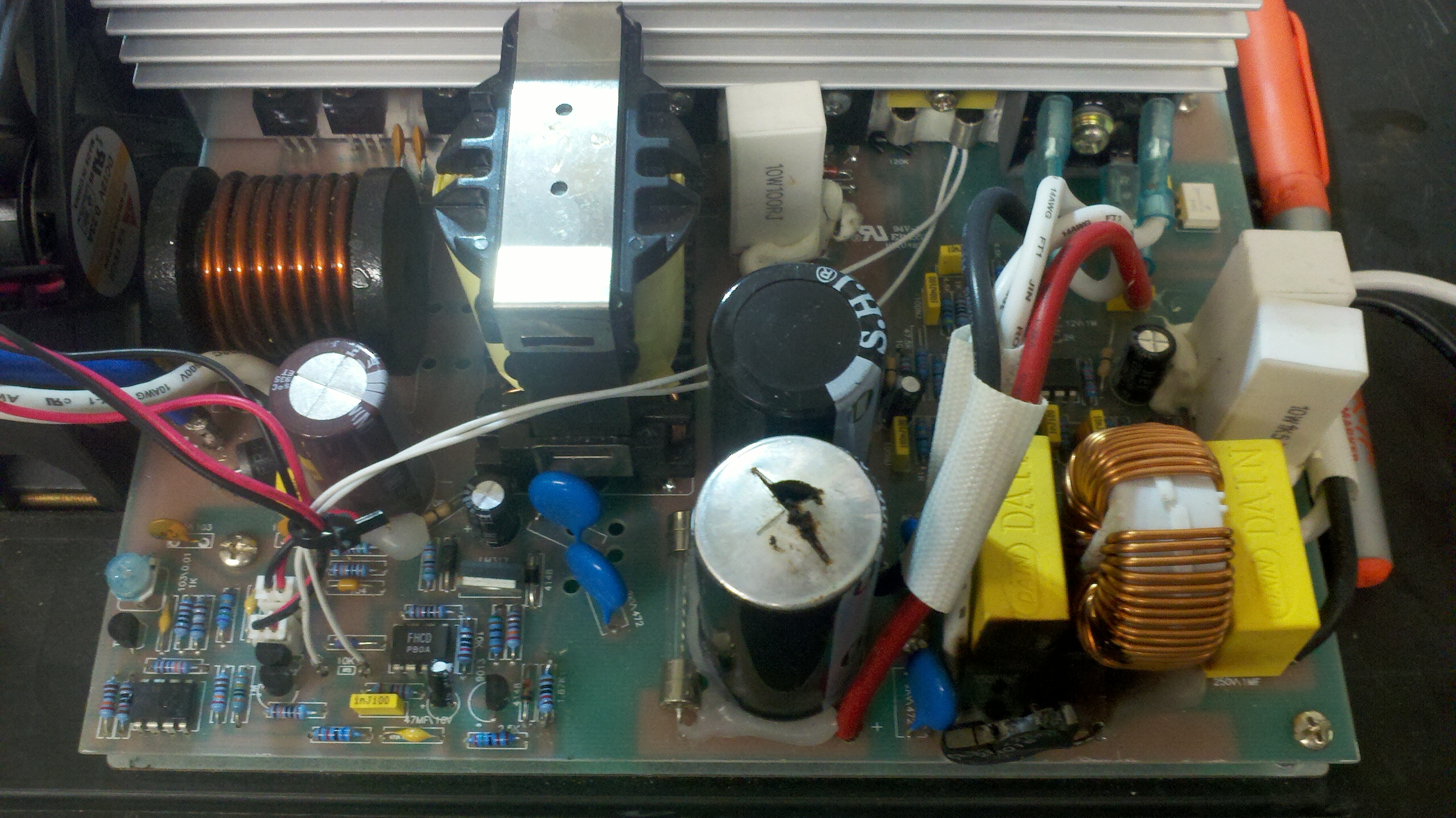

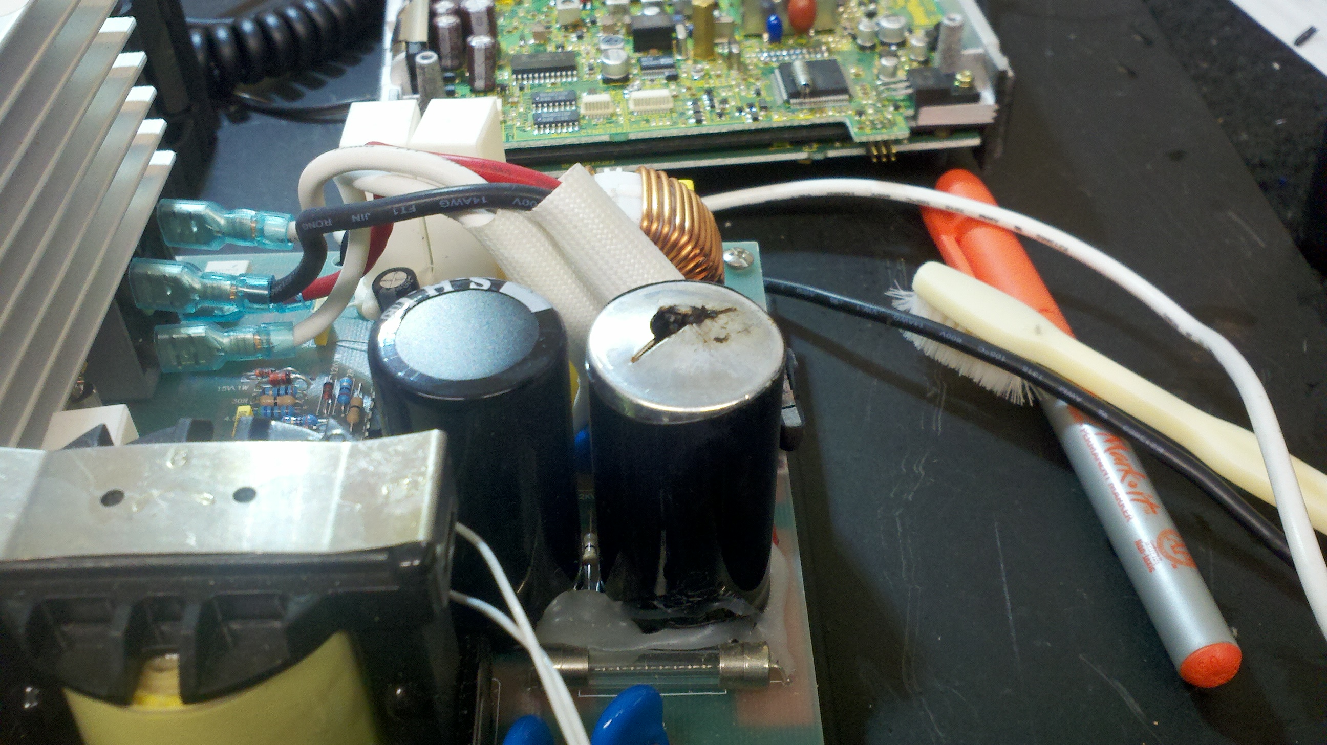

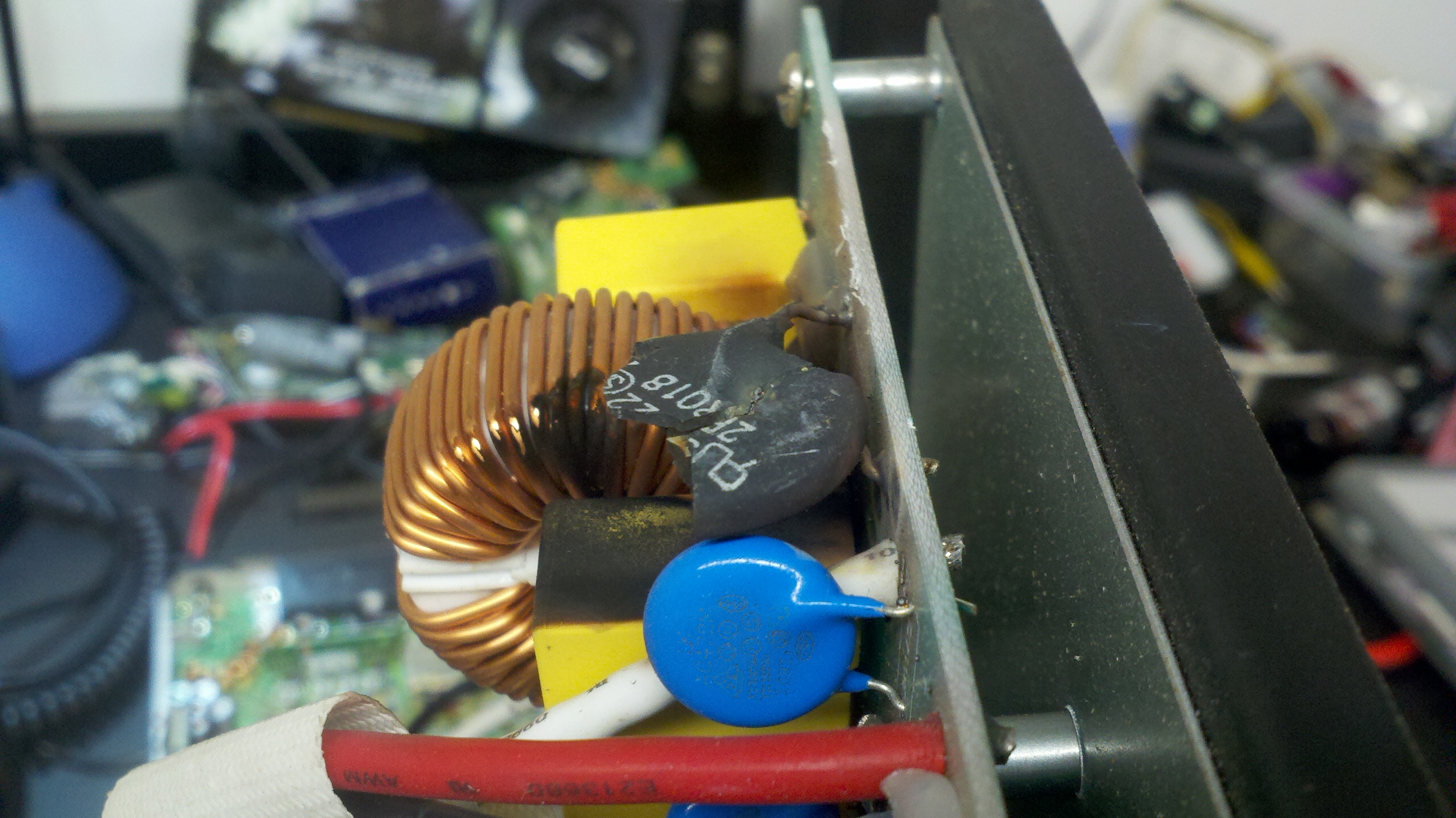

    this came from an rv that was plugged into a outlet installed by a supposidly pro electrician.how often do pro's forget the neutral?
    killed the primary caps,bridge,and inrush limiter.
    oh and before anyone asks the t is on the top of the cap.they saved on ink.

    Awesome carnage!
    Doesn't look like that bad of a PSU, but the primary caps aren't a good brand, and ofc they are blown now, so they need to be replaced.
    I laugh at how the fuse didnt even blow!
