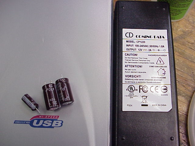

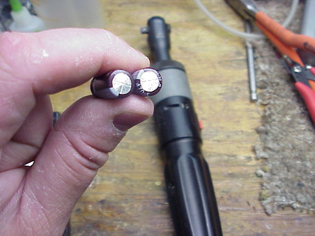

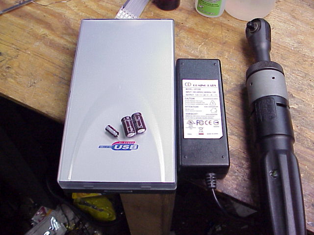

    might get here if we replace these.
    cheap usb hdd box.drive would not spin up sometimes and made a funny noise if it did.

    My data is coming.... Ugg g gh hghgh a aa hh ag gg .. ahhh.....
    What kind of drive did you have in there?
    I see the PSU is rated for 2A. Did you know that 7200RPM Seagates pull anywhere between 2.6 and 2.8A?!?! Wow!
    Rest in peace BFG. You were... a job...
    • gonzo0815
      • Feb 2006
      • 1600
      Re: your data is coming....
      Well, JPtur caps don`t like heat for some reason . So not very surprised that those are gone. If keept cool like in most Enermax PSU`s they will last.
      Is the drive afekted from the probably high ripple current?
