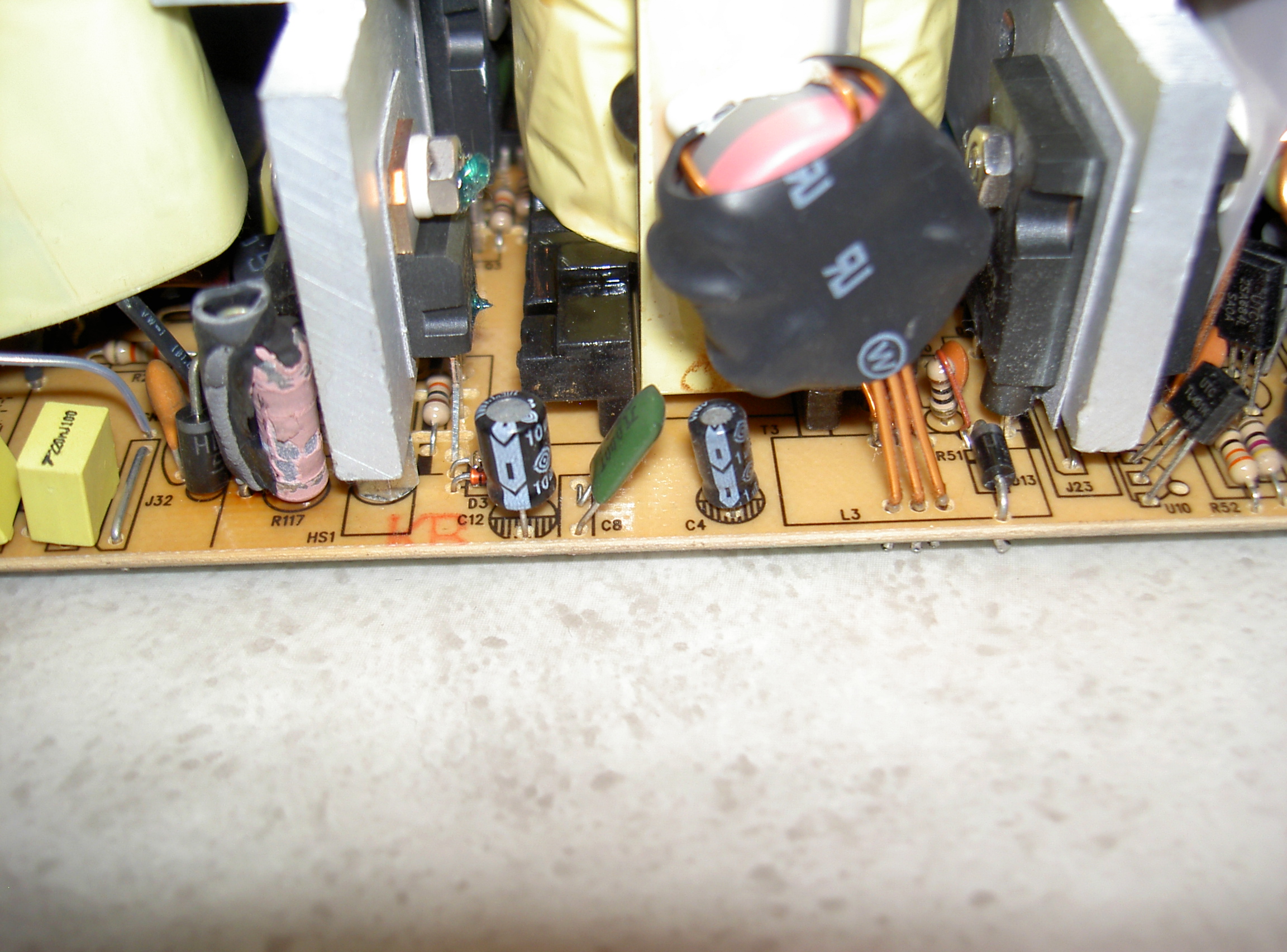

          #64
          Re: Antec 480W "NEO" PSU with Fuhjyyu caps
          Well I have to bring this topic back to life again, because my good old Antec Neo 480 died due to shitty Fuhjyyu capacitors. I found some nice Panasonic FM series to make the replacement.
          The thing is that the R117 doesn't look very healthy. I've tried Antec's customer service support but they were very unsupportive (I wouldn't say stupid but...). :P
          I really need to know if it is a 1.8k or 1.9k resistor and if it could be replaced by something bigger like a 5w ceramic resistor or something like that.
          Resistor and caps photos -> Click here.
          PCB model is CWT-XXXEX Rev: B
          Main Caps to replace: 2x 1000uf 10v, 2x 2200uf 16v, 3x 3300uf 10v, 1x 4700uf 10v, and some others too.
          Thanks!!

            #65
            Send CWT an email and tell them you have a CWT-480EX revision B... they might help you with that. Worth a shot anyway.

              #66
              R117 is 1k8 2w metal-oxide.
              i'd use a 3w but make sure it's metal-oxide.
              never wirewound / ceramic.
              it's exactly the same as the smart-power series uses.

                #67
                I had problem with a similar resistor in my antec true power 2.0 380 watt. It's in the same place as yours from what I can see in the photo you uploaded.
                https://www.badcaps.net/forum/showthread.php?t=8223 3rd post

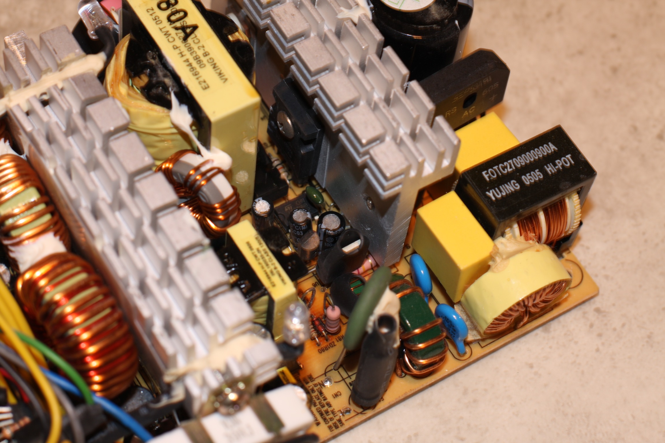

                          #72
                          Time came a week or so ago
                          The caps that control the switching chip (I think) had started to vent... The caps on the secondary side for 12v, 5v and 3,3v where fine though, of course all got replaced...
                          With Samxon caps, thanks Big Pope!
                          The vented caps are the two blurry ones in the middle top of the pic...
                          I got a little nostalgic over Taz's post here so I'm posting an update
                          In my original recap 7.5 years ago I did not swap out the small caps, 1uF > 220uF
                          Because of this back in November last year the PSU failed to turn on.
                          So I replaced those, and I also replaced resistor R117 that was severely burnt up as you can see in the pictures. I used Elfa partno: 60-549-62
                          Let's see if it lasts another 7.5 years now
