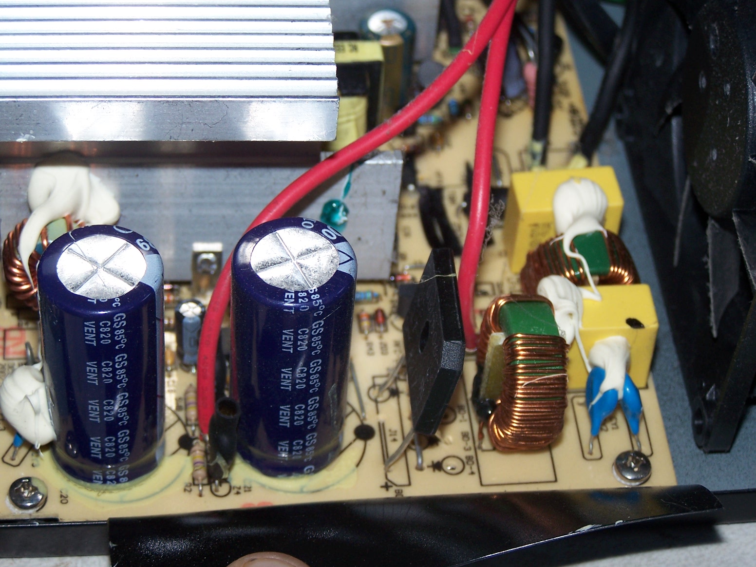

                                  330uF primary caps will allow for 250W. I often test cheap PSUs with 330uF primaries. They usually will be OK at 250W. it's when you ask for 300W that the switching transistors go kaboom. If we assume 2x the capacitance = 2x the wattage, then 680uF primaries = at least 500W
                                  EDIT: When I saw the Pic, I though tthis might be a CWT. The UL number, though suggests it's HEC Compucase. Either way, it's probably still a keeper though. Do you have any pics of the internals?

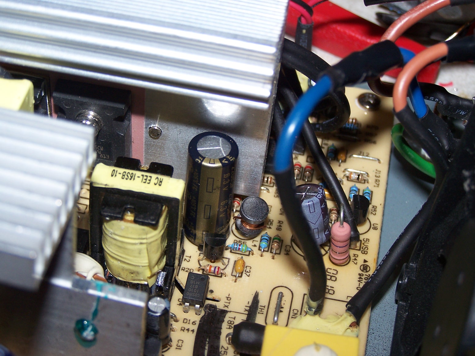

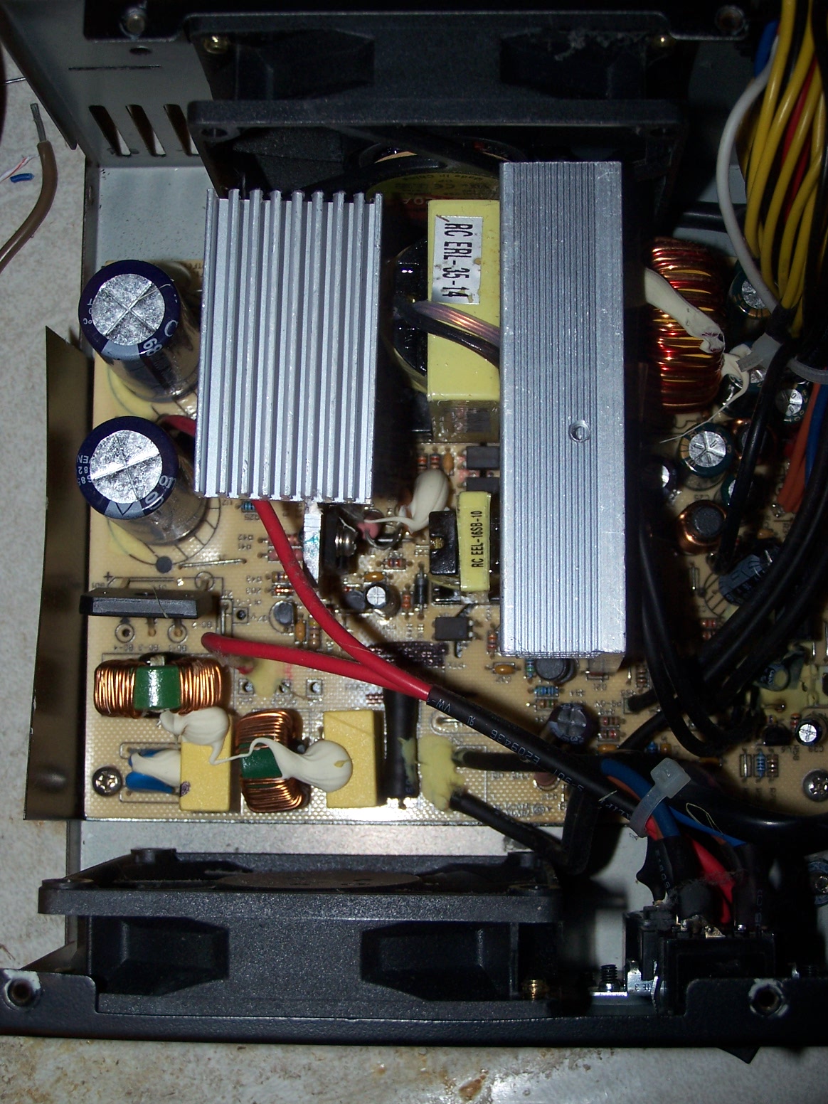

                                    I do have pics to post:
                                    before:
                                    Yawn.
                                    the primary... those capxons look tiny; I question real specs of them. I might replace them if I find a use for the PSU.
                                    Otherwise, the input filtering is good... the use of a beefy Bridge rectifier is a great touch.
                                    The secondary... mostly teapos . the P4 and PCI-E wires are 20AWG... I guessed that with such an anemic 12V rail that quality wiring was unneeded...
                                    At least the other wires are 18AWG.
                                    The heatsinks are good for a 300W unit... The only problem was that it was marketed as a 430W...
                                    The blown up 5vsb Cap... my guess is that is why it squealed so bad.

                                      Re: 430W Thermaltake Squealer
                                      The mods/fixes:
                                      Besides recapping, I:
                                      - shorted the 115/230V switch
                                      - bypassed the neutral side of the on/off switch; that side's contacts came out (melted shell) when I went to re-solder the the wires.
                                      - removed the 20AWG PCI-E and p4 wires; replaced with a p4 strand with 16AWG wires.
                                      The recapped secondary. I used a mix of samxon GD and rubycon MCZ.
                                      The new 5vsb cap... its a Panny FC. I didn't have a replacement for the other 5vsb cap, the 330uf 16V Su'scon, with it being next to that load cap, I assume it too will need fixed.
                                      No test data yet due to messing up the one cap's polarity (pics taken before the failure). Once I have that fixed, I'll see of the squeal is in check and whether the voltages are in spec and clean.
                                      Comments?

                                      • c_hegge
                                        • Sep 2009
                                        • 5219
                                        Looks alright, although I wouldn't use MCZ or GD in a PSU. their ESR is too low, so you'll probably make the ripple worse.
