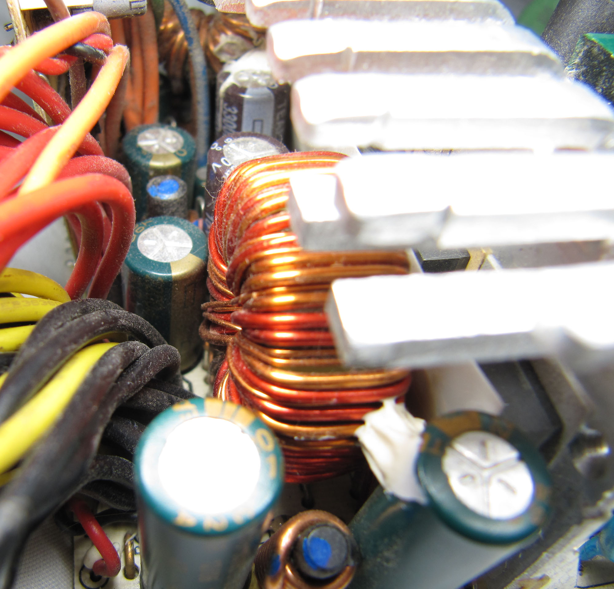

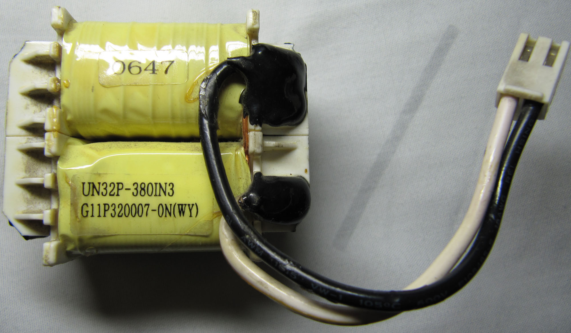

          It doesn't boost voltage but the PFC coil can get rather hot and since this PSU (like most CWTs) has the coil right next to the primary caps this adds additional stress. Of course the primary heatsink on the other side of the caps gets hot when the PSU is loaded and the airflow is somewhat restricted in this area which is somewhat narrow with relatively large objects on both sides that block airflow, the PFC coil being a solid object isn't exactly good for airflow.

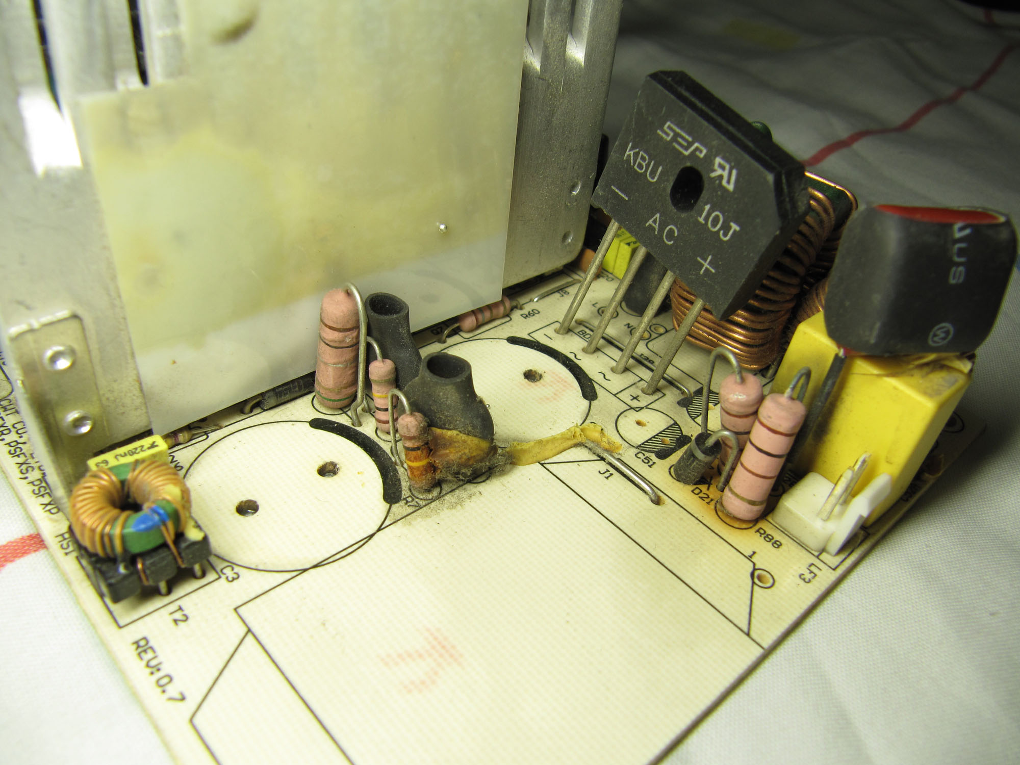

            I took out the Capxon primary caps and took more photos of that power supply trying to figure out why the primary capacitor in that specific spot keeps failing.
            There is some burnt glue on that bleeding resistor if I am correct. I don't remember those resistors to get hot.
            I also consider the possibility of the MOV getting hot, but is that possible?
            My last suspect is PPFC placed near the primaries. Do they get hot usually? Is it normal or a sign of failure?

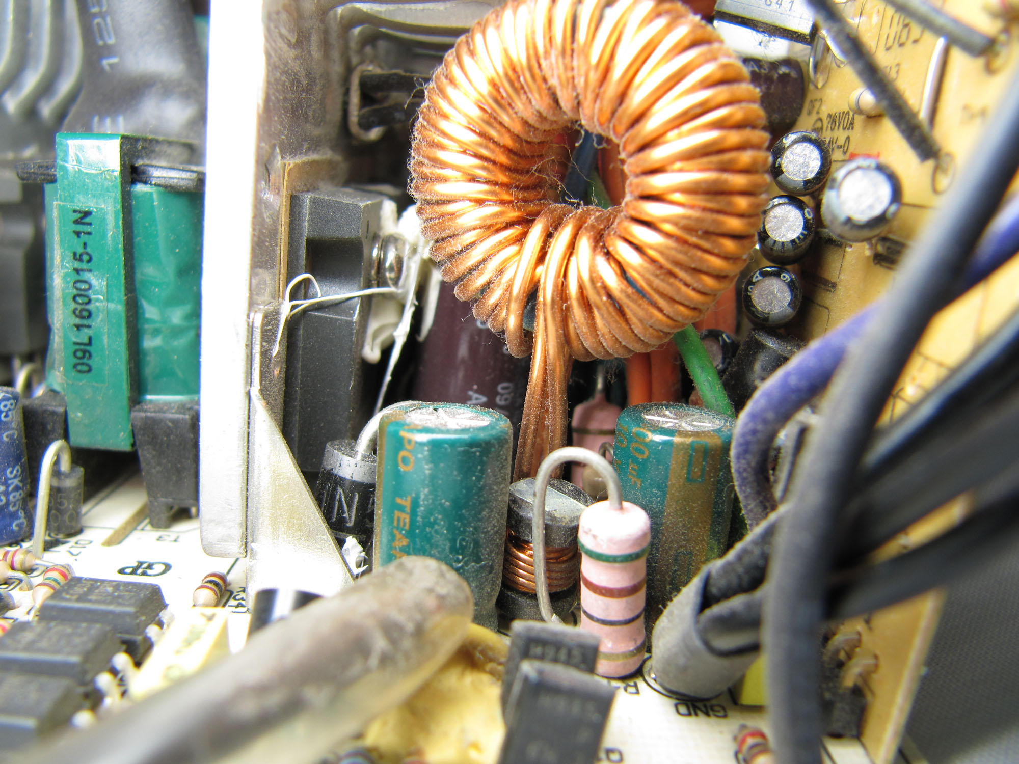

            Meanwhile I had a look at the other parts of that power supply.
            The bridge rectifier is a 10A KBU10J.
            The PWM IC is UC3845B.
            The power supply uses C5353 NPN transistor on 5vsb and 2x W14NK50Z power mosfets rated for 14A continuous at 25°C and 7.6A continuous at 100°C.
            Now let's move to the secondary section:
            -5vsb: 1x 1N582 3A, 2x 1000uF 10V Teapo SC 8x20mm, ripple 1080, esr 0.065
            -3.3V: 1x STPS3045 30A,
            1x 3300uF 10V Teapo SEK general purpose 10x25mm, ripple 950 and 1x2200uF 6.3V Teapo SC 10x20mm, ripple 1220, esr 0.051
            -5V: 2x STPS3045 30A(60A total),
            -12V: 1x STPS3045 30A, 2x 2200uF 16V Teapo SC 10x30mm, ripple 1780, esr 0.032
            - -12V: 1x 470uF 16V Teapo SEK general purpose 8mm
            Teapo SEK datasheet
            Teapo SC datasheet
            The fact that they used GP caps explains the relatively high ripple those Thermaltake psus show when high loaded.

              Put two good caps in there for a moment, and power it on. Take note of the voltage across each primary cap. Occasionally, if there is a problem with the PSU, one cap will have a higher voltage across it that the other, sometimes enough (greater than 200v) to cause it to fail.

                    Bingo!
                    I followed your advice and checked the bleeding resistors.
                    They should be 100kohm according to the color code and that's what I got from one of them. The other resistor, the one connected in parallel to the capacitor that failed, is open.
                    I put 220uF 200V primary caps and plugged it on AC. The cap with the open resistor gets 235V across its legs and the other only 85v. The total rectified voltage is 320V.
                    Thank you very much for the insight! I am going to replace both of them. How many kohm I should put? Should I stick to the original value?

                          Btw I removed the resistors and plugged it in again. Every cap now has 161-165V across its legs.

                                        I *think* I found your problem...
                                        See the resistors and diodes next to that PFC connector (one of the resistors is labeled R88) in this picture?
                                        Well, does that circuit look familiar?
                                        Hint: *Jou-Jye primary boosting circuit*
                                        I think you have the same problem here. I don't see the boosting caps, though. So maybe it isn't the same circuit. Any chance you can draw it out?

                                          I think he removed the boost caps, which disables the boost circuit. I often do this to CWT PSUs. It's not needed and gets too hot. I doubt if the boost circuit would have caused the bleed resistors to fail, though.
