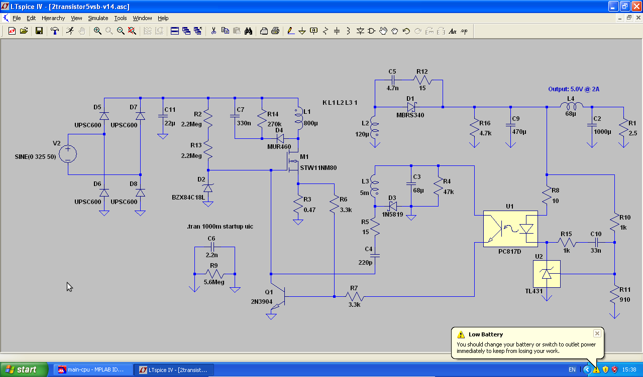

                It is indeed a classic 2-transistor circuit with opto feedback. The driver transistor is a 2N5551 SMD aka MMBT5551. It appears like they just threw the parts on there because the order of the part numbers on the silkscreen makes little sense. The only interesting part until now is the snubber, which is an RCD circuit wired from drain to +HV with an additional capacitor across the resistor.

                  These two-transistor circuits are very critical of component values. They will often oscillate with any set of values, but efficiency will be very poor and ripple current will toast caps quick. Optimising the values can be done with lots of calculations, or my favourite method is to tweak the values until it works in a circuit simulator.
                  A good 2-transistor circuit can be efficient, I've been able to optimise one to 85% before. It's very tricky because it's so critical of component values. The MOSFET often dissipates only a few hundred milliwatts, so you don't even need a heatsink on it.
                  Hmm. I wonder why they used a 160V transistor? The peak voltage the transistor usually sees is the gate voltage, which is set by the zener, and is typically around 18V. The simulations I posted seem to work with 2N3904s and 2N2222s, and those are cheap 30-40V parts.
                  Interesting snubber design. For output power <20W, the snubber is mostly unnecessary. Peak voltage at drain is around 400V even without snubber, so using a 650V device is sufficient. Snubber is necessary at AC power on and power loss though as voltage stress is very high then.

                    Done with the primary side. Tested all SMD caps and the zener (18v). Now for the secondary which won't be too much work, and the transformer.
                    Edit: All done. I also want to correct a few inaccuracies, as follows: The output caps are 1500uf before and 1000uF after pi filter, both 16v not 25v like i said. They are Su'scon SD. Interestingly the feedback is taken after the pi filter... i'll have to check the compensation component values, this is interesting.
                    Attached LTSpice simulation file. The differences between sim and real circuit are: I guessed the value of the source resistor R7. D3 isn't 4148 but something a tad beefier, but i haven't got a clue what it is exactly. The zener is supposed to be 18v instead of 15v, and the mosfet is 6N60 not 8N60, so efficiency is a bit higher in simulation. If the component numbering order seems weird, that's exactly how it was on the silkscreen. All other values are accurate including the ESR of the output caps.
