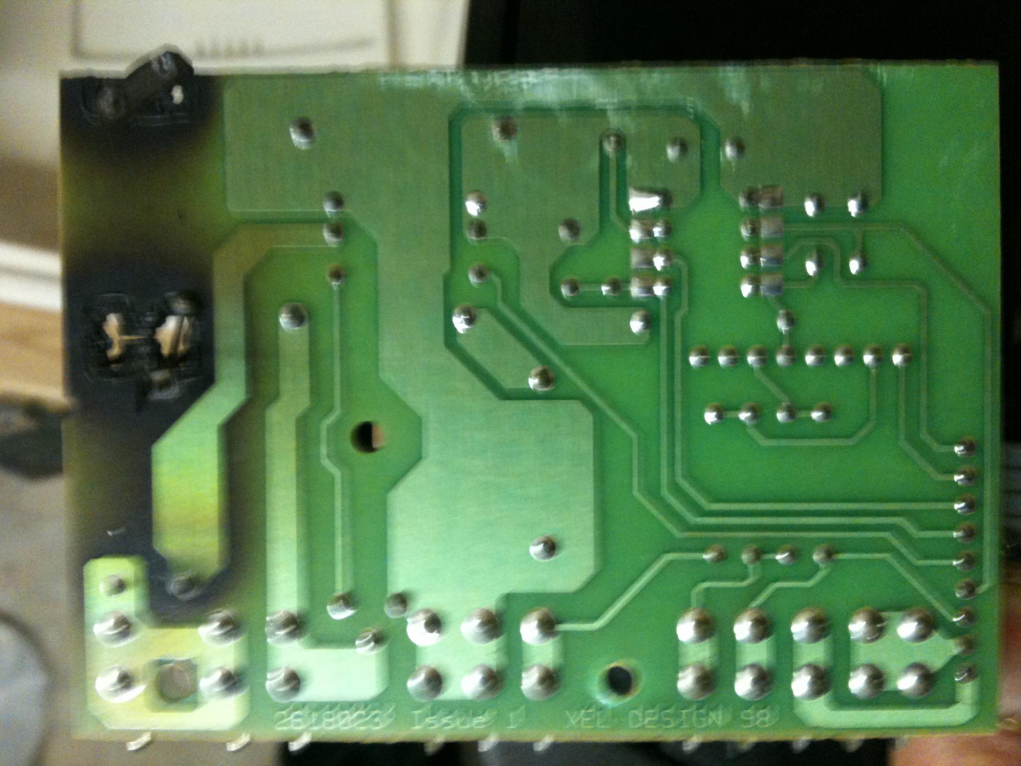

    In the last week i've already repaired one of my faulty dehumidifiers, after gaining a little experience here on the forums.
    Decided to give the other one a shot tonight, an old 1998 Ebac 11466TK-GB
    I was shocked to find the PCB in the state it was when I opened the unit.
    Just a warning to anyone with one of these units which miraculously is still working, be very careful!
    I will repair this, but it will NEVER be left unattended ever again. The PCB sits at the very top of the machine, right below the wooden case. I can only thank my lucky stars this didn't catch fire.

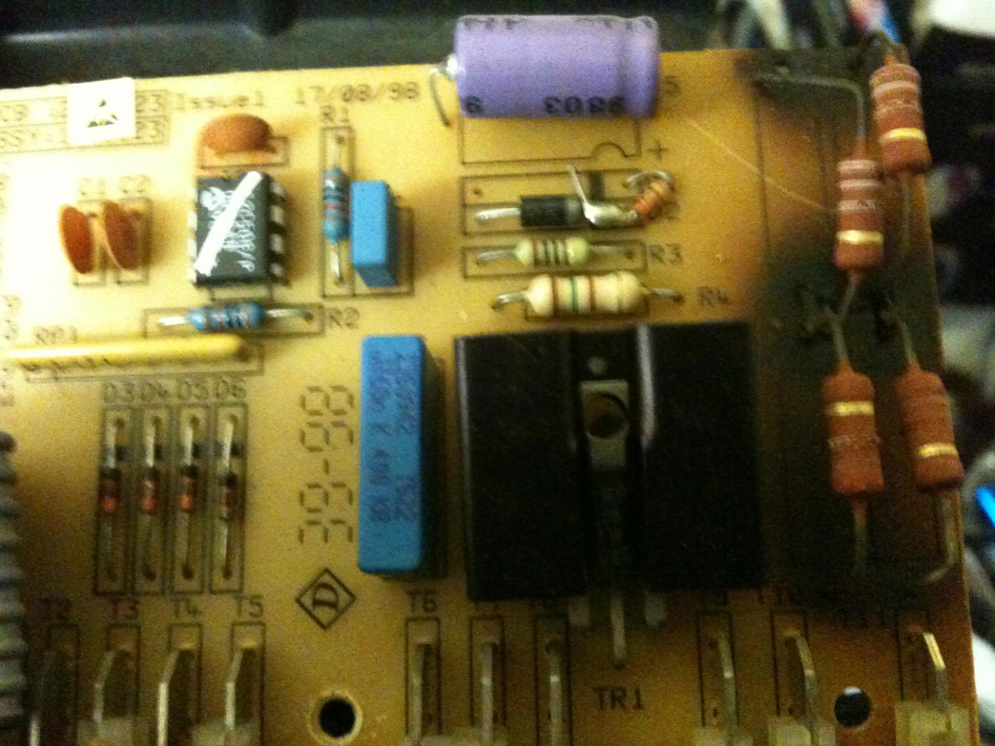

    That's some scary stuff.
    Looks like the resistors are used to drop the mains voltage to a lower one that can be used by the logic IC. If that's the case, then this is one horrible horrible design. Repairing such a design will not solve anything. Stuff like this belongs in the trash. Seriously, how much cheaper is this than a small transformer or an SMPS?
    Glad you caught it on time. If I were you, I still wouldn't use it, though.

        It's a capacitive or resistive voltage dropper. It looks rather poorly designed. The CR dropper isn't the greatest, but it is a cheap way of powering a microcontroller. The problem is, a triac requires a lot of current, so most likely those resistors dissipate a couple watts each...
        An SMPS would be best for this design; you could take apart a 5V or 12V wall wart and fit it inside the case.
        Not sure if a dehumidifier gets a lot of moisture; perhaps the board should have a conformal coating on the bottom?

          tom66 - excellent suggestion. Sounds much safer. I will probably go this route (after I repair the board and test the mechanical side of the dehumidifier, as it has been out of action for 8+ years)
          The board itself probably isn't really subjected to that much moisture - not in the domestic environment they are designed to be used in anyway!

            I have seen some fans and heaters that use a custom controller chip and a triac, and they all used a zener diode to reduce the voltage and a small resistor to limit the current. This works well for the application. The last one I took apart used a 5.6V zener diode and a 330 ohm 1/2W resistor, and the resistor only ran at 40°C. The rectifier diode was connected after the zener diode, so the IC received 4.8V.
