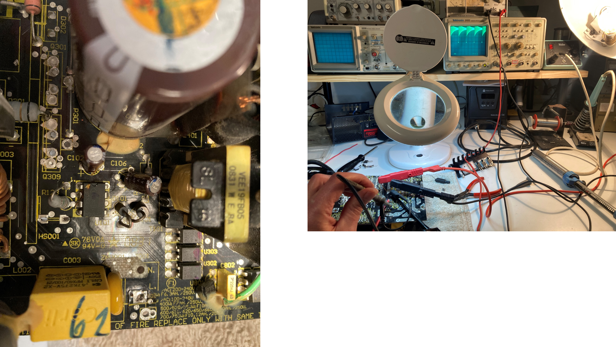

    I am recovering this thread as it's happening the same to me.
    Why might be the cause that one of the APFC mosfet blows "again and again"? Although I am using a light bulb current limiter, I am getting rid of 24N60C3
    First thing I've seen is that Q302 and Q308 were shorted.
    Q302 was marked as W2F (PMBT2907A??)-> I've replaced with M7A
    Q308 was marked as W1P (PMBT2222A??) -> I've replaced with M2A
    Changing the transistors hasn't made any good difference. I switch on the power supply and the light bulb lights for an instant (good). The 5Vstby is there (good). As soon as I connect the ATX tester..........the bulb shines like the sun (no good)
    Any idea what to look at? Any suggestion about how to trace this error?

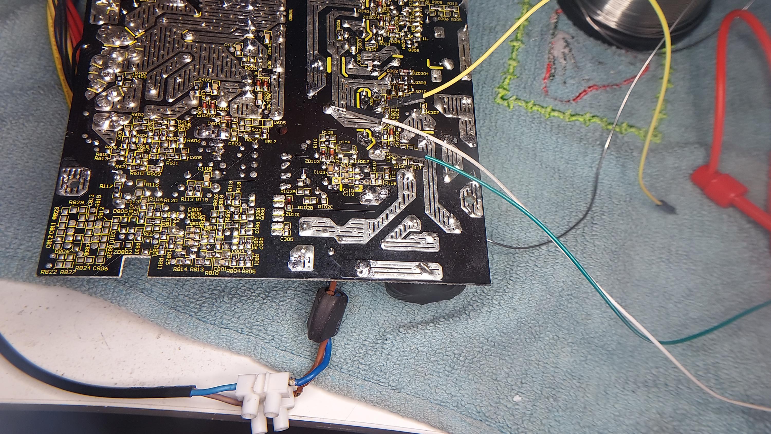

    I've placed two pictures with some measurements. Zoom is needed

        Re: Corsair HX620W - dead APFC MOSFET
        Grazie Davide.
        I will have a look. So far the main capacitor looks ok (at least from capacitance). I will measure the ESR on it (pending).
        In the meantime I've realised that also two resistors were bad (R302 was broken -10K, R304 was blown - 4R7). Last one replaced with 5R1
        I will keep on reviewing it until new mosfets arrive......
          Another thing is, APFC circuits do NOT like series incandescent bulbs - not low-wattage anyways. Try using something like a 200-300 Watt Halogen bulb instead. Or heating element from appliance, rated for 200-500 Watts at your line voltage (120V or 230V, depending on where you live.)
          Also, if you had open resistors in the Gate drive circuit to the APFC MOSFET, chances are the IC driving it is dead too. And with that dead, it may be getting too high of a voltage on its Gate and killing the new MOSFET too.

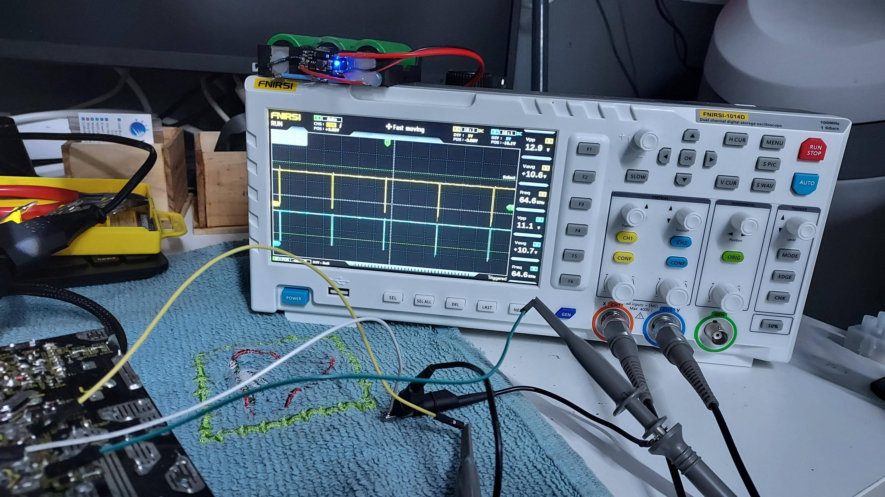

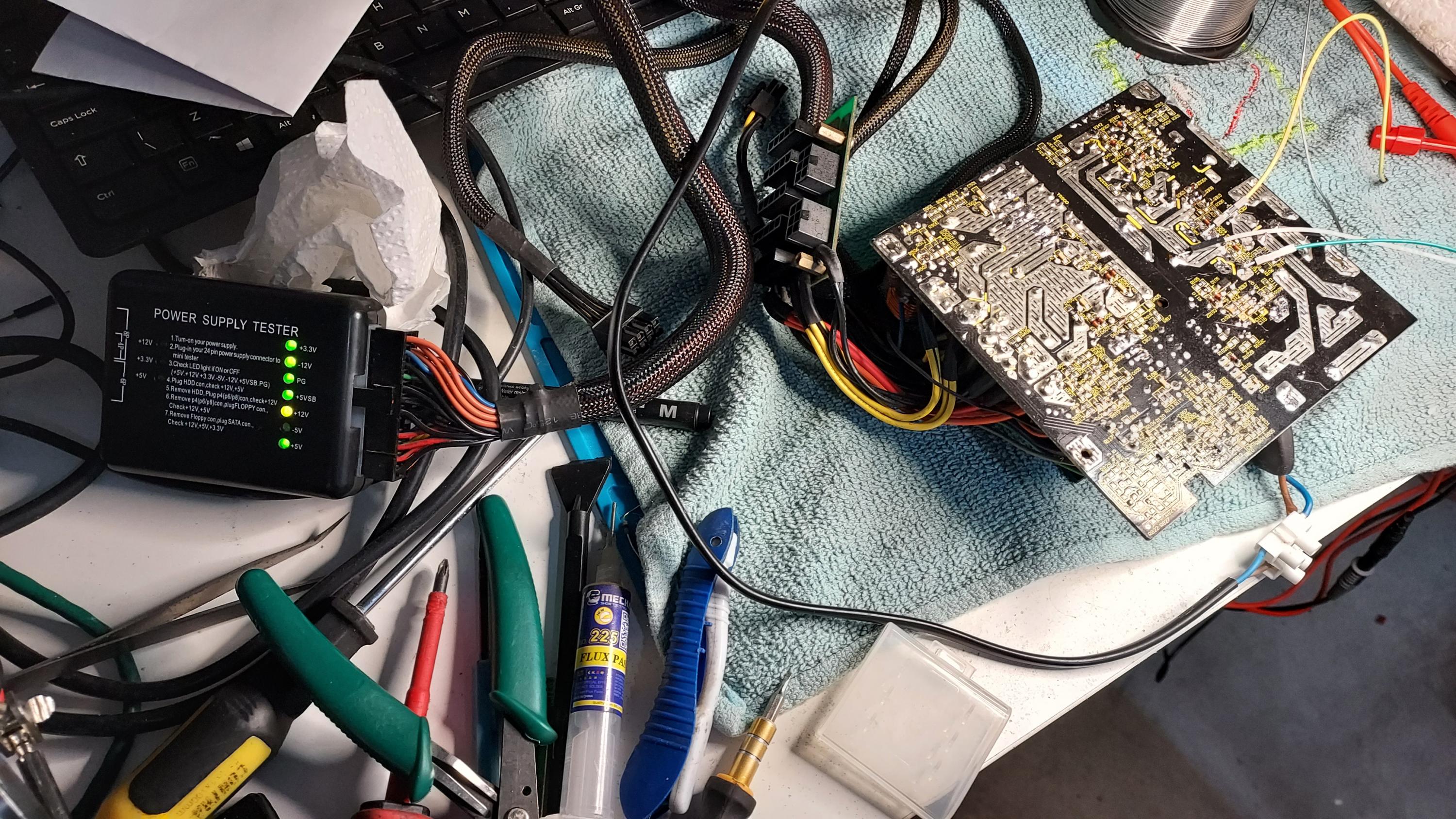

            Some follow up on this power supply.
            - I've finally put a 4R7 resistor in R304 to have both mosfets with the same gate resistor.
            - I have check that both gates receive the same voltage (10.6V) (Gate-Source voltage) - Source is conected to "big cap" negative terminal.
            - The SMPS works perfectly without APFC circuit (mosfets are not there).
            - I have connected the oscilloscope in both gates but not sure if the picture is the one I was looking for.......
            What do you think........is the Power supply ready for installing again 2 24N60C3 and see them blowing again?
            Regards,
            Francesc.
                I double checked the PCB and I realised that Mosfets are connected in PARALLEL. Between gates there's only 40ohm and both drain and sources are directly connected. So Drive is the same. That is what I was seeing in the oscilloscope.
                I put 2 new mosfets and this time the SMPS worked fine. (only 6 mosfets lost in the battle )
                    Originally posted by Mikenhauzen
                    Hello Francesc, what is the conclusion, chaning those two mosfets in the same time solved the issue? I happend to change mosfets one by one and everytime one of them blew up, I had privously some other diodes shorted, replaced those and currently I am having 1 out of 2 mosfets shorted, wondering if I should spend another money for 2 more mosfets…
                    Always replace both MOSFETs at the same time if one of them had shorted.
                    Also check the main capacitor. If it's bad, you'll keep blowing MOSFETs and/or possibly damange something else on the primary side too. In fact, the PWM or APFC controller could already have been damaged after those MOSFETs failing. Either way, DO NOT plug in the PSU directly to the wall even after replacing the MOSFETs and checking the primary cap. Use a 200-300 Halogen lightbulb instead in series with the AC Live. The Halongen bulb will limit the current and power in the even there is still something else wrong, thus would spare you a blown fuse and likely the APFC MOSFETs too. If you don't have a 200-300 Halogen bulb, you can also use a heating element with a power rating of up to 450 Watts (but no less than 100W.)

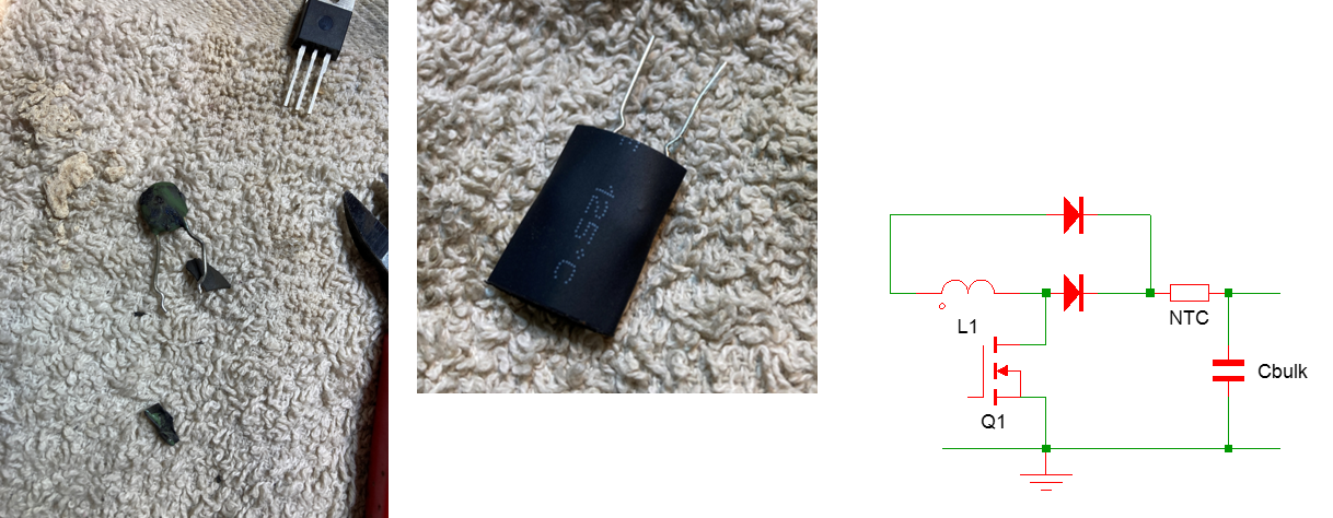

                      I have spent time on a Corsair HX620 in which the fuse was blown as well as one of the two SPP24N60C3 like reported in one of the posts. I've successfully removed the heatsink which hosts the two MOSFETs, the diode (a STTH8S06D) and the two MOSFETs for the 2-switch forward converter. None of the small bipolars in the driving stage were dead and waveforms from the UCC28515 daughter board were good, despite quite a large duty ratio in lack of feedback (transistors removed, 230 V applied). The standby power supply needs 230 V ac to operate, it did not start up with dc applied to the bulk cap. I thus replaced the defective SPP MOSFETs (I soldered two new parts) and reapplied power. Same effect, one of the two transistors failed in short circuit immediately.
                      Rather than retrying again with all transistors replaced, I wanted to check the PFC stage alone (and unloaded) by wiring a fast diode and an external MOSFET in a quick 3D wiring. When probing PCB tracks with the ohm-meter to identify the connections, I realized that the track from the two cathodes (catch diode and bypass) were going to the bulk cap. via a NTC. I unsoldered the NTC and measured it at 15 kOhms so no wonder why the drain-source voltage goes to the sky at turn off, making one of the two paralleled MOSFETs who has the lowest BVdss break first, protecting the second. I replaced the NTC by an equivalent of the SCK 054 (4 ohms at 25 °C) as described here. When doing this operation, make sure the new NTC is well protected with a heat-retractable sleeve otherwise it touches on both sides the switching transformer ferrite and the bulk capacitor. Truly packed!
                      This NTC is supposed to limit the in-rush current and is usually on the ac side of the power supply. To improve efficiency, designers look for places where the ac ripple - which partially contributes to the rms content - is smaller and one option is to put it in series with the bulk capacitor (then shorted later on) or in series with the PFC diode as in here. If in series with the ac, when it fails, the whole power supply safely stops and replacing the NTC is benign. But here, the NTC being open, the destruction of the MOSFET by over-voltage is immediate which is not cool. Now, I read in one comment that you need to replace both MOSFETs when one of them fails. Ideally, yes, they should come from the same lot for the best sharing option but MOSFETs have positive Tc which helps for current sharing anyway. Because I only had two MOSFETs in spare that I soldered in the first attempt, I had to reuse the one MOSFET that did not originally blow, no choice.
                      I then powered the board and started the standby power: the fan did operate and all dc supplies were present. The only thing I noticed is the rectified bus which is at 375 V dc or so which unusually low, as the bus is usually 380-400 V. The UCC may embed a kind of no-load mode which reduces the dc rail, I will double check this. I now need to test fully loaded but so far so good!

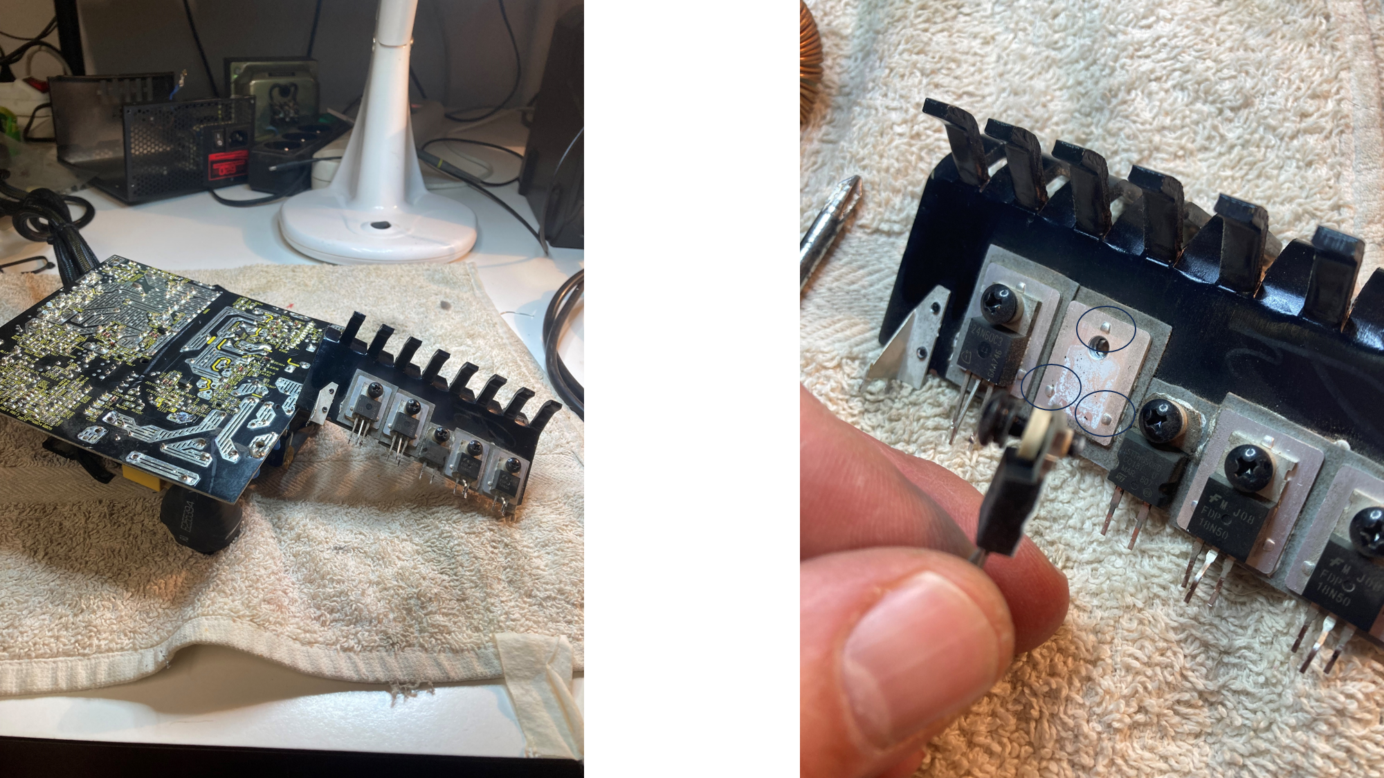

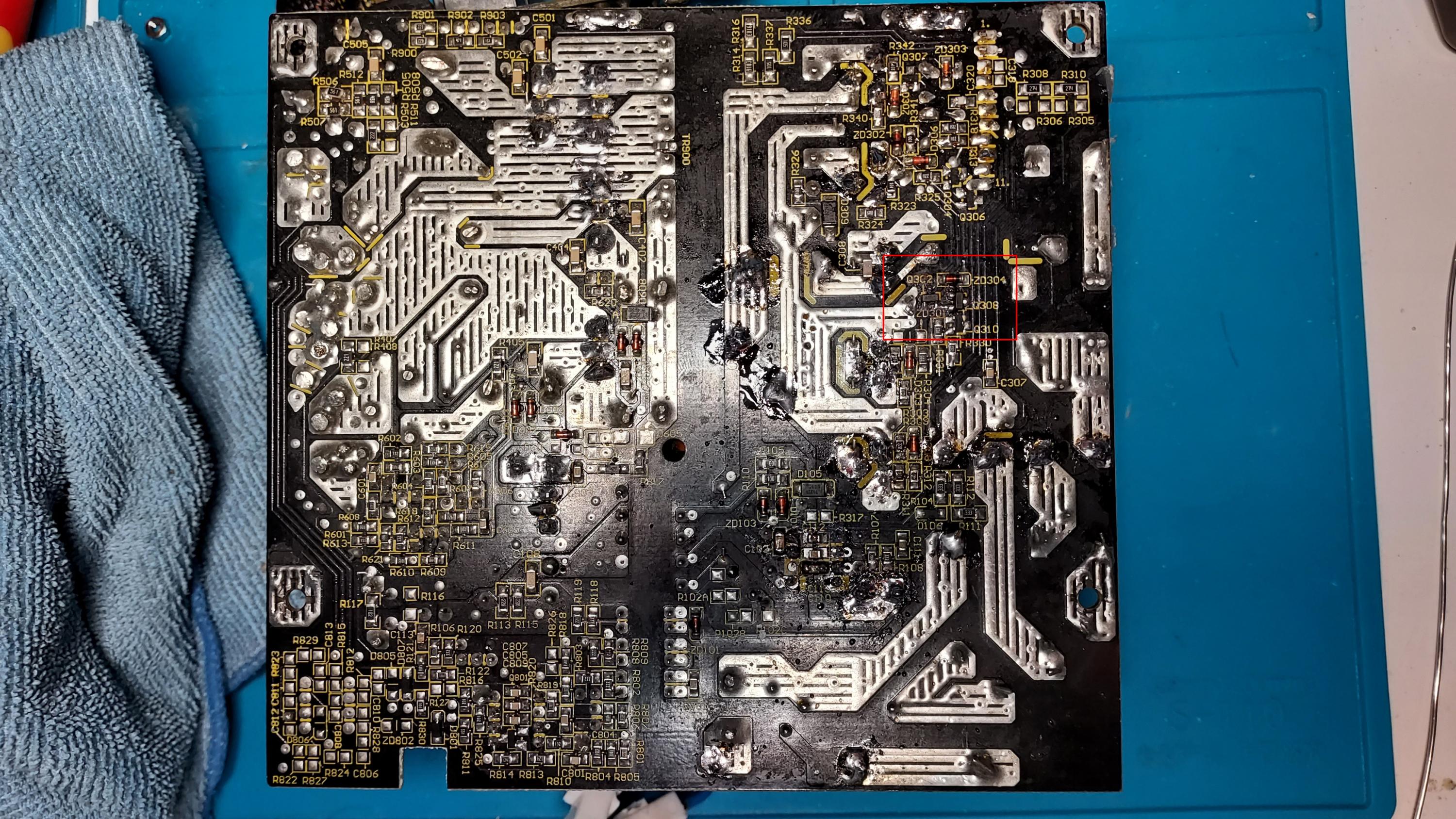

                                I have a Corsair HX450W with fuse blown ( exploded)
                                WIth first vérification both MOSFET seems to be shorted; would like to have a view of the schematics, but I cant see it on Hardware secrets review. Can you post me a diagram to have a view of the principle of operation of APCF. What is the IC based circuit ?
                                Thanks and best regards
                                Jean-Louis
                                • Clunche
                                  • Mar 2020
                                  • 12
                                  • France

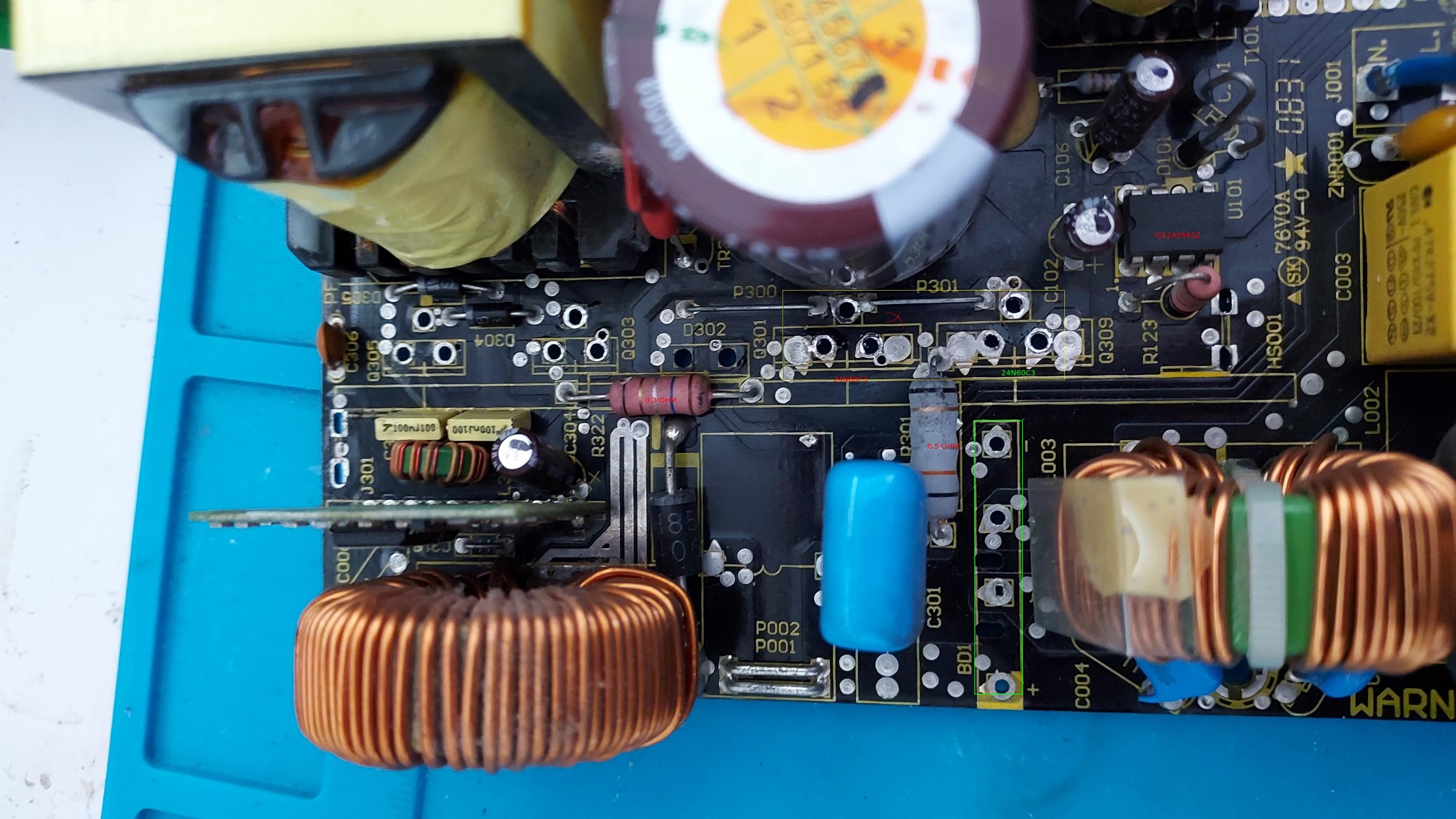

                                  Hello Jean-Louis, the board I fixed was driven by a UCC28515 which is a combo PFC + 2SW forward from TI. Once the MOSFETs are removed - you need to extract the whole heatsink at once, with 5 TO-220 to unsolder - you can supply the daughter board with a 12-V dc supply and make sure the driver signals are observed at the MOSFETs gates:
                                  The standby power supply uses an ICE from Infineon but needs a sense of the input line to start hence the external 12-V dc that I applied at the auxiliary Vcc cos' I did not want to apply ac:
                                  The issue on my side was the in-rush NTC, stuck between the bulk capacitor and the transformer. You can check its value immediately by measuring the resistance between the PFC diode cathode and the bulk capacitor. It should be a few ohms but was kOhms in my case. I replaced the MOSFETs and the NTC, back in business : )
                                  Good luck and please use an isolation transformer when powering this beast while discharging the bulk cap. through a resistor at power off.
                                  Christophe
                                        I really dislike those designs with a passion.
                                        There should be absolutely NO other component between the APFC MOSFETs, APFC forward diode/rectifier, and the bulk cap. Putting anything there that can go open-circuit is asking for trouble... and usually that's what happens - APFC MOSFETs blow, because the APFC inductor has nowhere to dump its energy after being charged up from the FETs. As a result, the voltage across the APFC MOSFETs sky-rockets and shorts them out. Really a shit design.
                                        The NTC should be up front, right after the fuse... and by-passed with a relay when the PSU switches On, to prevent the APFC from unnecessarily over-loading the NTC. Also, beyond ~100 Watts of power usage, a relay becomes more economical (energy wise) than an NTC. But I guess a couple extra parts is too much for many PSU manufacturers. :\
