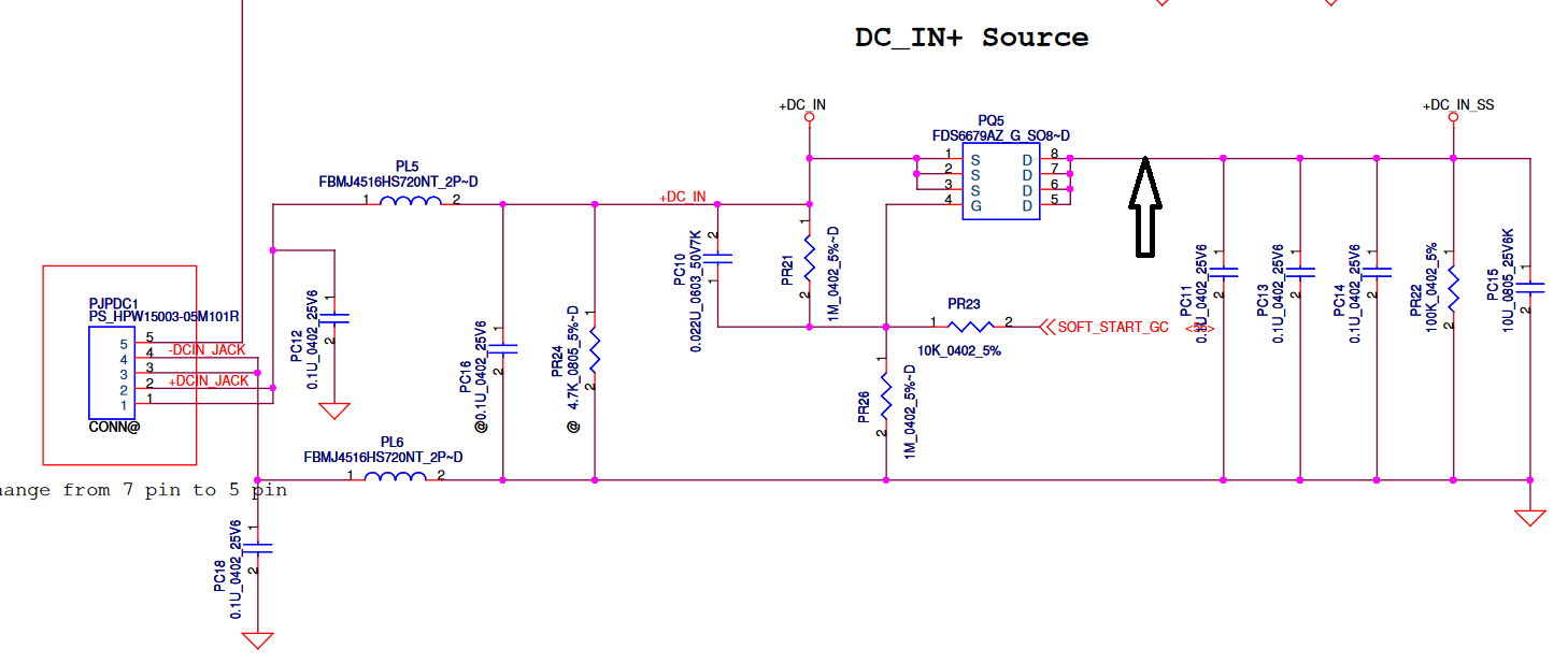

    Measure the MOSFET between Drain and Source while it's unsoldered, is there a short on the meter in diode mode in both directions?
    Are you able to measure total power consumption of the whole board? I.E. by connecting it to a lab power supply.
    When MOSFET is desoldered, measure point +DC_IN_SS to ground in diode mode, is there a short? If There is, inject a small voltage, no more than 1,5V to start with and check what gets hot.

        You can get a raw cable that is being used with Dell power bricks, connect that to lab power supply, set to 19.5V then connect to laptop and observe the drawn current on the power supply. If it maxes out and goes into constant current mode then it's a true short.
        As for voltage injection, Inject the + on the marked point where MOSFET resides, removing the MOSFET is not mandatory to do this unless it's shorted out. Remember no more than 1.5V to start with, we don't know if for example a part of supply of CPU or other low voltage part like PCH is not shorted and we don't want to damage the delicate part. If current draw is very low or you can't detect the heat from the shorted component, you can gradually increase the current on the lab power supply until you get to about 2A, you should be able to detect the heat then.

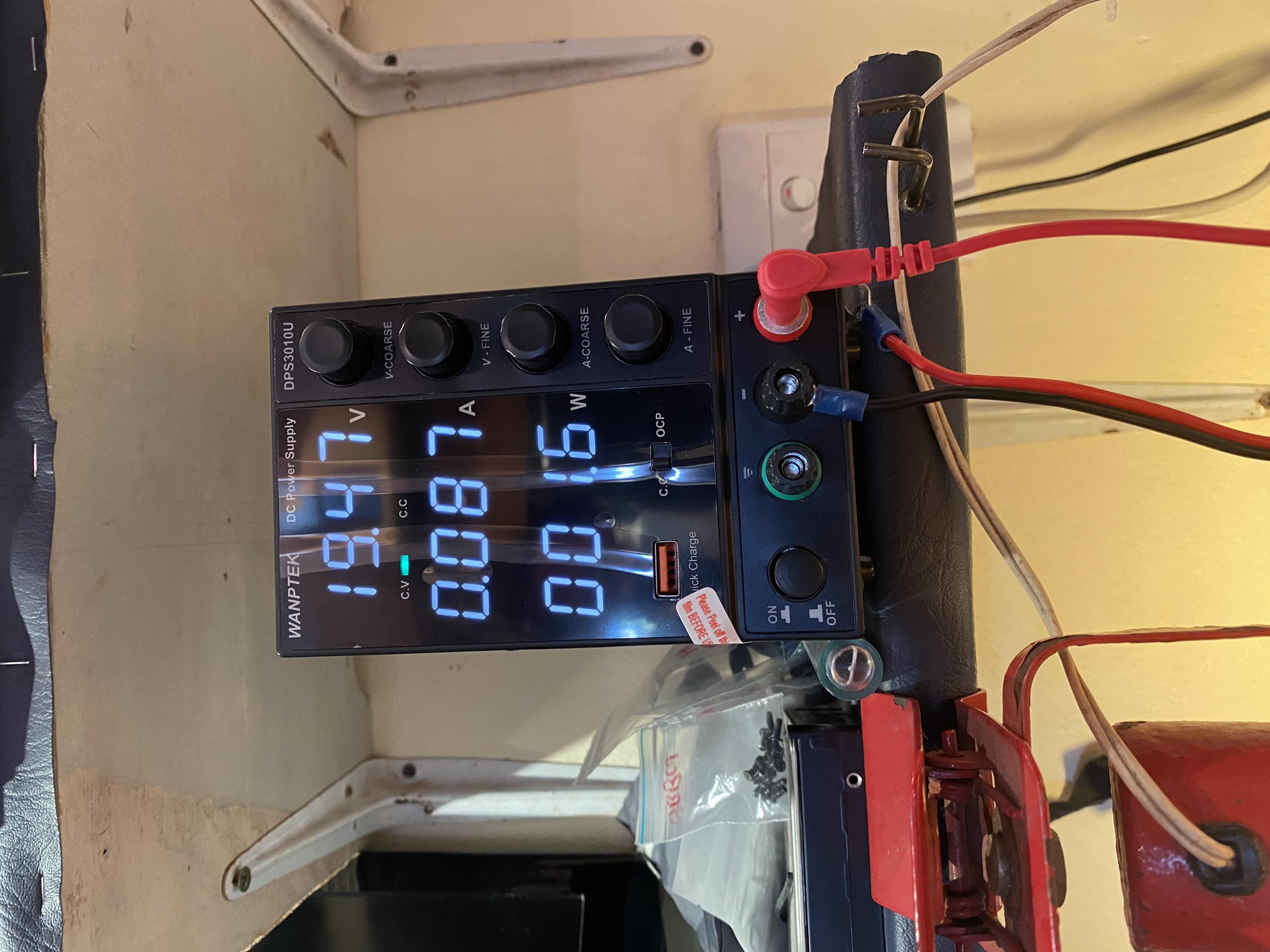

          Thanks for the info. so I did as you suggested and these are the results.
          I removed the Mosfet measured in Diode mode I get 0.187 from source to drain and vice versa.
          I tried injecting 1.5V but i couldnt feel anything getting hot. I will try increasing and test again.
          I didnt have a Dell Power brick to kill so i set power supply to 19.5V and put the red probe on the Positive where the DC jack is and the picture is the result.

            Remove all power. Meter in resistance mode.
            What is the resistance to ground of the source pins on PQ5 ?
            Resistance to ground of the drain pins of PQ5 ?
            You are drawing 87 mA of current which is very low so the logic board is not being powered.

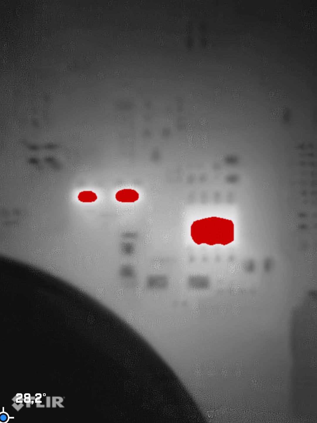

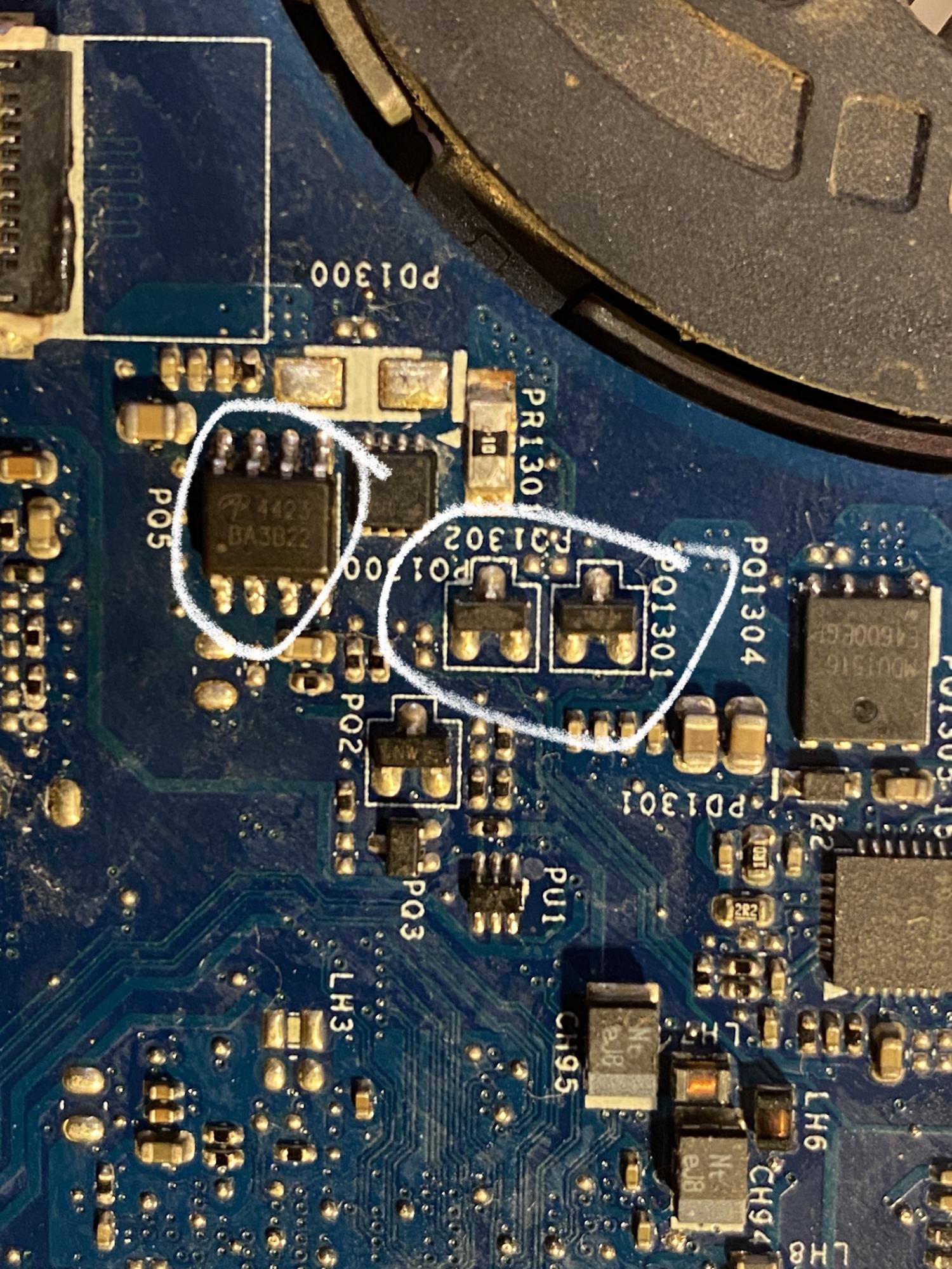

                              Thanks again for all the help. so i took a chance and connected things back up to test with the AC plugged in and i noticed the following under the thermal cam.
                              the following in the pics get hot.

                                Ok so i swopped out PQ5 which is a AO4423 MOSFET with a VDS of 30V with a MDS3604URH MOSFET which also has a VDS of 30V. Now PQ% no longer gets hot but PQ1301 & PQ1302 get very hot.
                                Do you think perhaps they are bad? i cant read whats written on them to try and find a substitute.
                                • mon2
                                  • Dec 2019
                                  • 14679
                                  Re: Dell E5530 completely dead and MOSFET getting HOT! Please help.
                                  Yes, perhaps damaged but they are acting like SPST switches to allow for the charger IC to measure the current being consumed by the main logic board power rail. The charger IC is measuring the voltage drop across the current sense resistor @ PR1301.
                                  Respectively, these mosfets should not be getting hot unless there is some excessive loading event.
                                  Remove all power -> meter in resistance mode.
                                  Measure the resistance across:
                                  source & drain
                                  source & gate
                                  gate & drain
                                  pins of each mosfet. Post their measurements.
                                  The part is a jellybean P-channel mosfet and can be replaced with many others.
