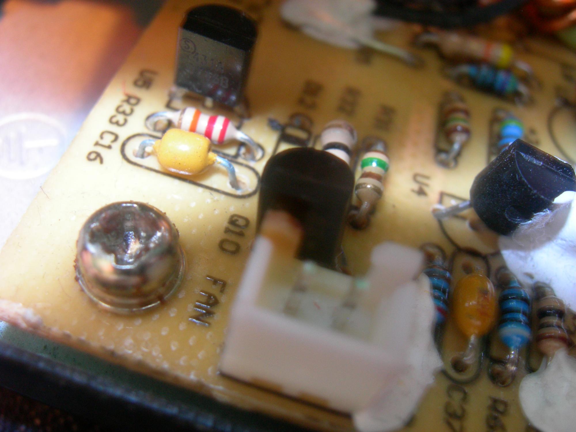

          If this power supply has a fan controller, make sure it is working properly. Check the output voltage. If it isn't high enough to make the fan start, make sure the thermistor is still in contact with the heatsink or the component it was originally supposed to contact. I had a power supply where the fan didn't spin and another where the fan didn't spin quickly enough to cool it. In both cases, the thermistor was not in contact with the heatsink.

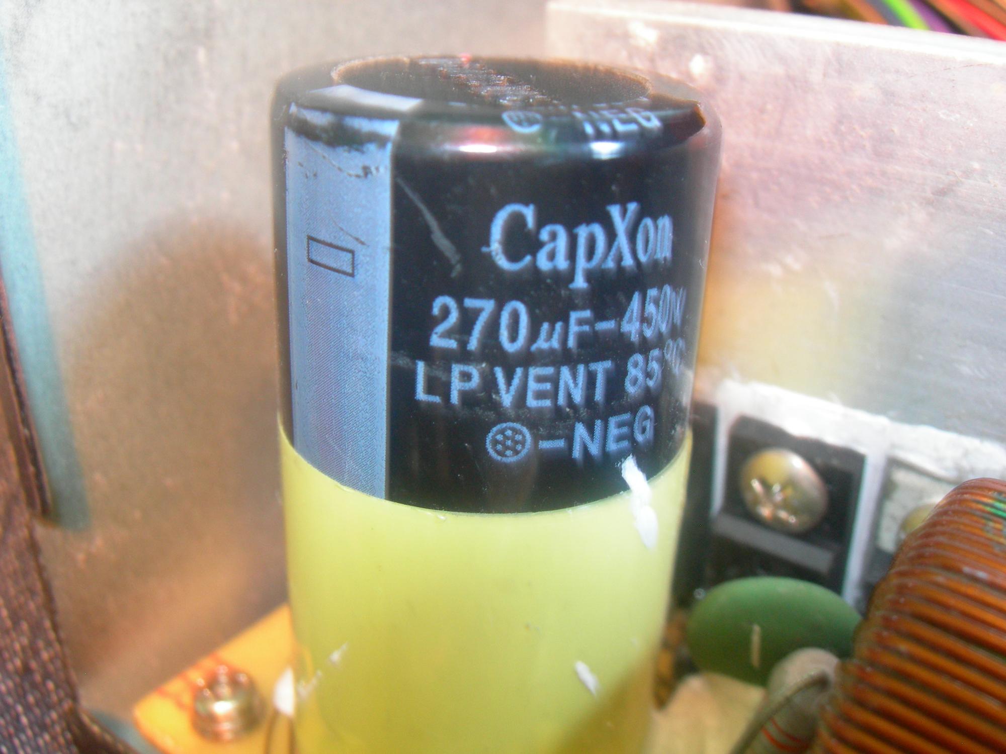

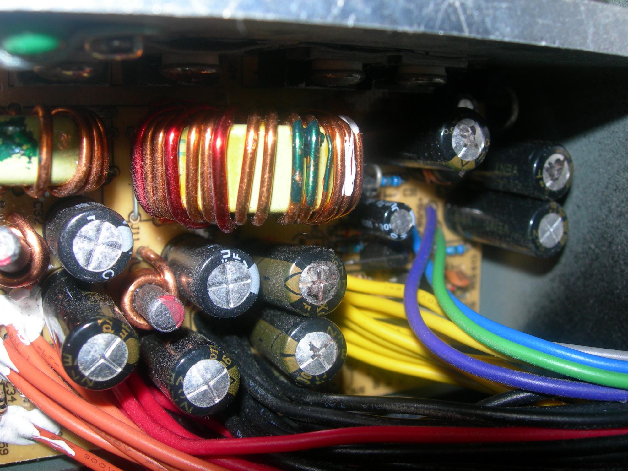

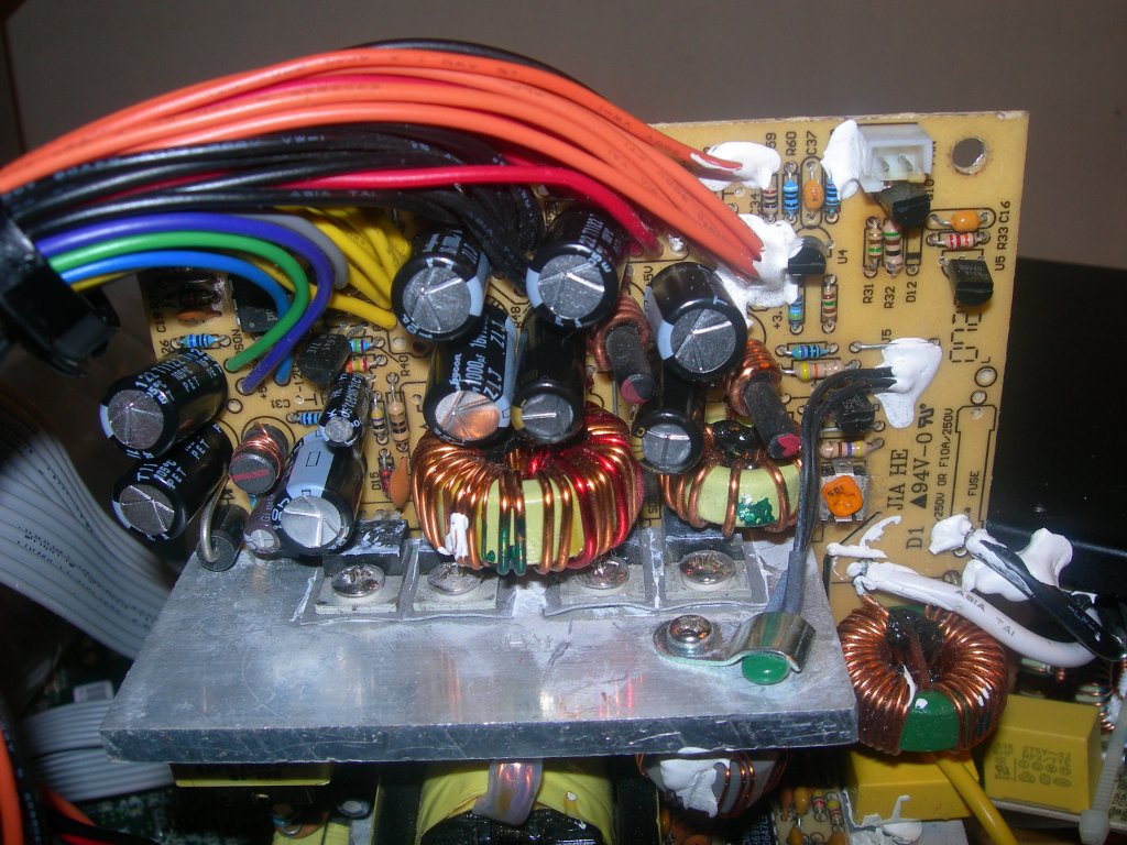

            So, I tore the PSU apart.
            First thing I noticed is it has several bad caps, so I will replace them. They are CapXon. This PSU is on 24/7 in standby (<5W USB draw for battery charger and wireless mouse/keyboard) most of the time (probably 30% usage e.g. playing a movie) but has only been used for 6 months. CRAP!
            Second thing I noticed was around the fan connector there was some burned plastic. This was probably produced by the nearby 2N2222A transistor which is right against this. I suspect this transistor has failed, to the point it's not providing sufficient current to the fan. I tested the fan on 12V and it works fine. I feel replacing the transistor won't be sufficient, as it might just die in 6 months anyway. I think I have a heatsink for a TO92 somewhere.
            Also, the input cap - a 270u 450V - is way too small for a 650W power supply. If it's 650W, it's going to be pulling ~2.8 amps from the plug (at 230V), plus maybe 20% losses, so 3.4 amps. That would be about 125V ripple across that main cap. No way the switching side is going to cope with that.
            What type of caps should I use to replace these? I'll be needing small diameter but tall capacitors. Rubycon ZLH? Panasonic FC?

              Re: PSU fan stopped...
              What series are the Capxon caps?
                        Also, the input cap
                        If it has active PFC it'll be working at 400 volts or thereabouts, so the situation in the primary won't be that bad. That cap will have to swallow quite a bit of ripple tho, and given that it's 85C... yeah you should use something better there.
                        A working TV? How boring!
                          Yeah, but the ripple voltage equations mostly apply for PFC too (for COT topologies mostly.)
                          I've got a 470u 400V CapXon I pulled from an 850W version of this PSU. (which was a joke too) I might change it over.
                            Original CapXon are LZ. But I doubt they'd match their spec, anyway...
                            http://www.datasheetarchive.com/CapX...datasheet.html
                            Panasonic FM seems like a good match if I use the following example
                            Capxon LZ, 2200uF 6.3V, 10x16mm, 1910ma, 18mOhm
                            FM 2200uF 6.3V, 10x25mm, 2470ma, 18mOhm
                                  Rubycon ZLH's: http://uk.farnell.com/rubycon/16zlh1...16v/dp/8126291
                                  1000u, 16V, 8x20mm, 1500mA, 29mOhm.
                                  Compare to Capxon LZ (so claimed):
                                  1000u, 16V, 8x20mm, 1850mA, 20mOhm.
                                  Nichicon HM is better though: http://uk.farnell.com/nichicon/uhm1c...16v/dp/1823808 (and considerably cheaper.)
                                  1000u, 16V, 8x20mm, 1870mA, 18mOhm
                                  Either will be better than the LZ cap, I'll probably use the Nichicons.
                                  • c_hegge
                                    • Sep 2009
                                    • 5219
                                    Go with the nichicon HM, since they are the closest to the specs of the originals.
                                      After replacing the caps (7 x 1000u and 2 x 680u) the power supply voltages are now all about 0.1V lower, which seems better. Also, replaced the transistor and the fan now spins. Happy days...
                                      Used Rubycon ZLJ and Panasonic FM. Couldn't get hold of Nichicon HM as they were too expensive (cheap individually, but a ~£16 shipping charge!) I ordered the incorrect 10x16mm size, but I was still able to fit them in. I expect the Rubycons will be fine; the system isn't under much load and I'm very sceptical about the Capxons meeting their original claim of 18mOhm.
