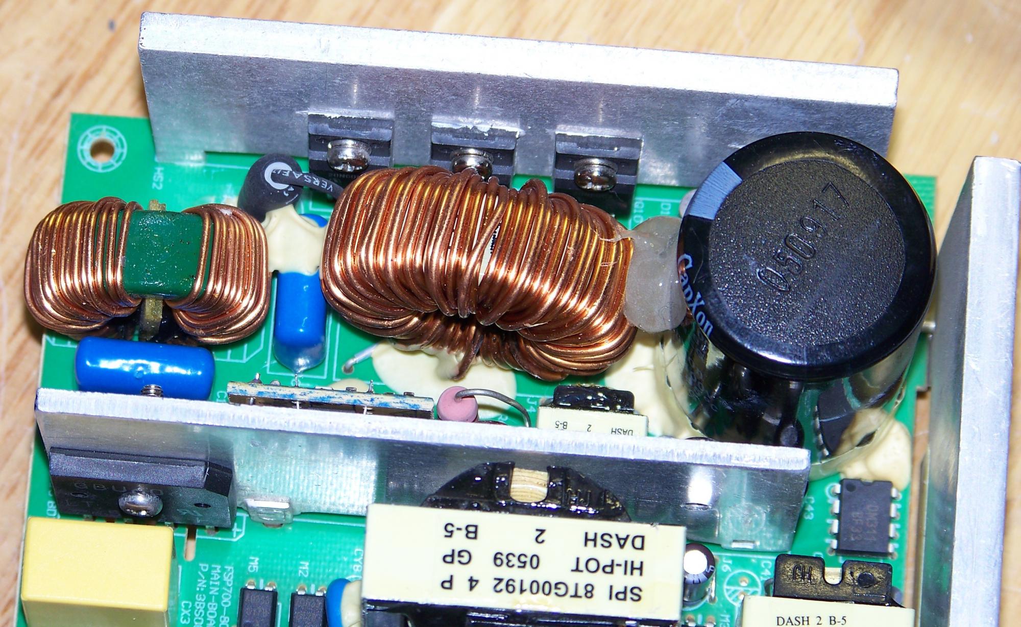

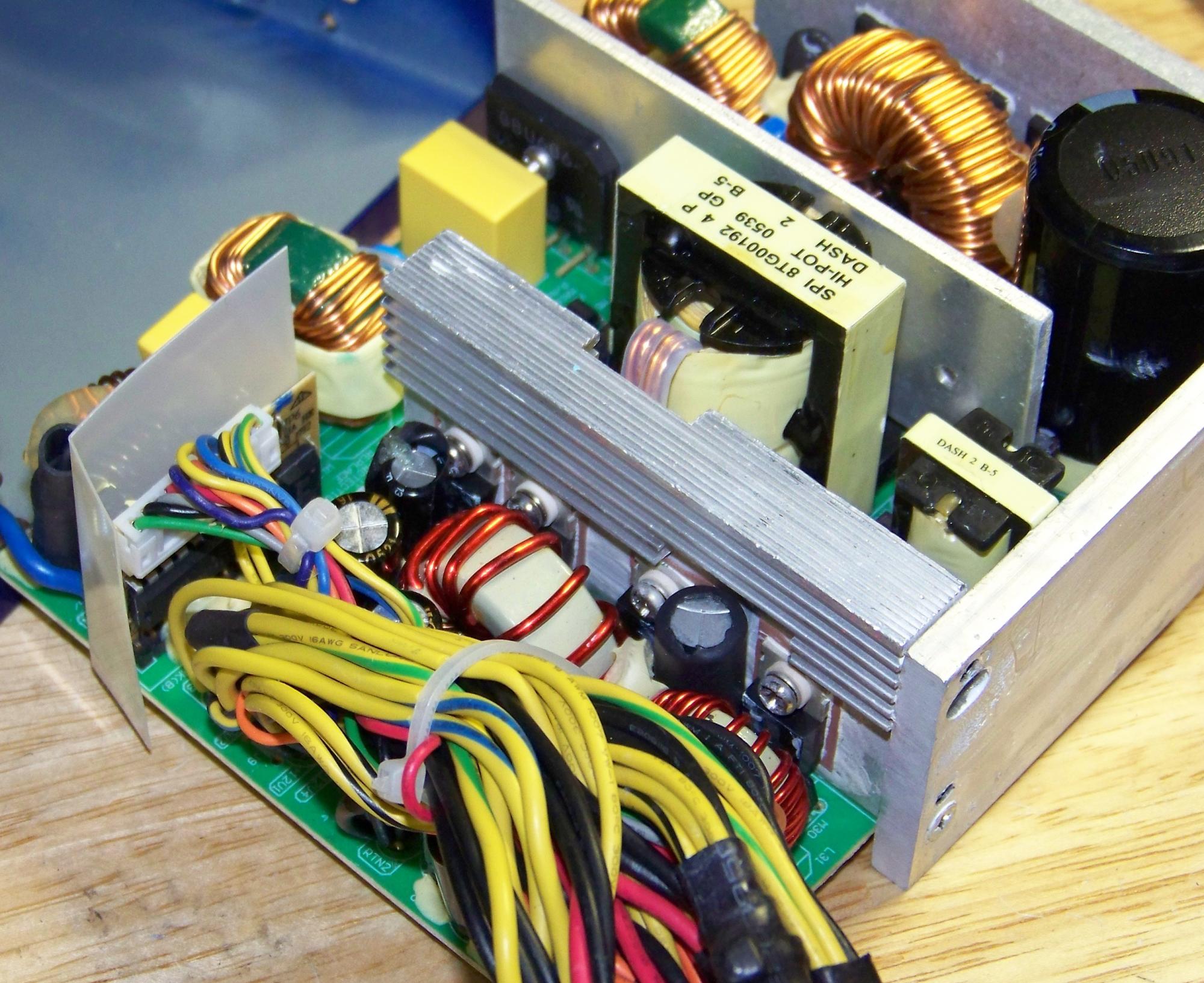

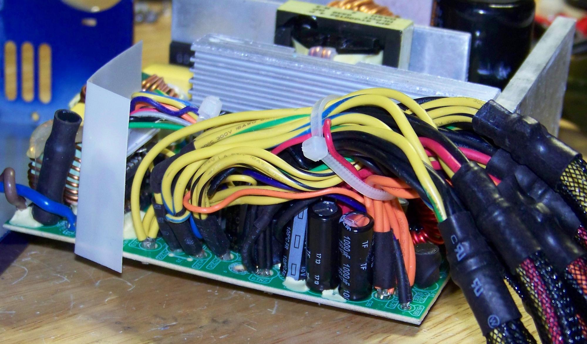

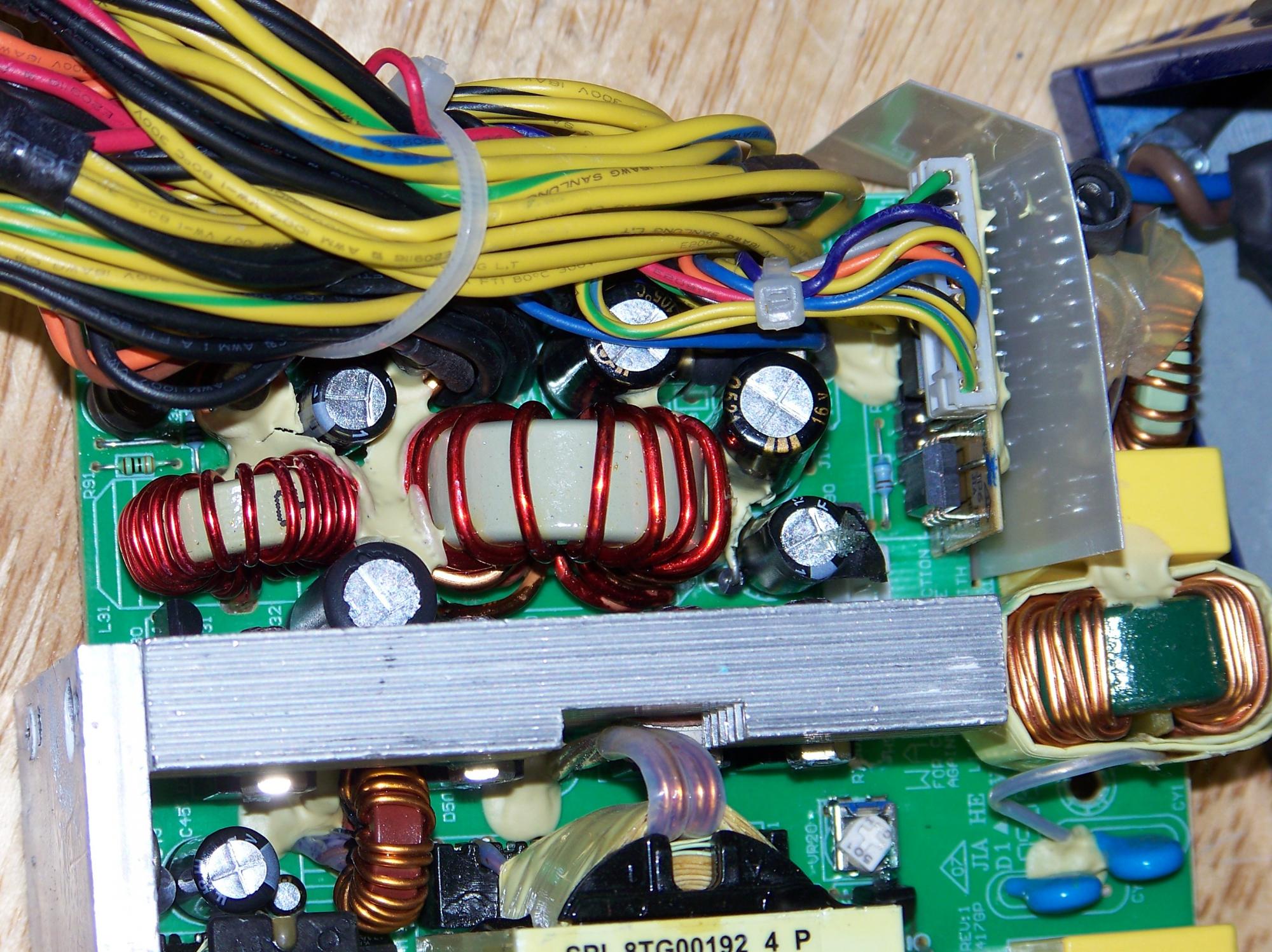

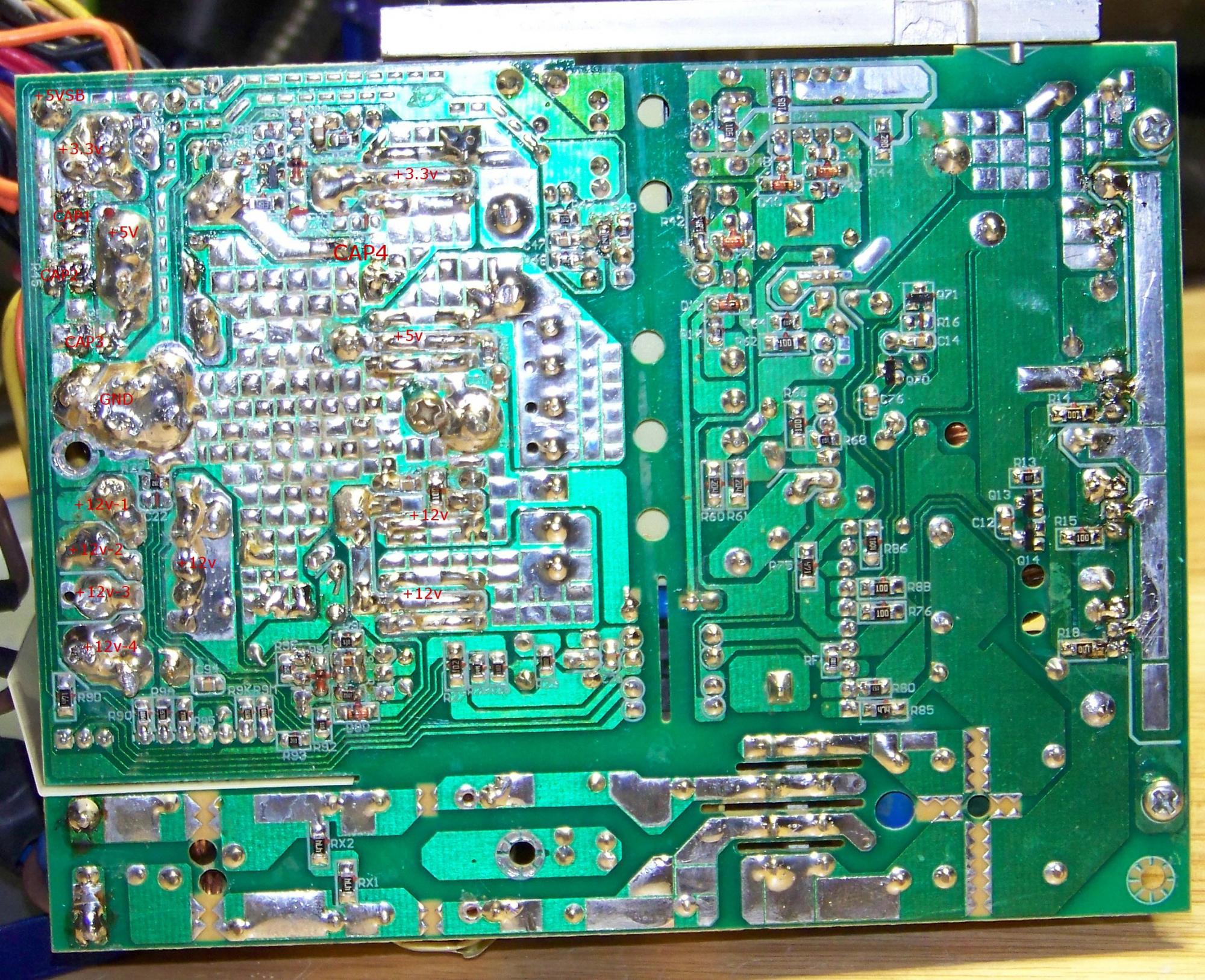

                    I haven't rechecked them since this last time it blew but last time it was the IGBT. They are 20N60C3 IGBT's (three of them) and the diode is a BYC8-600. The power supply model is FSP FX700-GLN. The switching transistors are PFV218N50 and the rectifier bridges are GBU606. The bridges were never taken out but looked ok (no shorts or bad polarity checks). The switching transistors were not taken out either but no shorts as well. It didn't short out after I replaced the one bad IGBT but it also wouldn't supply a proper load either. It only started tripping the breaker once I put a good load on it. (I hope this all makes sense)
                    Below are links to images of the PSU (the imageshack thumbnails weren't working right and didn't want everyone to download the images when just viewing this thread). The underside image I labeled though you might have to see it full size to see the text (larger font but didn't want to obscure anything).
                    Underside:
                    http://img221.*************/img221/3962/10038542.jpg
                    I replaced the three caps under the wires (labeled CAP1-3 on the underside image).
                    http://img847.*************/img847/5577/1003853k.jpg
                    The cap in the heatshrink against the heatsink is the panny 2200uf/6.3v I somehow now was able to get in. It is CAP4 on the underside image. (this was initially an OST 2200uf/16v that I replaced with a 2200/6.3v Nichi HM)
                    http://img27.*************/img27/3848/1003852v.jpg
                    This is the secondary. Two OST RLP 2200uf/16v (marked) caps I left as I didn't see a need and didn't know of a 16v replacement that would fit. All the smaller caps I replaced with Panny FR's (1000uf/16v as they were previously labeled (Capxon KF)).
                    http://img141.*************/img141/217/1003851.jpg
                    Primary side, cap is a Capxon 470uf/400v:
                    http://img600.*************/img600/9118/1003850m.jpg
                    Top-down image:
                    http://img803.*************/img803/1706/1003848.jpg

                        Attaching images to post. Prevents loss of information should Imageshack decide to delete them.
                        Use the "Advanced" button and the "Manage Attachments" section to either upload them from your computer or a URL.
                        IGBT is not the correct terminology. These are MOSFETs. Datasheet attached.
                        Replacing all 3 at the same time is the correct method. They appear to be connected in parallel and work together to provide 60A total. That is PFC. The control board is mounted vertically across from them.
                        If the PFC coil is shorted, that could be the source of the problem.
                        Check the 3 SMD resistors leading to the 20N60 drains. R14,15,18. R18 -looks- damaged, but that could be flux or camera angle. Code 100 = 10Ω - - Also check R76 and R8B.
                        Check transistors Q13 and Q14 for leakage.

                                      I tested the five resistors, all are 10ohm. I also pulled off the MOSfets and the middle one is blown again. That is the one linked closest to the coil (you are talking about the coil closest to the mains cap, right?).
