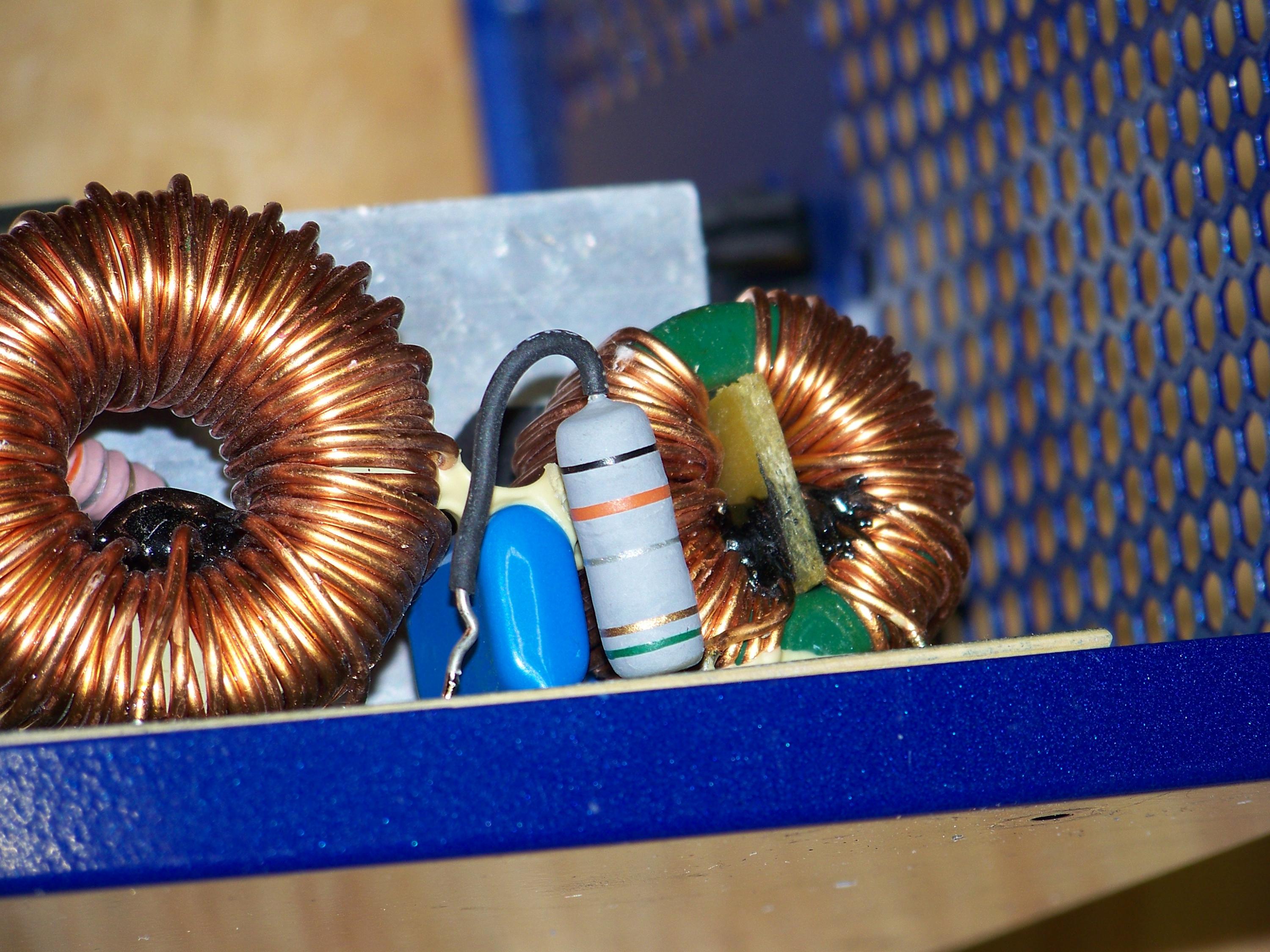

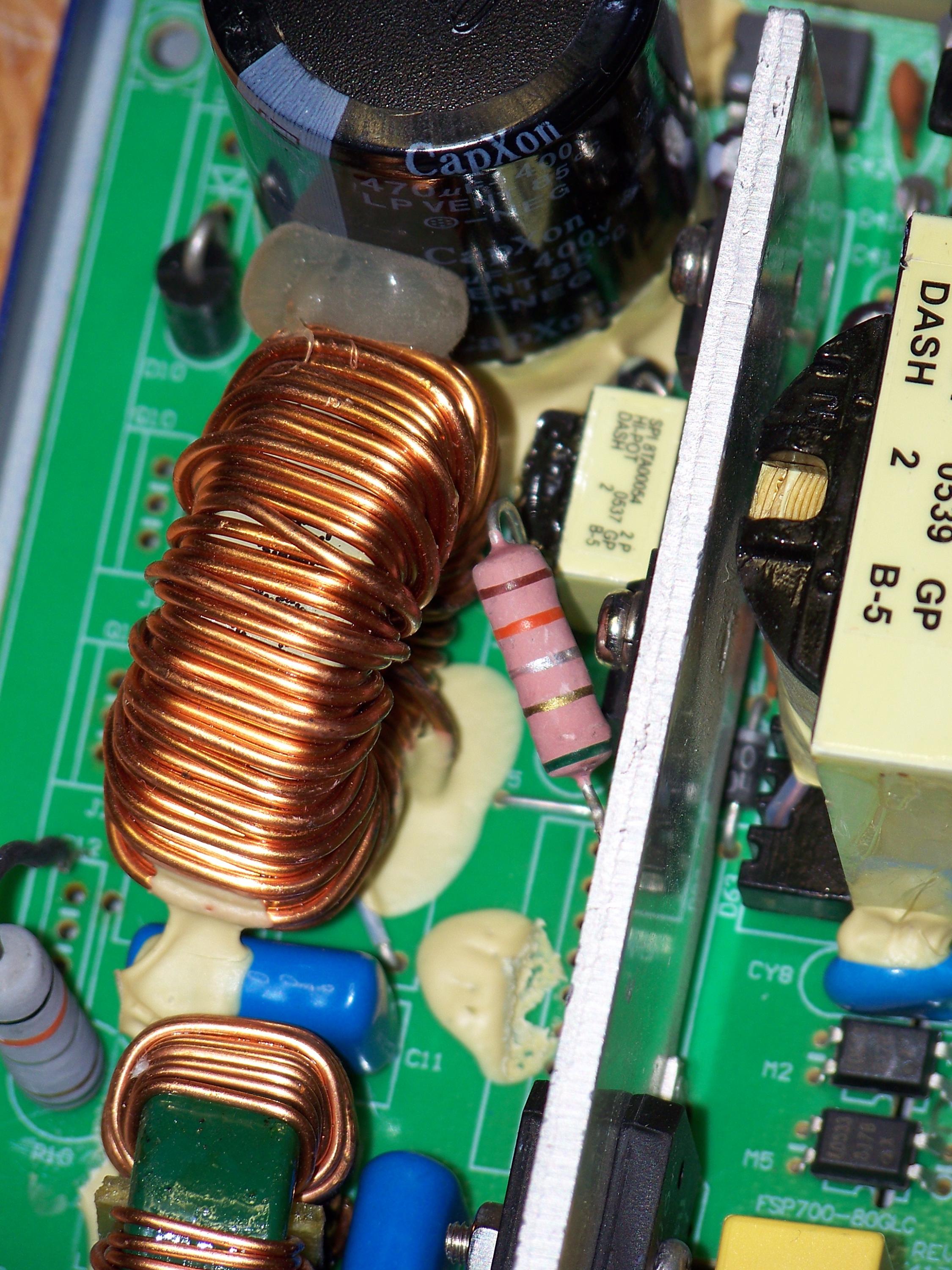

                    Hi guys.
                    I got some time again and am looking at the 700w PSU again (left them in a corner in the basement since). I found a bad/weak solder joint on the APFC board but also two resistors with 0 ohms.
                    I'm thinking the pink one is 13.8 ohm and the blue as 3.8 ohm but I don't see those as common values. Can anyone help ID these?
                    thank you!
