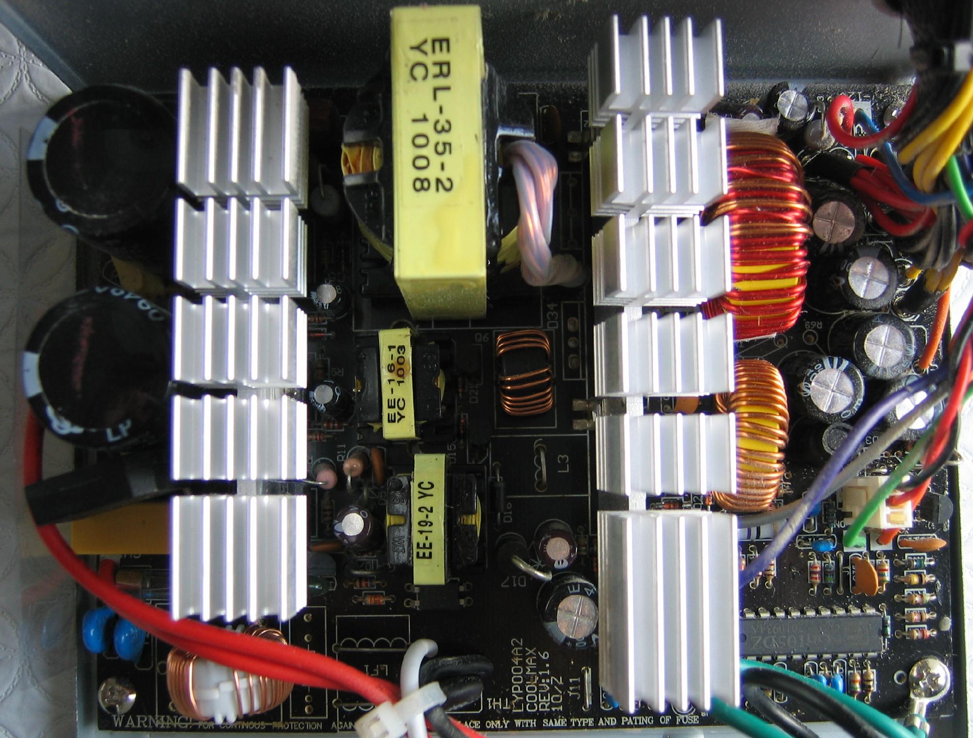

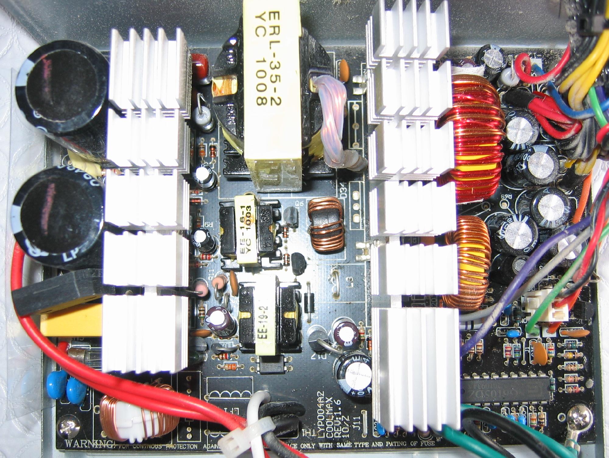

                      I recently got one of these for free. It works, but I can definitely tell from the weight (or lack of it) that it won't do 500W.
                      Since I have no gaming needs and tend to run just one old 40GB hard drive and use onboard video, I might use it in a low value P4 system and store no data on it. Alternatively, I can use it as test power supply for when I get unknown working motherboards.
                      It is cloudy today so the photos aren't too great, but this board looks different from the review site.
                      And before you bash it too much, this one is working, while the other 4 Antecs I received recently all have bloated Fuhyjuu caps including one that has 11V DC on its 5V SB rail (killing an Intel 775 motherboard).

                        Re: Coolmax V-500 review @ Hardware Secrets (is this 2005???)
                        Yours is the same one that I got. Its made by a bit more competent small chinese OEM called LongYi.
                                The LongYi units have OPP (as do the sunpro safety series, but obviously that doesn't help much) but hopefully it is not set too high. If it's anything like mine was it is not beefy enough to do 500W, though it is silkscreened for two diode packs on the 12v and 5v rail.
