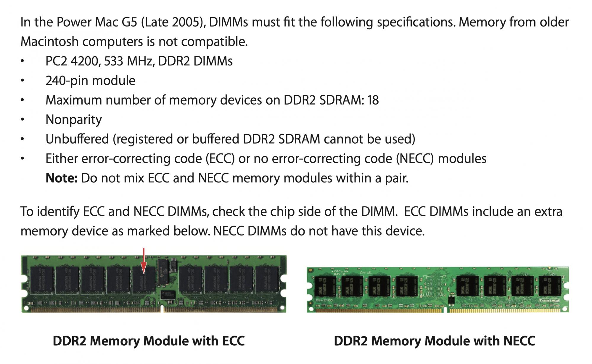

I've attached a datasheet and design guide from IBM concerning the CPC945. Reading through these, it's not clear to me that there actually was a way in hardware to disable support for features of the 945's memory controller.
Apple glosses over it in their documentation, including a very confusing image of what looks like an RDIMM as their example of "compatible ECC memory" (see Service Source page 135).
