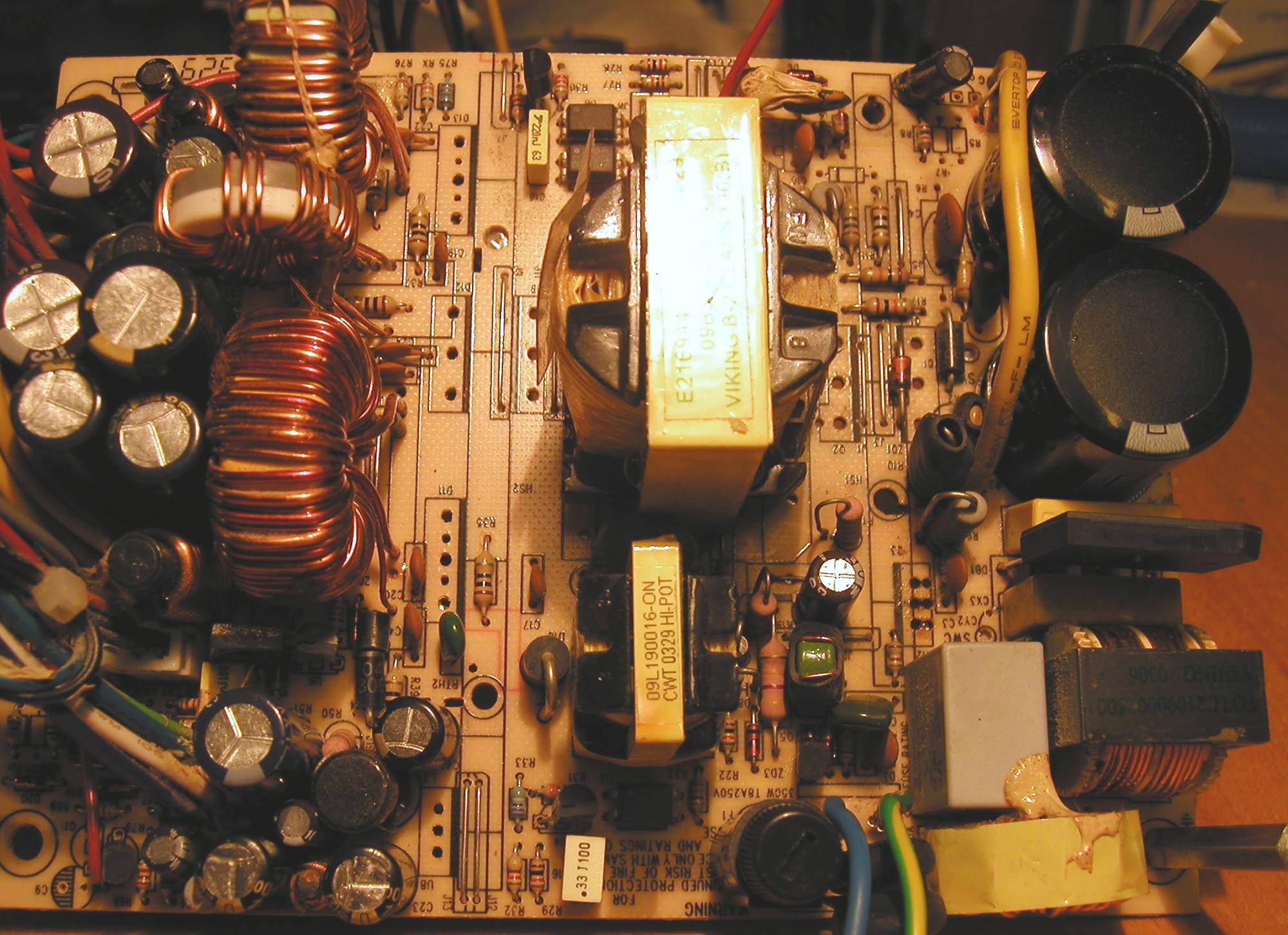

                                      Just some updates, no time yet for the fire test.
                                      I got a new UC3844 and also traced back its supply on the board. It is the same 19V as for the APFC chip, and the PNP transistor that drives it reads OK.
                                      Since my desoldering skills are improving, I also removed and checked the output Schottky diodes, which respond as expected.
                                      The load that I used for testing was 3.9 Ω for 3.3 V, 1.9 Ω for 5 V, 5.1 Ω for 12 V (the sticker specifies minimum loads of 0.5 A, 1.5 A and 0.8 A respectively). This should give a total load of 44 W, but due to the reduced voltages I had it was rather 16 W.
                                      Tomorrow I will put everything back, cross my fingers, get the helmet and... should you notice a boom, complete with mushroom cloud, you know where it's from.
                                      I also took some pictures of the board with the heatsinks removed. I tried not to use the flash, so the lighting is not the best.

                                        #39
                                        Re: Antec SL350P PSU
                                        Good. Keep your sense of humor about this and it will work out.
                                        Another member had the *BOOM* occur and he was suspected of causing an airliner crash that day.
                                        Nice pics too.
                                        I don't see anything blatantly wrong. But Antec (and others) have this horrible habit of leaving component leads long and then bending them over neighboring traces. A little bump while working on them can result in a short to the next trace over. Take a real close look at all of those on this board. There are dozens.
                                        I use a very sharp pair of lead nippers to remove all of those. Lacking those, a nail clipper will do nicely also.
