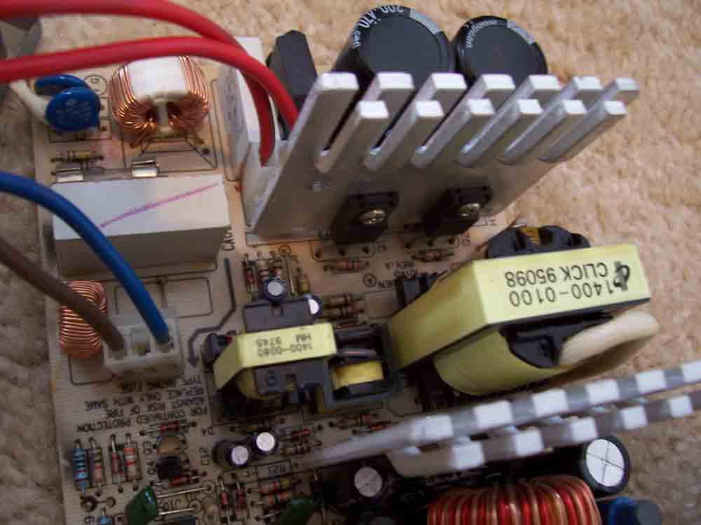

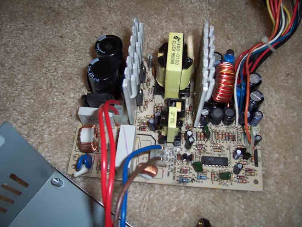

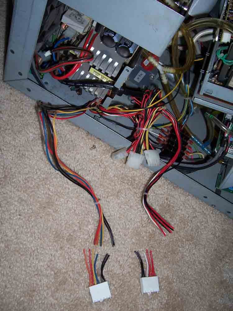

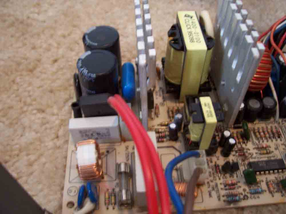

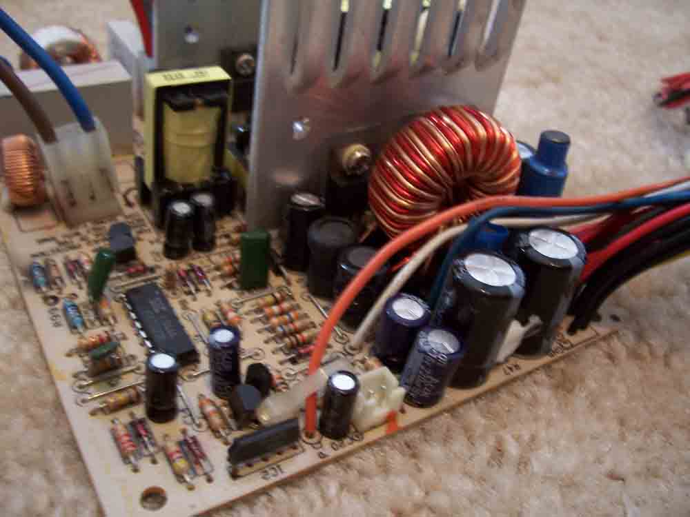

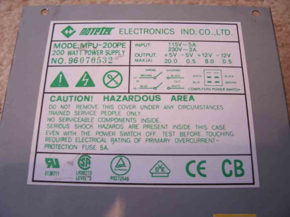

    im sorry i realize anyone was ansdwering my post, out of desperation i checked back here to see it has lit up like a christmas tree. here are some pictures. i did get a ATX power supply as suggested and i patched it on based on colors mostly.
    still all i can get is a flicker on the old style CRT screen then nothing.
    on the old psu im getting weird and unusual readings like blue is -10, im guessing its a safe bet thats supposed to be -12.

            The orange wire is the problem. The orange on an ATX psu is 3.3v, the orange on a AT psu is for the power good. Connect the gray wire from the 20 pin connector to the orange wire of the AT connector.
            • scampo77
              • Dec 2010
              • 233
              Re: older than time PSU for automotive test machine
              the grey wire is 5.25 is that correct?
              • 370forlife
                Large Marge
                • Aug 2008
                • 3112
                Yup, the power good signal on ATX and AT psu's should be about 5v. That might be why your original one wouldn't power it on, as you said it was reading .2v. 3.3v is too low and the motherboard will assume it's the power supply saying that something is wrong with it.
