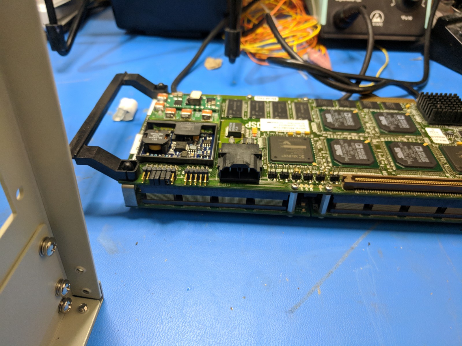

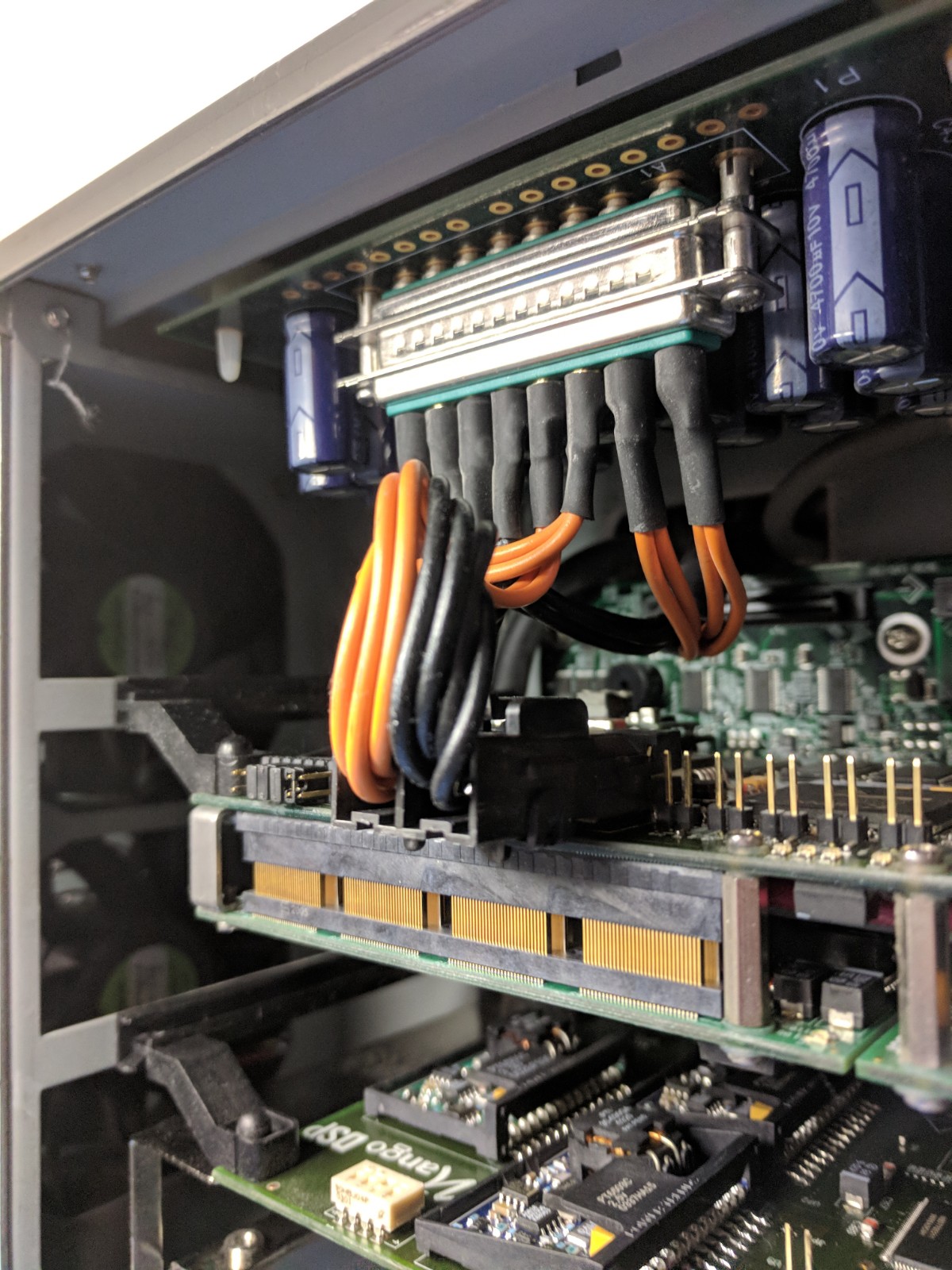

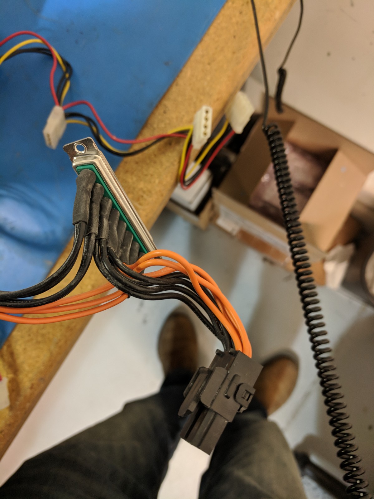

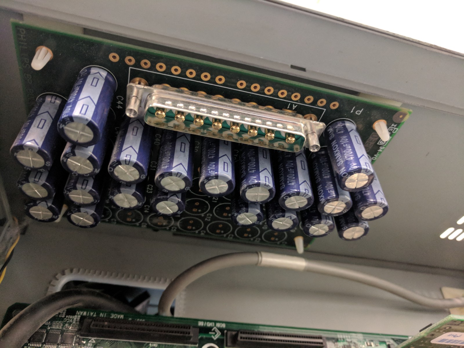

        Sorry for the delayed response I was out of town. I will follow up with the tech and get more info. I do remember that the PSU had capability to do 40A on the 3.3V rail and 46A on the 5V. This is different from the standard EG651P-VE. I'm assuming this is for the backprojector board.
        The modification involves a separate wire harness with decently heavy DC wires running to a capacitor bank before connecting to the backprojector board. Other than that, I will let you know if there's anything different on the PCB.

          Re: Enermax EG465AX-VE(G) Thermistor
          Here are some pics I had taken previously.

            Think the newer revision is the EG651P-VE-24P, it should have the newer 24pin Main ATX connector. As for high current from +3.3/+5 V, maybe some older telco PSUs may provide high current there. Or server units from dual PIII era. Or possibly some newer 12V unit with DC-DC modules, either internal, or external.
            It seems to draw actually just from the 3V3, how much? Isn't it easier to replace it with DC-DC converter fed from say PCIe connector? You can put it instead of that cap board. If the unit (or the converter) goes bad again, using more or less standard stuff you can replace it whenever you want. These hard modifications are usually a pain to replace if something goes wrong, as you can see. Also using newer HW the overall efficiency will likely be better so you'll save some power costs, internal heat etc.

              The actual draw on the 3.3V rail was not measured. It might be easier to use a DC-DC converter that can handle the current but we cannot modify the OEM's design. We have to keep everything working and intact according to OEM documentation and specs.
              Luckily, the tech was able to transfer the wire harness to the newer supply and get the PC back up and running!
