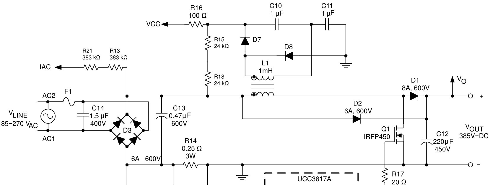

                I think only replacing the PFC FET with wire jumper should be enough, the diode conducts, the thermistor also does…however question is what will the PFC controller do without it? There may still be some reaction on the PWM fault sensing. But yeah, I guess it's worth testing.

                  If you put a jumper across the PFC FET, you're going to get a short-circuit between (+) and (-) busses on the primary side after the bridge rectifier. However, I forgot to mention: you should put a jumper across the PFC diode (or you can leave the diode if you like too).
                  If the APFC controller is unhappy due to removed FET, see if there is a way to mess with the voltage feedback circuit so that it "thinks" the voltage across the primary cap(s) is already boosted and normal. May need to read more into the datasheet for that, of course.

                    Re: Enermax EG465AX-VE(G) Thermistor
                    Right! I thought, for some reason, that the FET passes the current through. But it pulses in parallel with the cap. So just remove it and leave it be.
                      It does not. It pulls the end of the boost inductor to input B-, after the line rectifier.
                      When the PFC controller turns its MOSFET off, the end of the inductor flies up and the PFC diode dumps this energy into the "boost" electrolytic.
                      If the PFC MOSFET is jumped out, you'll make that PSU go kaboom.
                        I got the general idea, just never really checked how it was actualyl wired. According to the schematic it is in parallel though (well, in front of the diode which blocks the current from flowing back when the cap is charged higher).

                                Usually it takes the varistors which sometimes protect the rest. If not, than check bridge rectifier, PFC diode (and the return diode), PFC FETs and switchers and PFC/PWM controller driver (may be combo chip).
                                That drawing is reference circuit from the controller datasheet, nothing specific.
