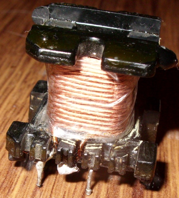

    The transformer. For this power level, i will be using two transformers made on the very common EI-33 core. Reason being i have lots of them. The primaries are going to be in parallel, and each transformer is going to have one 88v rail tapped at 18v. The 18v rails are for feeding some 12v linear regulators for the driver supply - again, this is an unregulated supply so some headroom is advisable.
    My spreadsheet worked out that i will need 62 turns on the primary and 37 turns on the secondary, with a tap at the 29th turn for the 18v output. I chose to use 8x 0.2mm (32AWG) twisted together wire for the primary. Homemade litz wire. The reason for using multiple strands of thin wire instead of a single thick one is that the skin effect comes into play at high frequencies, read more here. My supply will be working at 100kHz so i could get away with wire as thick as 0.4mm (26AWG), in fact, this is exactly why i will be using 4x 0.35mm wire for the secondary. 0.2mm wire tends to get real messy real quick, and it doesn't help when you're trying to twist together a few meters of it.
    For good coupling between primary and secondary i will wind half the primary, wind the secondary, then wind the other half primary on top. If you ever took apart an ATX PSU transformer you have surely noticed the same method. The best coupling is achieved by bifilar winding (twisting primary and secondary together and winding as one), but this is a big no-no when mains voltage is involved. I will be using one layer of tape between each layer of windings, and three layers between the primary and secondary. Here's how the transformer looks after winding the first half primary. More progress, tomorrow.

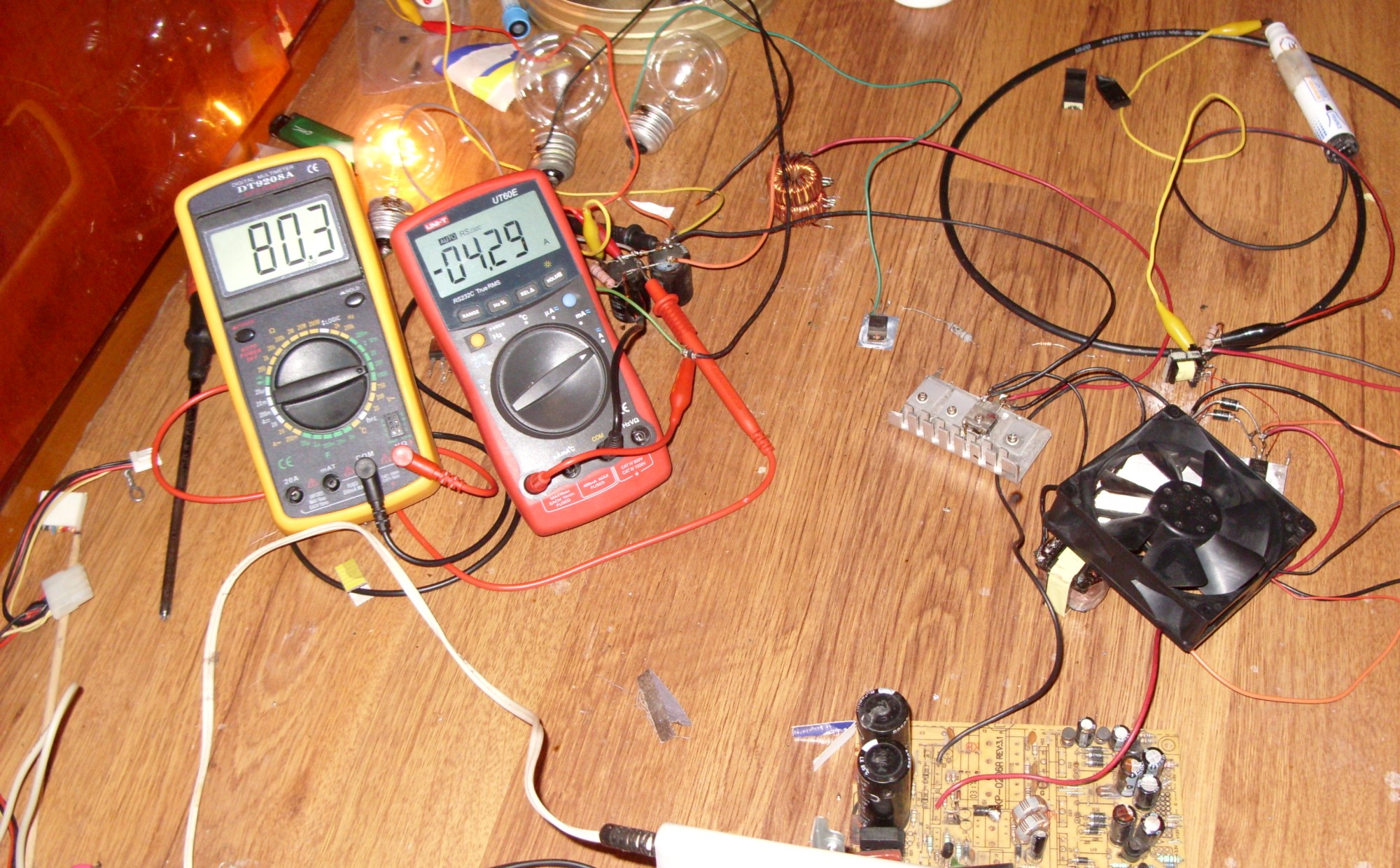

                          Ghetto PSU Company Inc here. The previous EI33 still blew my MOSFETs up, so i gave it one more shot. Third time lucky they say.
                          I used a 100mT flux density and ended up with the following configuration. 100 turns primary, 68 turns secondary. Wound as follows: 50 turns primary with 2x 0.35mm wire, 13 turns secondary with 3x 0.35mm wire (for the tap for feeding the 12v linear regs), the remaining 55 turns secondary with 2x 0.35mm wire, and finally the last 50 turns primary with 2x 0.35mm wire.
                          I knew the copper loss was going to kill me on this one. But a hot transformer is still better than blown MOSFETs. And... results? See for yourself.
                          And yes, talk about a messy floor. At the moment the whole thing is being driven from an adjustable generator using a 555, a couple trimpots and a MOSFET for driving the GDT, no TL494, no feedback, no nothing, all is controlled by hand. The fan is a 24v 92mm fan being run at 12v so it doesn't move as much air as you could imagine. The heatsink holding the MOSFETs stays cool, the transformer is at about 50C estimated, i'll probe it with the thermocouple later.
                          You can see the primary caps at the bottom (two 680uF 200v caps in series), the tiny GDT, the crap diodes which i took from the worst of ATX supplies (200v 3A, and actually they're quite well suited for this job), output coil (which btw is taken straight from an ATX supply, i'm using the 5v windings in series, and it runs extremely hot, actually the reason it's sitting on another coil is because it got so hot that it started to leave hot glue on my floor! ). The tin which didn't make it in the pic in whole, is filled with water and is holding some of the (undersized) load resistors to keep them from burning up. Romanian load testing at its finest. The secondary caps are currently 2x 330uF Viva... anyone remember them?
                          And yet, with all of this, i'm getting 350 watts. I expect at least 20W more from a proper output coil, some 5W from better rectifiers, again a few more watts from beefier caps... and looky, there's my 400W. And all ATX PSUs which use this core blow up at 250W. Romania 1, China 0. And btw, the switching devices are a pair of those - based on their voltage rating (220v mains here), they should have blown in the second the supply was plugged in - but apparently nobody told them. The primary diodes are some 5A ultrafasts from Central, don't remember their exact model.
                          I'll be dealing with the output coil now, then winding the second transformer, then i'll get to designing a proper control circuit. AND YES it is gonna be regulated.

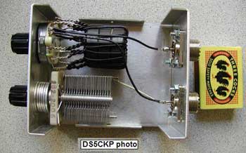

                            You'll *love* this: http://schmidt-walter.eit.h-da.de/smps_e/smps_e.html
                            I wound a new transformer for what was a Hipro 200W AT PS. Turned it into a 45A 13.8 -14.2V supply. New/bigger caps, two SBL3045CT LV rectifiers, MJE13009s instead of 2SC4242s, bigger line rectifier, line wires, heavied up/paralleled traces.
                            And the most important part- completely changed the feedback paths. Many times, you'll see 'conversions' that consist merely of a big load on 5 to keep things happy. That doesn't do anything about the outputs being dependant upon each other, the too-small 12v rectifiers or the smaller 12v winding in the transformer.
                            I'll start another thread for that, don't want to hijack.
                            How do you like that Uni-T UT60E, Unique? I've got the next lower model, without RS-232 nor TRMS, labeled as MCM Electronics' Tenma 72-7740. It has a yellow grip instead of orange. Does yours have a 4000 or 6000 count display?
                            You might try taking two of those yellow/white ferrites (type 26), stacking them and winding your output inductor through both cores at the same time. If too little inductance or they saturate (softly- 26 is iron powder), you'll get high dI/dT charging the output caps, as you know. Reflected into the primary, your switches will 'splode. Don't worry about the mess- it needs _more_ wires.
                            Another link: http://www.bcae1.com/trnsfrmr.htm
                            Stacked toroid example is shown in the antenna tuner.

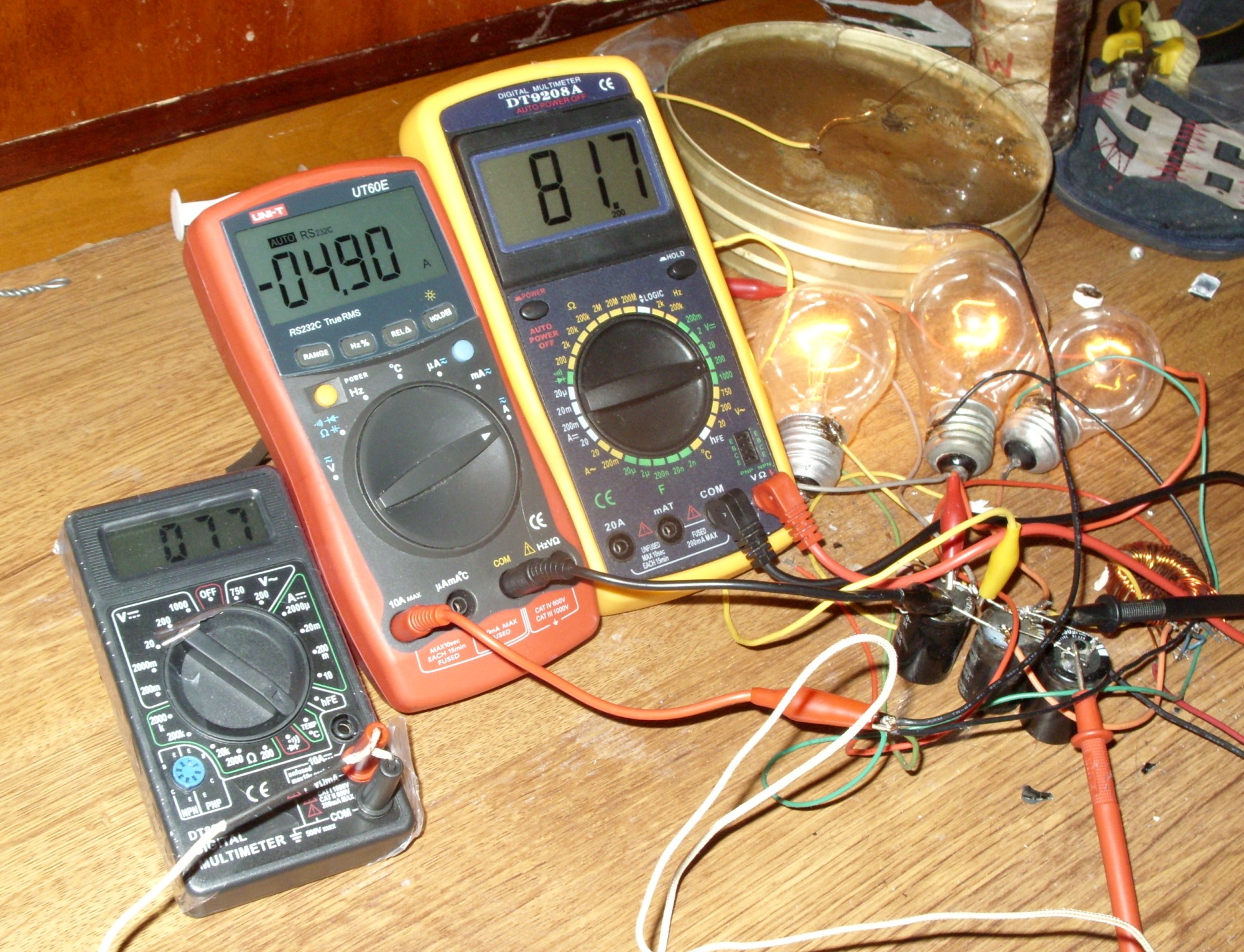

                                Ok, i think i've proven my point. Here's what my latest transformer does. 85 turns primary, 59 turns secondary, all with 3x 0.35mm wire. I dare anyone to try and shove more wire in that EI33. The DT838 on the left is measuring winding temperature btw. Do the math on the second picture.
                                This one doesn't get hot to the point you can cook eggs on it, but still enough for the tape to start melting, so i stopped after a few minutes. If i had proper high temp insulation tape it would probably be able to run continuously at this level, but again, it's meant for an audio amp so it'll do okay.

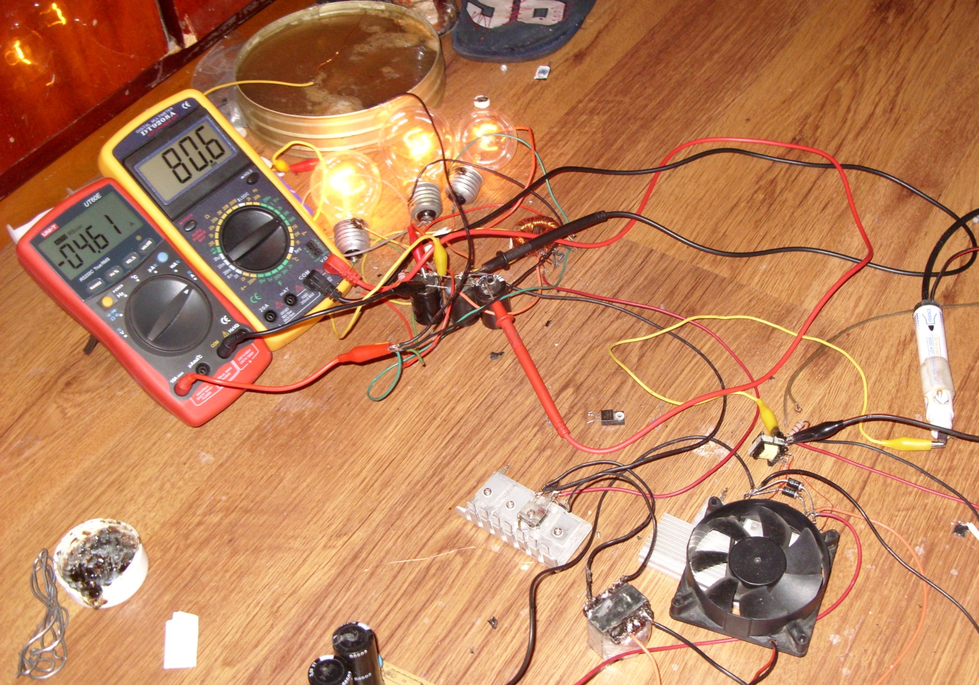

                                    Thanks. Now the mess has been moved onto the bench and has become a little, um, less messy. I don't step on random parts on the floor anymore.
                                    I now have a good idea of the overall design of the power supply. The whole thing must fit on a 100x150mm board. To save space and simplify PCB design, the controller and protection circuits will be mounted on their own daughterboards.

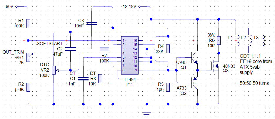

                                    The GDT driving circuitry must use split supplies for best efficiency. Since i already have provisions for +/-16v rails in the transformers (which will be regulated by LM317/337 to whatever value i find optimal for the driver circuitry of the amplifier), i figured it'd be a good idea to drive the GDT from there. So i don't need a standby supply - but then how would i start the 494?
                                    I thought about it a little then i figured out something that should work - a low current non-isolated power supply (derived from a small capacitor in series with AC line) will start up the 494, then once the main supplies are up a relay will break this connection, making the supply fully isolated. I'm making a protoboard with a 494 atm.

                                      I'm going to use single ended drive for the GDT like i did till now (one n-channel mosfet and a 100 ohm 3w resistor across the GDT), so i won't need +/- driver supplies anymore, and may go for a standby supply to avoid any safety risk.
                                      I'm proud to announce i have a TL494 successfully implemented on my protoboard. Now the fun part - stabilizing the loop.
