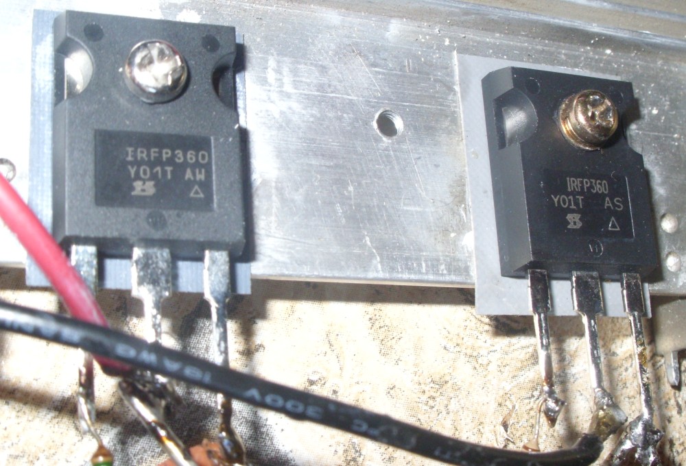

          Now, i have a little problem. I got my IRFP360s. For some reason, they run really hot with not much load at all. I mean, i could go on forever at 60W load without a fan on the 2SK2341s or IRF740s, and the heatsink wasn't even getting warm. Now, it gets hot. Quickly. I have added 15 ohm gate resistors because the ringing was getting out of hand on those big FETs - it went all the way down to turning the thing off and then on again during a switching cycle - however, they didn't fix anything. I used to run with no gate resistors at all on the smaller ones. While this wasn't a good idea as ringing develops, the gate voltage remained high enough at all times for it to not matter. Even on the IRFP360s Vgs has a spike to 12v and then settles at 10v. And the datasheet specs are given at Vgs=10v. So they should work great. I have no idea why they don't.
          Now, one little detail. I've never got from this shop two transistors that have identical writing. Every time i buy a pair, for some reason, the two MUST have a different font. It's like the clerk picks them up that way. And they usually have an just an "i" instead of the familiar International Rectifier logo with a diode symbol in the O. So far they have all worked fine but now i think i got fakes. I'll post some pics tomorrow.
          Anyway, i also bought two pairs of IRF740s. Looks like four weak cheap FETs are better than two big and more expensive ones.

            Here's how my IRFP360s look like. They both look dodgy IMO. What do you think?

              If they're from the pre-Vishay-acquisition, then they should look like it says on the last page of the datasheet (2004). The Vishay version doesn't specify how the markings should look...

                Thanks, but i already had that datasheet. Anyway i think i found the issue. Due to my driving method fall time is slow. With the big capacitances of those fets, it's even slower. I have to get that bipolar driver supply going.

                  That's the Siliconix/Vishay logo, but the one on the left looks like it was stamped on upside-down and the labeling is also misaligned. All the pictures of IRFP360s I could find look like the one on the right.

                    Thanks. I've sped up the fall time a bit (still not using bipolar driver supply tho), and the result is.... the same. I'm puzzled.
                    The losses are far too great to only be rise/fall time related. It's like they are constantly hitting breakdown voltage. And they are (supposedly) 400 volt devices, while i got by with 250 volt ones in insulated TO-220 packages - how's that for heat dissipation - and yet they ran COLD at this load level, and could go for about a minute at 400W without a fan till things got really crispy. The IRFP360s heat up about the same like when i tried IRF640s (200 volt) just for kicks... Those ran for a few minutes but got really really hot and then one of them died. I don't want the same to happen with the IRFP360s because they ain't cheap.
                    They're either not what it says on the tin, or there's something else that i'm missing. Regardless, i'm going to hook up the two pairs of 740s in parallel, and if that works fine, then that's what i'm using. The differences in capabilities are marginal, and the two pairs of 740s still have roughly half the gate capacitance of 360s, so rise/fall times are likely to be faster too.

                      Fixed. The transistors are fine. I found that the secondary of the transformer was ringing like crazy at 250kHz! Obviously most of that made its way to the primary as well and disturbed the switchers. The culprit was the output inductor, i was again testing one with a lot of turns on a pair of T106-26 iron powder cores. Replaced it with a ferrite core one and all the ringing has gone away. Transistors are now cold.
                      Of course i could've tried using a snubber. But instead of wasting power why not actually fix the offending part?
                      Morale: When in doubt, scope around.

                            Different FABs and different lines will have different laser marking equipment so the finished parts look different. Often the case plastic, leads, tabs, and shear marks are different too. It comes from buying companies and from buying from different equipment suppliers through the years.
                              Thanks for clearing my doubts on this.
