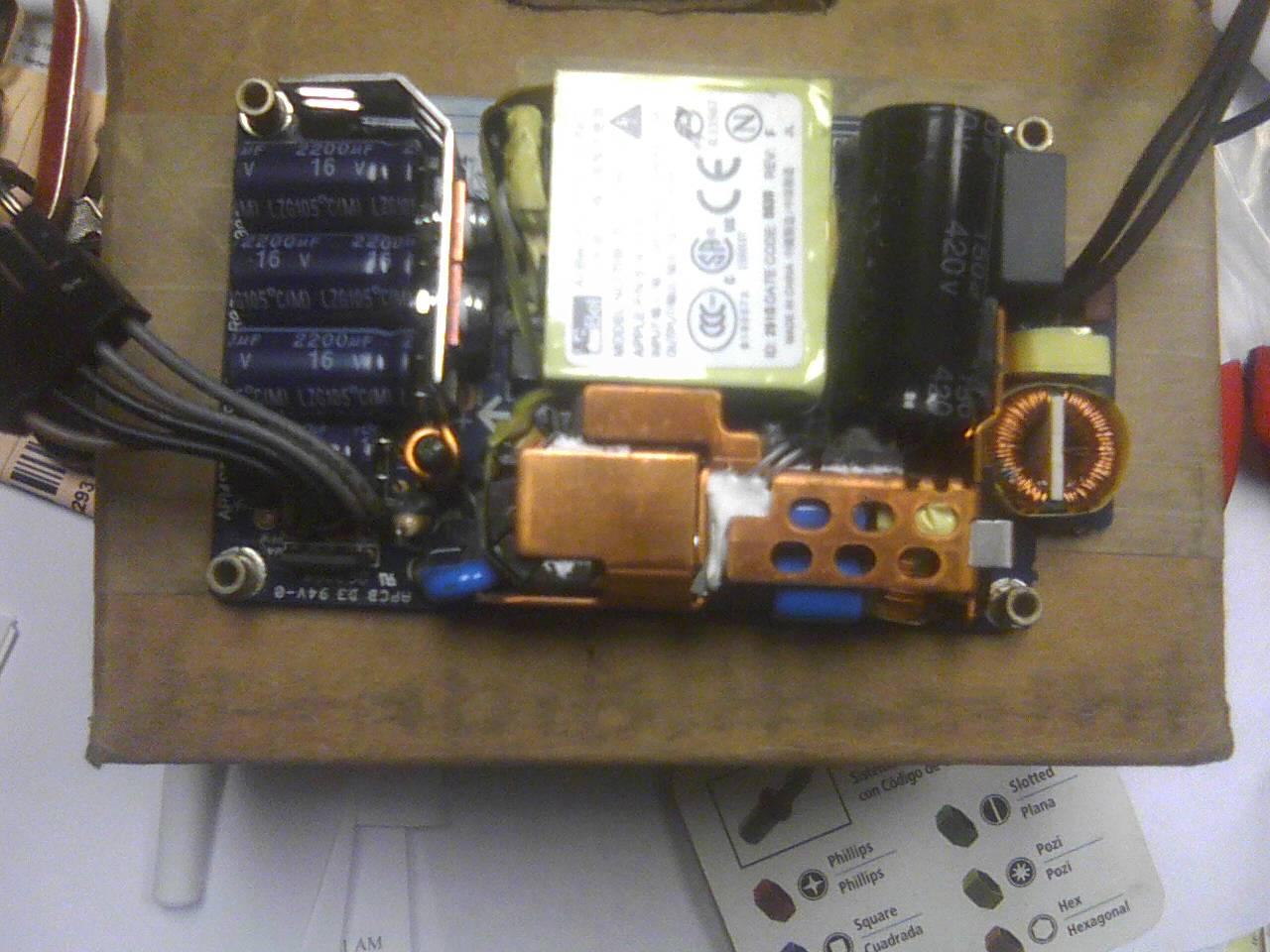

        the computer just blink at the front panel and that is all. I see a 12V label on the gray so it may be safe to assume the black is ground and the brown is 24V?

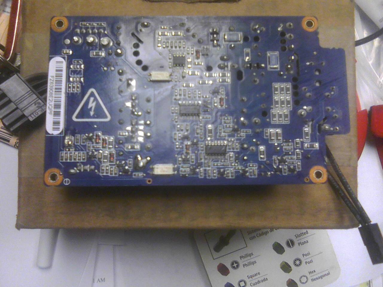

        This board is not easy to diagnose on the top side. Is there a schematic for this board somewhere?

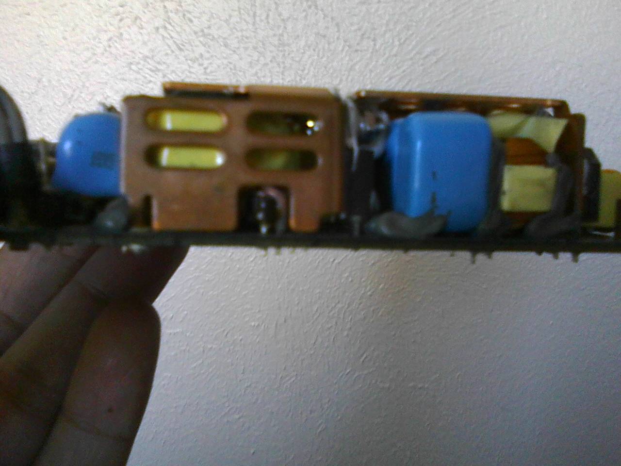

                    Re: Imac Isight G5 PSU repair
                    nothing underneath the copper heat sink enclosure.
                    There is a small (start up?) cap underneath the large 420V cap though..
                    no signs of bulging on any caps though.

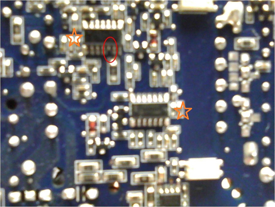

                      Studied the board a little more and noticed one pin is missing on the IC chip.. attached image. This chip looks heat stressed compare to the bottom chip. chip labeled LM339G PCT610?
                      • Toasty
                        • Jul 2007
                        • 4171
                        >>no signs of bulging on any caps though.<<
                        Just means the caps haven't bulged. Says nothing as to their condition.
                        >>one pin is missing on the IC chip<<
                        Looks like a factory modification. Chip is probably fine.
                        Can not see chip condition due to out of focus pic.
                        Recommended that you replace all caps except the large mains cap.
                        Please supply for all caps:
                        Diameter & length in mm. - 10x20
                        Capacitance & voltage - 2200@16
                        Brand & Series - Ltec LZG
                        Probably looking at <$15.00 in total.

                          Thanks for the help. Sorry for the bad image.
                          I have (3) 2200 uf at 26V, (1) 1000 uf at 16V, (1) 68 uf at 25V for capacitors..
                          There are two blue components underneath the copper heat sink but it does not look like capacitors to me. attached image.
                          Question.. Panasonic has the high temp caps with low impedance. Is this better than low ESR caps?
