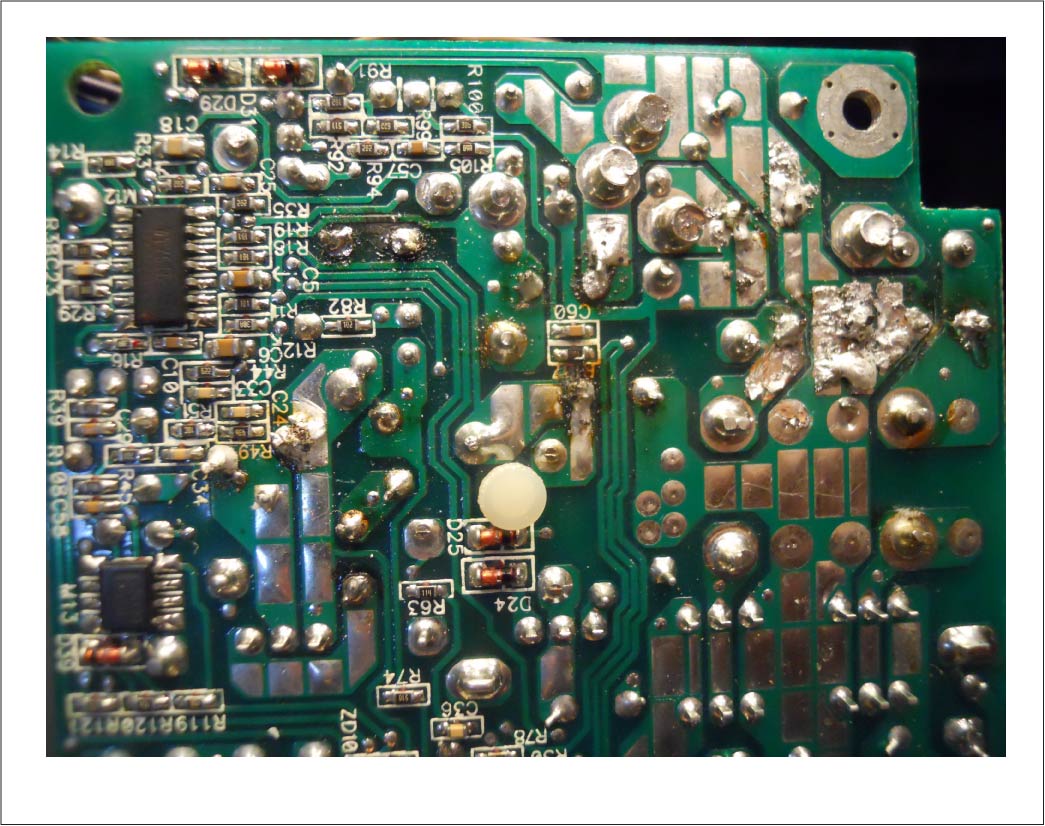

    The guy I bought this Imac from re-caped the PSU, couldn't get it to work and just gave up. I found two dry solder joints and it brought the Imac to life. After a while it would just shut off. Sometimes after post, sometimes in a day, or a week or two. I couldn't repeat the shut down and there was no log on the computer of a shut down. I pulled the PSU and checked the voltages again and they were all a little high. the 3.3V were 47V when it was off. Also I noticed the pins that supply current when it is turned on continue to increase in voltage. As I write this I think I should have just re-caped this and re-tested. here are pics and voltages for the pins, any thoughts?
  • retiredcaps
    • Apr 2010
    • 9271
    Re: I mac G5 PSU, ALS - odd voltages...

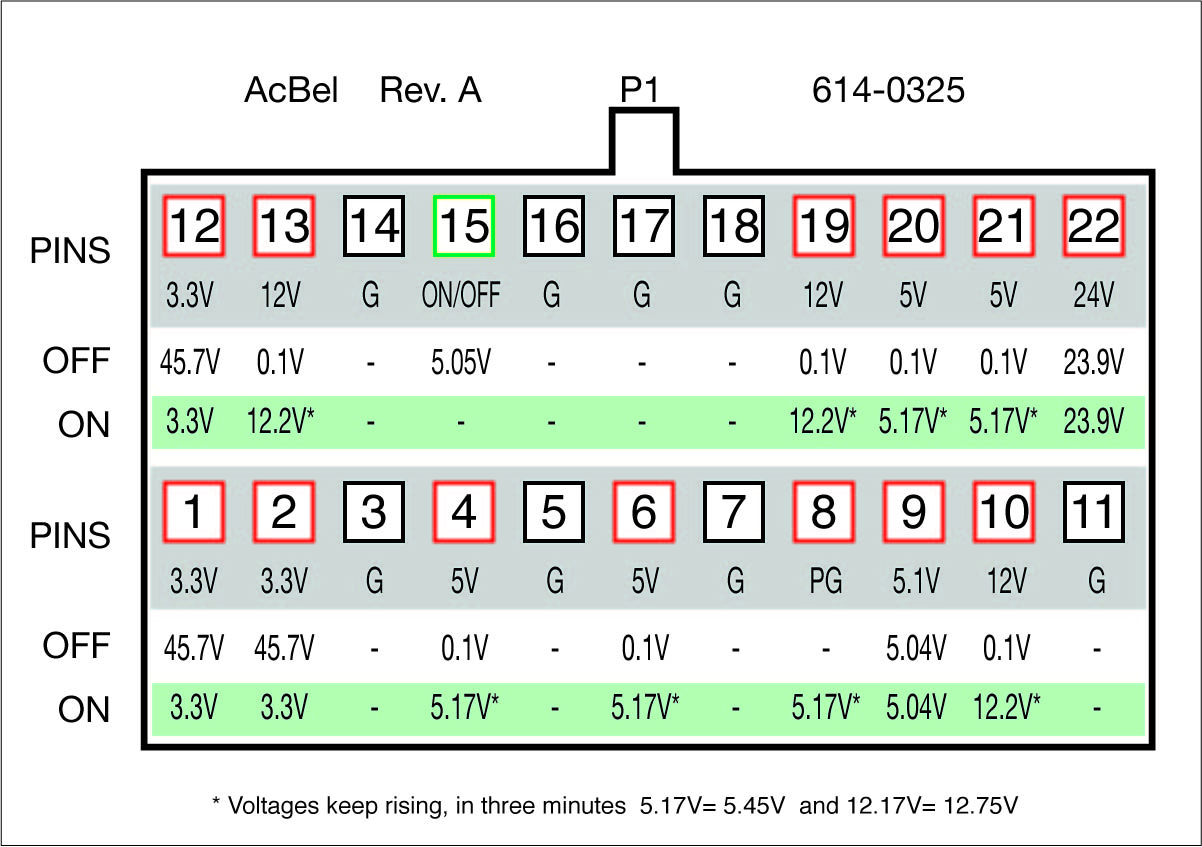

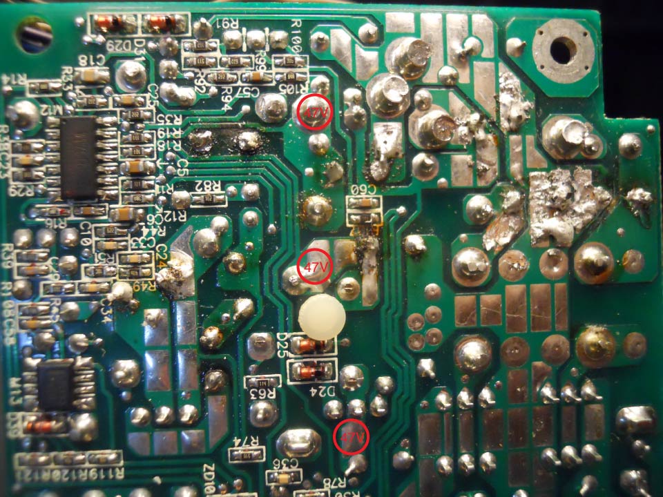

    4.7 or 47V?
      Yup, forty seven (47V). I wish I knew some history on this PSU.
      • Toasty
        • Jul 2007
        • 4171
        Please stay out of the other thread until the PSU problem is fixed. Posting in both will only be confusing.
        There is no 3.3v standby power. When the unit is plugged in and not switched on, the only voltages should be 5vsb & 24v. All others should be at zero with the exception of the "power on" line which will have ~5v on it, but there's no real "power" there. Just a potential provided by the power switch circuits.

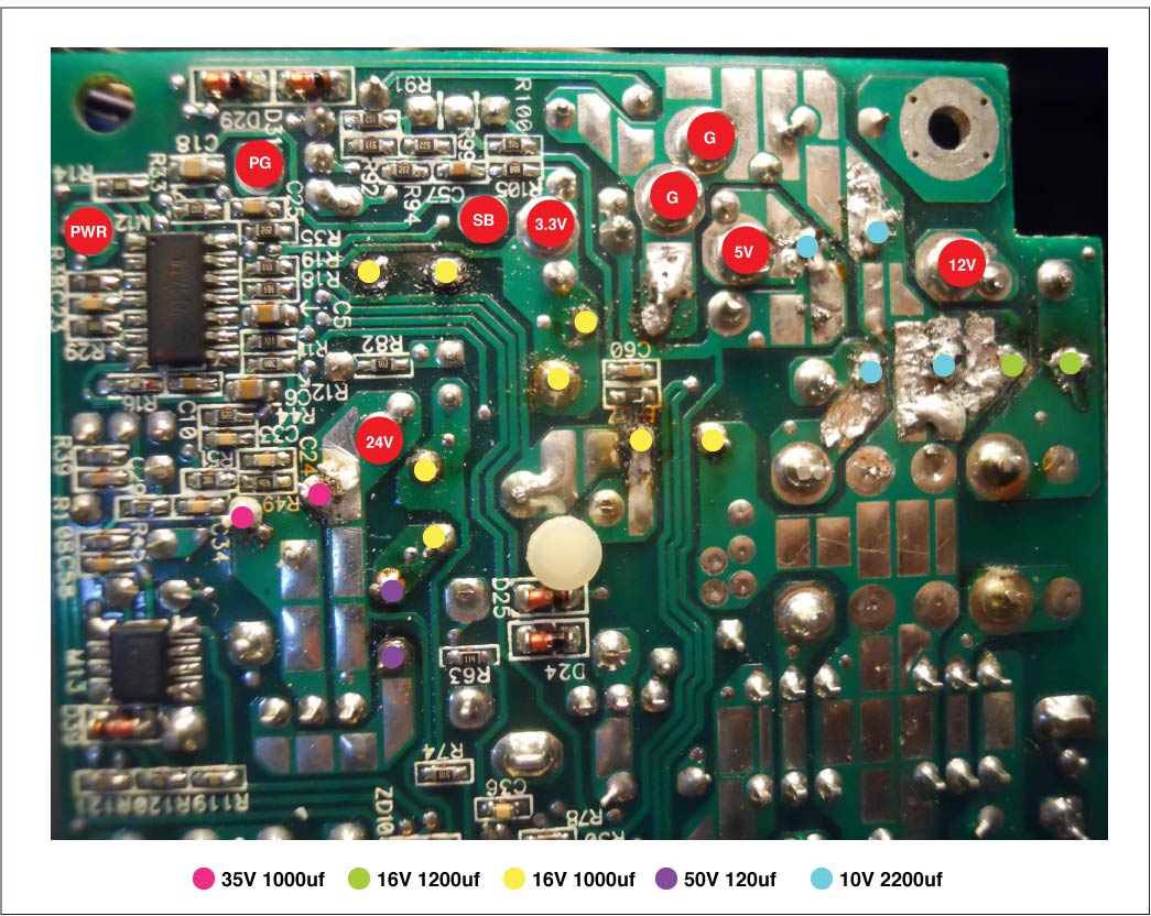

        Verify the (1) values on the caps that were replaced and (2) their positioning/polarity by using the other threads in here on those PSU. A few threads show the cap layout and values, and a few off-site links too. I have that board here in a unit that I will open later on and check too. The PSU model doesn't matter as much in this case as does the board number: API4PC47
        The standby circuit provides 5vsb & 24v through the small vertical transformer. The 3.3, 5, & 12 come from the horizontal transformer next to it. If the 3.3v is 47v when off, then the other lines should be showing a voltage also. I think this points to a short or other connection to/from the 5/24 standby side. Check those traces for a solder bridge from the cap replacement job.
        Note that 47v is about double 23.9v...

          OK, the caps are right polarity and specs. I can't find any close ups of the end of my PSU to see what it is supposed to look like before it was butchered. I really need to see what this looked like so if anyone has a API4PC47 out of the case and can post a pic I would be eternally grateful. I'm not an expert but the 12V and 3.3V lines don't look like they are close enough for a solder bridge to short them. I traced the 47V back from the 3.3V wire out to a section I marked. Above it is, I think, a mosfet bolted to the copper heat sink. Can I test this in board or do I have to take it off?
          • Toasty
            • Jul 2007
            • 4171
            You're missing the point. There is no voltage produced by that part of the circuit until the 'power on' wire is grounded. Whatever you are reading there is coming from the 5/24 volt circuit.
            Is there any "power" to that 47v? Does it light a light bulb? I'm thinking it might be an induced voltage from T2 and that a ceramic or chip cap is damaged, has a cold solder joint, or missing. The cap would be across ground to this trace to suppress any induced voltage as these trace go top and bottom of the board, everywhere.
            The top 47v is connected to the middle 47v by the vertical ferrite rod coil "in front of" the blue toroid coil. The middle 47v is connected to the lower 47v by the blue toroid to the center pin of the common cathode dual Schottky diode pack, D23.
            Where are you measuring the 47v from? Where is your meter negative (-) connected to? I want to try and duplicate it here.
            Toast
            PS: Q1 ( marked:1P ) is bad. That's part of the start-up circuit. Underside at T1.
              So that Schottky can't be leaking voltage, it has to be from the 24V circuit? For Ground, I used the ground posts that lead to the P1 connector (In the first pic above they are the 'G's). I traced the 47V back from the connector wire to the dual Schottky, and it seems to end there. I couldn't find any other contact that had any voltage close to that. My DMM reads 0.29mA from ground post to all of the 47V I marked above. I don't know what T1, T2, Q1, 1P are?
              • Toasty
                • Jul 2007
                • 4171
                I'll check mine tomorrow to see. Your meter should never be placed -across- power when reading current. Inline only. Doing what you did could either blow the internal fuse (if your lucky) or burnout the meter. Fortunately the current is <1ma, so no harm done.
                That 47v does seem like an induced voltage from T2 or something nearby that 24v section.
                The part ID's are marked on the board. T1 - main transformer. T2 - 5/24 SB transformer. Q1 is under T1 on the solder side, next to R4. You'll need a 10x or better jeweler's loupe to read the numbers on it, but you'll see it's 1P. There are several more near it. That transistor has been discussed in the other thread and in some others. If you look at it, you'll see the difference and how I picked it out.
                I'm working on finishing a system to ship out Monday, so I may not poke my head back in until late tomorrow. The hardware's easy. The software is just time consuming...
                I think the same individual worked on yours and mine. The Sanyo caps are very welcome, but I'm jealous because I can't lay hands on them from the usual sources.
                Also, plan to replace the 4 little caps on the 'HOT' side as they run & run with Q1 and the TOPSwitch.
                Toast
                  I'll get the four caps, and I need to replace the P1 because the 'off' voltage is 24V and should be 20V? Do I also need to replace the 2F transistor, you said they work together?
                  The thing I was most concerned about was the rising voltages, is this normal for a PSU under no load? Something keeps making this PSU turn off, wouldn't a voltage that is out of range have the PSU shut down?

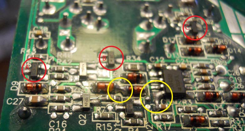

                    Hey Toasty, I tried and tried but I just can't figure it out, could you please point out which F2 NPN is paired with Q1
                    Also, I circled two areas I noticed that looks like it may be unintentional solder bridges. The only other pics I could find were on this forum and only the 20" PSU was high enough resolution for me to see. These solder bridges weren't there but it is slightly different.

                        • Toasty
                          • Jul 2007
                          • 4171
                          It's 1P. That is not the reason. The transistor is -visibly- damaged, and is the source of problems as mentioned in other threads.
                          I never said that.
                          - No, not really.
                          - Yes, it would.
                          No, they're correct. (factory)
                          You should be looking around where the caps have been replaced.
                          I would replace the transistor, the 4 small caps, and re-do the soldering on those caps that were replaced, just to clean up the lousy looking job. Just be sure to use a good iron of at least 45w with a medium or larger chisel tip.
                                      OK, replaced the caps, transistor and cleaned up the solder a little. I get the correct voltages and they don't seem to be rising anymore.
                                      But I have a new problem, there's no standby, the PSU is always on. The gray power on/off connection at the board is untouched. Not sure if it's something I did or replacing the components revealed a new problem.
                                        I can tell you pin 15 (on/off) sits at 3.3v (off) and drops to 0 when the supply comes on.
