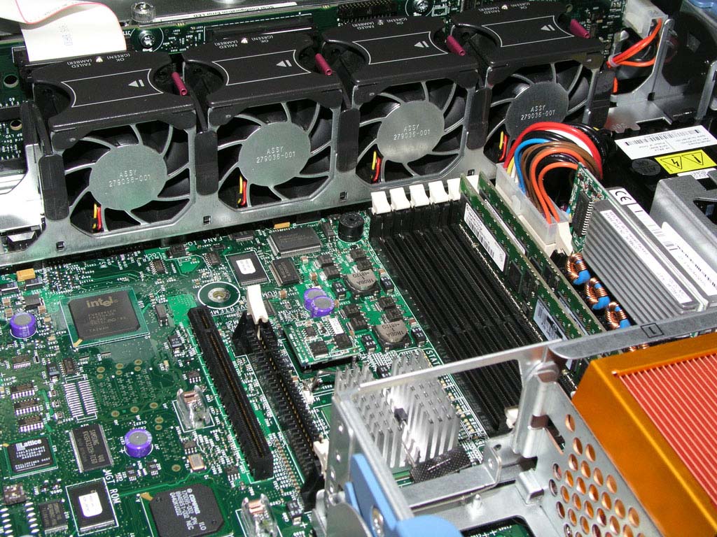

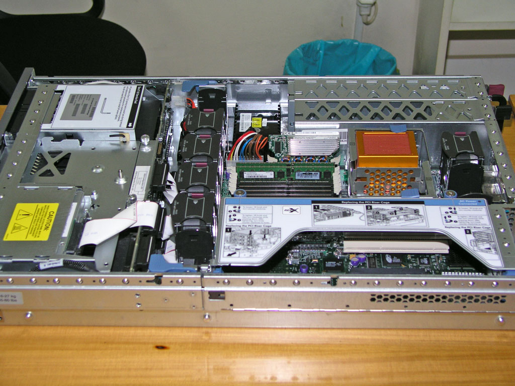

                          Do the 6 Delta fans sound like a small helicopter
                          no they sound like someone set fire to the beehive
                          more pics here
                          http://www.techmati.com/reviews/dl380g4/index.htm
                          actually looking at the photos it has 8 fans with the 3 redundant i put later.
                          it's a 20mm thick model I can't find a replacement for
                          i dont know how the vent looks but you could consider putting it on the outside of the unit (if you are talking about the rear fan).
