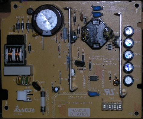

                                          #160
                                          Re: Power supply build quality pictorial
                                          Another gaming console PSU; this time from a PS2 (SCPH-5000x Europe - Delta model ADP-75JP C). 82uF 400V Nippon Chemi-Con KMH, two Taicon PW series on the primary side, 680uF 16V x4 LTEC LZG before primary inductor, 470uF 16V LTEC LZG after primary inductor. Nippon Chemi-Con KY series were a near exact match to the LTEC units.
