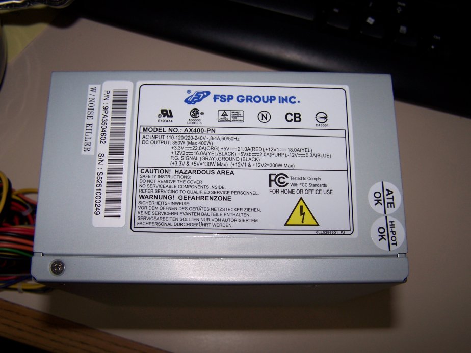

              FSP Group AX400-PN 350w (400max) dual +12v rails
              Looks remarkably similar to the Sparkle (FSP) 350watt that I posted earlier. This is a $40 unit from Newegg.com, which I purchased for a new system build. CapXon on the input side, Teapo's on the output (slightly different from the 350w version.
