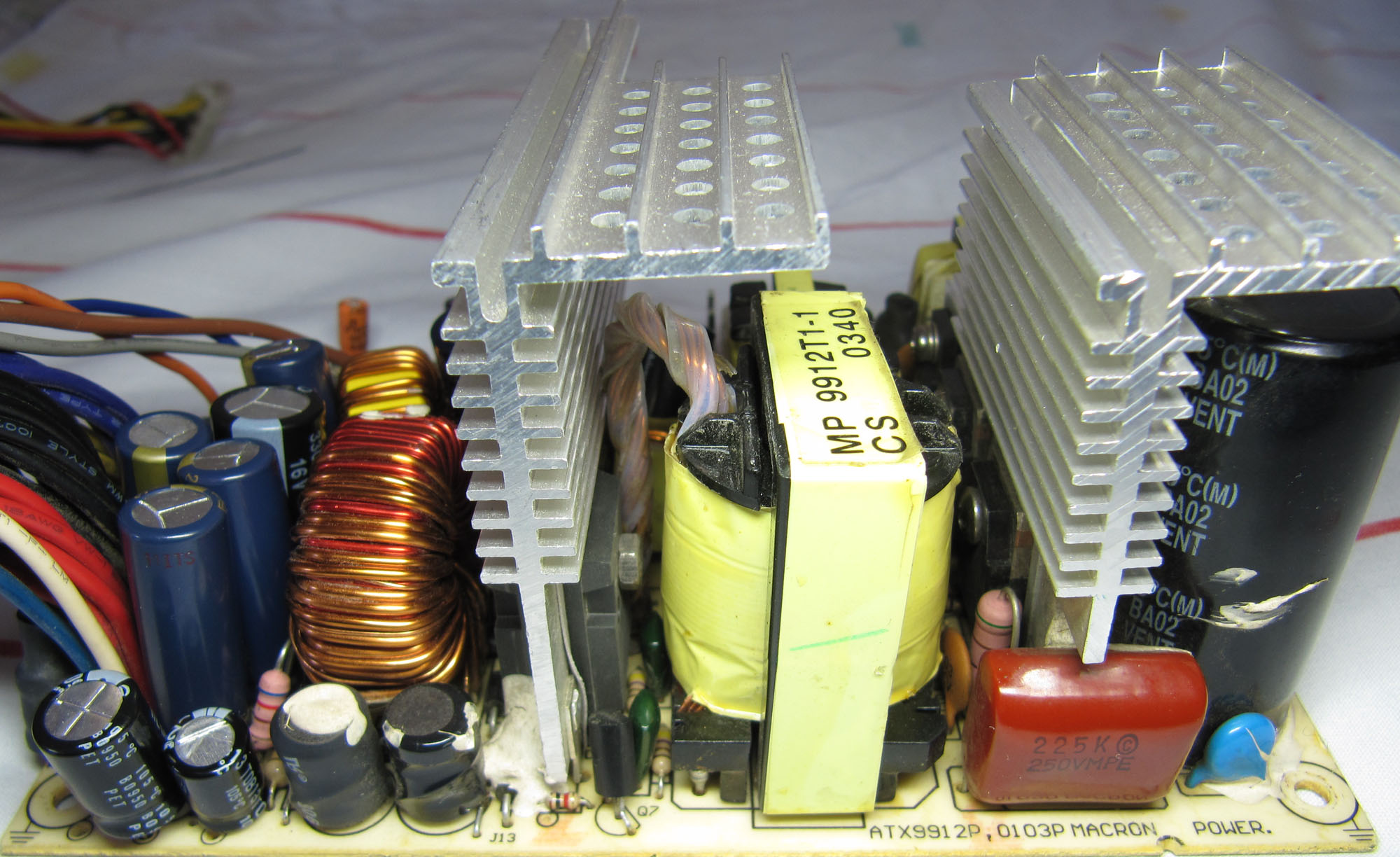

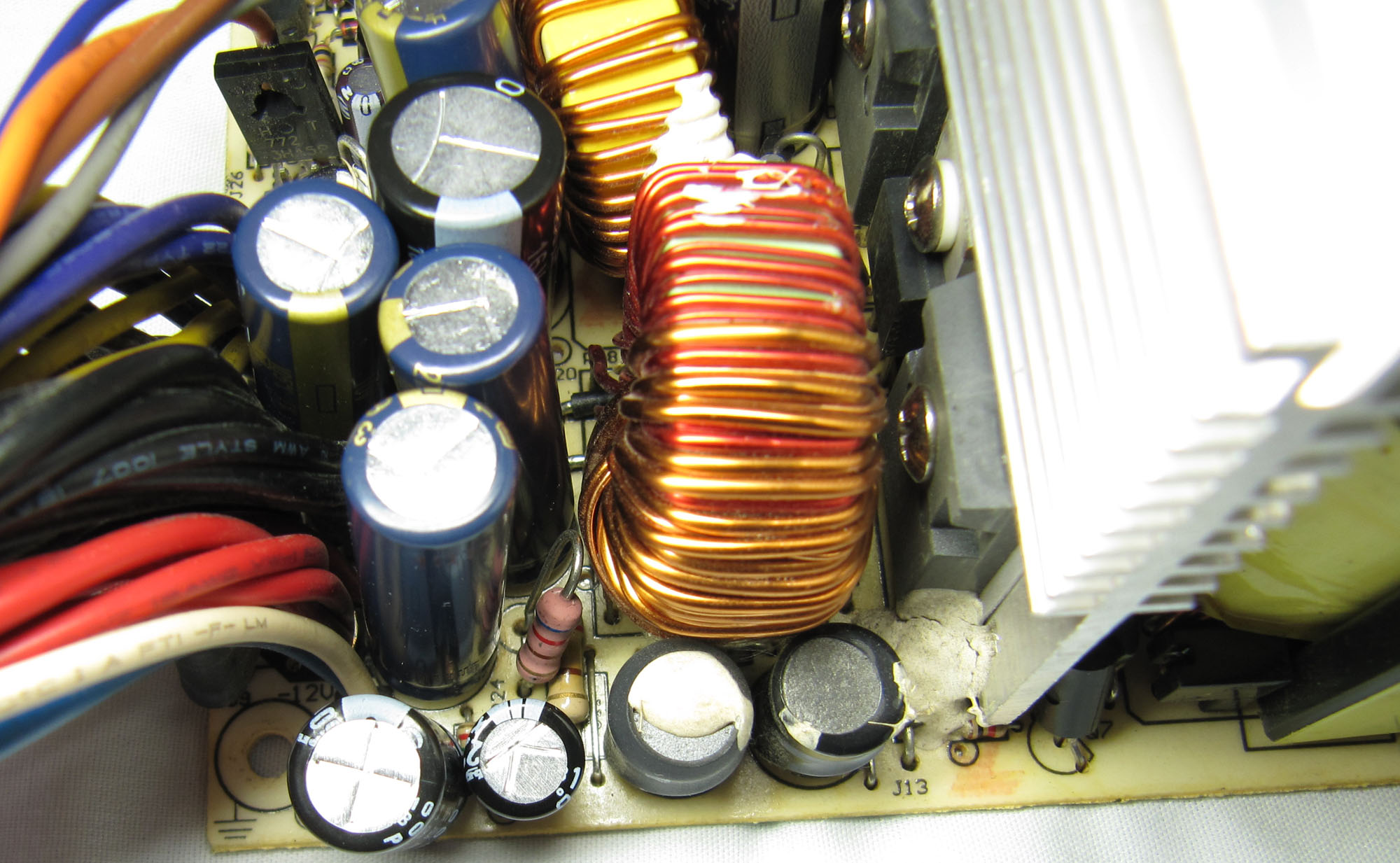

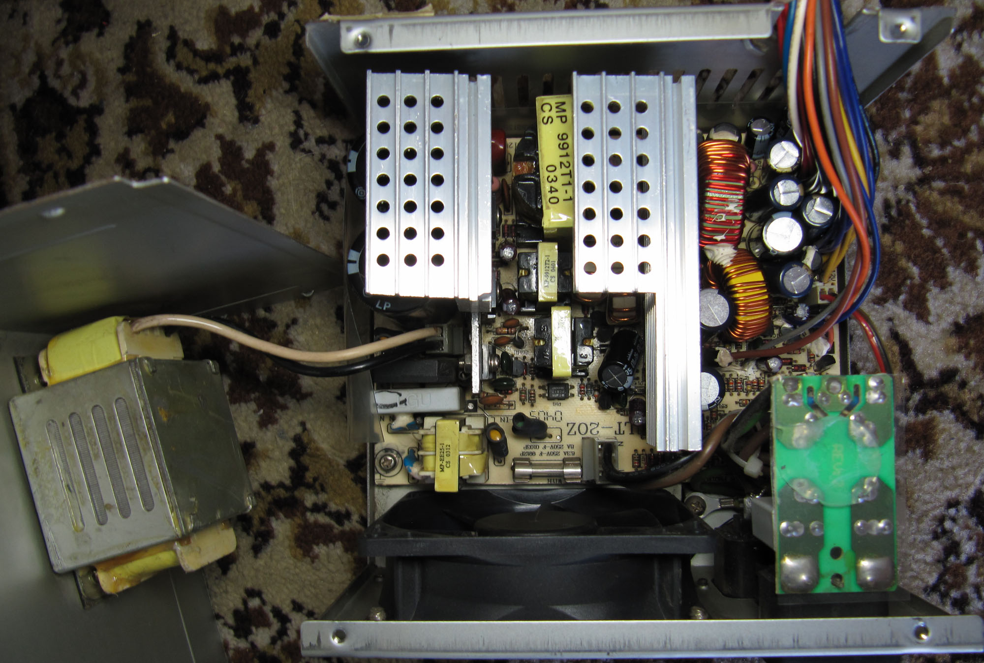

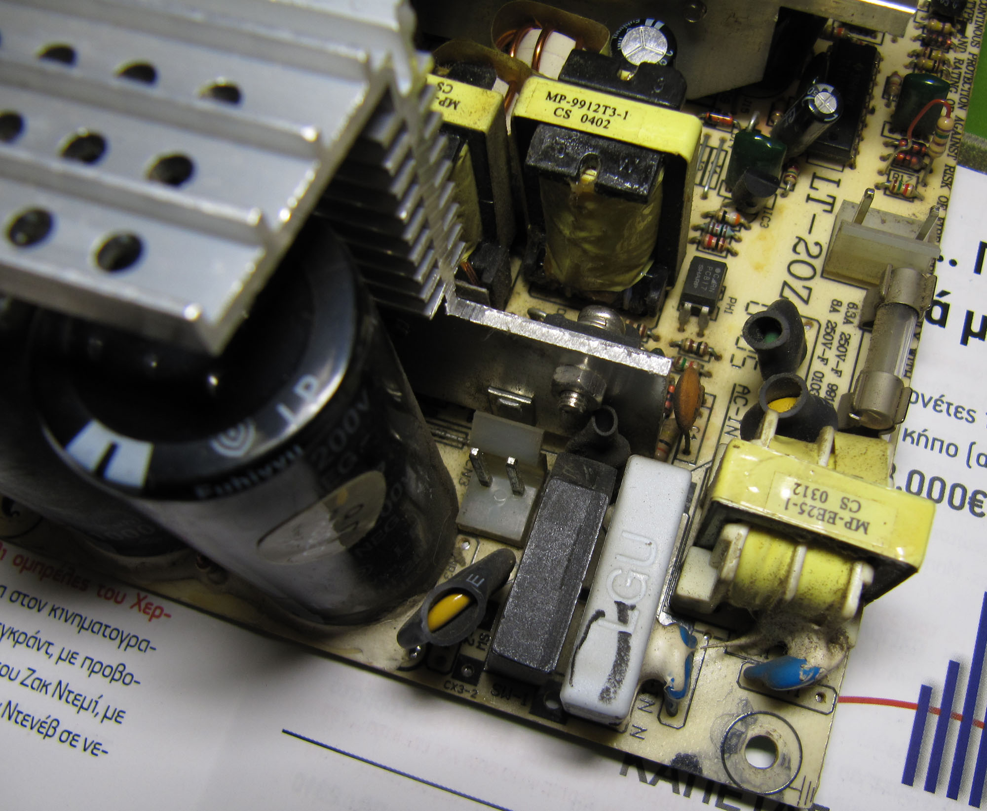

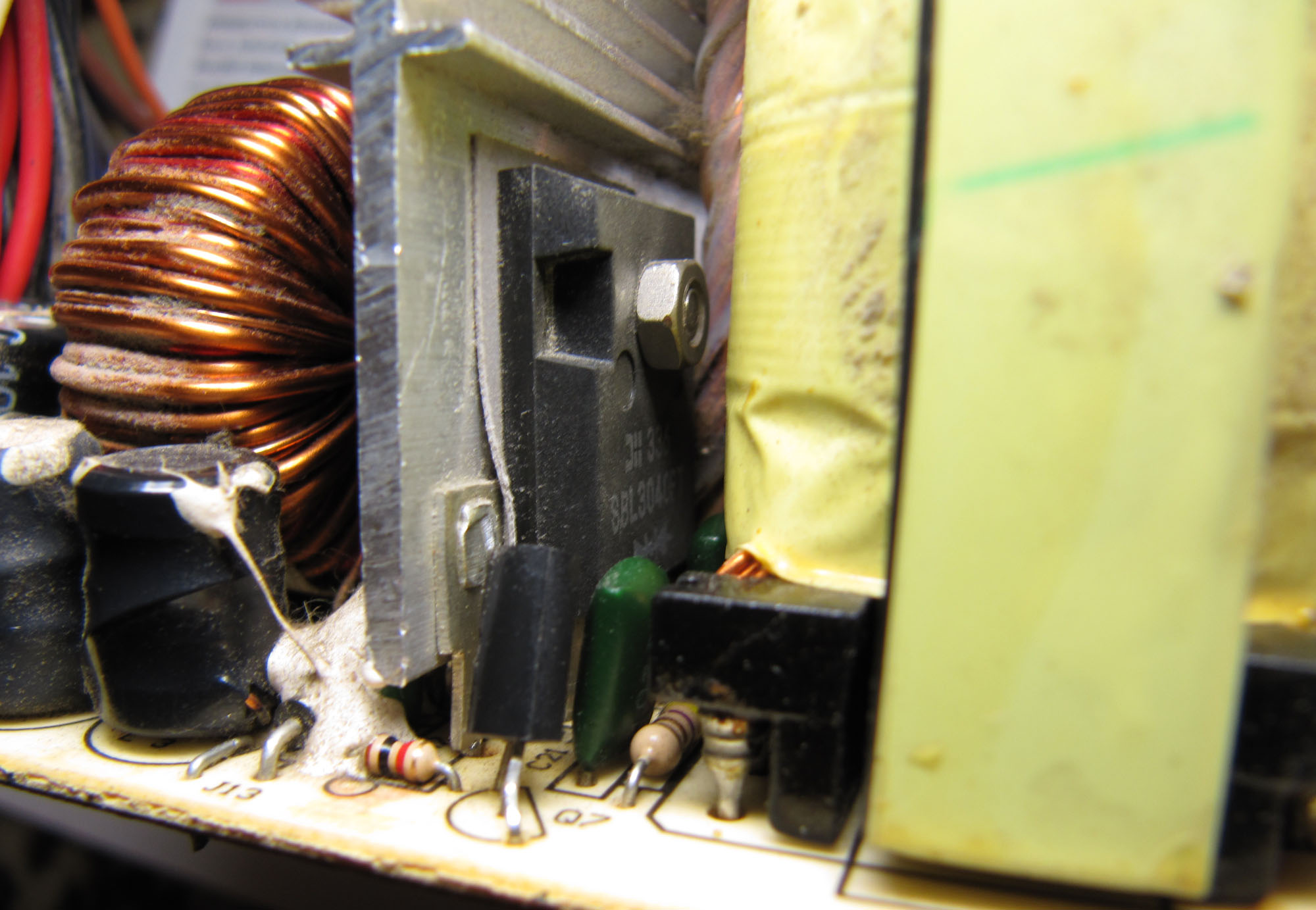

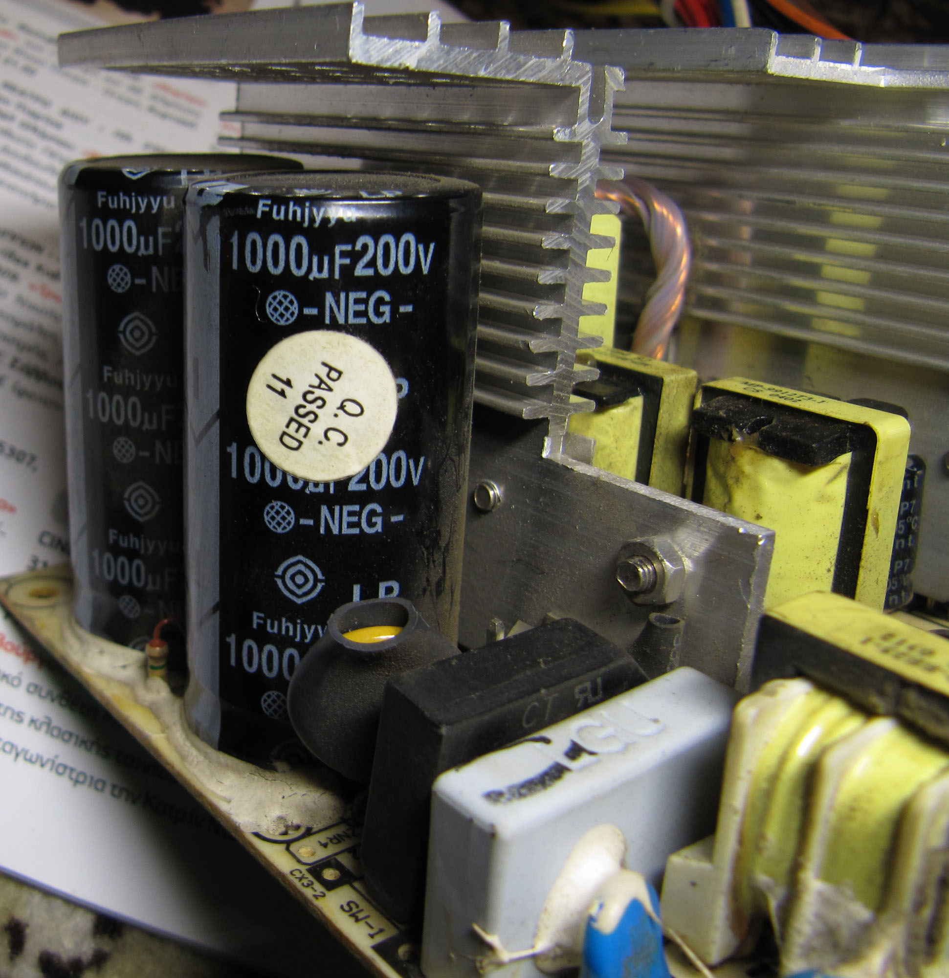

    This is a good power supply.

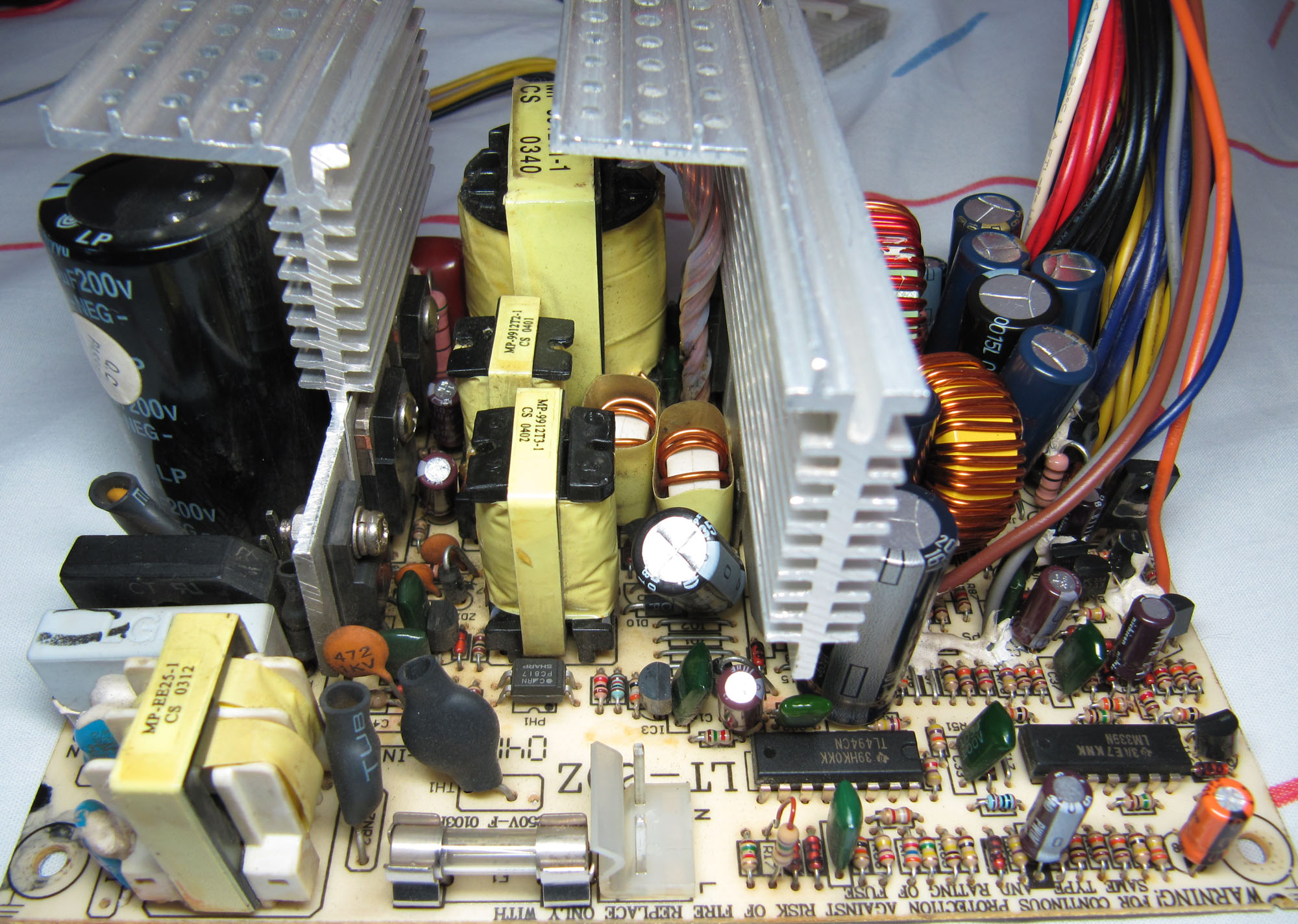

    It has a full input filter, 6A bridge rectifier, Passive PFC, 2x1000uF 200V input caps, 2x2SC3320 switching transistors, big main transformer, 1xSBL3040PT at 3.3V, 2xSBL3040PT at 5V and 1xF16C20 at 12V. The fan is "Superred" and is temp. controlled.
    There are 2 caps bulging: one at 5vsb (2x2200uF 10V GL) & one at 5V (2x2200uF 10V GL).
    3.3V: 2x2200uF 10V GL
    12V: 1x3300uF 16V GL
    It powered an ATHLON XP Barton 2800+ and Geforce FX 5600. The voltages were in spec but the psu made a high pitch noise (due to the bad caps?).

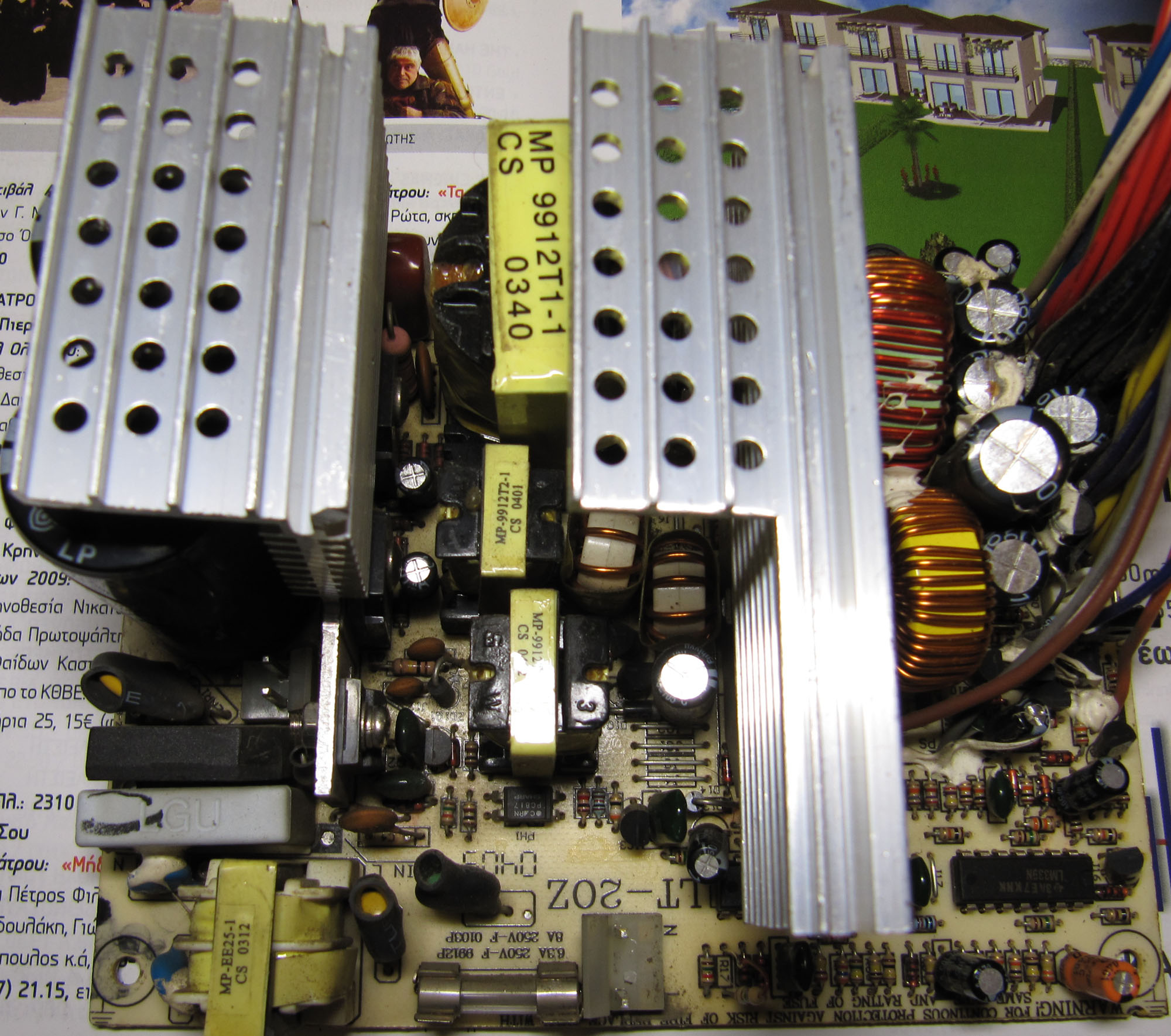

    Re: Macron Power MPT-350P
    It looks a bit like an FSP knock-off with those heatsinks.
        Looks almost exactly like the MPT-301 (300W model), but with much better heatsinks, bigger primary caps, PPFC, and an extra schottky for the 5v rail.
        It is a decent PSU, minus the caps.
          Another difference is that the transistors of MPT-350P are 2x2SC3320 instead of 2xFJPF13009 that my MPT-301 has.
          But my MPT-301 has 2x SBL3040PT schottkys for the 5V rail as well.
          edit: The heatsinks are not bad for that wattage.

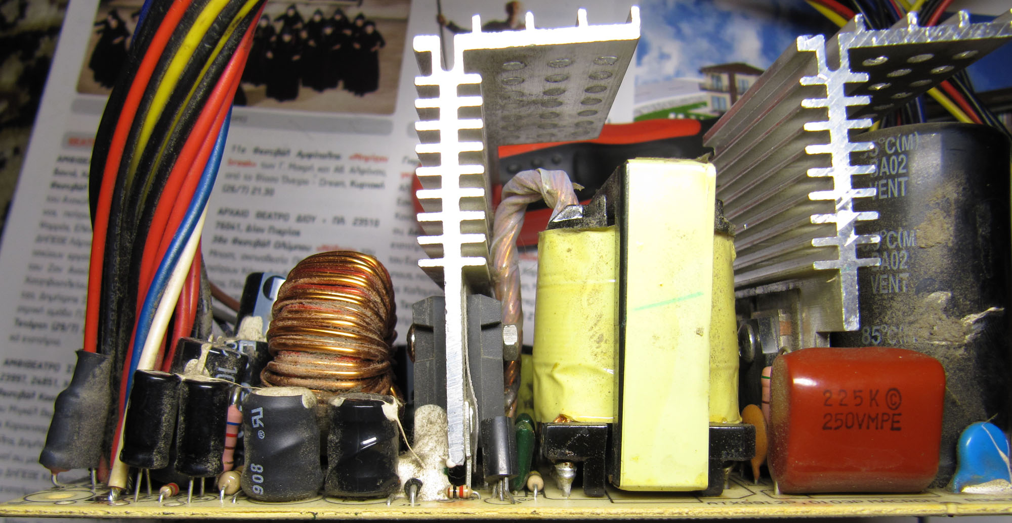

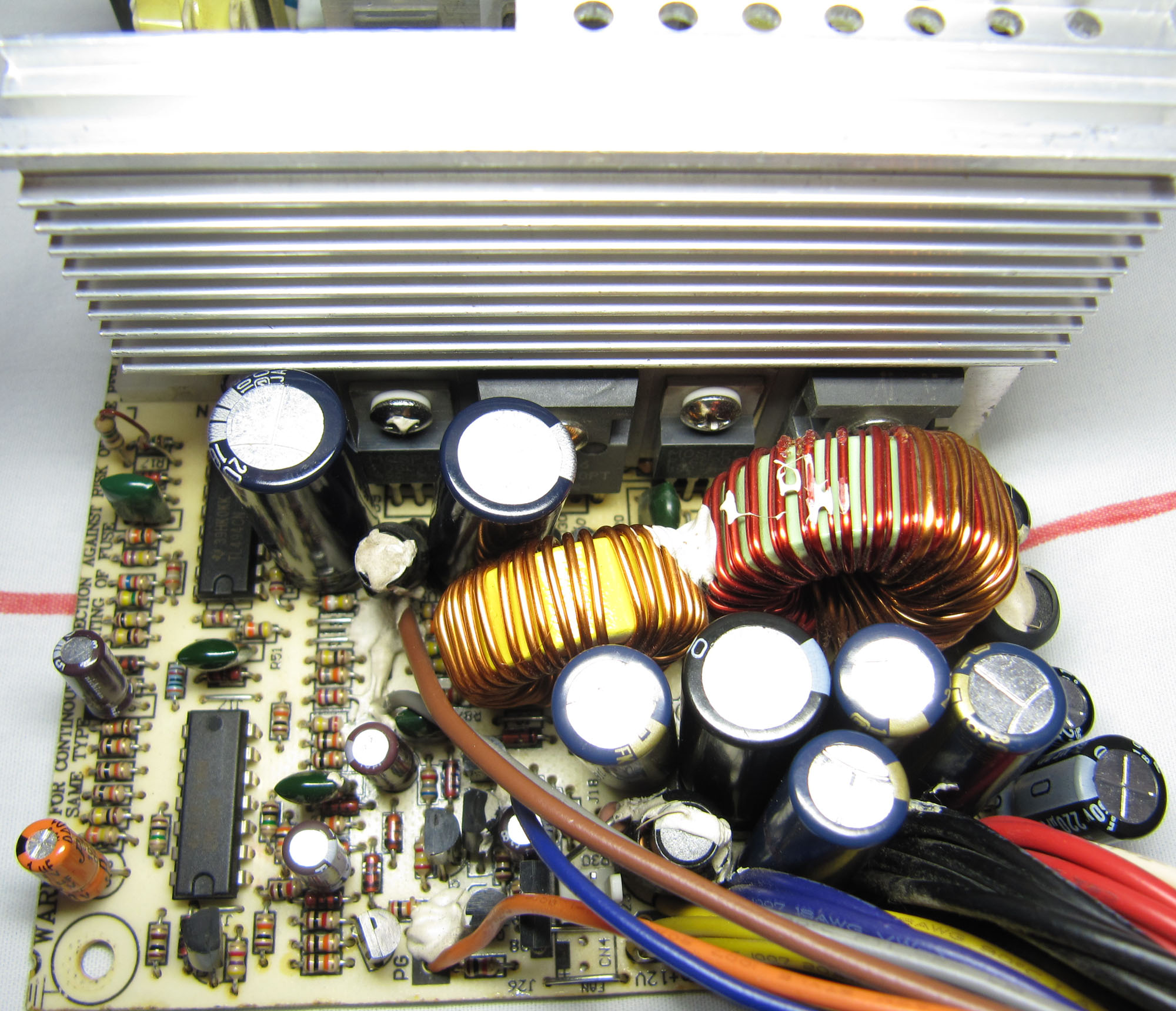

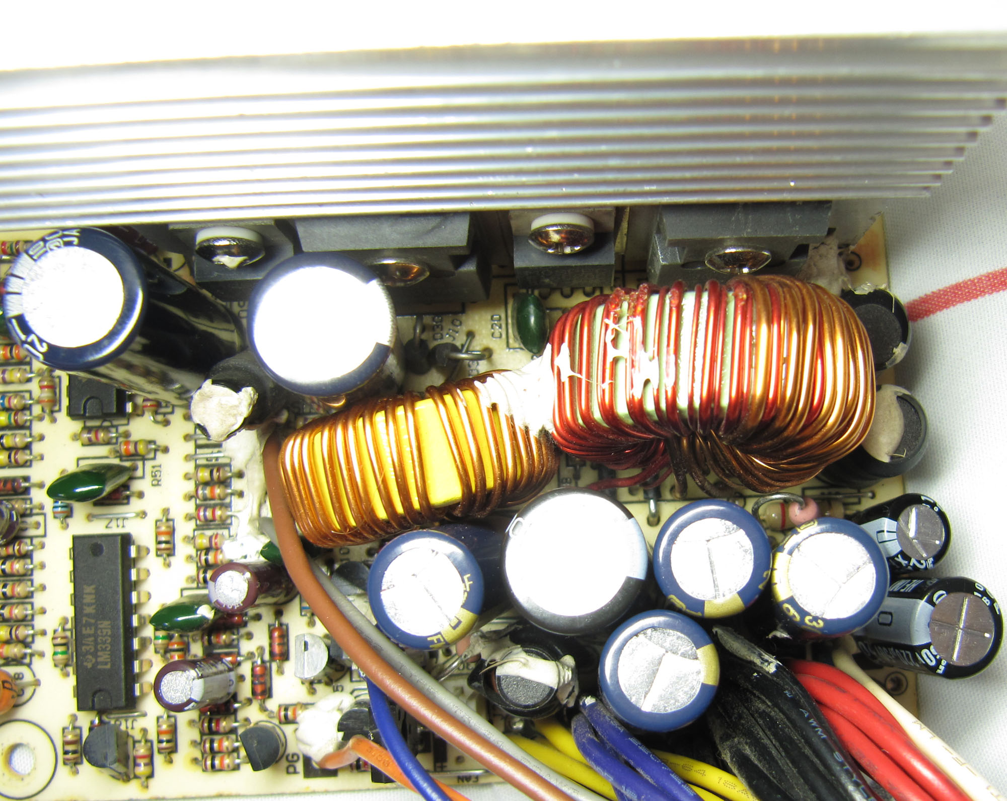

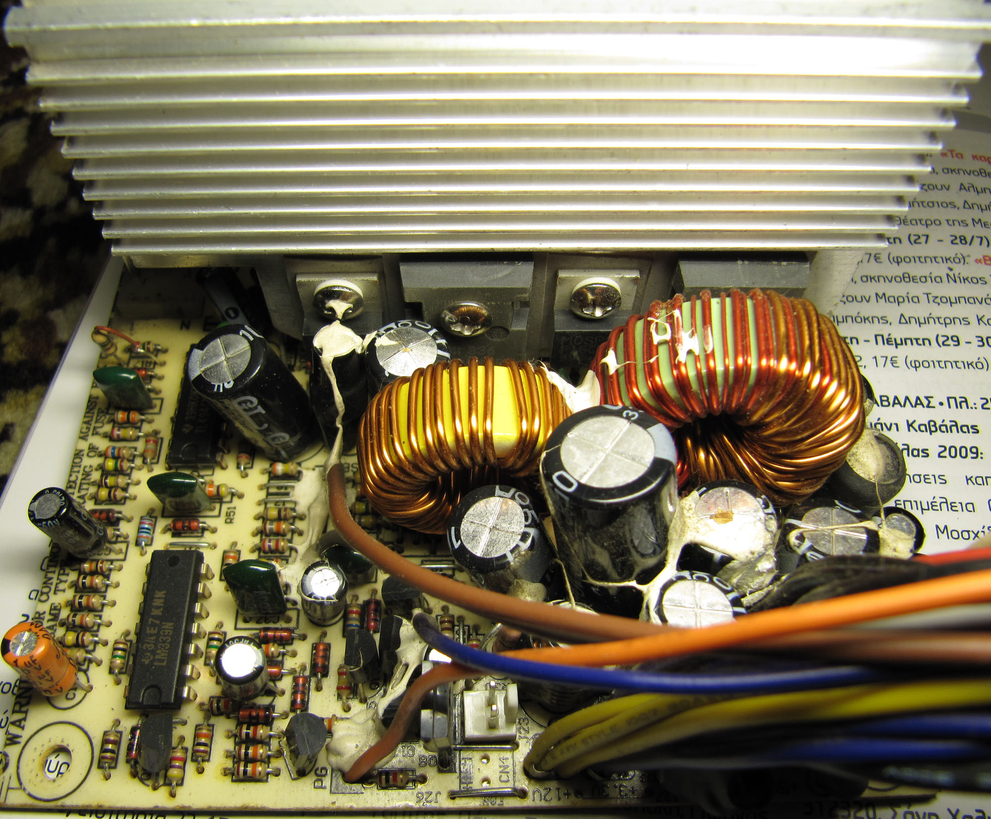

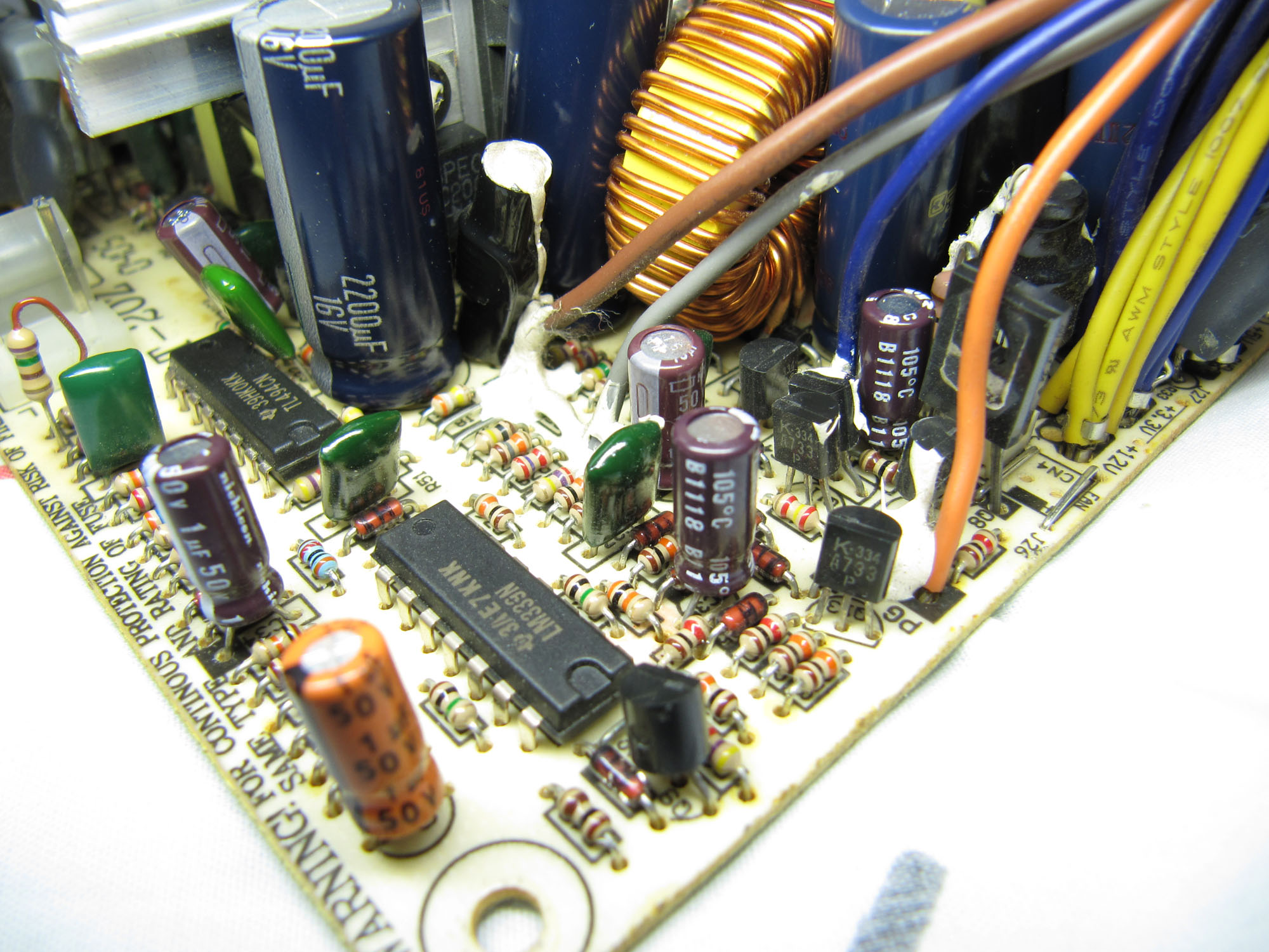

            I recapped the psu, using exclusively Made In Japan caps.
            2x1000uF 200V Fuhjyyu input caps -> not changed
            2x1uF 50V Fuhjyyu TN & 1x1uF 50V G-Luxon SS -> 3x1uF Nichicon PW 50V
            1x1uF 50V Jpce-tur -> not changed
            4x10uF 50V GL -> 4x10uF 50V UCC KY
            1x470uF 25V Fuhjyyu TN -> 1x 470uF 35V Nichicon HE
            +12V
            1x3300uF 16V GL -> 1x3300uF 16V Panasonic FR
            +5Vsb
            2x2200uF 10V GL -> 2x2200uF 16V Panasonic HFQ taken from an old Intel PII motherboard
            +5V
            2x2200uF 10V GL -> 1x2700uF 10V Panasonic FK & 1x3300uF 6.3V Panasonic FK
            +3.3V
            2x2200uF 10V GL -> 2x2700uF 10V Panasonic FK
            -12V and -5V:
            2x220uF 16V GL -> 1x220uF 16V Rubycon YXF & 1x220uF 50V Nichicon HE
            It runs perfectly fine

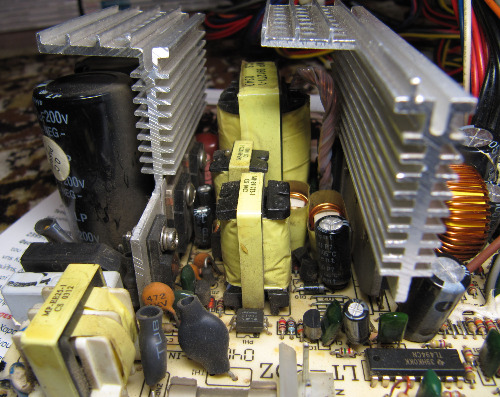

              I like it . Should definitely be capable of 350W and with the new caps I doubt the noise/ripple will ever be a problem. Nice job!
              My MPT-301 is also still doing fine (recapped with Japanese as well). I've been mainly using it as a test PSU and lately to power my 939Dual-Sata2 with a AMD Athlon 64 3200+ (67W TDP) CPU. I even tried a FX-57 CPU (104W TDP) and the voltage rails were rock stable and still almost not cross-loaded at all. Might post some pictures of it in the PSU Pictorial thread, even though there are already quite of them in that thread.
              The only thing that worries me is the 2-transistor self-oscillating 5VSB on these. But other than that, they seem like great simple PSUs (sort of like the older FSPs and Antecs).
                I don't worry about that. Replacing the 5vsb output filter caps and the small ones, especially the 5vsb critical cap (usually 47uF 50V) with Japanese quality capacitors does the job.
                I almost forgot to mention that I always turn the psu off by the on/off button.
                Yes, post some photos of it
                  There doesn't seem to be one in this unit, though. I tried tracing the 5VSB circuit on mine before, but I only encountered film and ceramic caps.
                  I do that too on all of my PSUs with the 2-transistor 5VSB circuit, but for other designs (like the PWM-FETs) I just leave it on.
                  Will do.

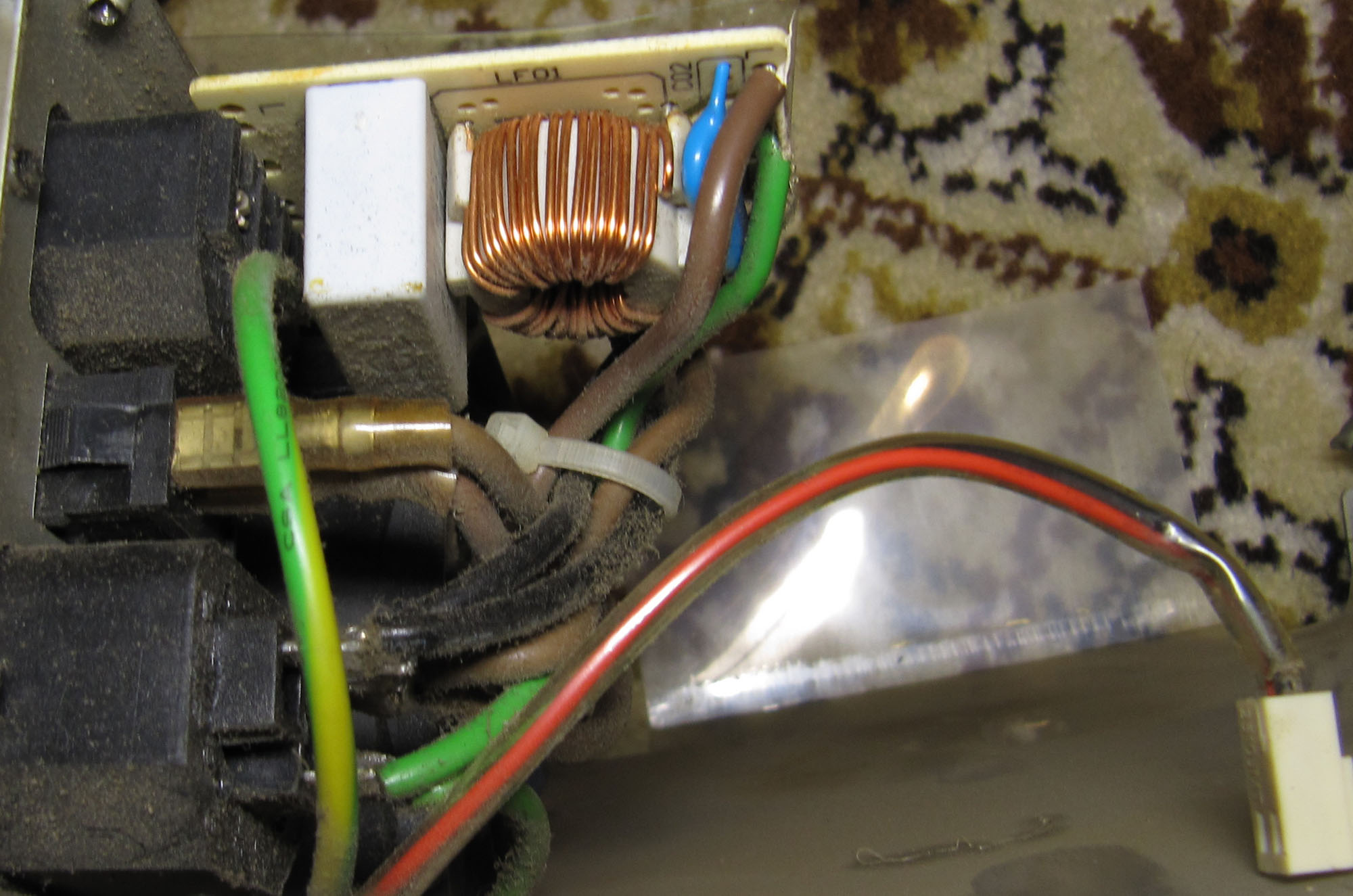

                    Sorry to hijack your thread but I'm doing the same thing on one of my MPT-300, it's branded as "Advance" which is a french brand of bad quality computer products. It's very similar as the MPT-350P, same transformer, nearly identical layout, but some components are different : no PFC (holes are there), no bridge rectifier (only four diodes), weaker mosfets, smaller radiators.
                    So far I've changed :
                    - the filter coils with beefier EE25 ones (the one at the power connector, and the other one on the board)
                    - the bigger capacitors, but I did with what I had so it's half good half bad, but it's still much better than the Fuhjjyu and PCe-Tur toasted caps.

                          So today I made a few more modifications :
                          - added a passive PFC (I had to cut a part of the radiator just like this picture : https://www.badcaps.net/forum/attach...7&d=1291339960 )
                          - replaced the two C4242 with a pair of 13009
                          - replaced the 10A schottky with a 16A one at the 12V rail
                          I've done some simple tests with the following setup :
                          Athlon 64 LE-1600
                          2Gb of DDR2
                          nVidia mGPU 8200
                          Radeon HD4850 Sapphire Toxic
                          The 3.3V is steady, the 5V is at 5.12V, and the 12V is at a steady 11.75-11.76 under load for an hour on Video Memory Stress test with a multimeter.
                          Now if I remove the HD4850 and use the mGPU, I have a pretty perfect 11.99-12V under load. The same test with a Bestec ATX-300-12Z gives 11.83V.
                          That's close to a 0.5V improvement over the original one, and a much better stability.
                          So being very basic tests, I'm not sure how reliable they are but it does show these units are pretty capable.
