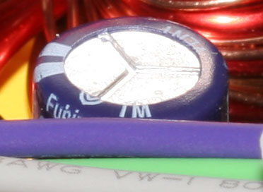

        whew i found a fujiyuu. happy happy. good luck monika

              It's not crap, merely over-rated. It should be good for 200-250W - the secondary-side caps seem to be Elna/Chemicon, so it should be OK. Just pre-emptively replace the auxiliary primary-side flyback capacitor (visible to the right of the top-most transformer on the 2nd pic) with a long-life Nichicon PW(M) or Chemicon LXA and you should be OK for many years of safe use.
              i have seen noname caps with the same vent elna uses.
              a pic of the caps would be nice.

                Good call - those Koshin and Fujhiyu (?) on the secondary need to be recapped. Primary is not that critical, except for the auxiliary flyback.

                        You've found one Fuhjyyu cap in that ISO power supply, my Antec PSU is loaded with them!
                        i have Fuhjyyu in several units. the most important thing is whether the psu design is ok so it wont nuke the computer when they fail.
                        In this case it was quite suprising to find one Fuhjyyu amongst all those Koshin when i was checking the photos.
