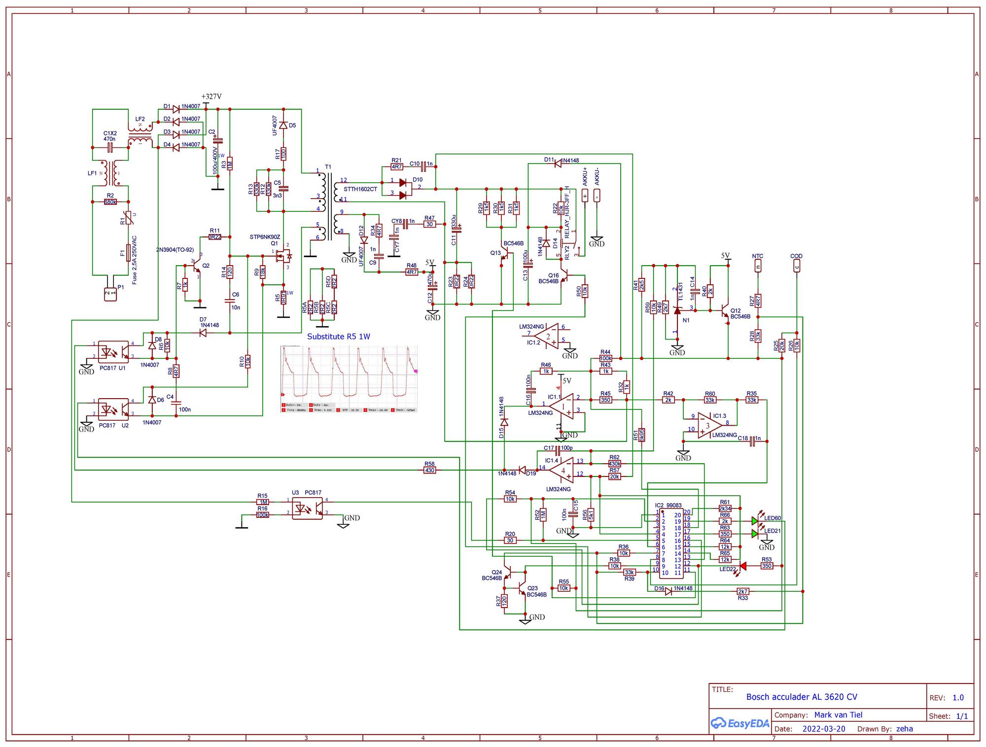

    found r3 open can i use a 1/4 watt 1M resistor for R3 just to see if it starts up the supply ?
    and what wattage should it be ? it measure about 11mm long .
    i found schematics here .. https://www.circuitsonline.net/forum/view/157709

    ok to answer my own question i took full responsibility for my actions and proceeded not knowing what might happen .
    and yes it can be done and got a green light on the charger .
    that just leaves finding out the correct wattage for this 1MEG resistor .
    and why is it am even doing this for a living ? as new chargers are only £35 ..

      11mm long is 1 watt resistor.

        I could be wrong but:
        roughly R3+R9+R5 in series across 327 volts gives about 0.32ma, 0.1watt
        with Q2 turned on, 327v across 1meg is still only about 0.32ma and 0.1watt

          Re: Bosch al 3620 cv . charger
          wonder why they went for a big one then ? just ordered some 2 watt ones there is plenty of room .
            • 31277
            higher wattage = bigger case
            that resistor has to handle 350v dc or more.
            small resistors cant because if they are too short the voltage can arc across them
                new 2w resistor in and charger is now working .
