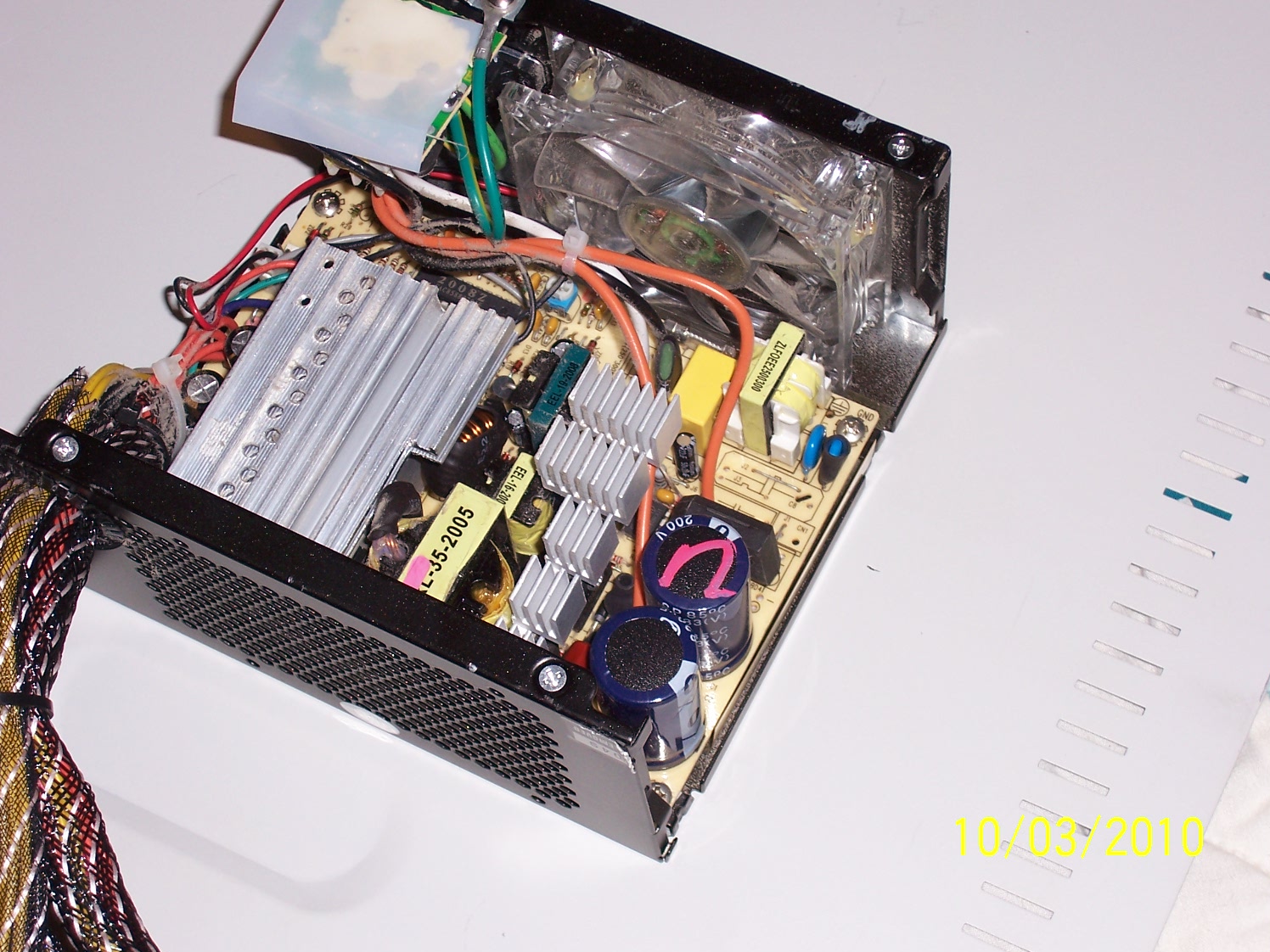

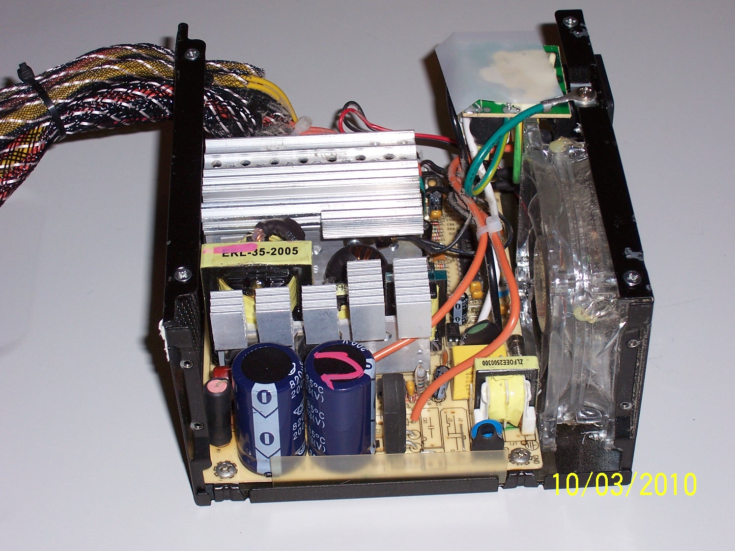

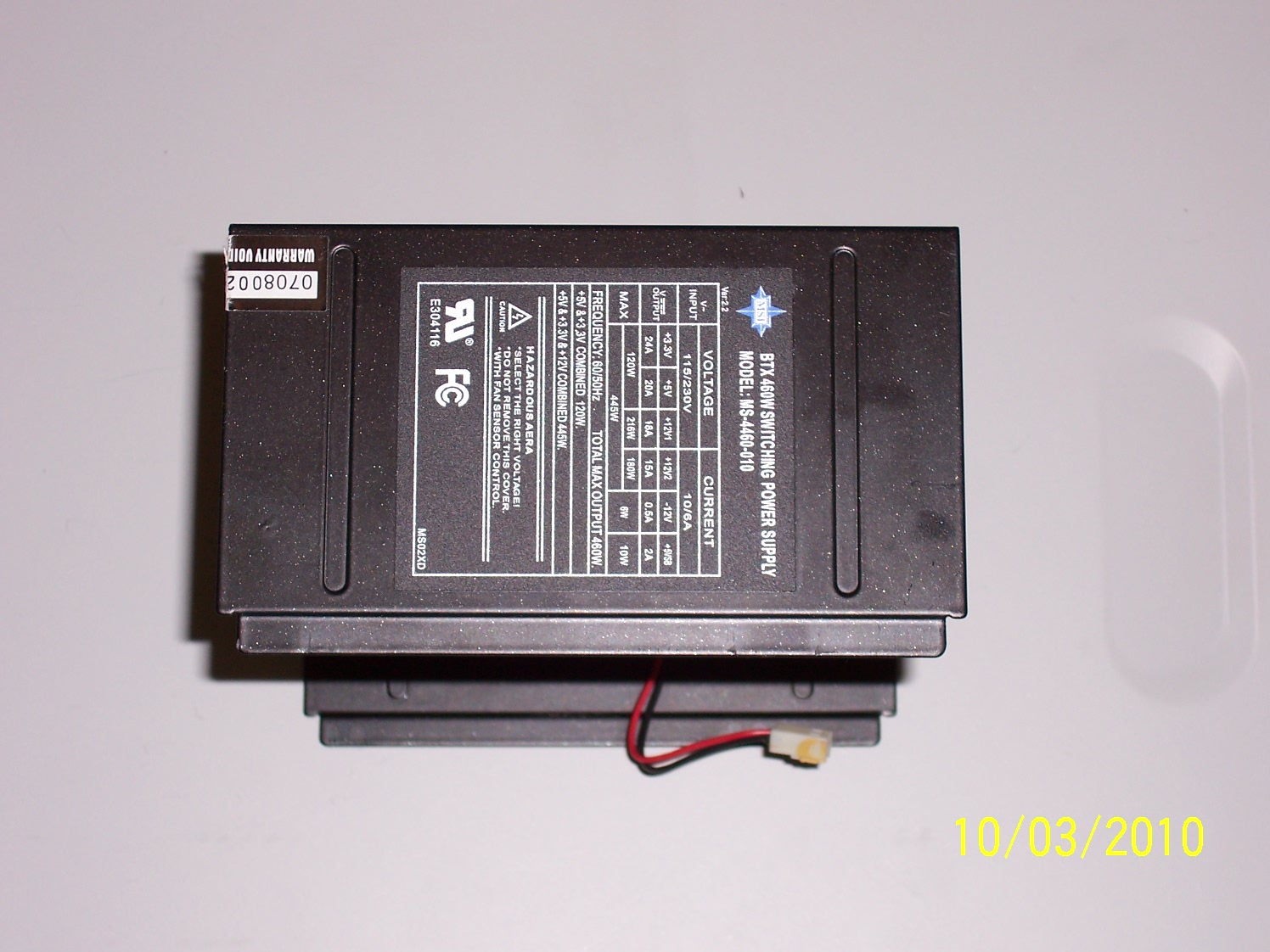

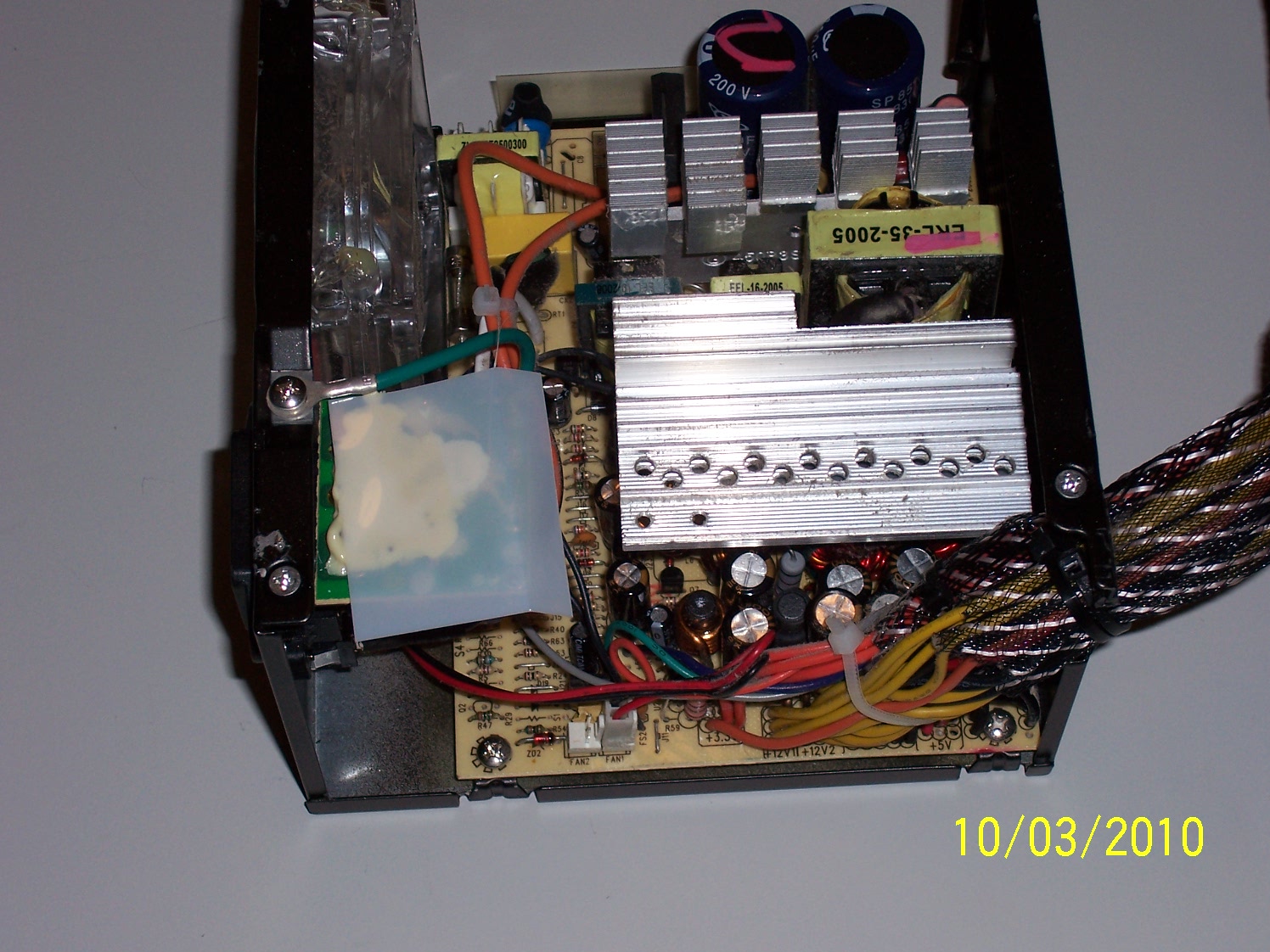

I have seen many LC/Allied/off brand "cheap" power supplies using the "chip of the year" 2003Z pwm/supervisory chip. Just got a MSI BTX 460 watt model MS-4460-010 power supply. Maybe 370forlife can tell me if it is a LC power supply. It seems to be an improvement in many areas:

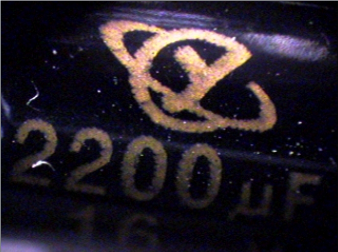

Mains caps are 820 uF/200 volts (although a cheap brand, planet I think)
5vsb is NOT two transistor design but uses Infineon ICE3B0565 chip
Main switching transistors are two D209L
Main pwm/supervisory chip is the new "chip of the year" 2008Z (20 pin)
Two fans
Much better heat sinks
Has anyone seen tech data sheet or schematic of the 2008Z chip?
Still no APFC circuit, but I consider that a plus!
