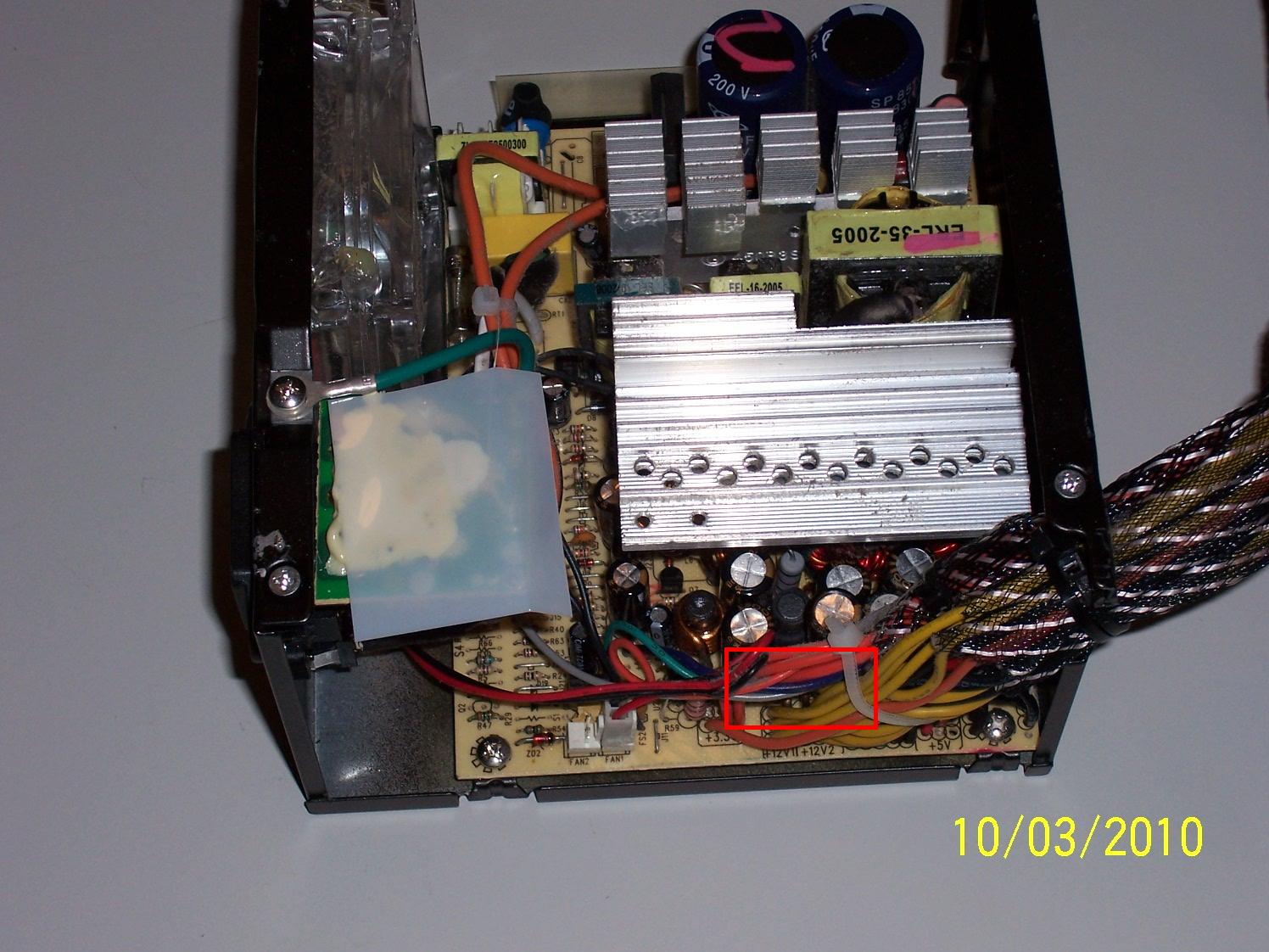

                  Solytech sl-8460BTX. I had a very similar solytech built rosewill sl-8500BTX that used the same infineon chip to generate the 5vsb. It also had OCP, I believe the 2008Z supports OCP, there should be shunts around the 12v leads that would indicate OCP.
                  See the attached picture. I believe those are shunts.
                                Yes, there are two shunts, each measuring zero ohms. Each connects between the 12 source and either 12V1 or 12V2 output. Each output goes to an OPP pin on the 2008Z chip. The markings on the pc board show that a resistor should go where each shunt is located. Does this mean that the shunt is not a thick piece of wire, but actually a resistor?
                                Old proverb say.........If you shoot at nothing, you will hit nothing (George Henry 10-14-11)
                                  Re: Chip of the year 2008
                                  so i have a 2005 chip in one of my psus/ what does the year mean?
                                    These particular shunts are current sensing shunts, they are what allow the unit to have OCP and actually have two separate 12v rails.
                                      Yes. Its value is too low for it to be measured on an ordinary meter. If it were any higher it would dissipate an inordinate amount of heat.
