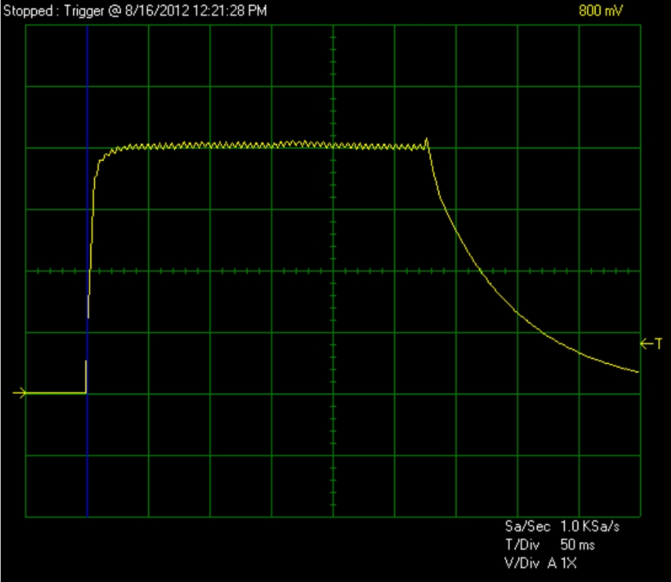

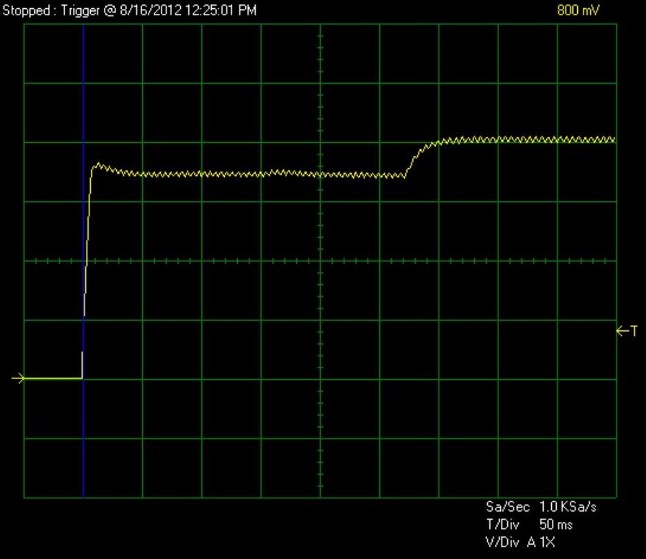

                                At last I have found the culprit. The 3.3 volt rail with no loading whatsoever comes up at about 3.4 volts. With one HDD and one CDROM for a load, it comes up to just a tad over 4 volts, spins the fan a few times and stops. Adding a 15 ohm resistor to the 3.3 volt rail and it comes up to 3.4 volts and stays on. The 5v and 12 volt rails are not giving any problems.
                                What baffles me is that under no load conditions, the 3.3 volt rail goes up to just a tad over 4 volts and stops after 275 msec. With the 15 ohm resistor, the 3.3 volt rail goes up to 3.4 volts for the same 275 msec, then goes up to just a tad over 4 volts for several seconds while the HDD settles down, then decreases to 3.4 volts. I would have thought that going that high AFTER the 275 msec would still shut down the power supply??? See attached pictures!
                                Conclusion, I can either add another 15 ohms to the 3.3 volt rail in the power supply, or I can use a real mother board for testing and thereby have a good load on the 3.3 volt rail.

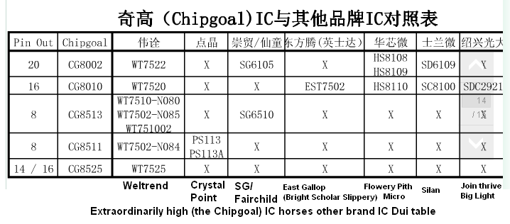

                                    If anyone has the equipment to decap one of them we might be able to figure out who the manufacturer is.
                                    I have a good guess it's Chipgoal (lol) CG8002...
                                      #38
                                      Re: Chip of the year 2008
                                      If the table lists equivalents between the various makes (which i believe it does), then that's definitely not what it is. The SG6105 and WT7522 are the same thing, and they do not support current sensing.
                                      The SG6105 is a 494 + 2x 431 + 6 preconfigured comparators (UVP/OVP for 3.3, 5 and 12v) + 2 opamps. It really doesn't look like what we have here.
                                        Good joke! But if it would have been a match, the part number would have been CGZ8002...............
