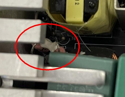

      Guess I'll chime in for quick second here...
      There are two current paths on the primary side for the rectified positive rail after the bridge rectifier before it goes to the positive of the two primary caps. These paths are:
      1) Through the diode you circled in blue and then through the thermistor.
      2) Through the APFC inductor and then the diode circled in yellow
      Path 1) is used only when the PSU is plugged in and sitting in standby.
      Path 2) is used when the main PS is turned on and the APFC circuit is active. At this point, path 1) is no longer used. Therefore the thermistor does not need to be rated for the full power (and thus current draw) of the PSU.
      Admittedly, I too do not recall to have seen the primary of an ATX PSU (with APFC) designed like this before. But I agree with Per that it is pretty clever, as is doesn't require a relay to bypass the thermistor. Most PSUs I've seen, either the thermistor is always active, or there is a relay to bypass is when the APFC is On.
      What I don't understand about this particular design is how current won't flow through both paths 1) and 2) when the PSU is plugged in. I'm sure CM must have though of this... but who knows? For now, I can only assume the APFC inductor has a large enough inductance that it presents a higher impedance path compared to the thermistor, at least on a cold plug in with the bulk caps discharged. Therefore, only path 1) can be used on a cold plug-in. But maybe not? If so, that could be why the switch contacts are getting fused. However, I doubt this could have happened to every one of these PSUs without anyone noticing. Given that these are decent quality PSUs, Q.C. at the factory would surely have caught this.
      On the other hand, I wonder what will happen if the thermistor is open-circuited. Perhaps then this might somehow cause the switch contacts to fuse, as only path 2) will be used and there won't be a "soft start" circuit. The APFC inductor might have a higher impedance compared to the thermistor for the first few ms of the rectified wave, but then a much lower impedance shortly after. If so, and if the thermistor is open-circuited, then perhaps this is one way to make the PSU draw a much higher inrush current?
      You mentioned your thermistor measure OK, though... so I'm skeptical this is the issue here.
      If anything, I'm more inclined to think the replacement switches may be the issue here. Where did you get your replacements? If ebay, Amazon, Ali, or some other China-mall place online, consider their ratings bogus. You'd think the cheap China factories can't get it wrong with making a simple switch... but in fact, they CAN (and I have seen it multiple times myself with cheap switches failing after number of years vs. quality switches working reliably for a long time.)

          In my opinion this path should not exist because when the PSU is soft off the MOSFET's for the APFC are off so there is no path through it to the capacitors.
          But if one of the MOSFET's failed shorted that would surely be a problem and cause this inrush issue.
          Well, not quite.
          The two APFC MOSFETs are not part of the current path from the bridge rectifier (+) lead to the bulk caps (+) leads. Rather, the APFC MOSFETs pulse On and Off when the APFC is activated, shorting the positive rail from the bridge rectifier to ground through the APFC inductor. This "charges" the APFC inductor each time the MOSFETs are On, and then "discharges" through the APFC diode and into the bulk caps when the MOSFETs switch Off.
          So if one of the APFC MOSFETs failed shorted, either the fuse or the APFC MOSFETs source resistors would instantly blow.
          The circuit is pretty much the same as the one I drew a simplified schematic for a while back for an Enermax Pro 82+ PSU, shown here:
          https://www.badcaps.net/forum/attach...1&d=1539360637
          In the case of the above schematic, Q3 and Q4 are the APFC MOSFETs with R7 and R8 the respective Source resistors. L1 is the APFC inductor, and D4 is the "diode" (Enermax used the S-D junction of a MOSFET there for whatever reason) corresponding to the diode circled in yellow on Tony's picture. THR1 is the thermistor... which is not where it is in this Cooler Master 12000W PSU. C1 and C2 are the primary bulk electrolytic caps.

            You're welcome, can you also please check resistance at the point I marked with red text as "Heatsink Pin???" in the same picture, if that leads to the heatsink or if you can see where it leads in the top of the PCB?

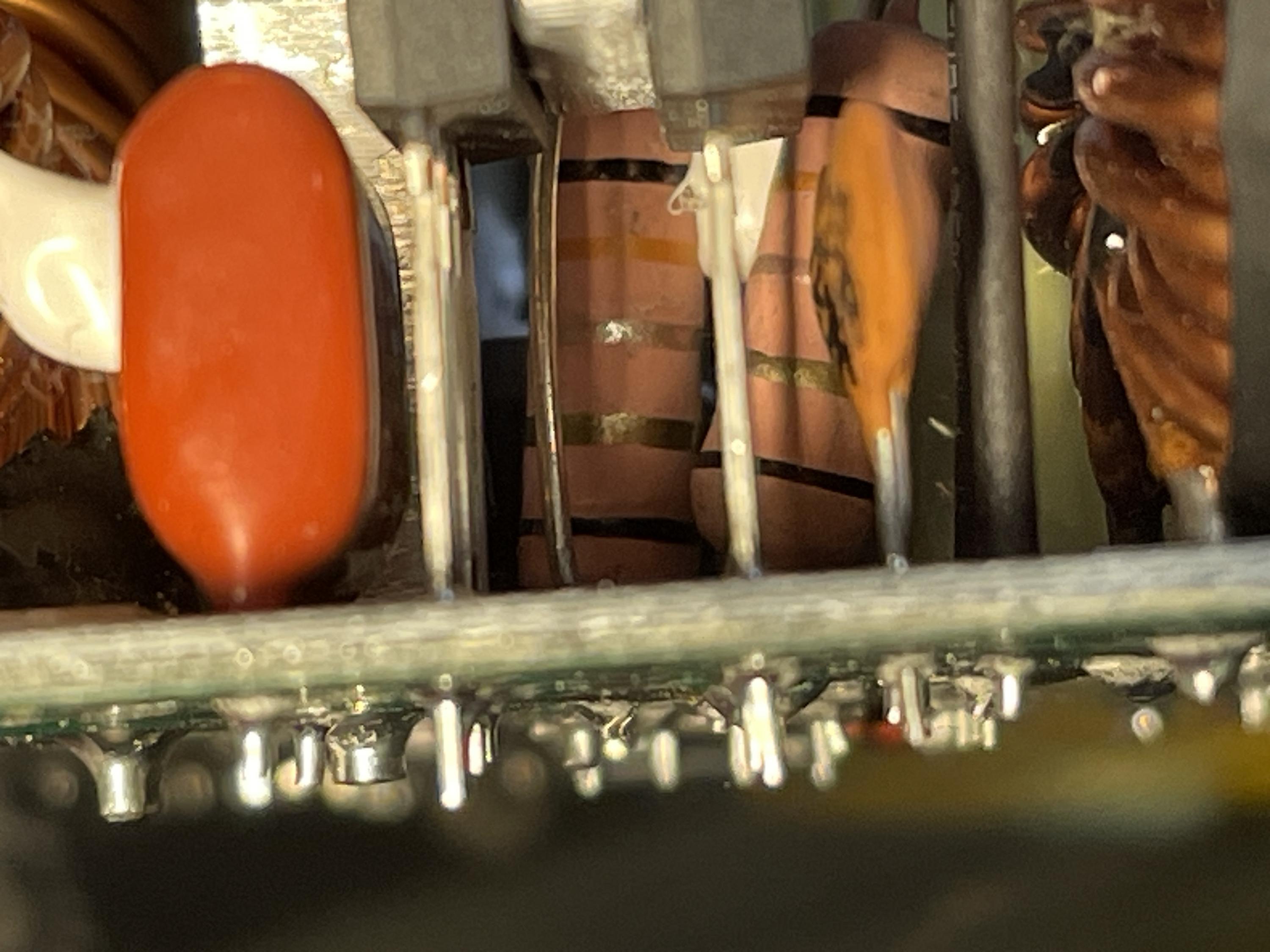

            tony359: what's the color coding of these two resistors?
              attached. Could it be 3.8 Ohm? I'm reading a short there - my probes read 0.5Ohm if I short them and I read 0.5 ohm on those resistors in circuit.

                  how did you get 3.8ohm from black(0) yellow(4) silver gold black?

                    I get Black Orange Grey gold - and the last black might be some special tolerance?

                          The resistors should be read with regular color scheme for a standard 4-band resistor.
                          So it is black-orange-silver for 0.03Ω then gold for 5% tolerance and the final black band is manufacturer specific (could mean non-inductive for example).
