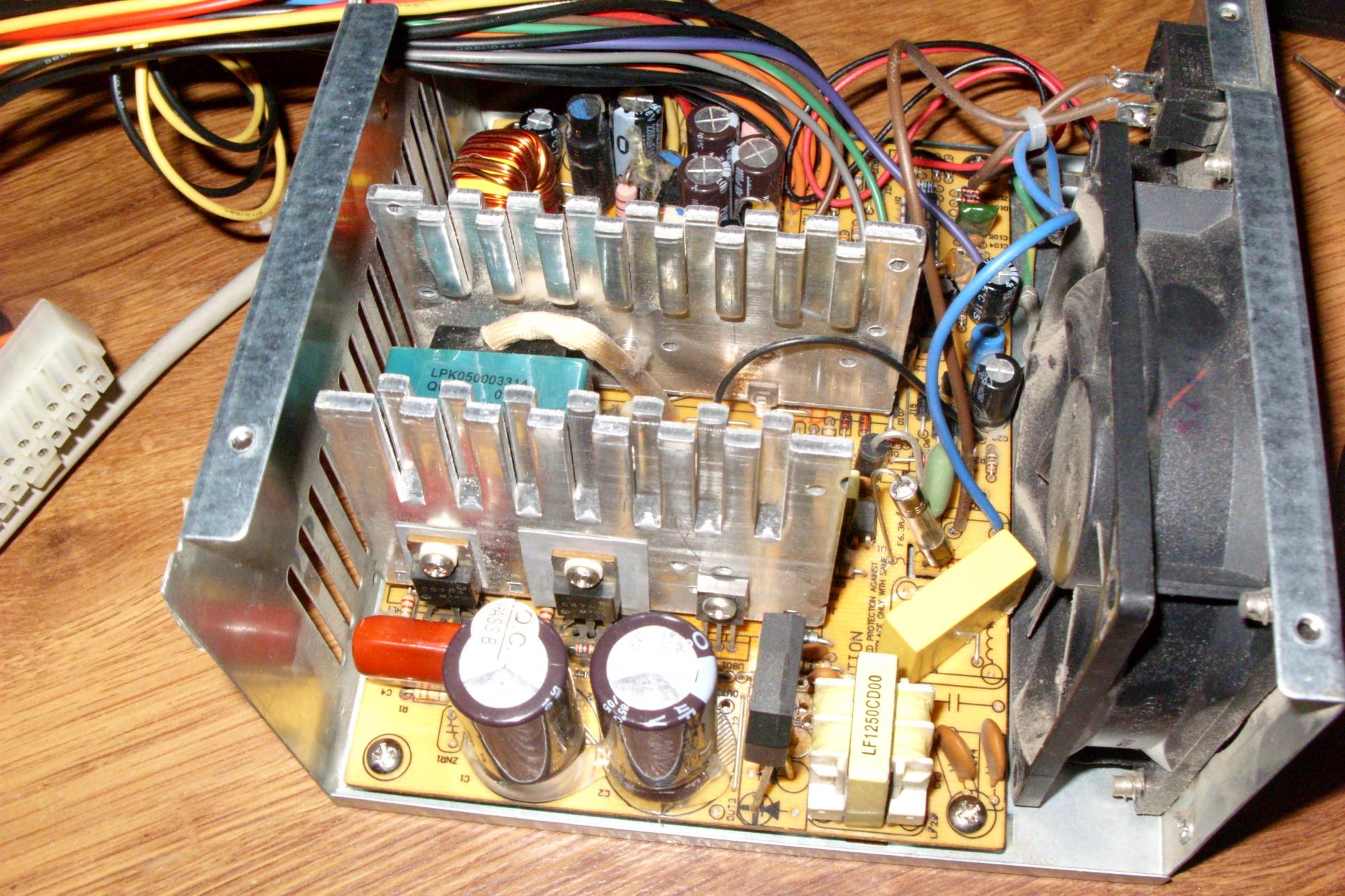

    Here's what the label says. For 400W (there is no "420W" model printed on the label):
    • 3.3v: 24A. Bullshit! The rectifier is a SBL2040CT (20A).
    • 5v: 33A. True... almost. The rectifier is a SBL3040CT (30A). It can usually handle a couple amps more than its datasheet says.
    • 12v: 16A. True... in theory. The rectifier was a SBL20100 (20A), however, it was blown. It probably was a knockoff part.
    I got it for free. It had the following issues:
    • Bad caps on the 3.3 and 5v rails (2200uF/10v Forever and Canicon)
    • Shorted 12v rectifier
    • Shorted primary transistors (D209L)
    • Blown (open) base drive resistors
    • Blown fuse (of course)
    • Incomplete transient filter (two Y caps and that was all)
    However, it had several things that made me decide it was worth fixing:
    • A bridge rectifier! No 4-diode treatment, thank you.
    • Decent primary capacitors (a pair of 470uF Teapos)
    • Complete output filtering, all coils were in place (if you didn't know, they like to omit those as well!)
    • Adequate gauge wiring on the main filter coil
    • 20+4-pin ATX connector
    • SG6105D controller
    The bulged capacitors were replaced by 1000uF/10v Nichicon PL(M). I didn't find anything official about this series, but they look a lot like the PM(M), and the specs on those look real good. They came from a Tyan Tiger 100. I'm pretty sure that the lower capacity is made up by the much lower ESR. Also, they are the same size as the "2200uF" Canicons, so it's likely that Canicon was simply lying about their capacity. The caps on the 12v rail were left alone for now.
    The other parts came from a 300W Powerlink that i also got for free. This one was in working condition and had a half-decent transient filter, however it was a disaster in any other aspect. 220uF primary caps, all pi filter coils were missing, it had a grand total of THREE main capacitors, two of which were bulged, the wire on the main filter coil was the thinnest i'd ever seen (i think it's 26AWG), the main transformer was ridiculously small (first time i'd seen one of those too). It was ridiculously crammed as well, no chance of actually fitting the missing parts in. It also had a loud fan. Probably that's what kept it from blowing up...
    Even after recapping it couldn't keep a 20GB hard drive running, and it happily continued powering a motherboard with a shorted chipset even though ALL voltages had gone out of spec. Luckily i noticed that the fan had slowed down and shut it down, otherwise it would probably have gone boom. Loud fan and all, it was quite hot inside after this incident. So i decided to transplant the primary transistors and filter components into the 420W. Here's what got donated.
    • The two 2SC5763 switching transistors
    • The 2.2 ohm base resistors
    • One SBL2040CT rectifier for the 12v rail
    • The input filter coil
    • One X capacitor
    • The fuse ()
    I plugged the 420W unit in, and... nothing. I quickly found the reason: One side of the input filter coil wasn't actually connected to anything on the PCB!!! I re-used one of the straps they used to bypass the coil to wire that end of the coil to the diode bridge. I then plugged the PSU in again. 5vsb? Precisely 5 volts. Green wire to black wire.... and.... and.... it didn't blow! Yay. It also has a fairly quiet fan.
    I connected the PSU to the board with the shorted chipset. It did what it was supposed to do - didn't power on at all! So this one actually has protections... I wonder why it blew up in the first place.
    I left the PSU connected to a Pentium III and it's doing fine for now. I'll fire up the 'scope and check its ripple later, but i think it's well within specs. So let's revisit the ratings now, judging by the rectifiers. The input bridge rectifier is 4A and mains voltage is 230v here, so no problem with that. The 3.3v rectifier is 20A so that makes 66W. 5v - 30A, 150W. However, since 3.3v is derived off 5v, that's a total of 150W for 3.3 and 5v together. 12v - 20A again - 240W. 150+240=390W for 3.3, 5v and 12v. If you also add -5v (0.6A), -12v (0.8A) and 5vsb (2A), it looks like this one might just honor its rating! We shall see.
    Things it still needs:
    • A MOV in the input filter
    • PCI-E and SATA power connectors
    Pics coming tomorrow, i'm too lazy to make some after typing all this. So. What's YOUR testing PSU and where did it come from?
              Bulk capacitance is more important to power supplies than Low ESR. Also, lowering the ESR can actually increase ripple in power supplies as the PI filters are "in tune" with the ESR rating of the caps. I like to use Samxon RS (available here or through Big Pope) as they come in 10x30 size in both 16v, 3300uf and 10v, 3300uf. Good for bulk capacitance and not-to-low of ESR.
                I have to check on that one... The PSU is performing great atm. Though i did find another spot with room for improvement - the ATX 12v cable should be heavier gauge. As it is now, a Pentium D can dip it to 11.75v which is lower than i'd like. The rest of the connectors stay over 12v, so i'm sure it's the cable.
                      If the primary transistors are in TO-220 packages, chances are something will blow up before you even get to 350W. 250W-300W is more within the range of these PSUs.
                      By the way, what size is the main transformer? 35 or 33? If the latter, you're looking at no more than 250W continuous (300W peak).
                      You did a lot of good work on it, though, so it should be more reliable now at least. Good thing you put a schottky on the 12v rail. Much lower heat loss than a fast recovery rectifier. Definitely check ripple if you have a scope, though.

                        Yes, they are TO-220. I'm not too worried about them however, i've blown dozens when building my own SMPS with +/-70v output so i know exactly what they can do. That is, till i switched to MOSFETs in that supply - IRF740s - blown pairs count - zero.
                        I'll put some MJE13009s in there sometime soon so i can stop worrying about them entirely. Btw, the D209L transistors it had were in TO-3PN package, and they were still blown. If you read Hardware Secrets' reviews, they had primary transistors blow in ultra-low-end 350W Huntkey supplies, yet the very same transistors did not blow in the 700W Rocketfish supply which is also manufactured by Huntkey. It's about the implementation as well.
                        It's an EI-33. In my +/-70v supply i pull 400W from one myself, so i know it is possible.

                                  I've scoped it and overall ripple/noise levels are at about 70mV for the 12v rail, with the PSU powering a Pentium D. Acceptable. However, there are some spikes that get over 600mV tall... Looking at them with a small timebase shows that they are actually very high frequency ringing, they clock in at 8.7MHz. For now i am sure they do not come from the transformer, as i've tried placing snubbers there and no result. They may be a result of parasitic inductance somewhere in the secondary... i'll check it out when i get back, as i'll be leaving for a week.
                                  Adding extra caps to the board does not help. But strangely, adding them on the rail i am measuring (especially a 100nF ceramic), cuts the spikes in half. The cables seem to kinda act like an antenna... so i'm not exactly sure if the spikes come from the PSU at all. There is a ~200mV waveform at about the same frequency, that i see on the scope even with the power supply off, so it's interference from something. It has a distinctly different appearance than the spike, but i think it could be a part of it.

                                    I would add another X capacitor and a second coil at the input filter. I would also add mov protection.
                                    What is the capacity of your input caps?
                                      Re: What is your testing PSU and what's its story?
                                      I mentioned in the first post - it's a pair of 470uF Teapos. There is no room for a second coil, as you can see i decided to put an X capacitor there, but i can solder a second X cap to the back of the AC plug like commonly done.
                                      I will add MOVs as soon as i have a good excuse to go to the parts store, aka as soon as i have at least $20 worth of stuff that i need from there.

                                        You can place a X cap on the AC plug and a second smaller X cap in the empty space of the pcb near the y caps. That way you can add a second coil where your X cap is now placed.
                                        470uF primary caps I think are good for 300watts max.
