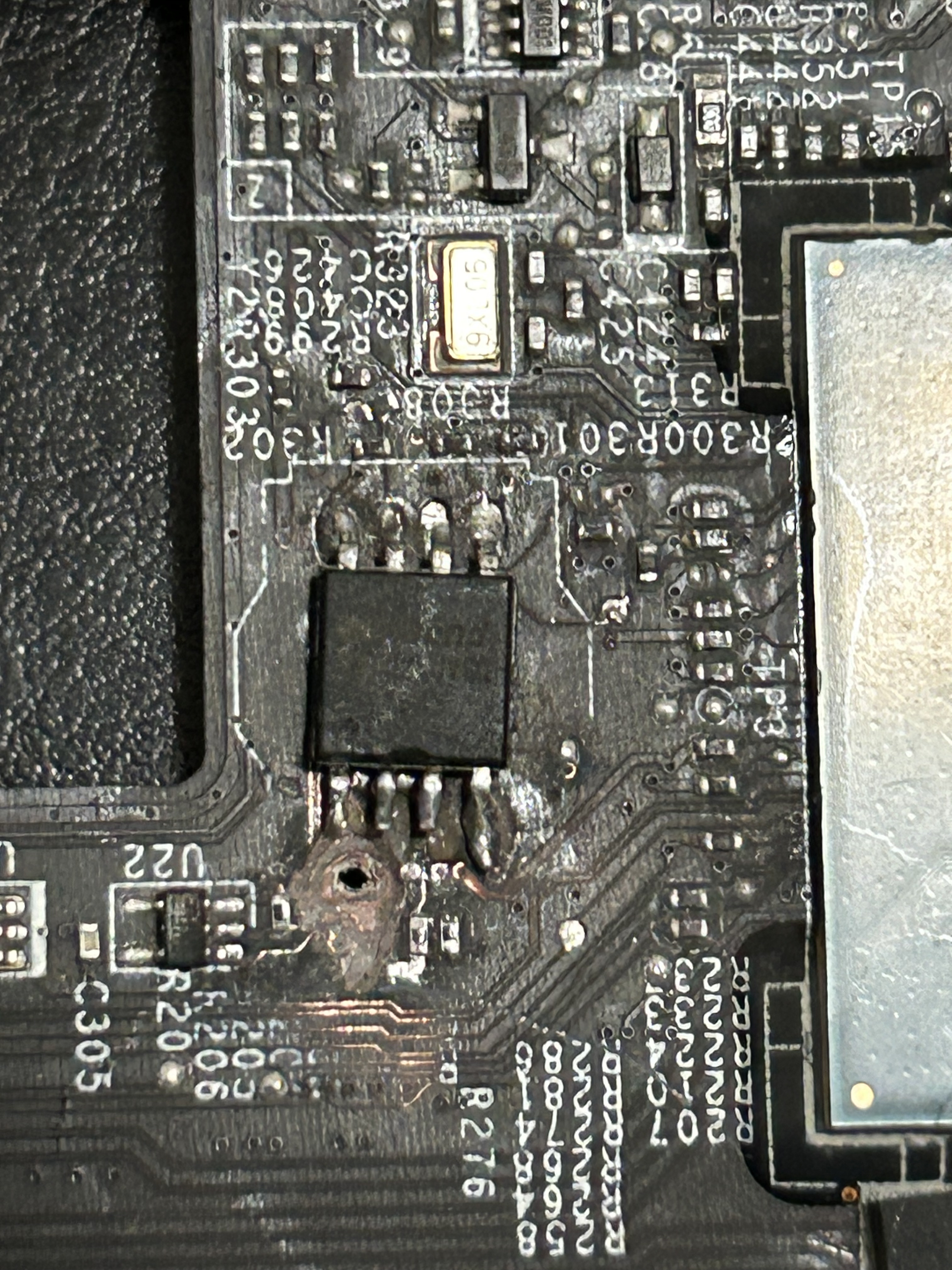

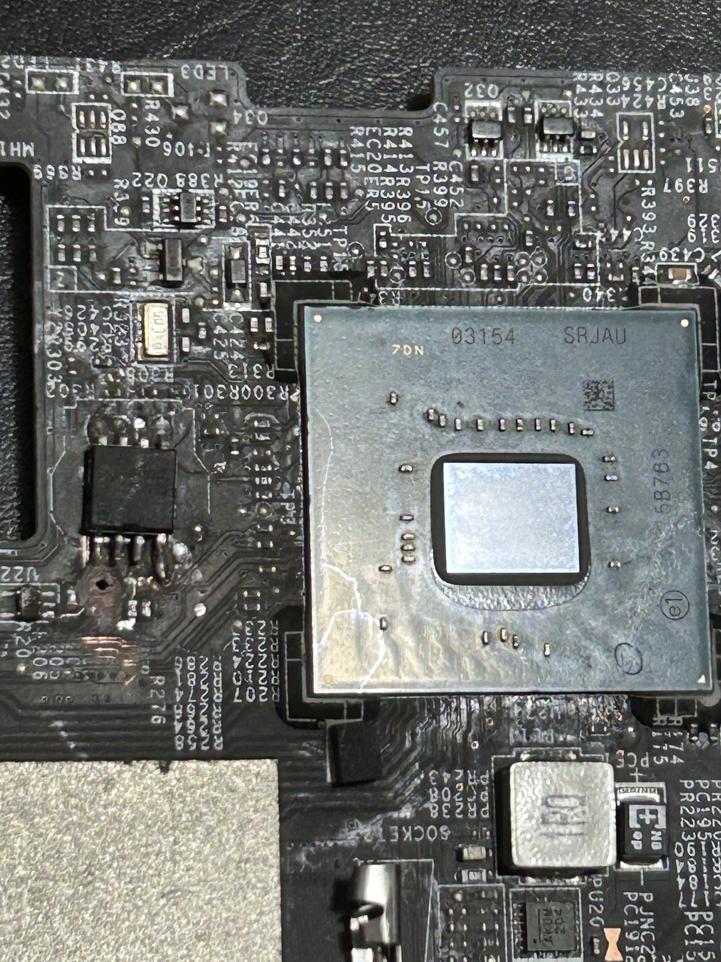

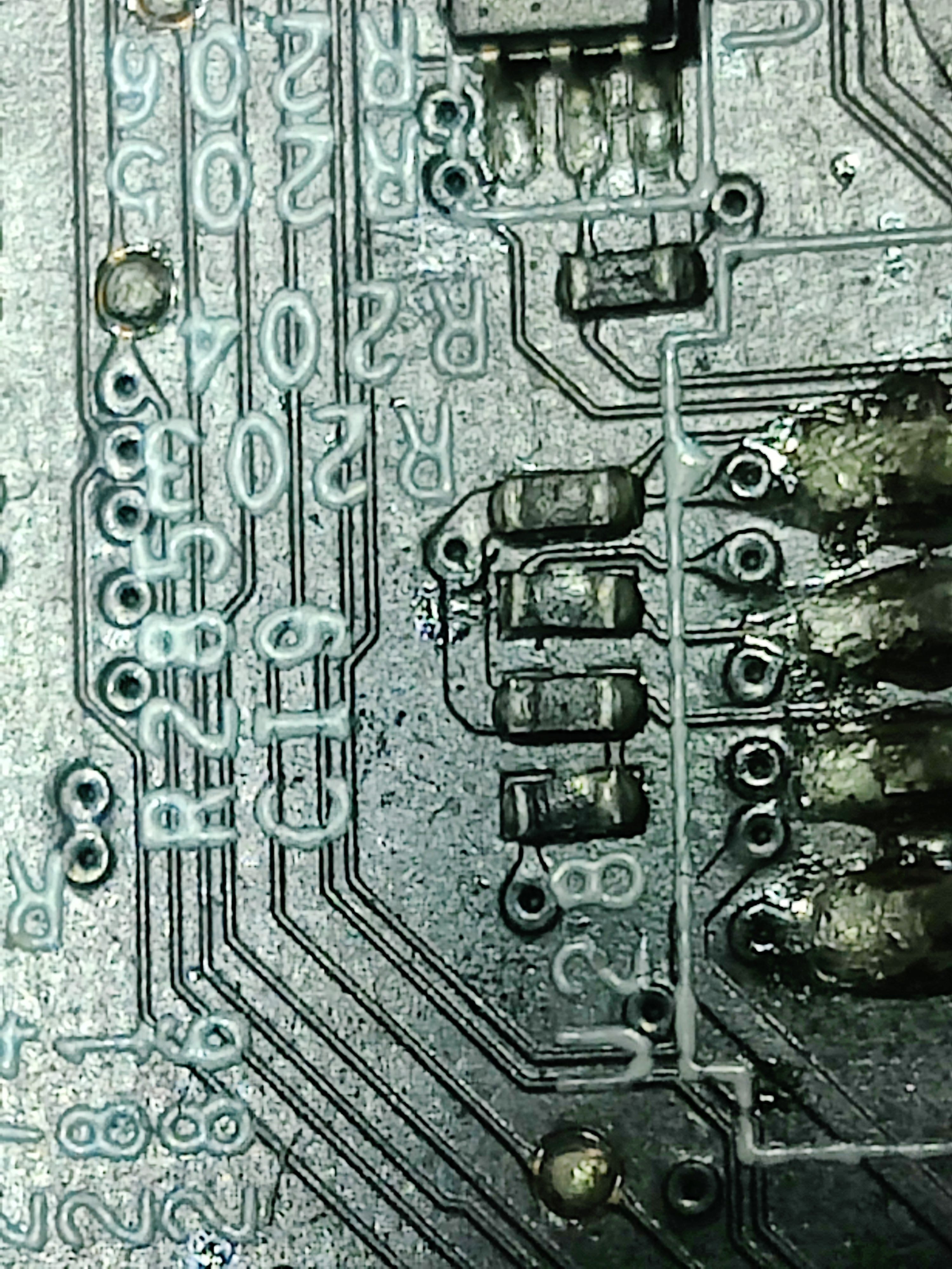

        I buggered the bios chip pins 1--3-> traces gone and missing resistors =(
        Board has major damage.
        Thank you for any help you can provide.

          Post a few pics of the board shape. Perhaps another model will be similar to allow us to study the schematic.
          Also - is it the main bios or another that is butchered?

            Main Bios
            thus far ms gs75 stealth 9 series seems similar....
            • ethics
              • Oct 2016
              • 39
              Similar to ms-17g11 schematic-Same EC chip
              I am going to jump wires from EC chip to resistors-->Bios chip pins 1/2/3....
              Any idea what resistors values I should use for pin 1/2/3? would cs# = 1k? 33ohm? cs0? wp#?
              I see various values online....
              Thank you.

                Can someone please upload a photo of Msi gs75 stealth 10sfs motherboard or similar?
                the main bios and its resistor values would save my life!
                Thank you

                    I have a 17G3 Msi laptop, if you still need the photo I can upload it with the values that you need

                      Please!!!
                      near the bios chip is buggered
                      pins 1-4 not sure where vias go also not sure of values of resistors connected to bios pins.
                      thank you!!!

                        Pin 1 resistor 1kohms
                        Pin 2 resistor 22.2ohms
                        Pin 3 resistor 1kohms
                        Pin 4 resistor 22.2 ohms
                        The resistor near pin 1 is 100kohms

                          Thank you so much!!!! any idea the voltages if any of those small vias near pin1-4....? Mine are gone =(

                            basically I need to know which resistors need +3vsus? I am trying to grab cs0 and spi output from SUPERi/o chip for pins 1/2, pin 3 is write protect and pin 4 should be GND.

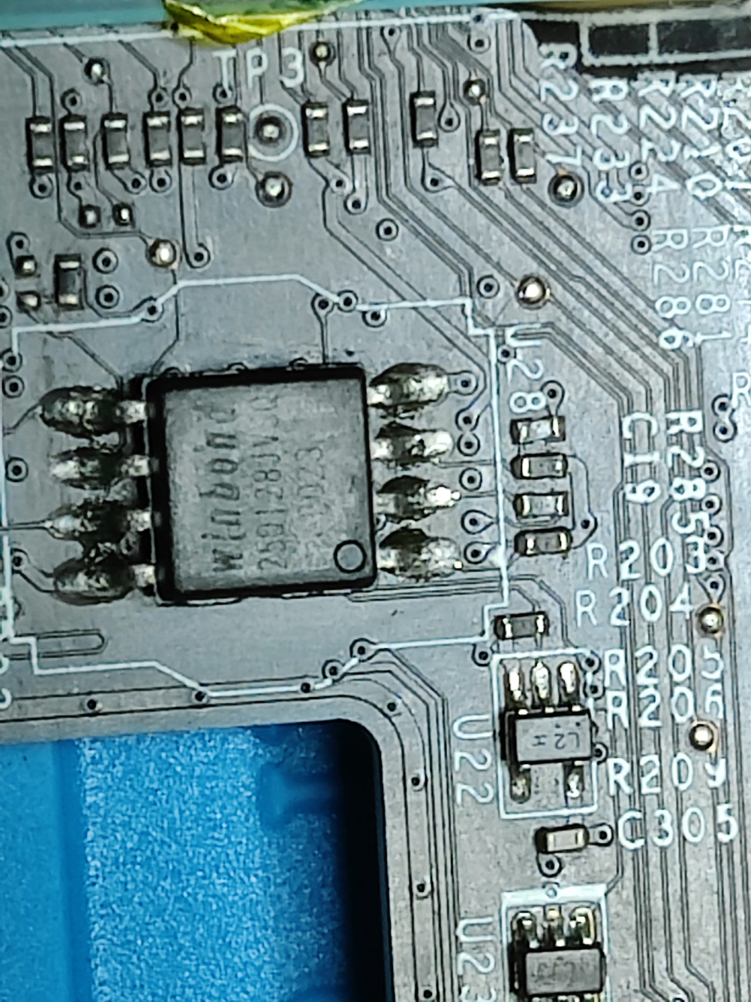

                              EC

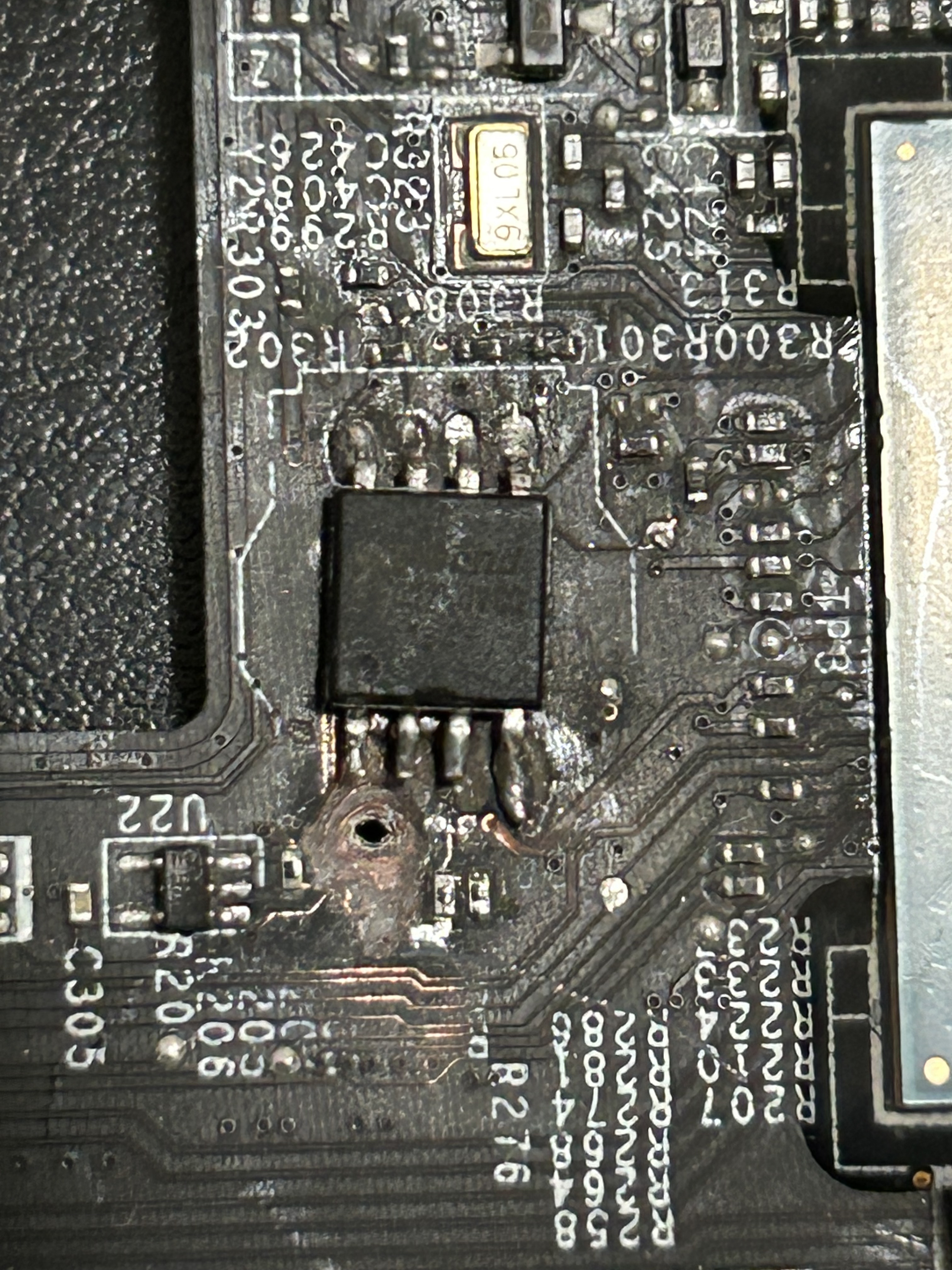

                                    I tried to mark up photo with where I think needs to connect...but can you please assist?
                                    If you could tell me which points need to connect to where?
                                    This is where I am confused...
                                    Thank you.
